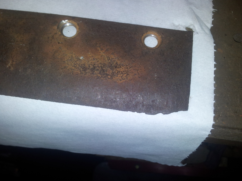

    I have a question for you, Im going to need a new bottom blade for the Atco, its 355mm long by 55mm width, flat profile with 7 holes in it. The closest I can find is 359×50 and is for a Commodore….. would this be ok if I cant find the correct one? Do you know what the part number would be for my machine and who/where I might get one from???

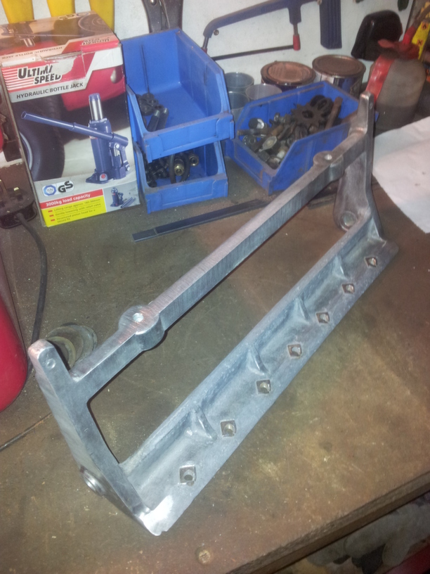

    Had a bit of fun Christmas eve, removing the old bottom blade from the ally frame. not one of the 7 screws would loosen, despite soaking for over a week in penetrating fluid, certainly did not want to hit them with an impact driver because the ally could break. only way to remove was to grind flat, centre punch and drill holes for the ‘easy outs’ the bottom blade is beyond salvage, as there would be little material left once the dings were removed.

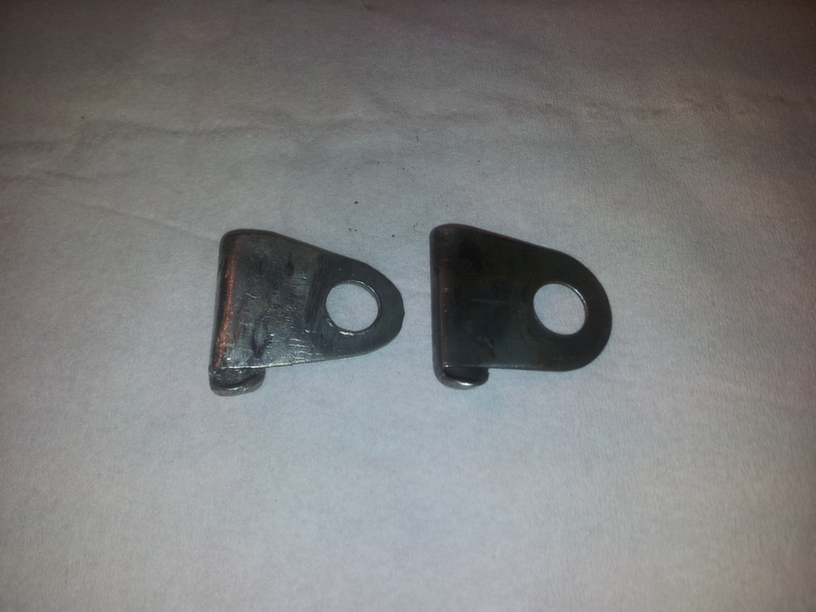

    darmic1

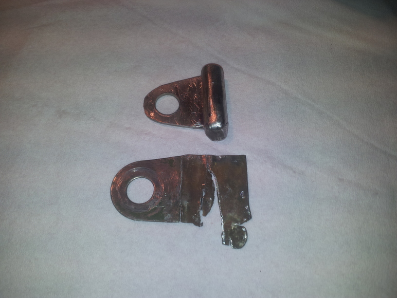

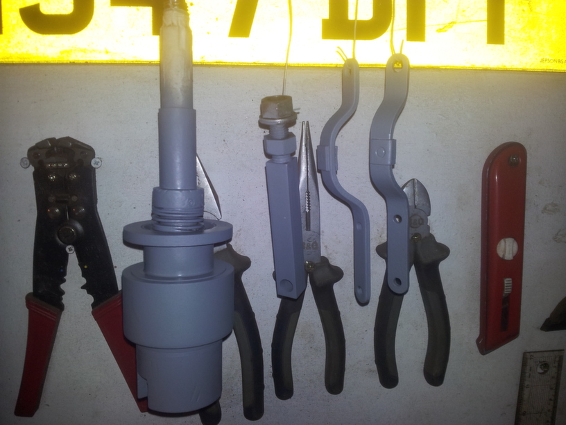

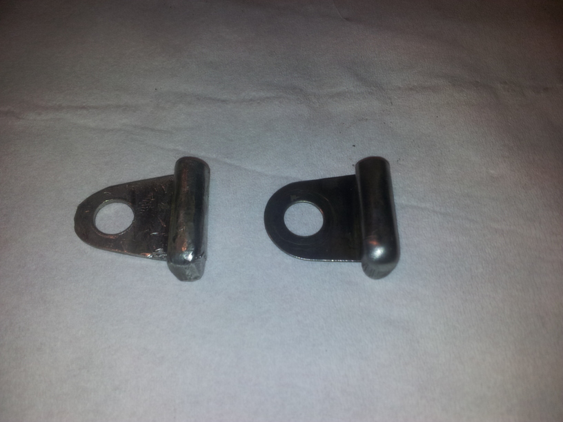

    Have been back in the garage today, making up for lost time. Have made a new ‘oiling tube’ as one was damaged beyond repair after a chain failure at some point. Here’s the damaged one, flattened as a template and the newly made one. there’s also a picture of an original with the new one.

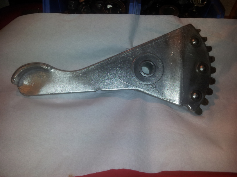

    darmic1
    Also cleaned and polished the ally kick start pedal.

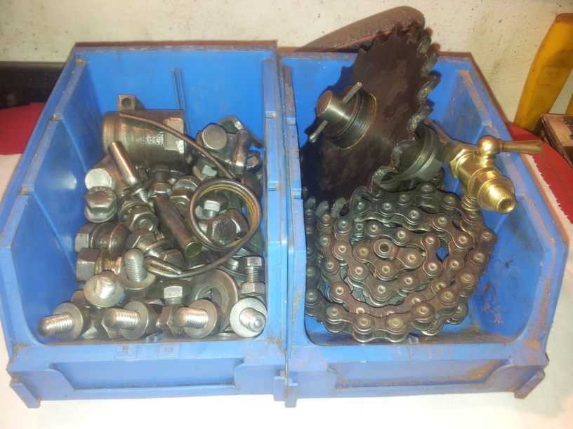

    All the nuts, bolts and other fixings have been de-greased, de-rusted and are ready for reassembly.

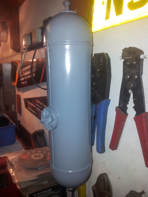

    darmic1

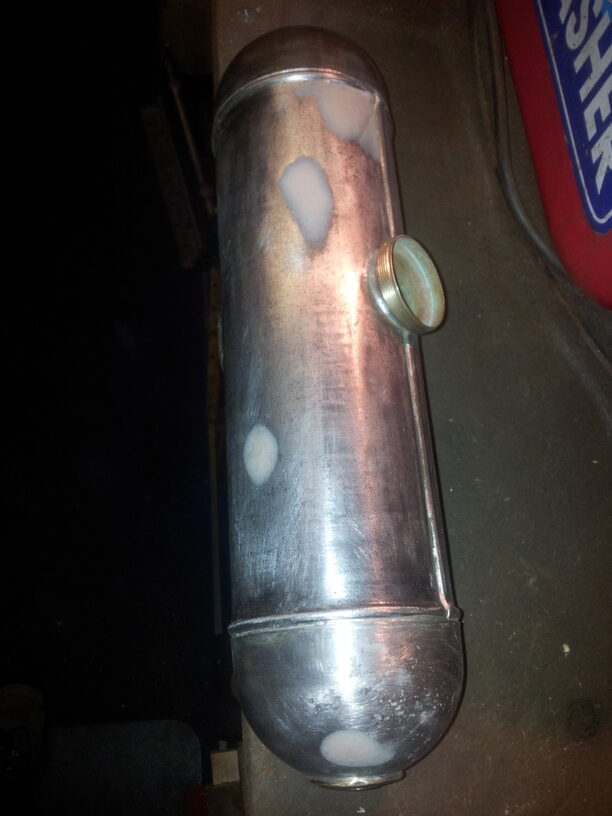

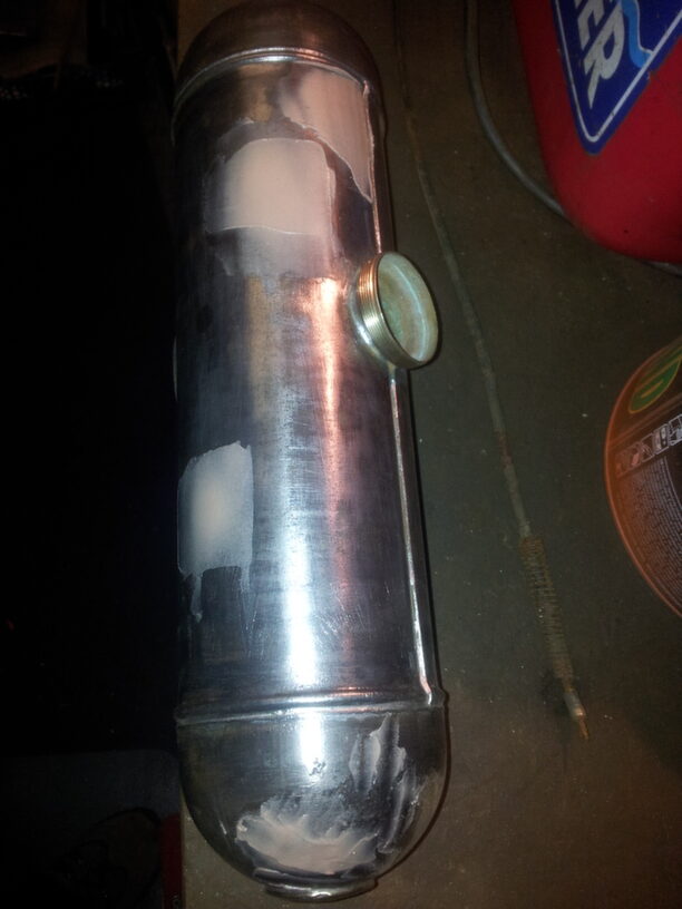

    The last of todays tasks was to prep and prime the fuel tank. This was stripped down to bare metal, the dents were filled and sanded then a couple of coats of Etch primer ready for top coat once colour is identified.

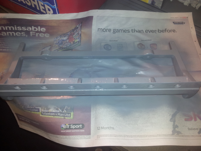

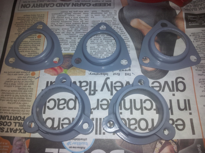

    Don’t know about Lord Lucan? But hopeful on the paint, maybe next weeks lotto numbers would be nice too! Didn’t get too much done here, 43 years young today. Had a couple of other chores to attend to, like my daughter’s blackboard, she’s been moaning her chalk crayons don’t draw anymore. So a quick rub down and repaint…. But couldn’t resist the Atco. A few bits that were ready for priming got a coat or two of etch…..

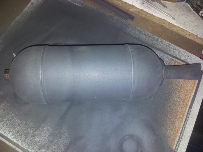

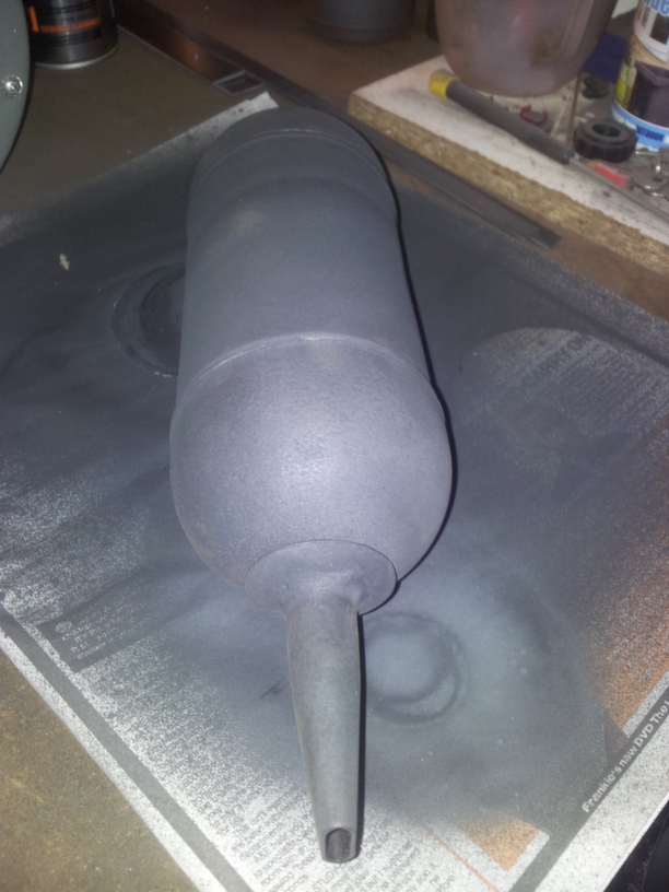

    The exhaust got a bit of attention today. Rubbed down using a 180 grit paper, then a finer 240 grit before several coats of high temperature paint, the same as used on the Gem exhaust.

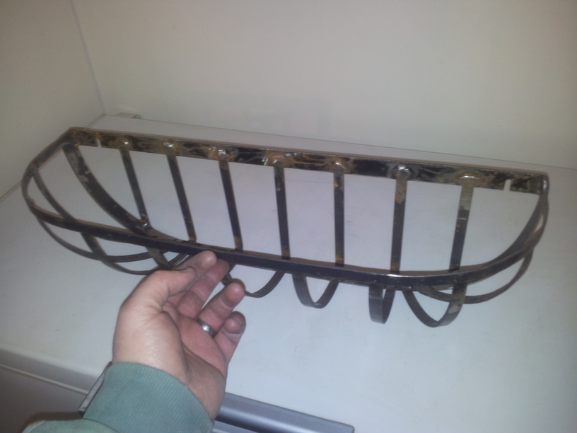

    Was then side tracked by another project. Not strictly horticultural, but will be in the garden next year……. We’ve had some Baskets/Planters on the fence for the last 5 years, this year whilst emptying the compost and liners they kind of fell apart, rusted away completely. I’ve kept one as a template and quite a few weeks ago bought the steel to remake them. Its been cut and just sitting in the garage for a month. Today I finally got to weld one together, the other 2 are ready to go, when I get a dry day. Here’s the 1st of 3. Once finished they will be blasted and powder coated black.

    Not just a pretty face then,when you have a spare hour or two make them in different sizes and put them on the unmentional one.that little basket would be about £11 on the bay. well done
