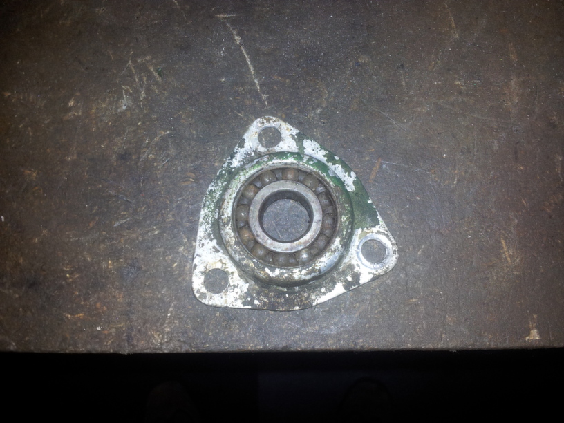

darmic1ParticipantTodays progress was to make the gaskets for the crank case and the barrel. All made and ready. Next was to remove the remaining old bearings from the roller and the cylinder. These came off fairly easy and I took them to my bearing supplier for identification. He confirmed them to be RL5’s, a double race, self aligning bearing, not something which is kept in stock these days. 4 phone calls later and it wasn’t looking good for the old Atco. He then phoned an importer/distributor who it seems holds the entire UK stock of these bearings. The downside is they are £10 each and I need 5 of them, still, they are decent quality and not cheap chinese rubbish. They should be here in a week.

darmic1ParticipantThanks Andy, thats brilliant. Re the bearings, my vernier has stopped working, changed the battery? Dead! Couldnt measure them and these guys were really helpful last time I needed bearings and seals for the Gem….. Thanks Ray, if I could identify them…… cheers!
