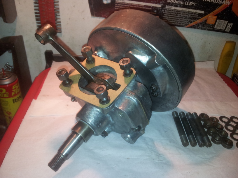

    #4275
    darmic1
    Spent an hour in the garage this evening. The crankcase is all back together with the new gasket.

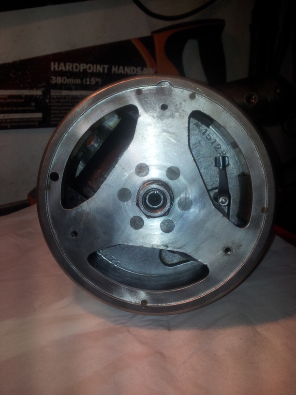

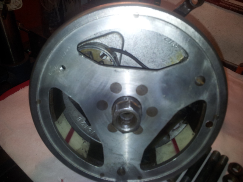

    #4279
    darmic1
    Put the flywheel back on to adjust the points, and after lining up the 2 arrows, discovered that it might be a bit of a faf to adjust the points and refit the points cover. The flywheel obscures the points completely!

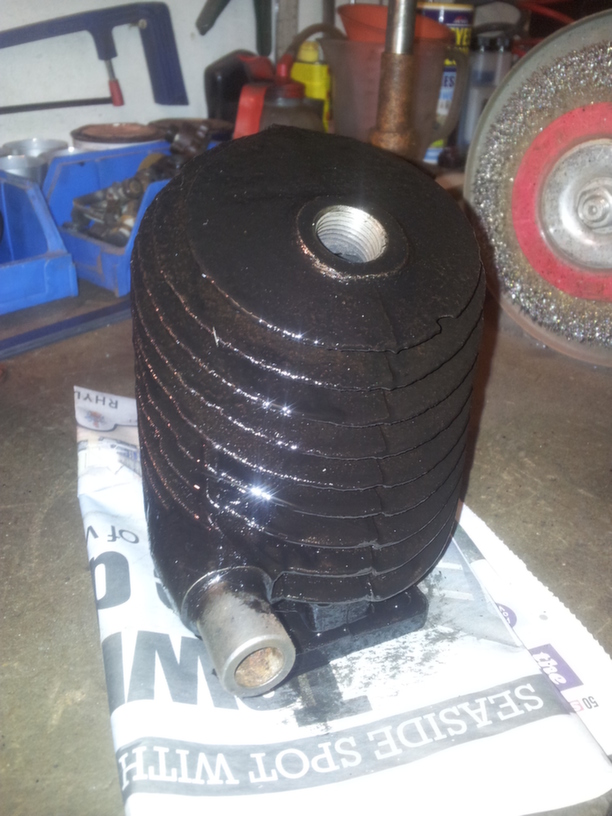

    #4282
    darmic1
    Got the first coat of Smoothrite on the Barrel too……

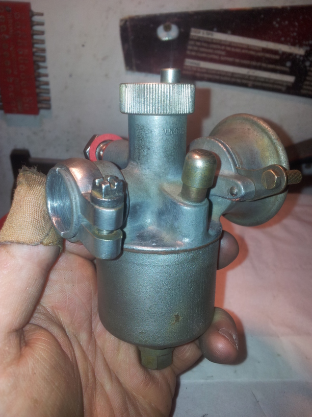

    #4285
    darmic1
    The new parts arrived from Meetens today, so the carb is now back together.

    #4296
    darmic1
    The method for setting timing does state, 1/8″ before tdc, as the arrows are just a guide. Re the difficulty getting to the points, have found several pictures showing the back plate turned through 180º, ie with the coil to the top left. Not as mine was when stripped down. Am wondering if this will have much of an effect on it, as the whole assembly will be turned through 180º. It will certainly make setting the points easier!
    #4297
    Darren. I would give it a try,like so many of our projects the have a go joes get going and then they give up in desperation then we get them and make the babies sing. all down to the knowledge on this fine forum.
    #4337
    darmic1
    Well, its been confirmed…….. I was not thinking clearly earlier. I thought that if I turned the back plate through 180 degrees, that the flywheel would no longer be covering the points. Hmmmm, a definate blonde moment. The whole assembly moves doesn’t it, Its exactly the same, just opposite where it was! However, its not all bad news, The coil is now at the top left, where almost every picture shows it to be. The HT lead now exits opposite side to the exhaust, and not under it. I think its right now, anyone confirm this for me please?
