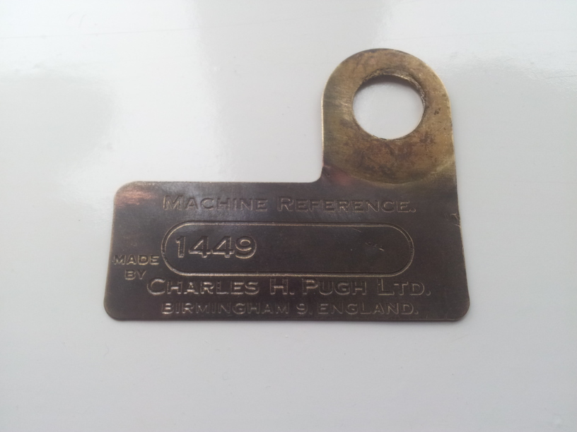

    Have found the following plate on the machine, it seems this is a Machine Reference number. Don’t know if this denotes the year in some way. The number shown is 1449, I thought 14″ and 49cc???
    #4062
    HI Darren,
    The plate denotes it’s a 14″ built in 1949.

    darmic1
    Thats brilliant, thanks for the info. It makes it older than I first thought!

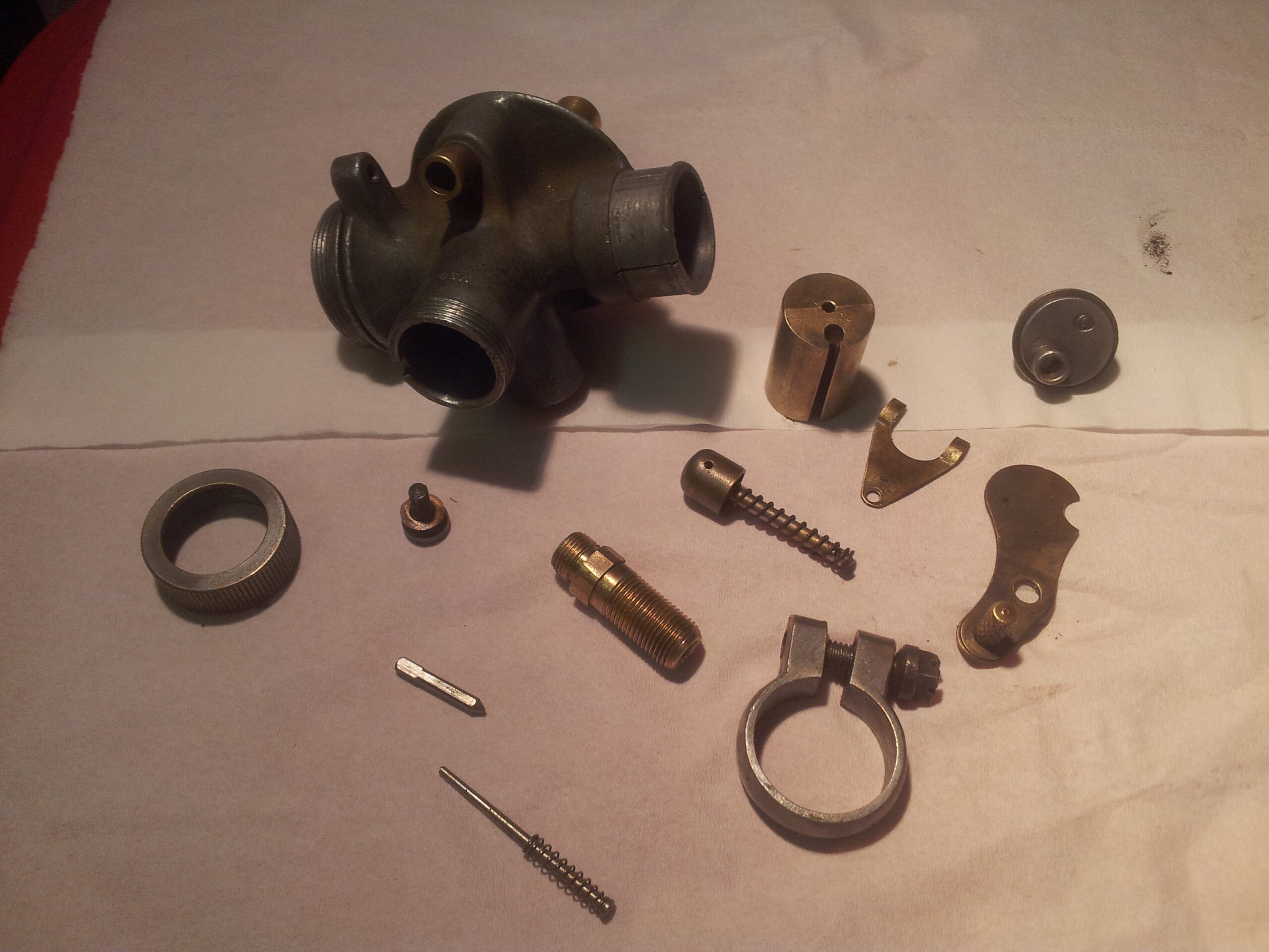

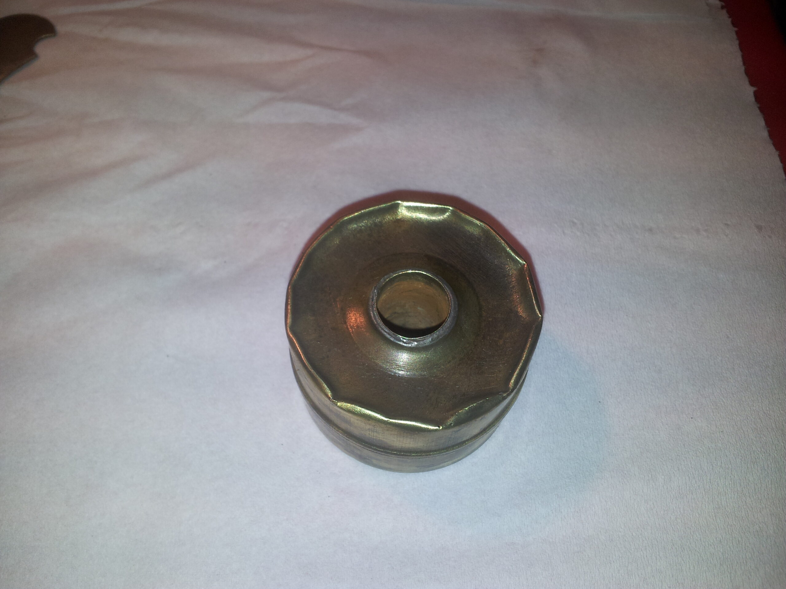

    I’ve had a quick look on “Villiersparts” site and have seen a carb which is remarkably similar, the Villiers junior…… I’m going to need a couple of bits for the carb, namely a float and a new bowl as the float has at least 3 holes in it and is seriously dented. The bowl is badly corroded both on the inside and on the outside. I will also need an overhaul kit for it too. Here’s the damaged float and the carb stripped down.

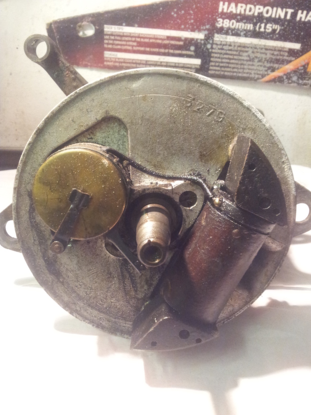

    darmic1
    The little Villiers is also stripped down. It looks like its never been apart before, judging by the points cover…….

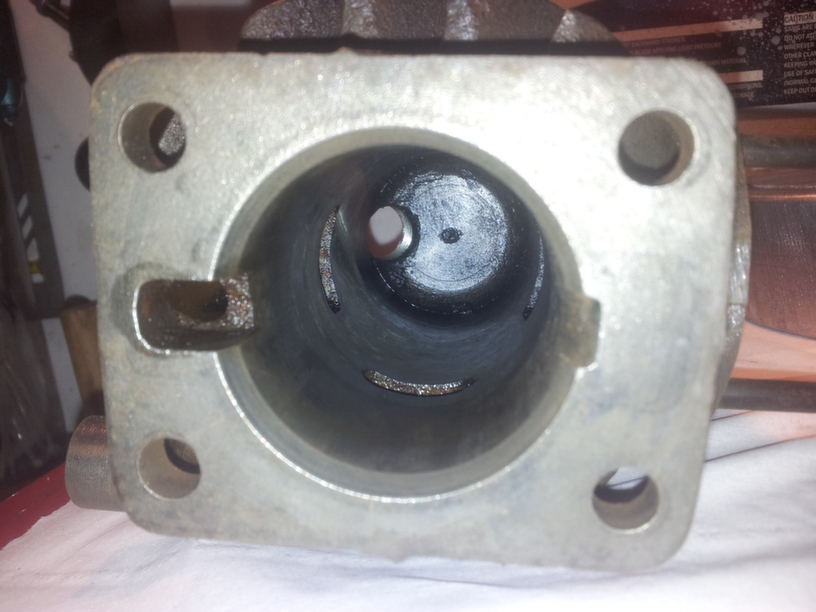

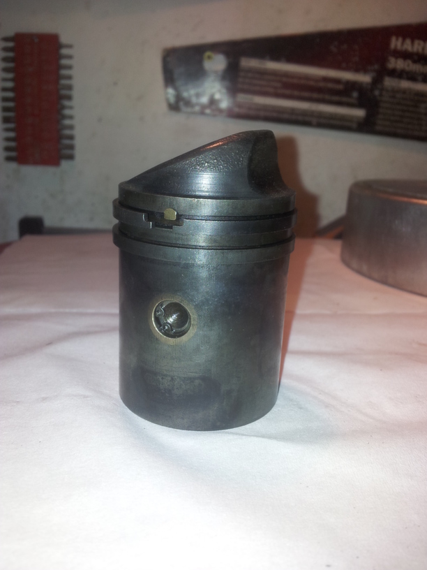

    darmic1
    The barrel and piston are in really good condition too, with no wear or scoring to either. This would explain why it has good compression

    Darren , obviously the Carb and magneto parts are Villiers , as this engine is unique to Atco , I suspect that they had this produced by Villiers at their design/request.
    I’m almost certain I have one of those floats , and more than likely a good bowl , that you are most welcome to FOC. I’ll have a gander in the morning.
