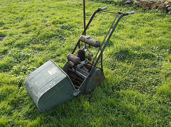

vhgmcbuddyMemberProbably dates from the 1960’s with the Ali handles and that type of exhaust. I’ve got a 17″ one fom 1957/8 that I’ve never got to run tidy as the crank no longer seals on the case, could be repaired but never felt it was work the expense of boring and bushing the crankcase. The box on yours looks very sound.

darmic1ParticipantThats what made me buy it…. Have no idea what state the engine is in, whether it runs or not. It just looked complete and not beaten up like some i’ve seen. If for whatever reason its going to be too expensive to repair, it will probably break it as spares for more than the £10 its cost me.

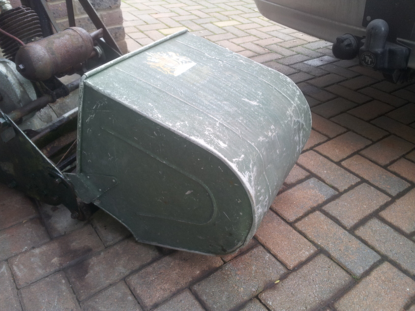

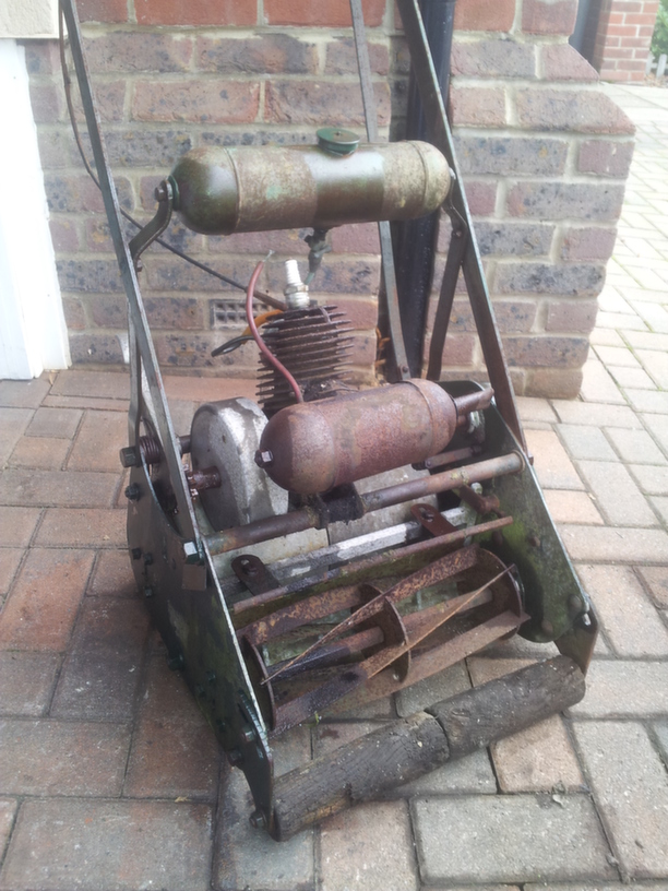

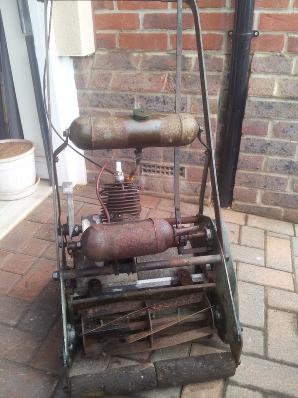

darmic1ParticipantWell, I’ve picked up the mower. Its in pretty good condition, the engine is free and turns nicely, it even has good compression. I am unable to try to start it at present as the fuel tank, tap and carb are gummed up. There is now neat petrol hopefully un-gumming everything. I’m going to strip the engine. just to make sure the rings are completely free and de-coked. Here’s a few pictures before I started to strip it down.

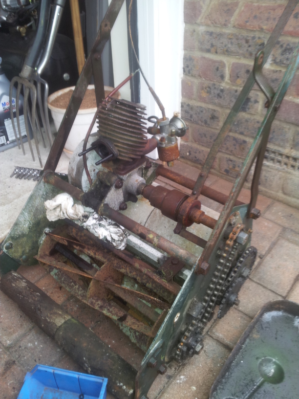

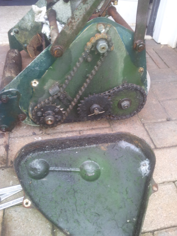

darmic1ParticipantStarting the strip down, discovered the chain which drives the rollers is missing, not sure this was removed to make this machine a push mower instead of driven. Here’s a couple of pictures showing the condition of the chain and sprockets. I think this machine has been re-painted previously, as the paint under the cover is quite a few shades lighter. I’m thinking the lighter colour is original Atco Green, its a slightly yellower green, almost a dirty green, if that makes sense.
