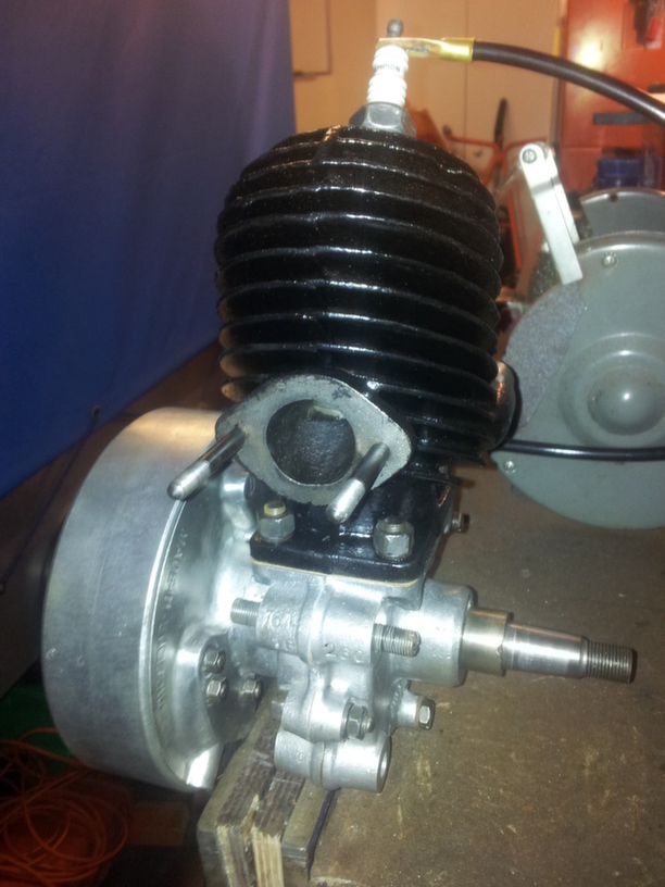

    I have to confess I did think that might be the result, because the cam is on the flywheel. Could the flywheel have been changed at some time, do other similar engines have the can lobe in a different position?
    #4372
    darmic1
    I dont know, bought the mower off the bay, so history unknown? I do remember having similar fun with the points on the Mk15 of the Bantam. If anyone has a manual for this engine and the mower, I would be extremely grateful!
    #4376
    The way you’ve got is how mine is.
    #4377
    Can’t help with a manual but for what it’s worth I have never seen a Villiers 2 stroke mag with the points anywhere other than roughly the 7 o’clock position, the coil at 12 and the HT lead exiting at about 1.

    darmic1
    Been busy this evening. The engine is back together, timing set, points adjusted……. and it runs!!! A little squirt of 2 stroke into the inlet, a quick spin of the flywheel and away it went first time.

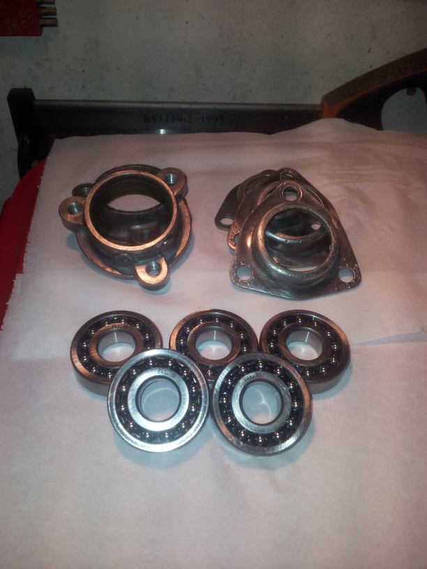

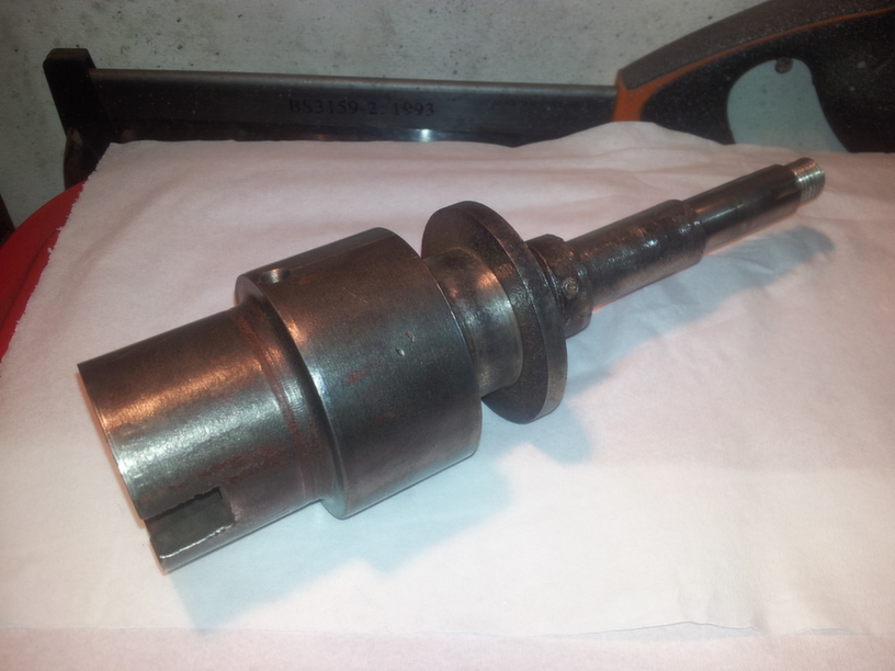

    #4438
    darmic1
    Picked up the new bearings too, cleaned the bearing carriers. Took the clutch apart, cleaned and reassembled it.

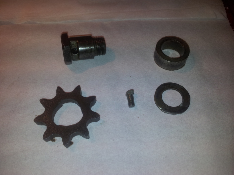

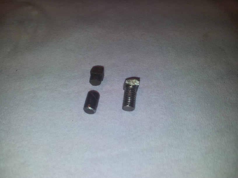

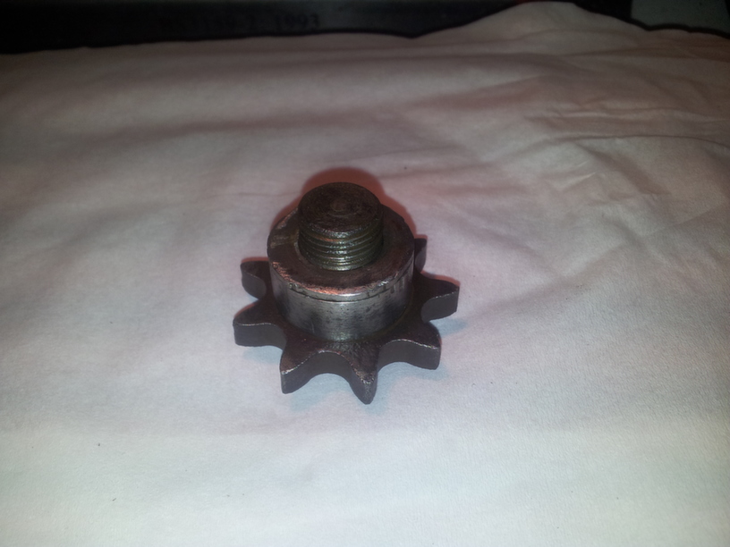

    #4441
    darmic1
    Then tackled the seized starter gear….. Managed to get it apart, to find the peg which engages the gear, but allows the kick start to return was in 2 pieces. Found a stainless steel bolt the same diameter, ground and filed the head down to match the broken piece, then cut to length. Its not the prettiest part, but it works…..
