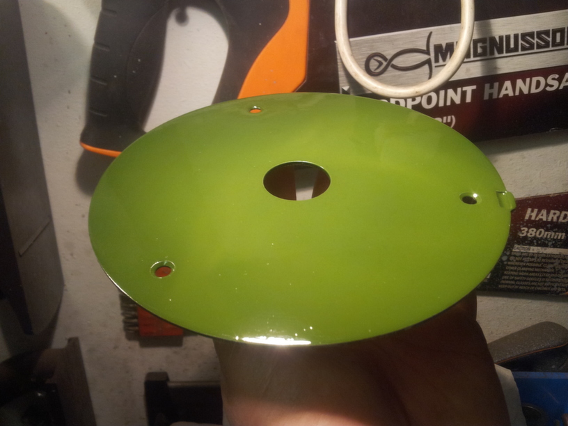

    darmic1
    Some paint at last!!! Here’s the colour, under a spot lamp and normal lighting.

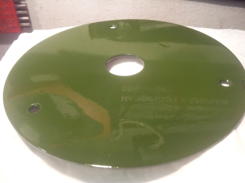

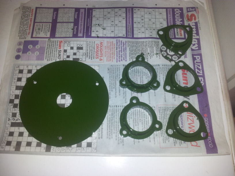

    darmic1
    So I got some painting done this evening. The bearing carriers and the flywheel cover, I know this wouldn’t have been painted originally but it was quite badly scratched up.

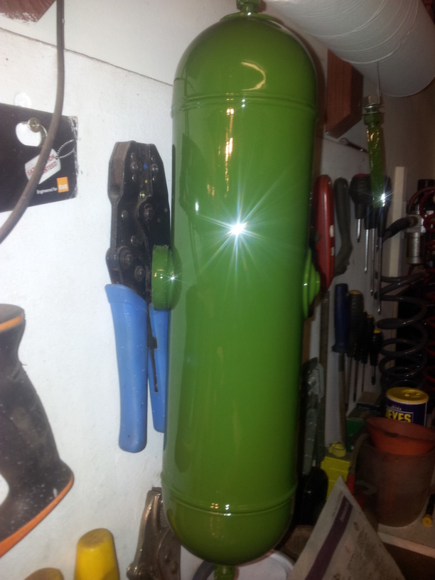

    The fuel tank has come out really well, no signs at all of the 5 dents which were in it!

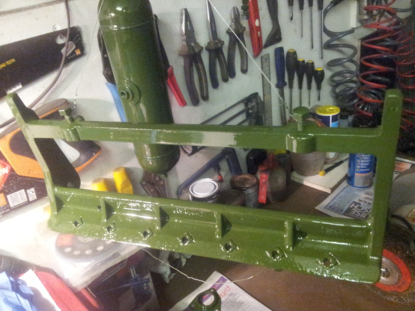

    darmic1
    And the frame for the bottom blade…… A new blade and screws was ordered today too.

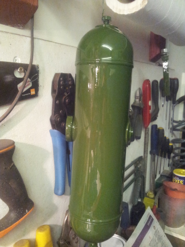

    Here’s the tank in daylight…..

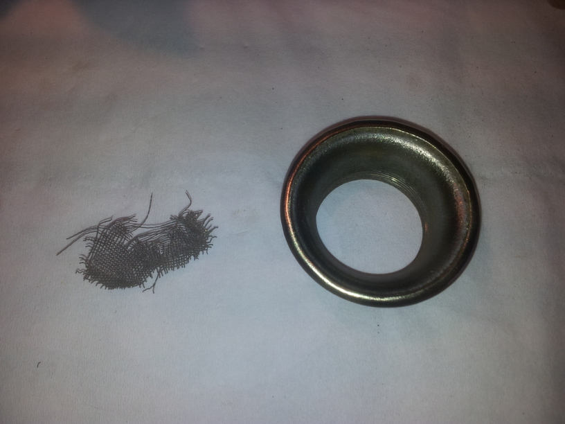

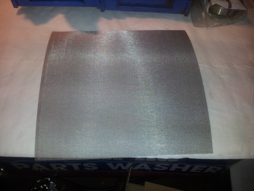

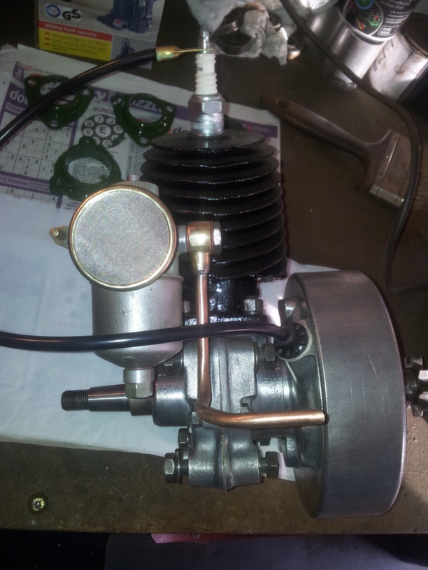

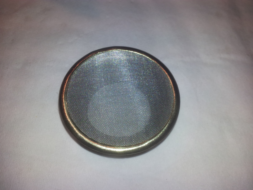

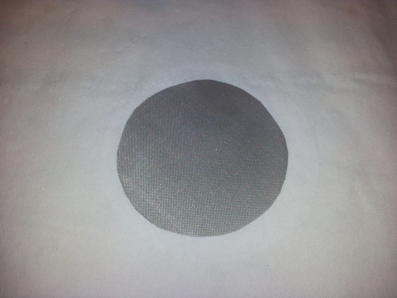

    Replaced the damaged gauze air filter today. Used a very thin screwdriver to prise up the brass lip holding the gauze in place, then removed the old bit. Cut out the new piece from the sheet and placed in under the lip. Turned the piece over, so the gauze side was face down and tapped all around the back applying pressure all the time. Here are the pictures and it refitted to the carb.

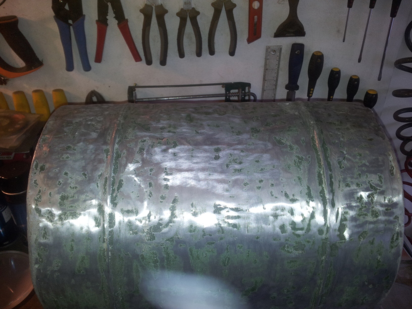

    darmic1

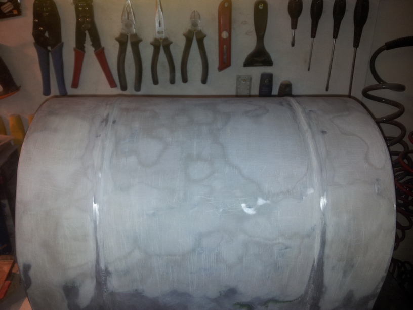

    Made a start on the grass box today. It looked reasonably straight, however, running a hand over the surface proved otherwise. So to start with I removed as much paint as possible, then using hammer and dolly set about removing the largest of the dents. Unfortunately I don’t have a shrinking hammer or dolly so had to leave the minor dents as was, these will be smoothed with filler.
