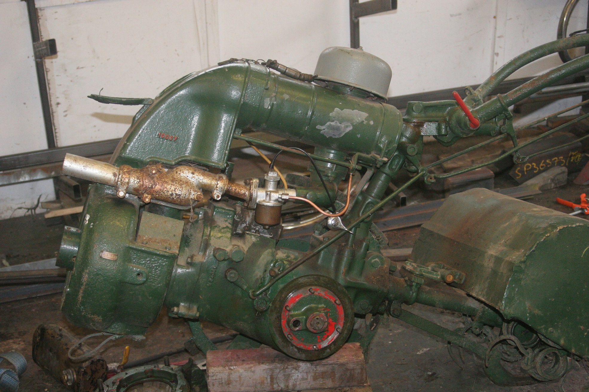

vhgmcbuddyMemberApologies for dredging up an old thread, but, nearly nine months after purchase…
…it runs!
Now the engine is known to be sound I can begin working through the rest of the issues!
January 28, 2021 at 8:36 am #36519
charlieKeymasterSounds good. What did you have to do to get it running?
Is that a Rototiller 35 I saw in the videoJanuary 28, 2021 at 8:50 am #36520ted20
Participantthat looked a painful way to stop it, sounds nice
January 28, 2021 at 6:02 pm #36521
vhgmcbuddyMemberCharlie, actually very little the end, I resorted to robbing the Wico mag from Roland the headless 35, until such a time as I can afford to have the old Lucas properly rebuilt. Aside from that, the usual rigmarole, carb strip and clean, filled the gearbox with oil and away she went! That exhaust pipe is frantically loud, the video does it no justice. I assume it ought to have the normal flattened style?
Ted, painful indeed, my Jerry rigged throttle cable, borrowed from a Seagull outboard motor jammed and I had to get it stopped in a hurry. You can see when I caught a real belt off the HT lead by the way the pliers go on the floor!
January 29, 2021 at 8:12 am #36523
charlieKeymasterMike I may have a drawing for the exhaust, let me know if you would like a copy.
Rather than pull the lead off push pliers tight onto cylinder head then whilst applying pressure touch them against plug top a lot less painful. That is how I stop my Trusty Earthquake.January 29, 2021 at 5:00 pm #36531
vhgmcbuddyMemberA drawing for the exhaust would be great! Shall I PM you an email address?
Of course that would have been a much more sensible course of action, even better would have been to just press the stop button on the Wico mag, but alas all these sensible thoughts go out the window when one is fearing for the life of the engine!

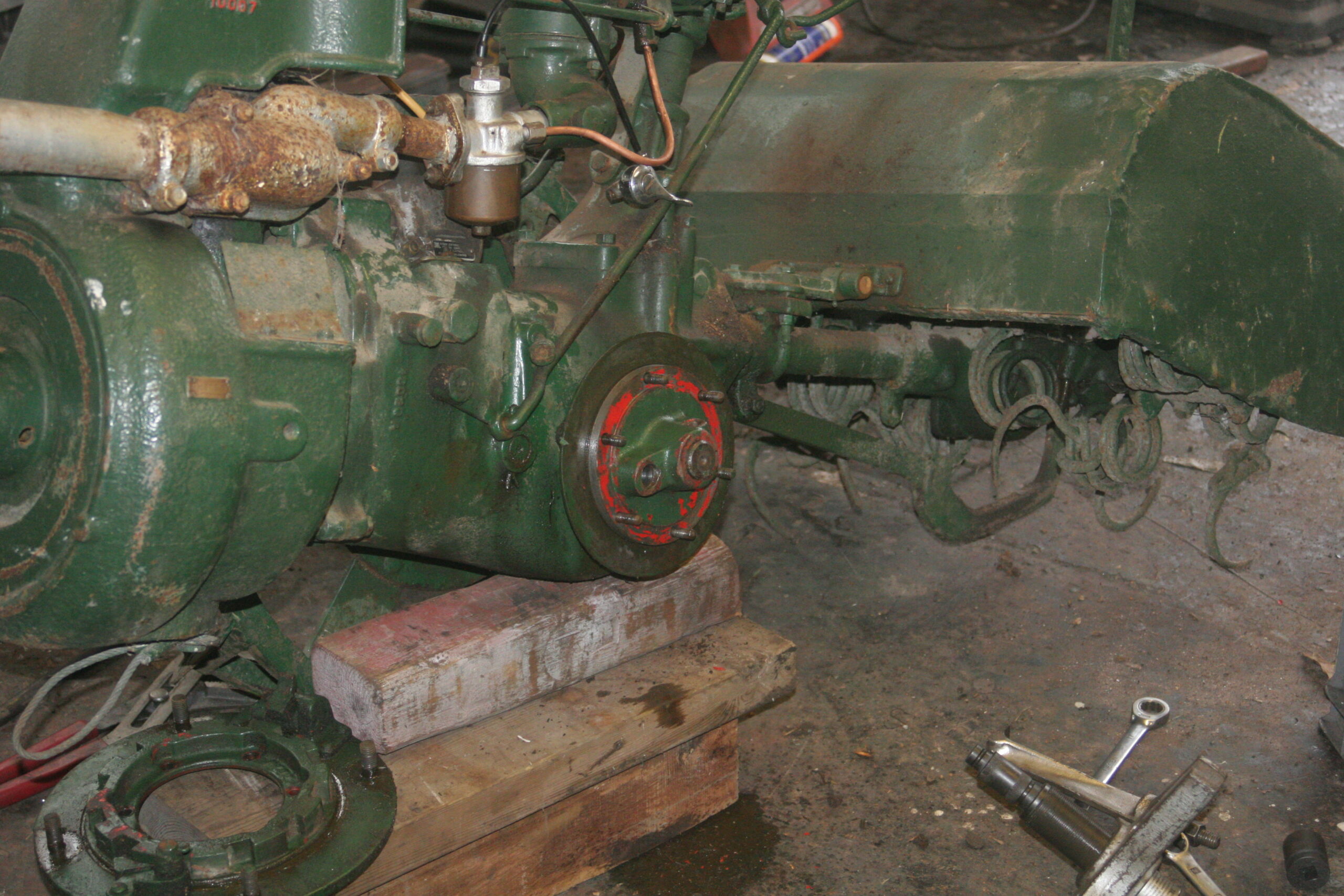

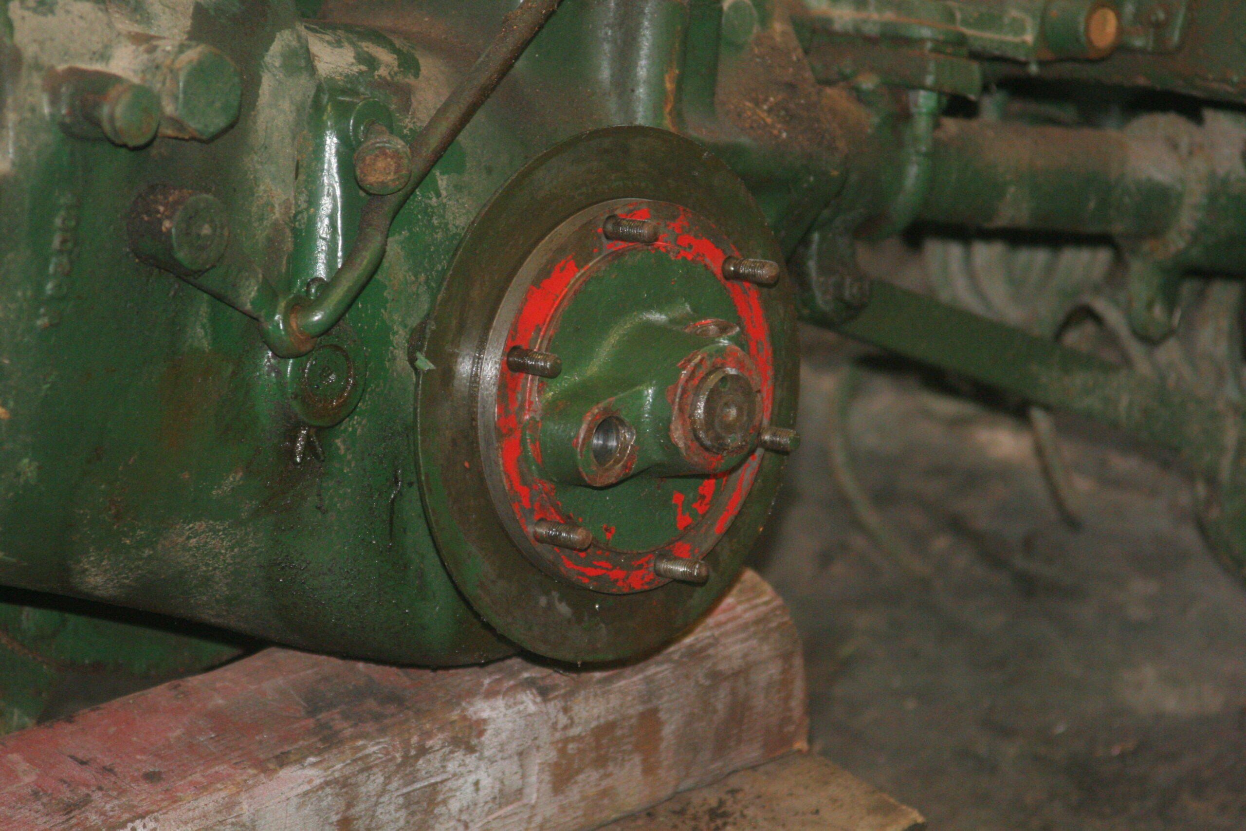

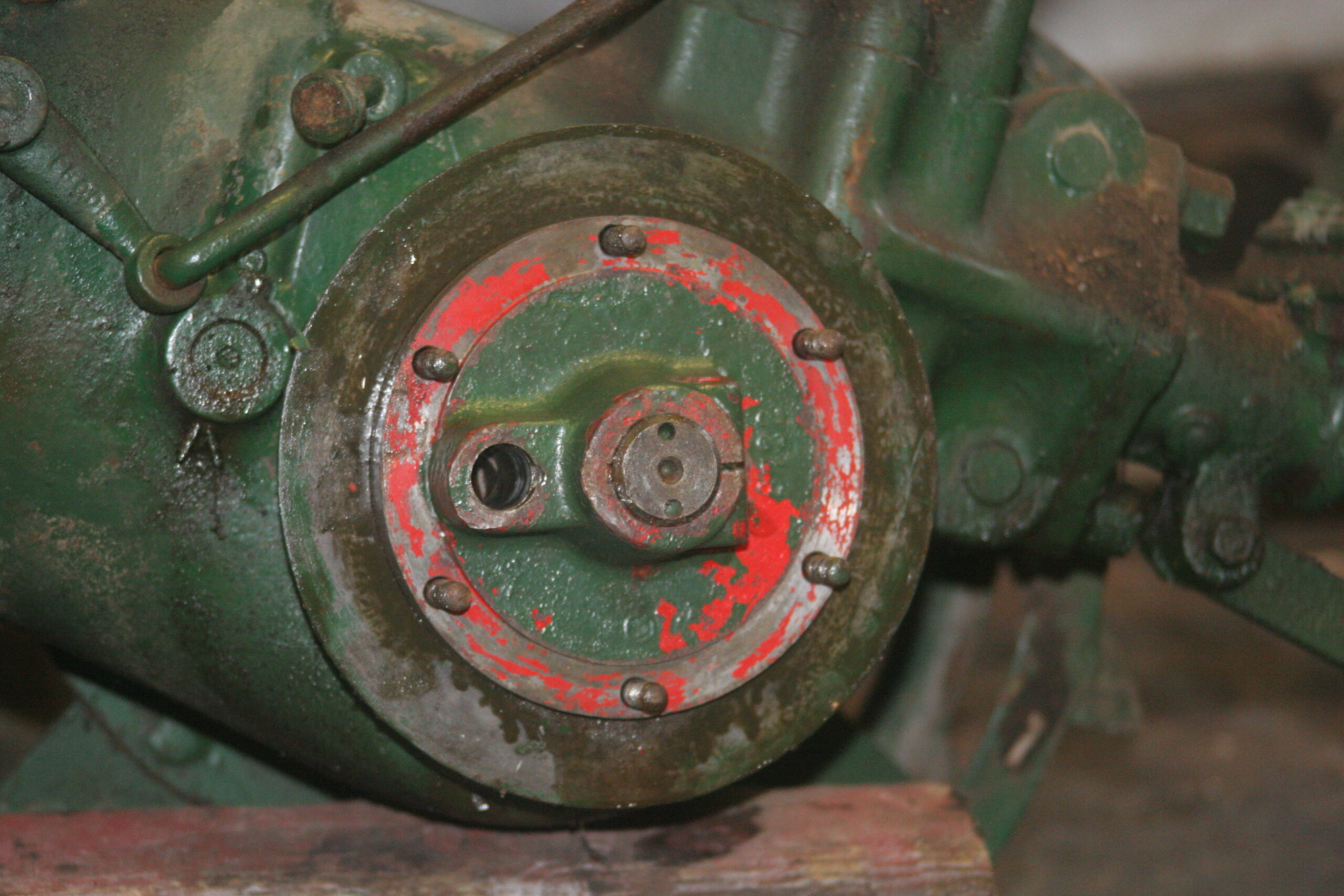

I’ve stripped the hubs to cure the very stiff/seized drive pins, all back in one piece now, just waiting on some parts to make a throttle cable and it’ll be time to see how it turns the soil!

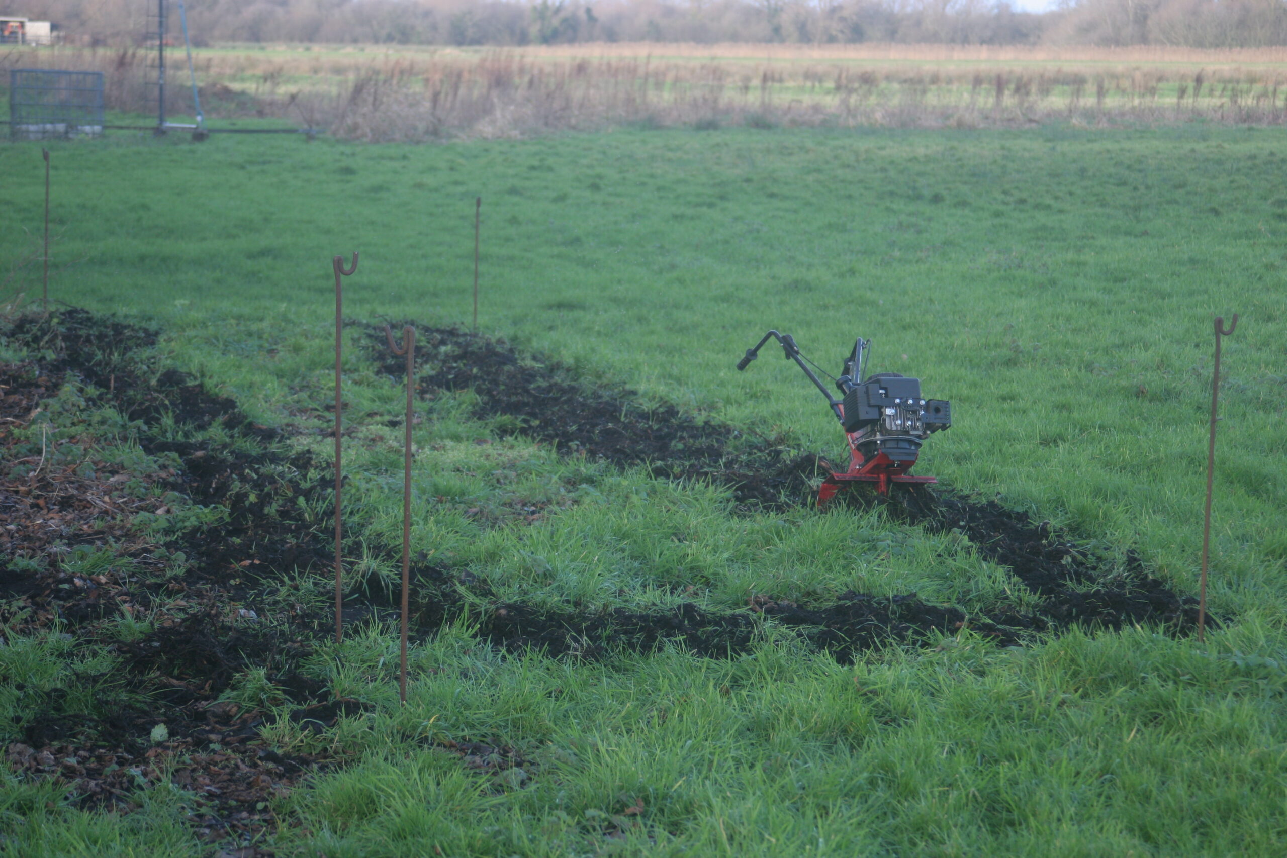

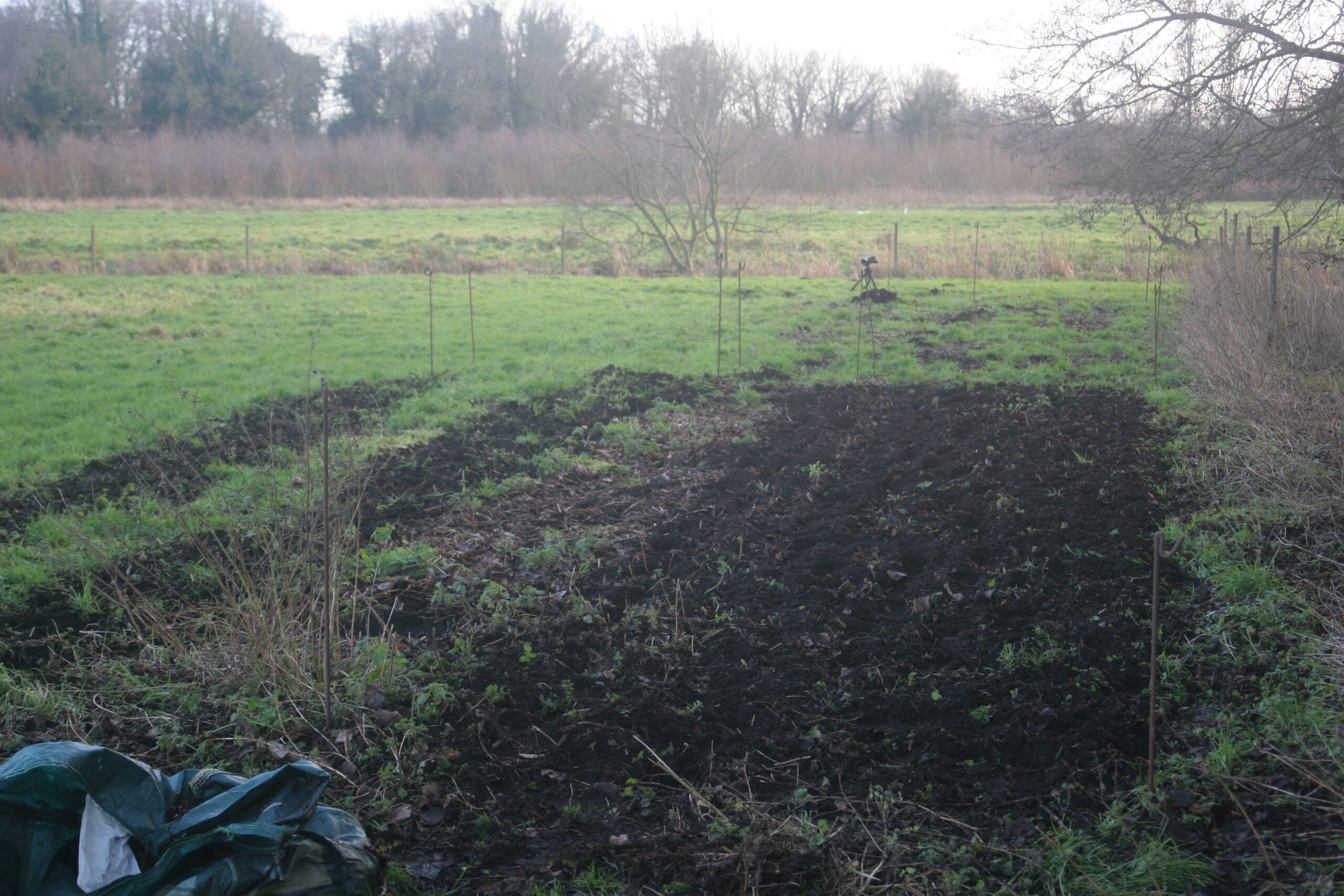

charlieKeymasterSo long as the ground is not too wet you will find it produces a very tilth.

vhgmcbuddyMemberJanuary 30, 2021 at 9:54 am #36544
vhgmcbuddyMemberIs there much to choose between the “wire” type tines and the “slasher” ones?
January 30, 2021 at 2:38 pm #36545
charlieKeymasterI have the wire tines on my 56, not used the slasher type although they are very similar to normal digging tines on MonroTillers. On the Rototiller the springs are different for wire and slasher tines, the later have a casting that sits inside the loop of the spring. The wire tines are prone to straightening out if they catch on a tree root and are almost impossible to bend back into shape.
January 30, 2021 at 4:46 pm #36546
vhgmcbuddyMemberWell I don’t think I should be encountering any tree roots, fingers crossed!
Does the gearbox in the middle of the miller unit share oil with the main gearbox or is it filled separately?
January 30, 2021 at 9:34 pm #36553
vhgmcbuddyMemberShould any of you wish to view the whole process of torturing the Simar back into life, here’s an extended cut of the video:
I know easy start is naughty, but used as a diagnostic tool it has it’s place… The issue which necessitated it’s usage was a vacuum leak between the choke butterfly and the carb, meaning the engine couldn’t be effectively choked. I have now rectified this!
