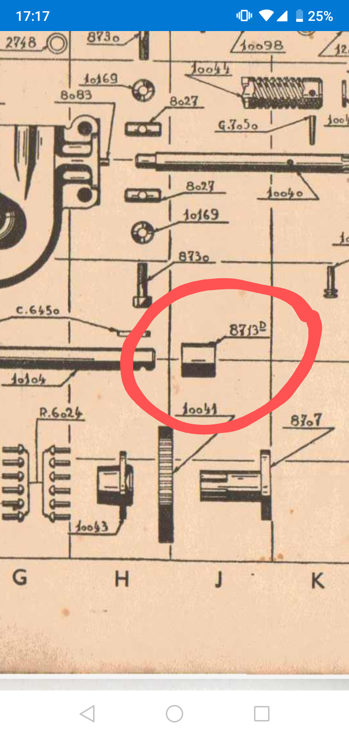

vhgmcbuddyMemberI’ve been referring to Sean’s thread, it’s a great insight into the inner workings! The deeper I dig into these machines the more I appreciate the way they’re made! Would be good to see you out and about, fingers crossed we don’t have to stay confined to quarters too much longer!

charlieKeymasterA quick look at parts books and numbers are different for 50 and 56, also checked list of drawings and could not see that part number.
The machines are metric, nuts bolts etc.May 5, 2020 at 3:25 pm #34207
roatavatorParticipantMike
Might the part number be 8713d? I think I’ve found the part you’re referring to in a parts list on the French siteMay 5, 2020 at 4:15 pm #34208

charlieKeymasterI spotted that when I looked. Note part numbers with a suffix of D or G indicates Right (droite) and Left (gauche).

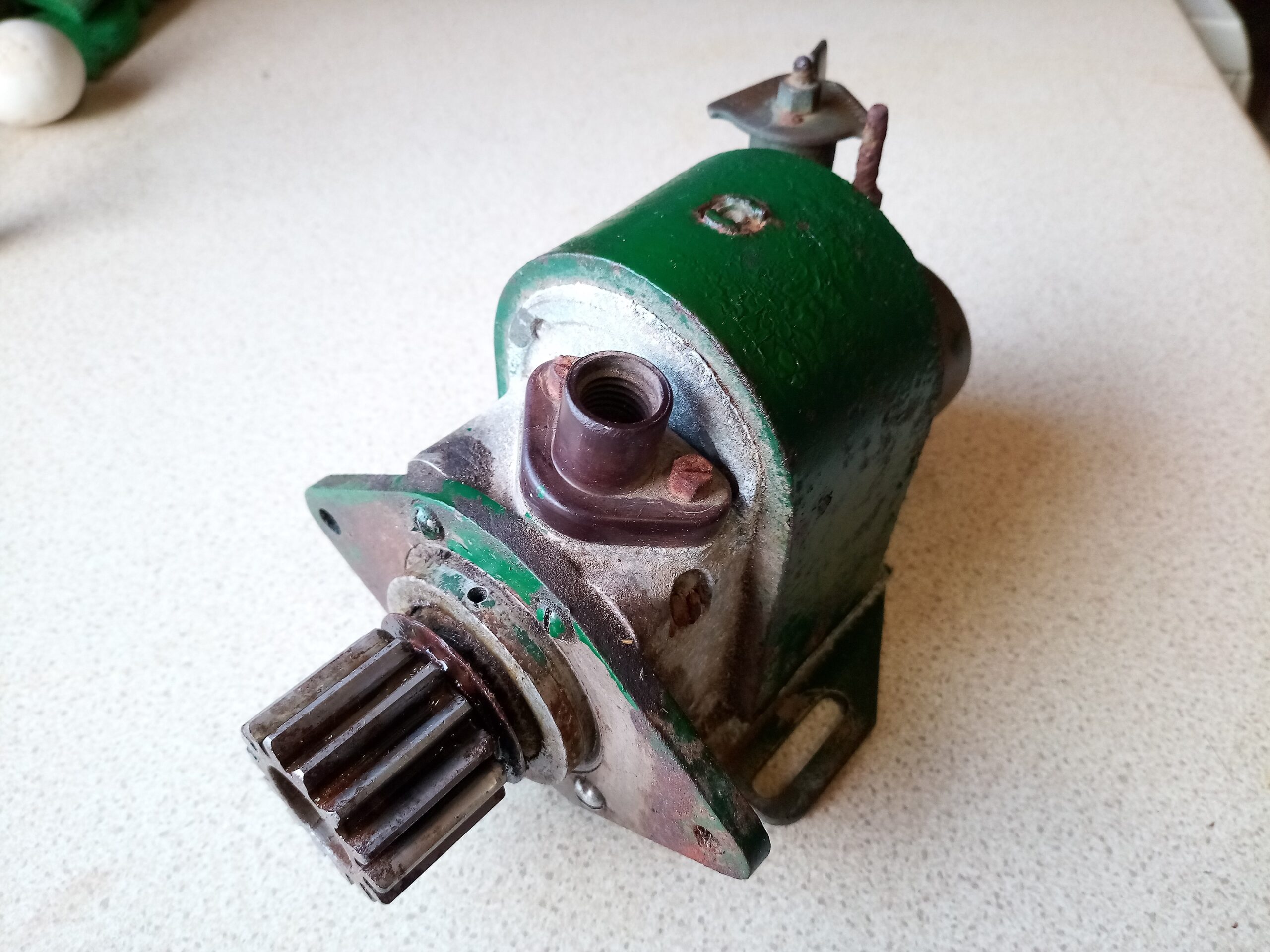

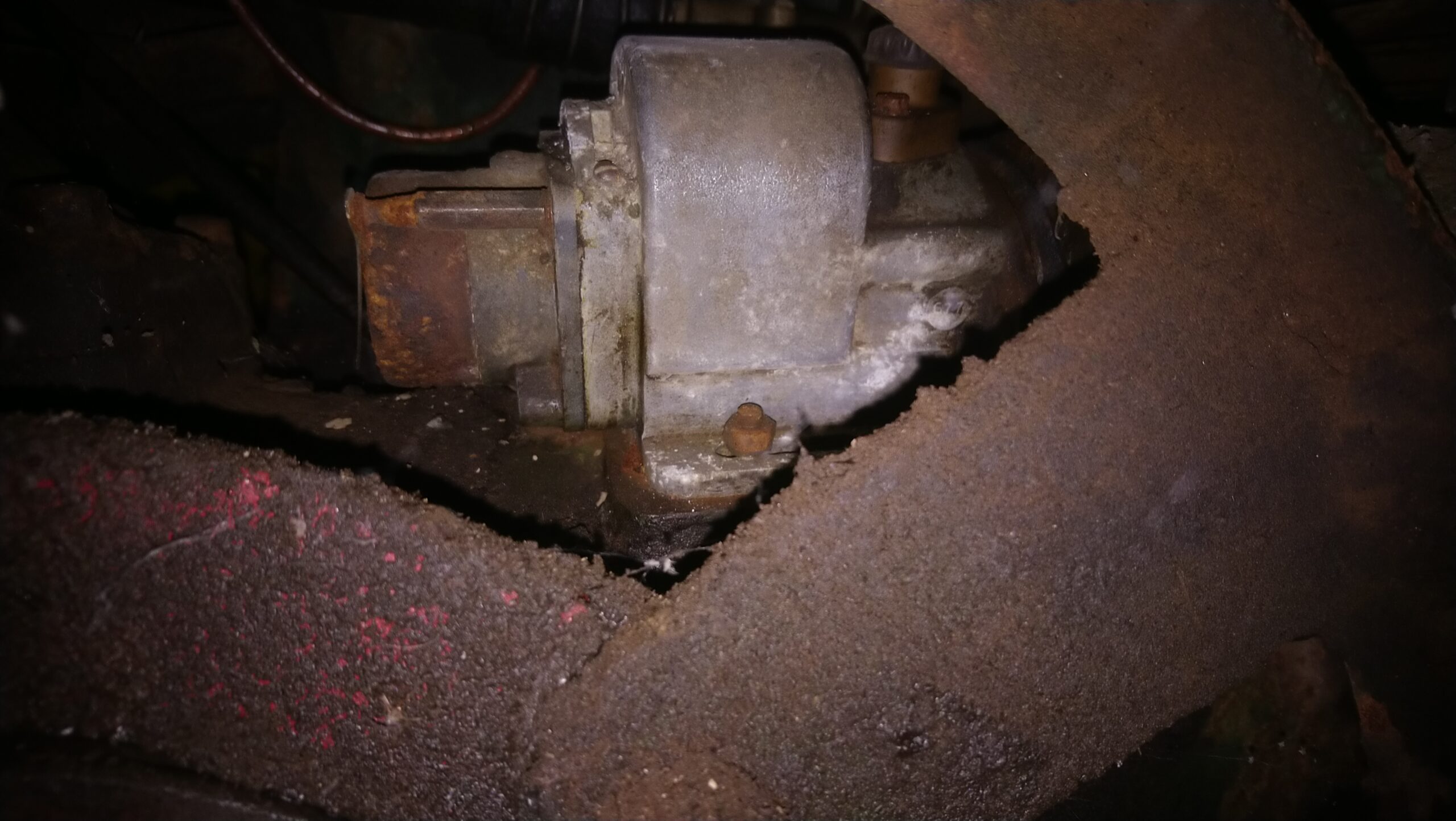

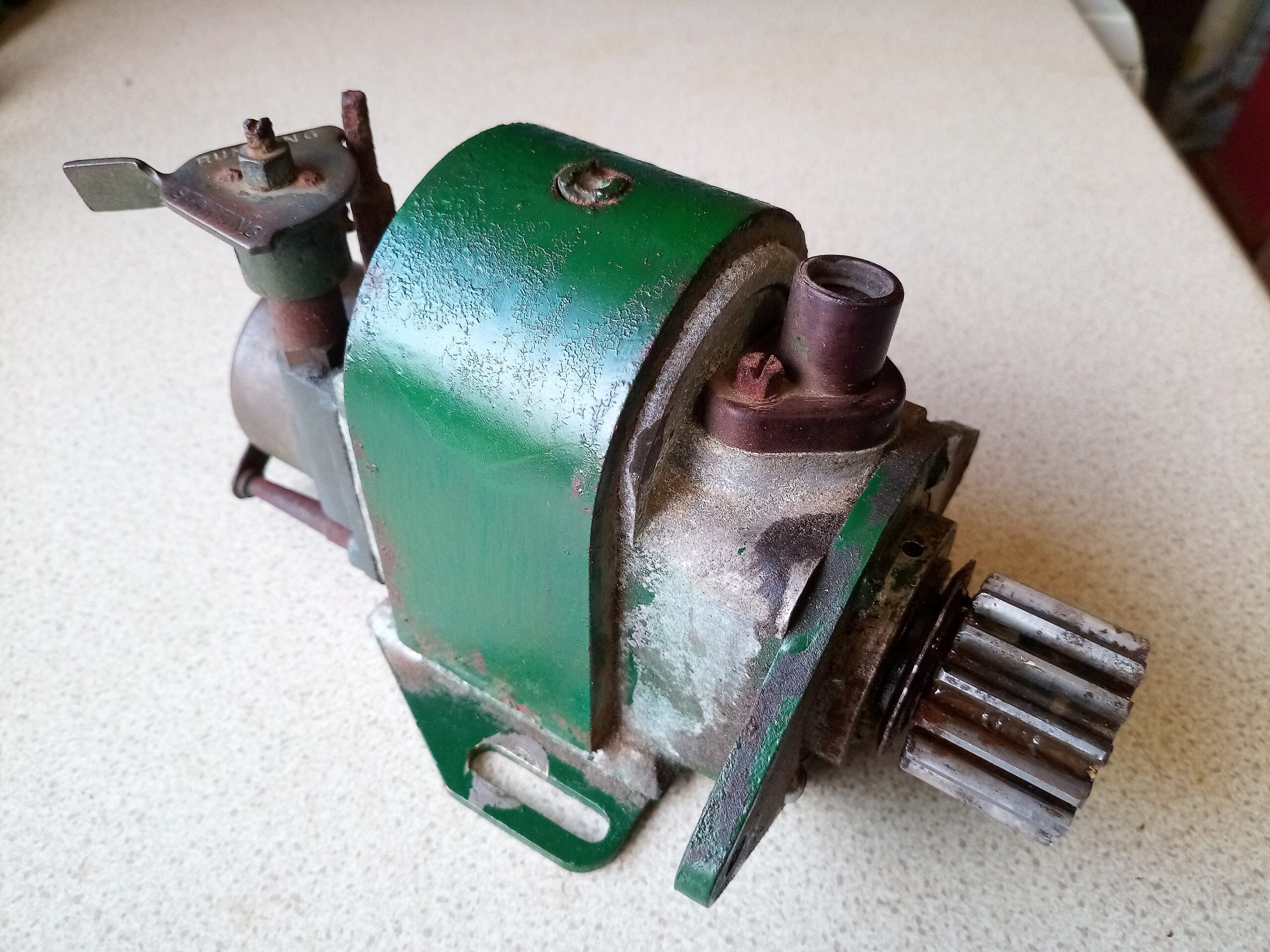

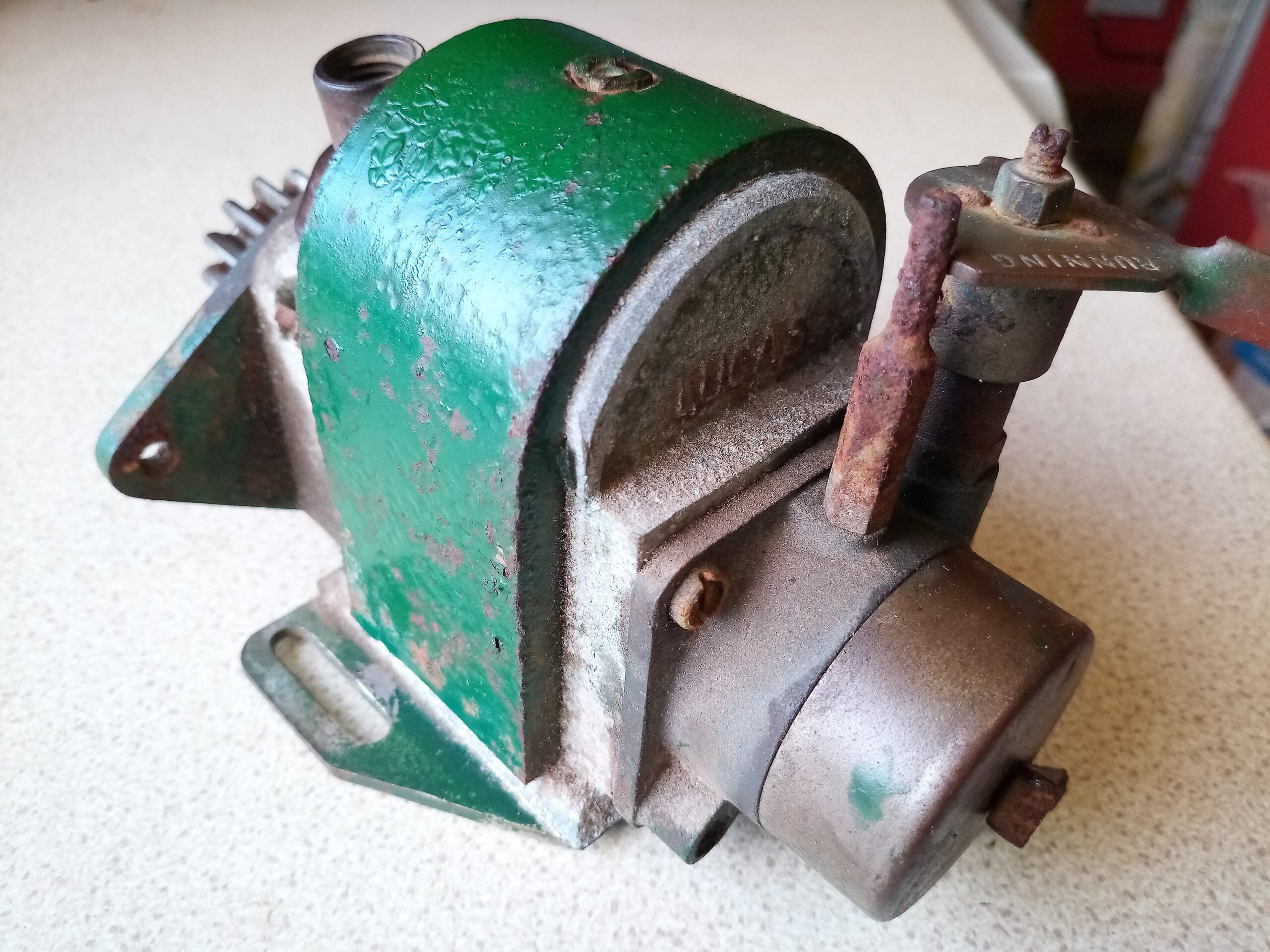

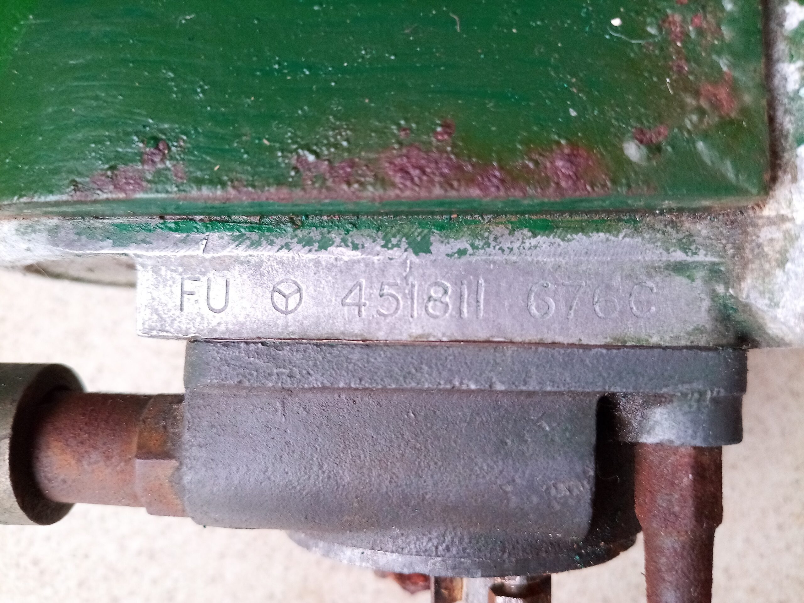

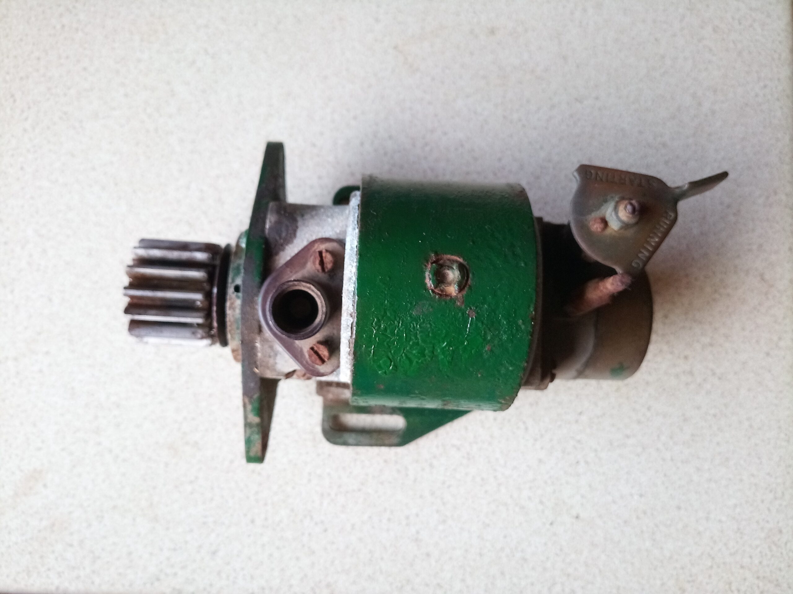

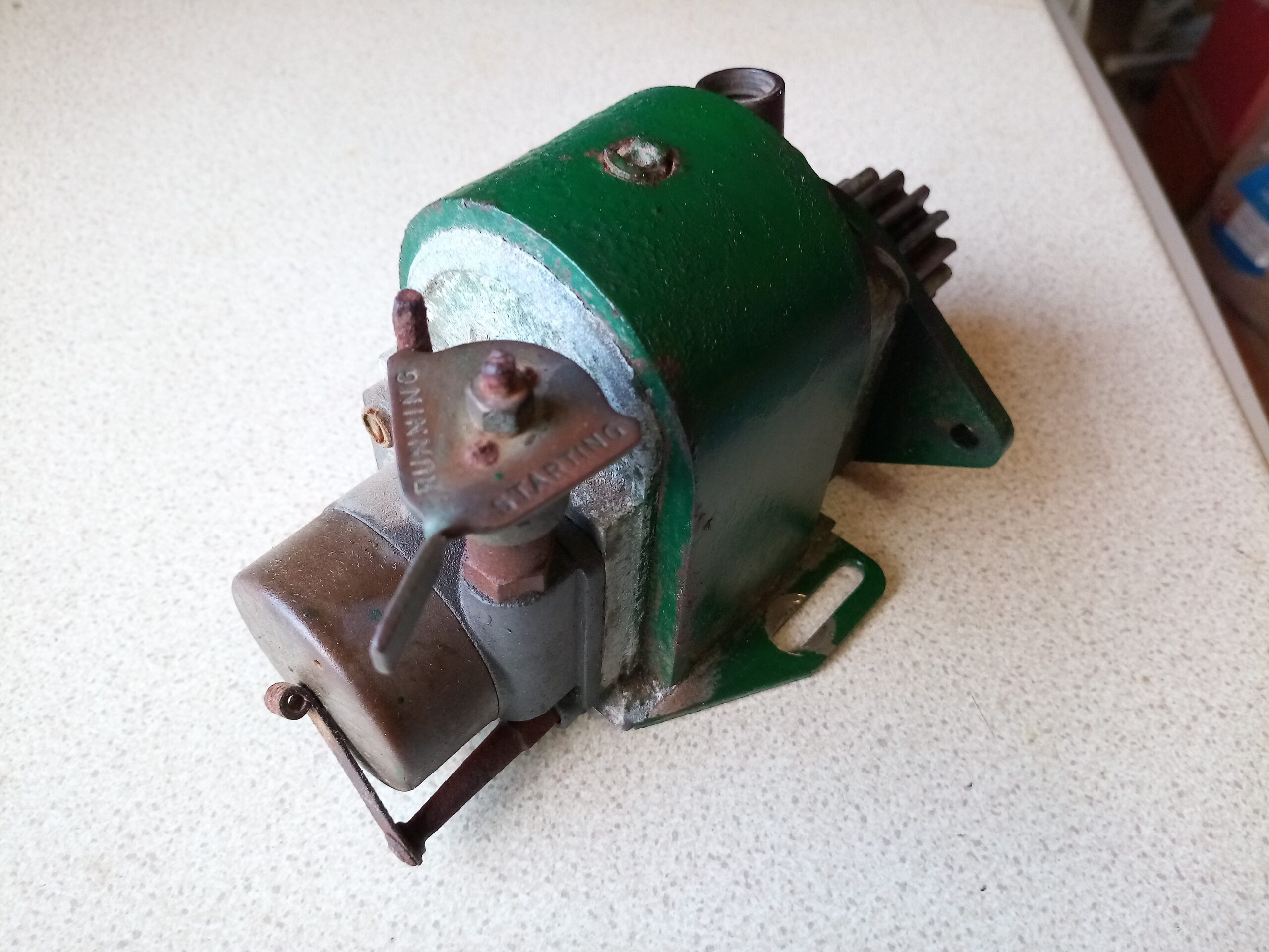

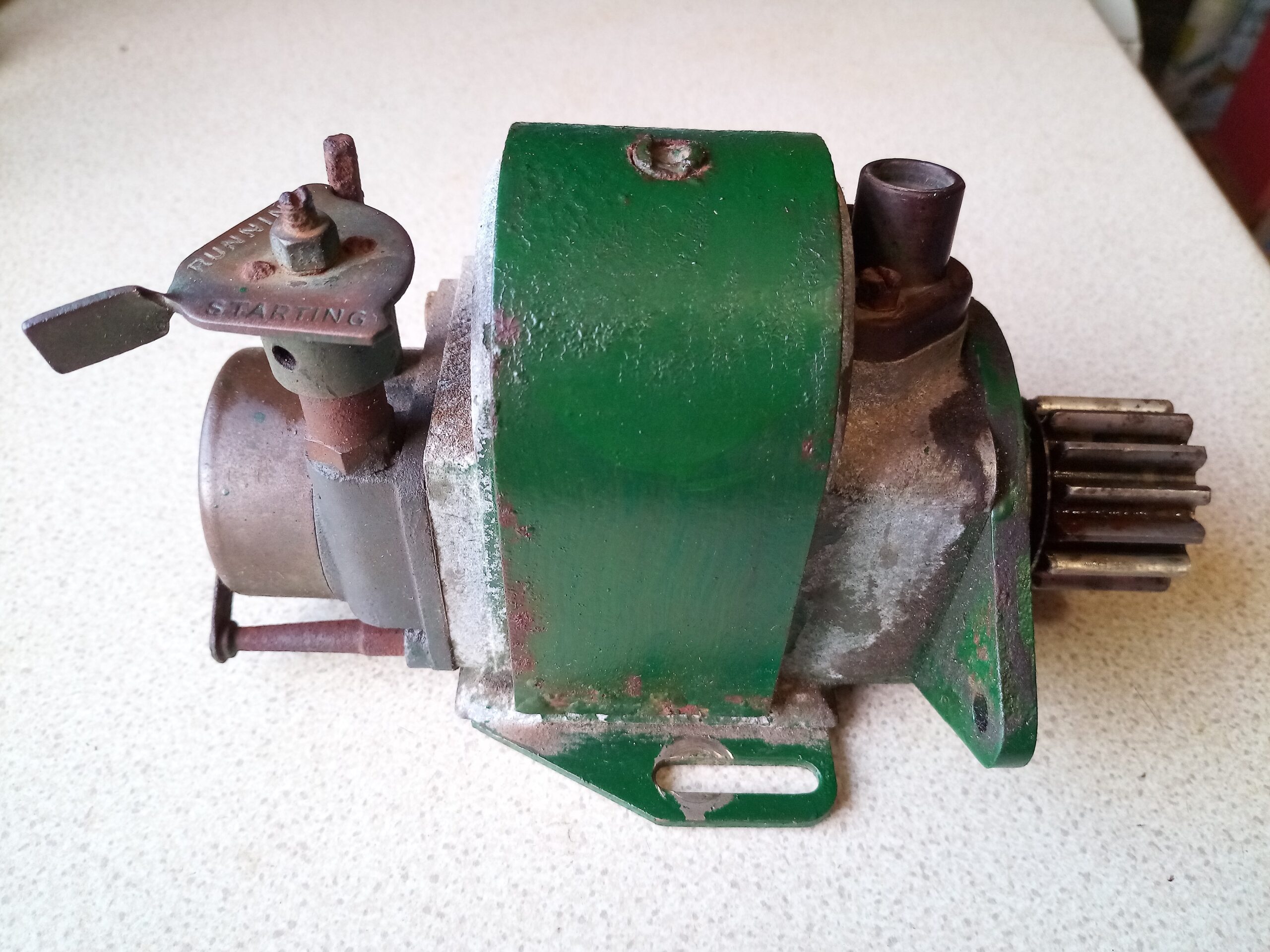

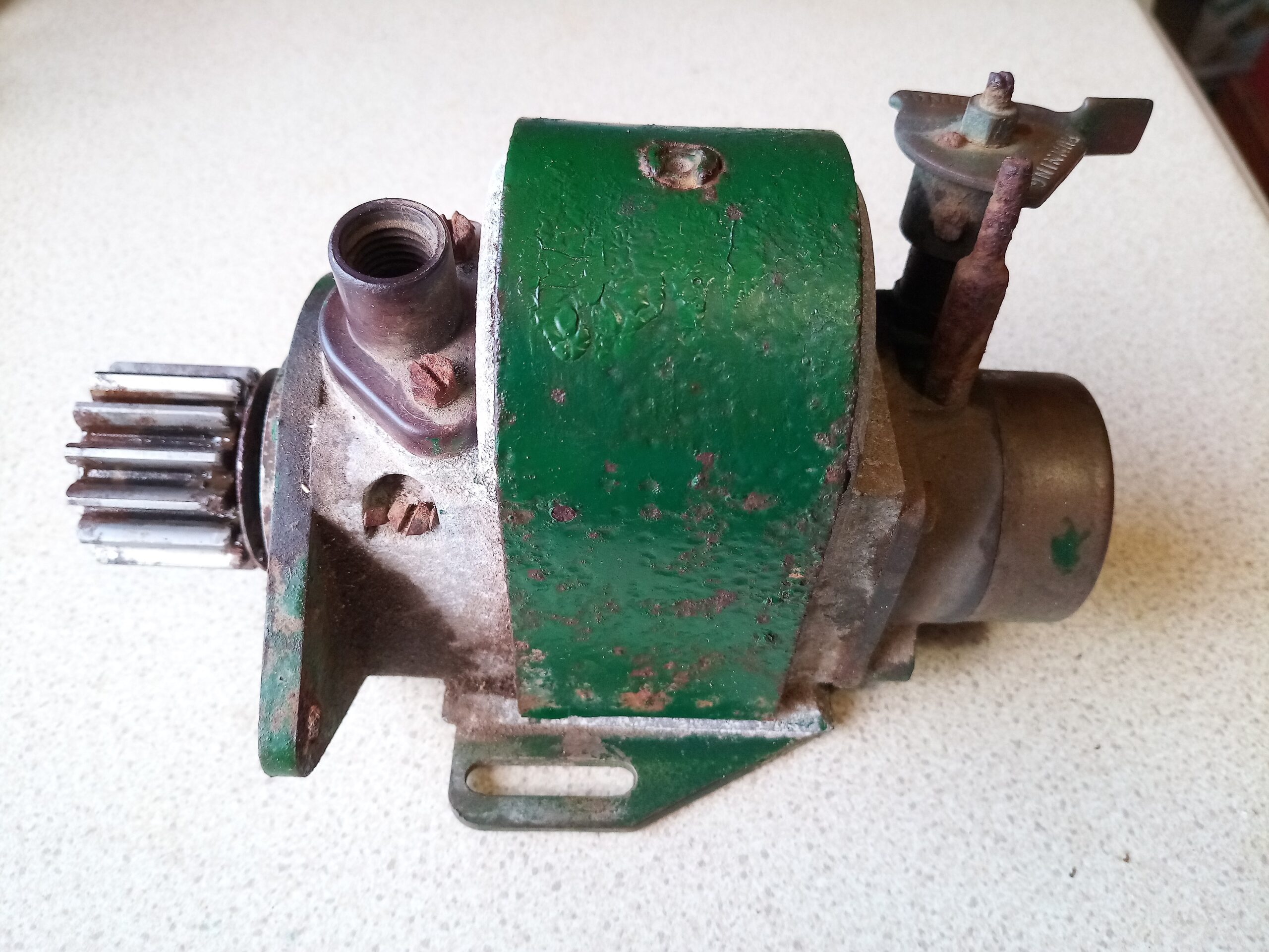

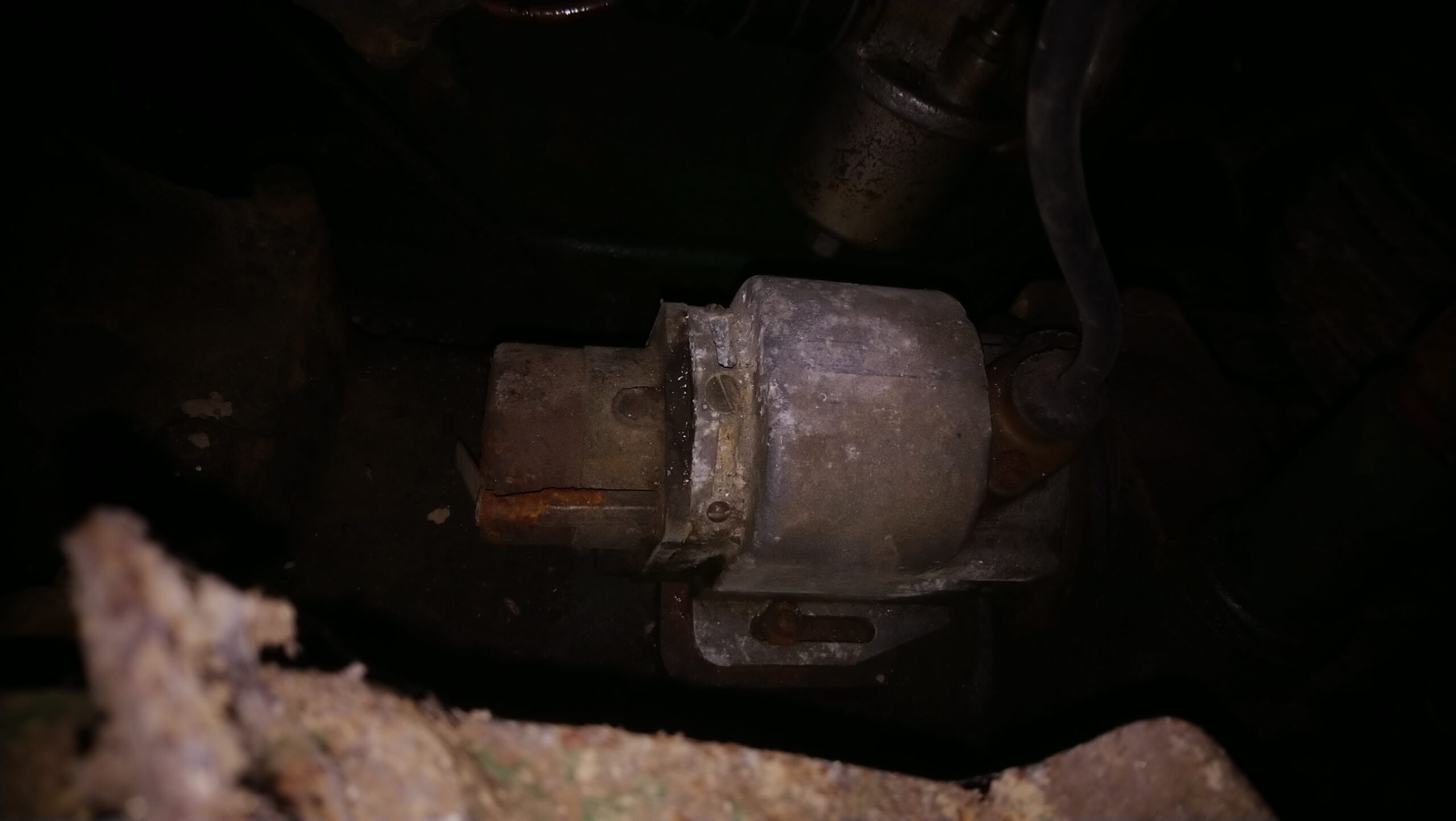

vhgmcbuddyMemberSo, things aren’t looking too good with regards to the magneto, popped the cover off to check the points today and was greeted by a rusty corroded mess.
Still can’t identify which Lucas magneto it actually is, even after hours of trawling through websites, which makes trying to find parts nigh on impossible. I have emailed several firms offering overhauls, looking forward to some eye-watering quotes after the weekend 😀
If any of you good people have an idea as to which mag this thing is I’d be super pleased to hear! As is so often the case when googling anything Villiers, amal, jap, Lucas etc there is an impenetrable mass of information pertaining only to motorcycles out there, everything else seems to fall through the cracks. Still, such is the joy of playing with this old stuff!
May 9, 2020 at 10:49 pm #34276
vhgmcbuddyMemberPS, if anyone has a type 50 (or any other simar, all comparisons welcome) handy I’d be really interested to see how the mag is mounted. Mine was bolted down by it’s baseplate onto studs in the top of the gearbox casting, but also has a face plate fitted as if for flange mounting, but this was not connected to anything… See photos in previous post!
