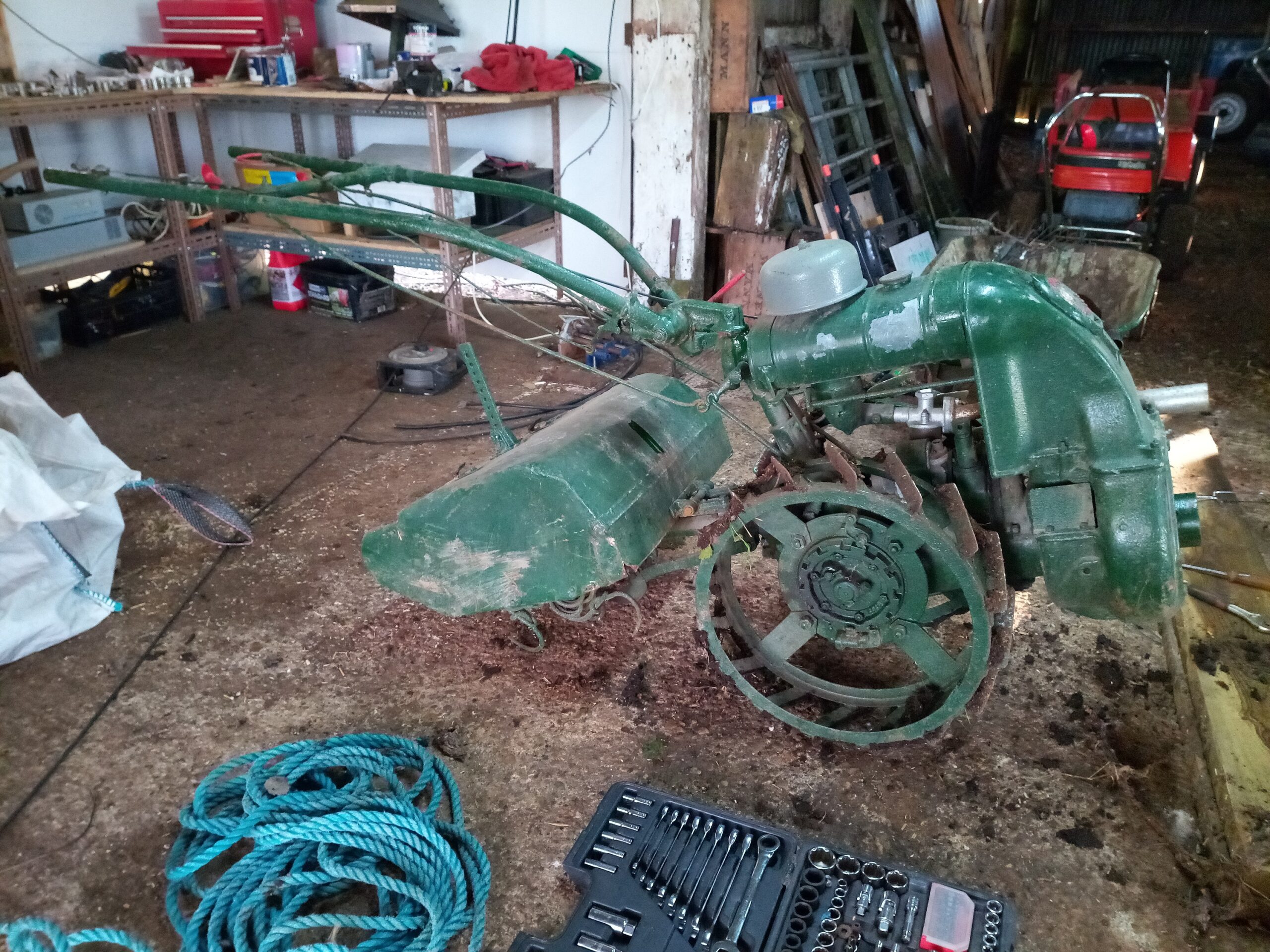

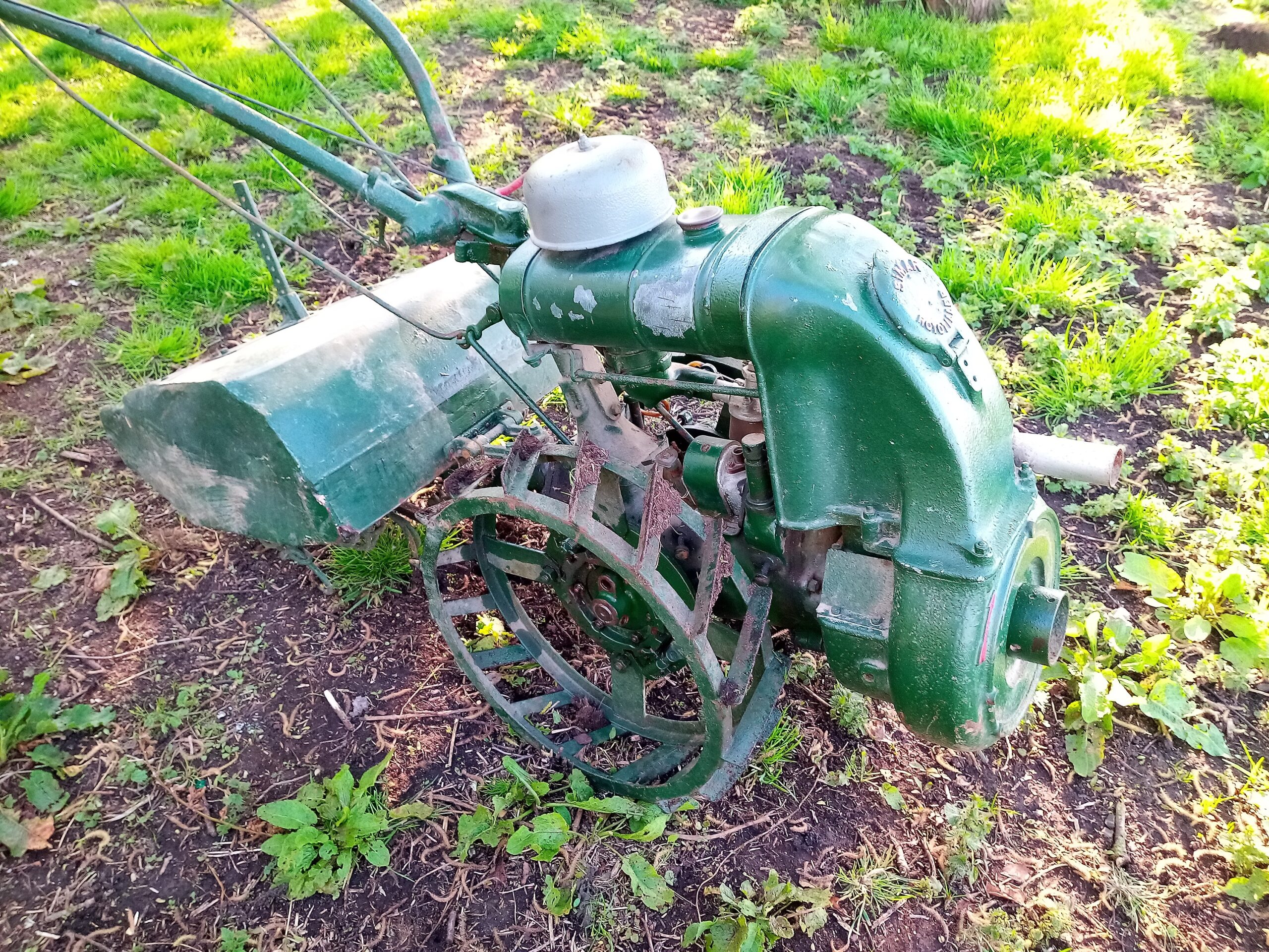

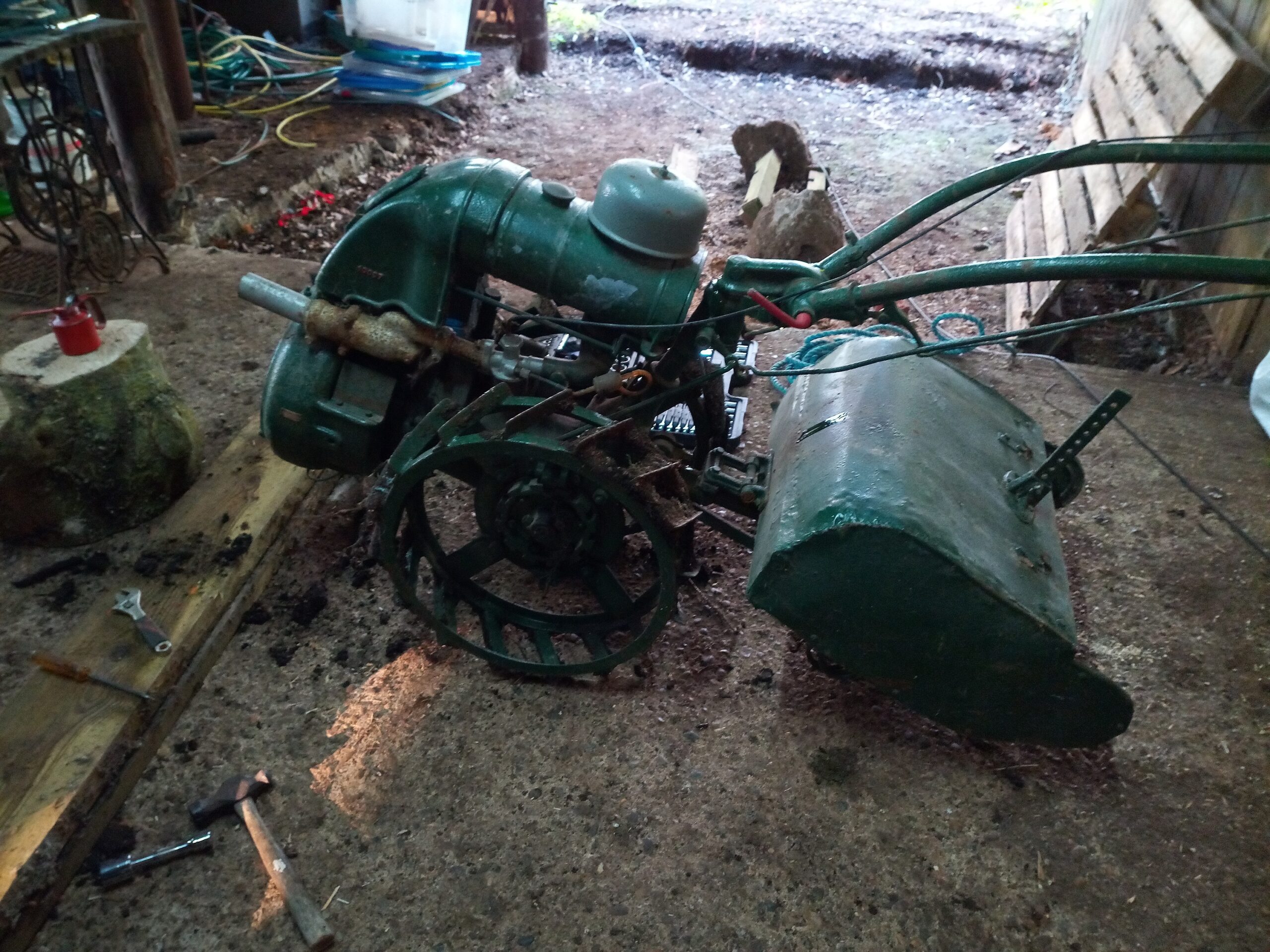

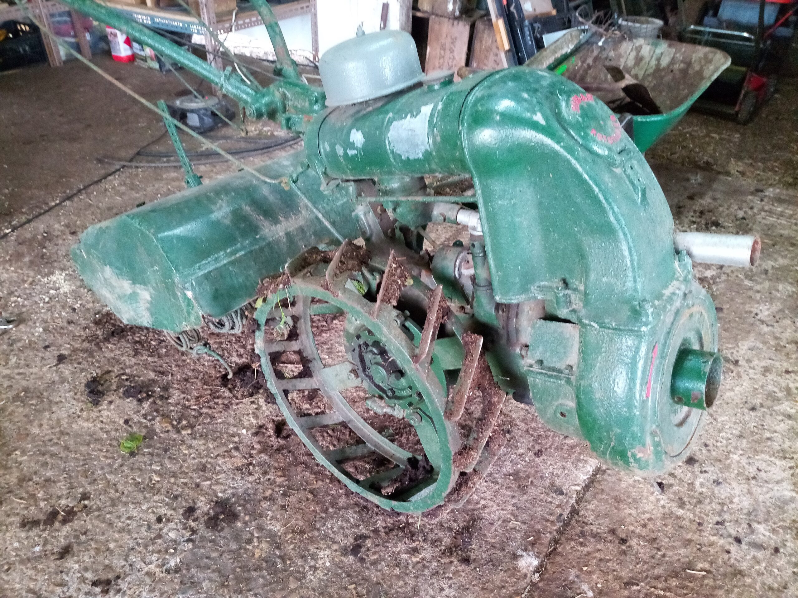

Picked up a SIMAR tiller today, my first one, so there are bound to be plenty of daft questions. The first, and possibly most daft of all is:
What have I bought?! Best guess from looking through the excellent french website is that it may be a C50… Bigger than a 35, smaller than a 56, no reverse gear etc.

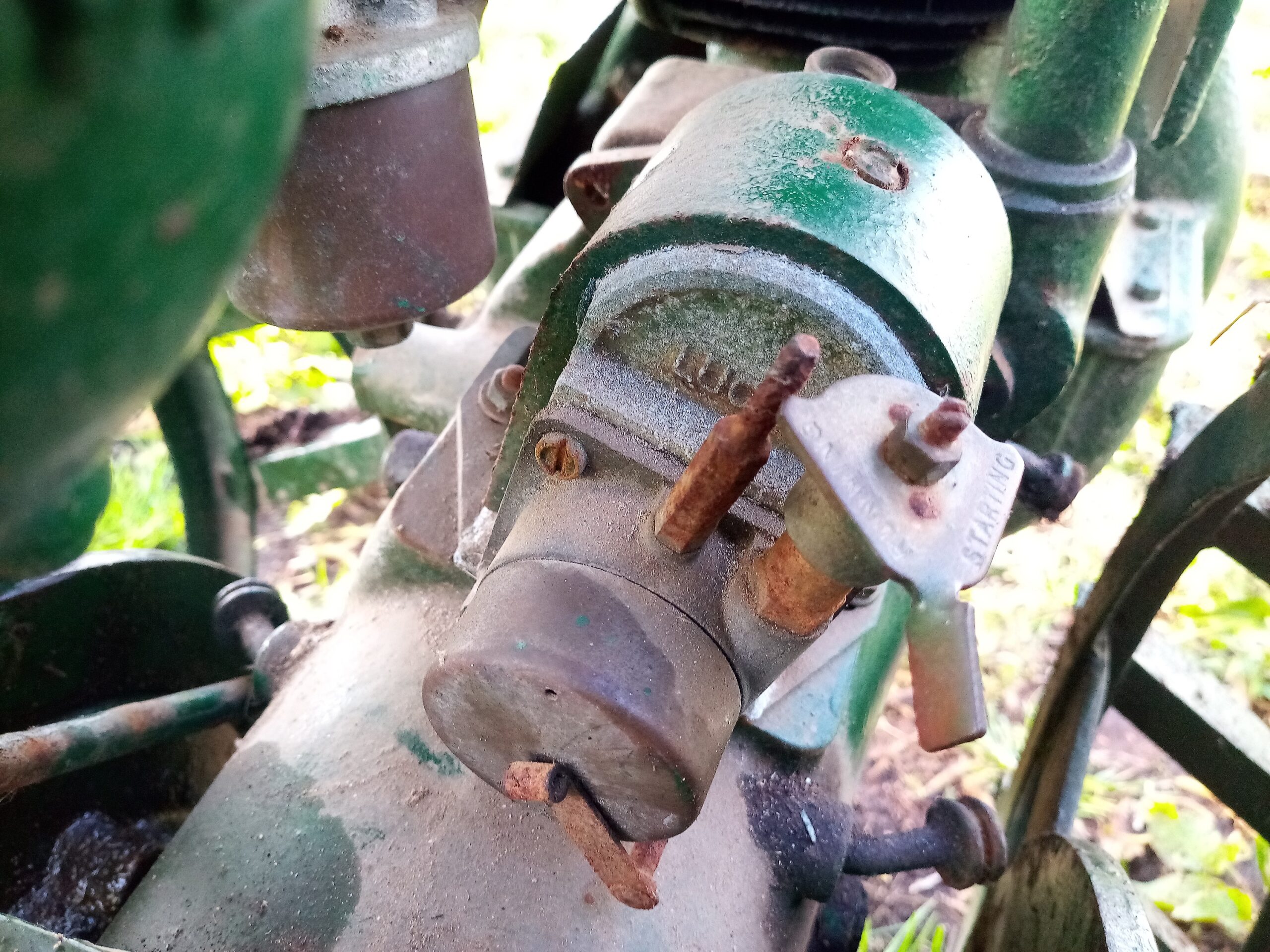

Next question is of it’s origins. No mention of “British” on the spark plug cover, but sporting a Lucas magneto. So I’m assuming it is a British built machine?!
Only had it home a few hours but aside from a few small bits, most importantly an HT lead, it seems fairly tidy, clutches work well. But one drive pin is very stuck, penetrating oil is currently doing it’s thing!
Any thoughts or suggestions would be very much appreciated 😀
Apologies for photo quality, I’ll drag it outside and get some better ones tomorrow if you chaps are interested!

charlieKeymasterWelcome back. You have come to the right place, SIMAR and Geo Monro are my speciality.
Your machine is a model 50 and would have been made in Switzerland, only the 35 and 56 were British built. The 50 is almost the same as a 56, the major difference is the 56 has an additional segment in the gearbox between engine and main gearbox, which houses the reverse gear. The clutches are dog clutches so have little to go wrong with them. The drive pins are different lengths, depending on which wheel the longer one is in determines which gear is selected, high or low, so I am guessing it is the longer pin that is stuck.
If you require operators manual or parts manual let me know your e mail address via a personal message.
I see the miller cover looks as if it has been repaired or fabricated at some time.May 3, 2020 at 1:51 pm #34130

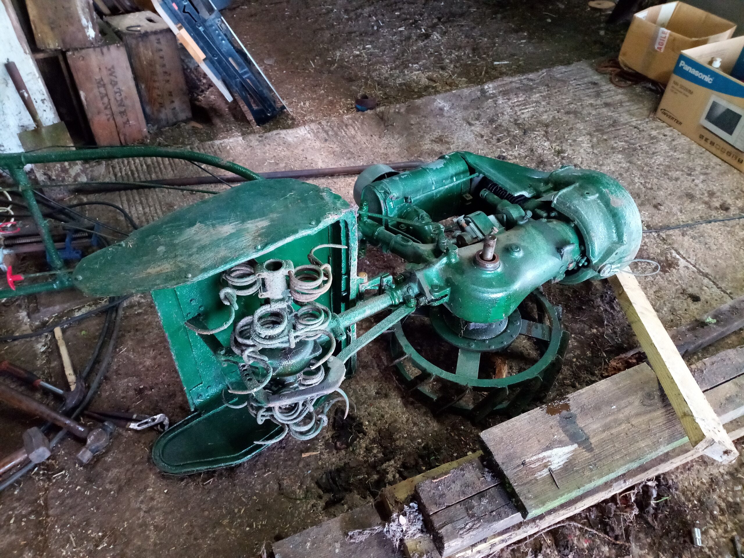

It is indeed the long pin that’s stuck, but not totally, when I first wheeled it off the trailer is was semi engaged in the drive hub which lead to a horrible notchy rolling effect and me fearing that the gearbox was trashed. But after tapping the pin in a little farther drive is now positive!
I suspect this machine has done a stint as a garden ornament as it’s had a good thick coat of green paint applied and not been used since, ie paint intact over semi-engaged drive pin, control rods etc!

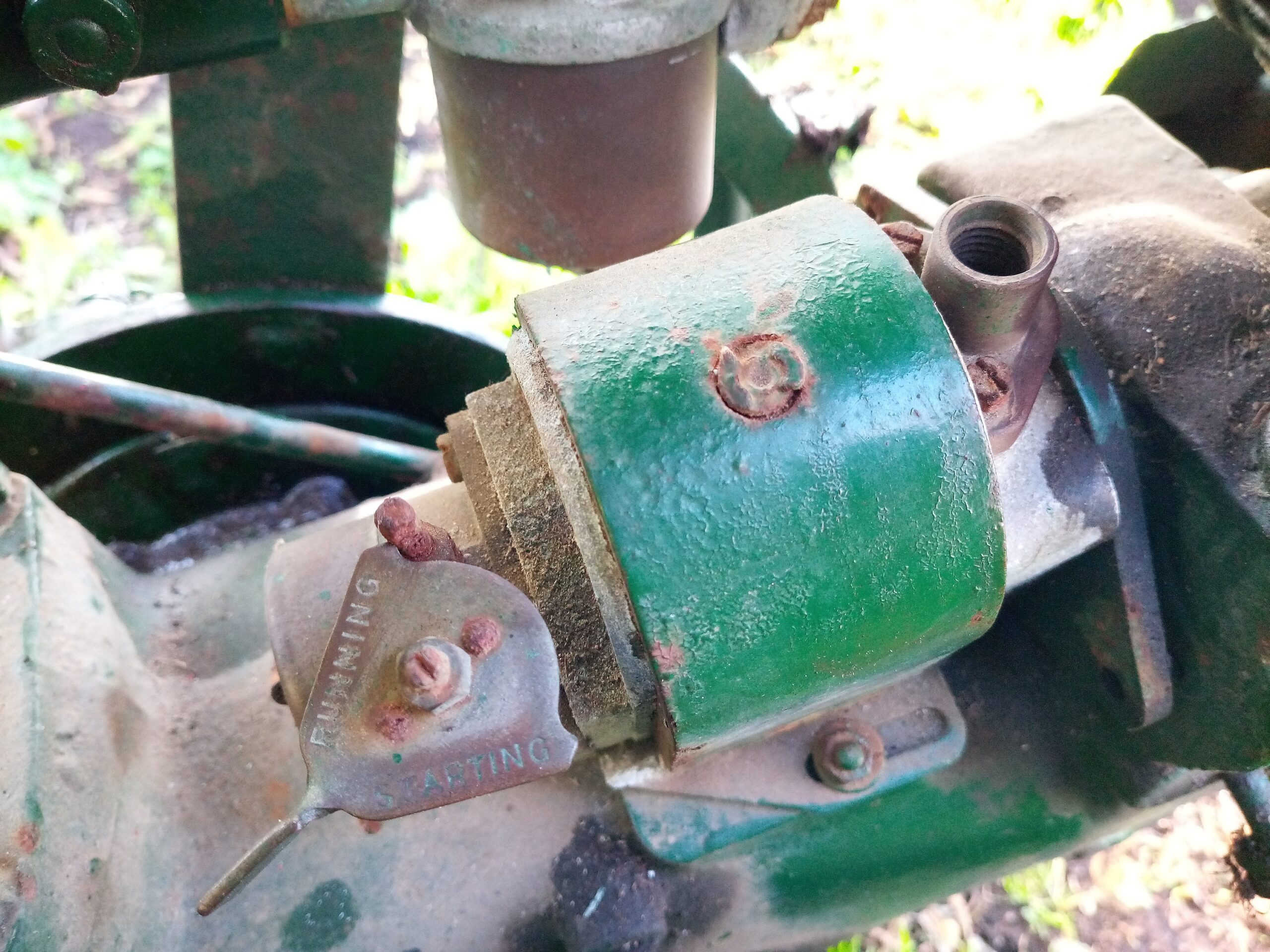

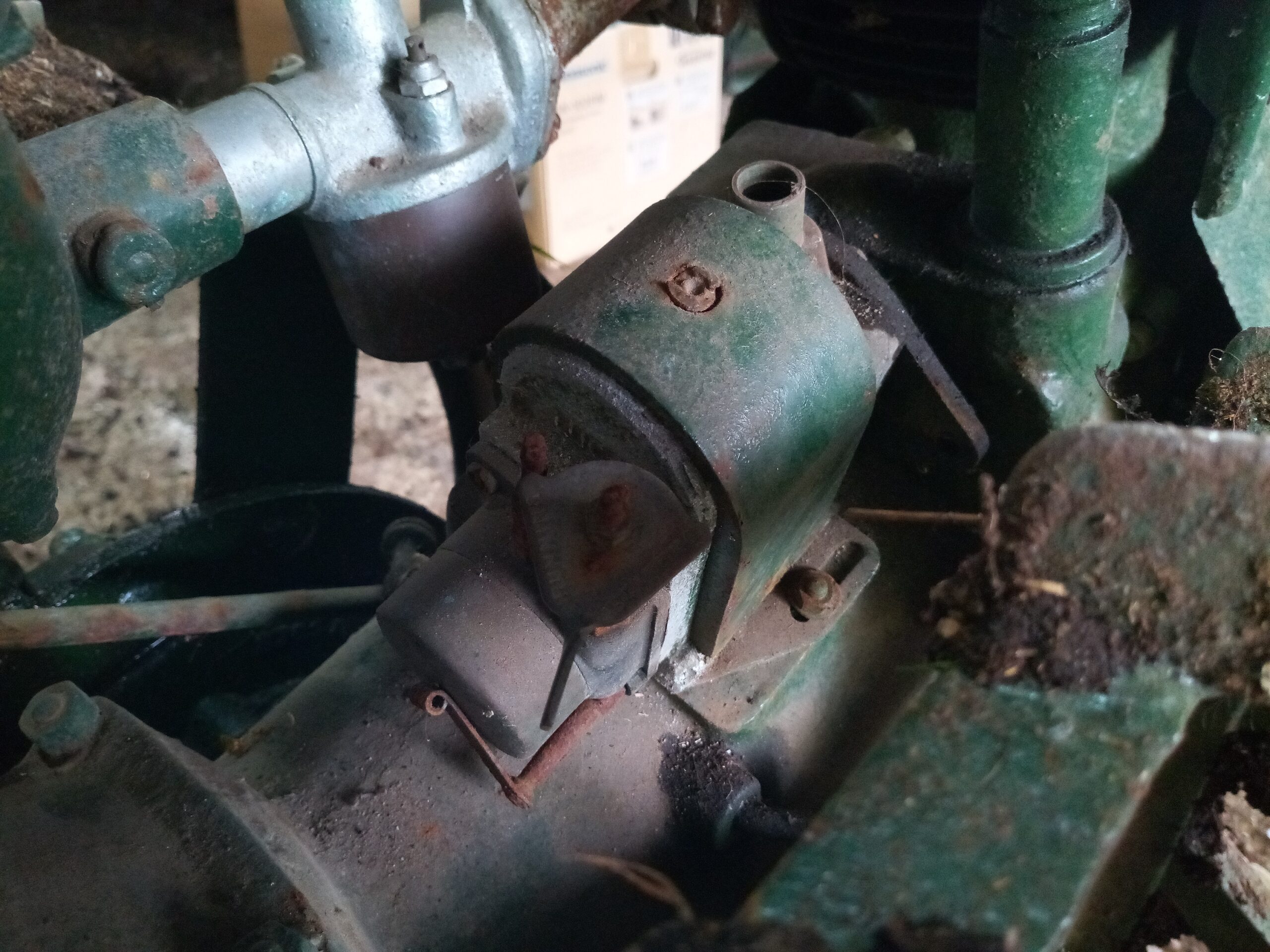

Do you know which Lucas magneto is fitted? As an HT lead is the current hang up.

charlieKeymasterIf the HT lead pick up is in good condition it should be easy enough to but a length of HT cable to make a replacement.

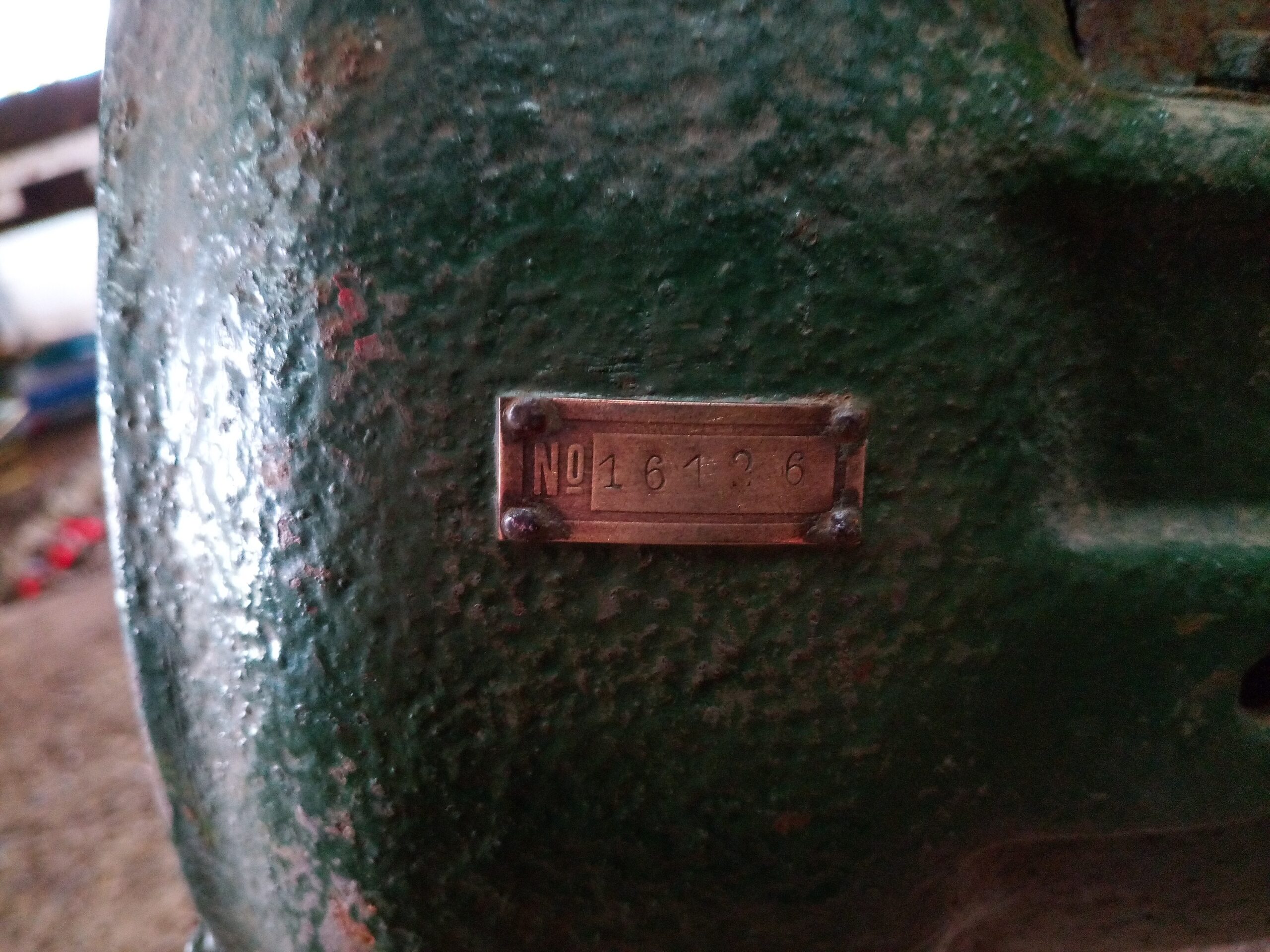

Do you have any idea why the number on this machine doesn’t tie up with any of the serial number ranges on the French site?

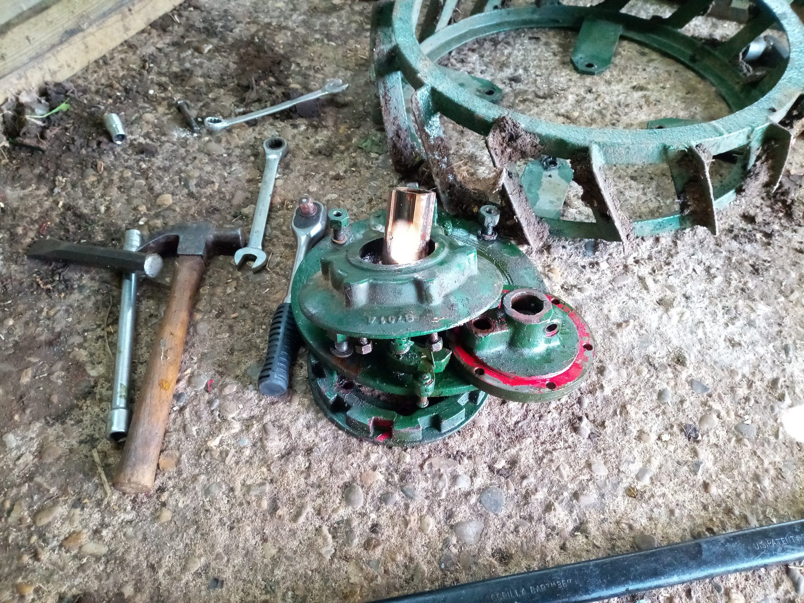

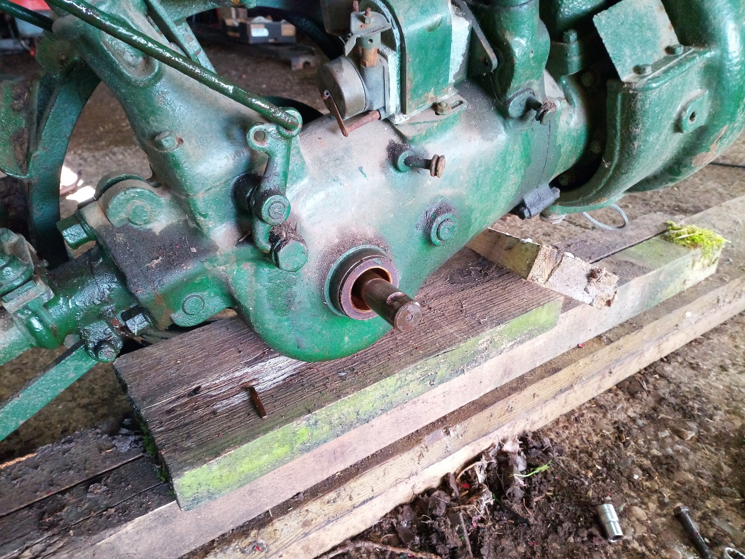

vhgmcbuddyMemberI’ve gotten the short pin removed. The long one is pretty stuck indeed, I tapped it inwards with a hammer to ensure it engaged properly, and I can withdraw it back to it’s original position with the use of a pry bar behind the “t” piece. I’m reasonably sure that the issue is the part which has been exposed through the back of the wheel hub has become rusty and is now very tight in the bore. Current plan is to remove the wheel and attempt to drift it back through rather than risk damaging the “t” bar by prying behind it.

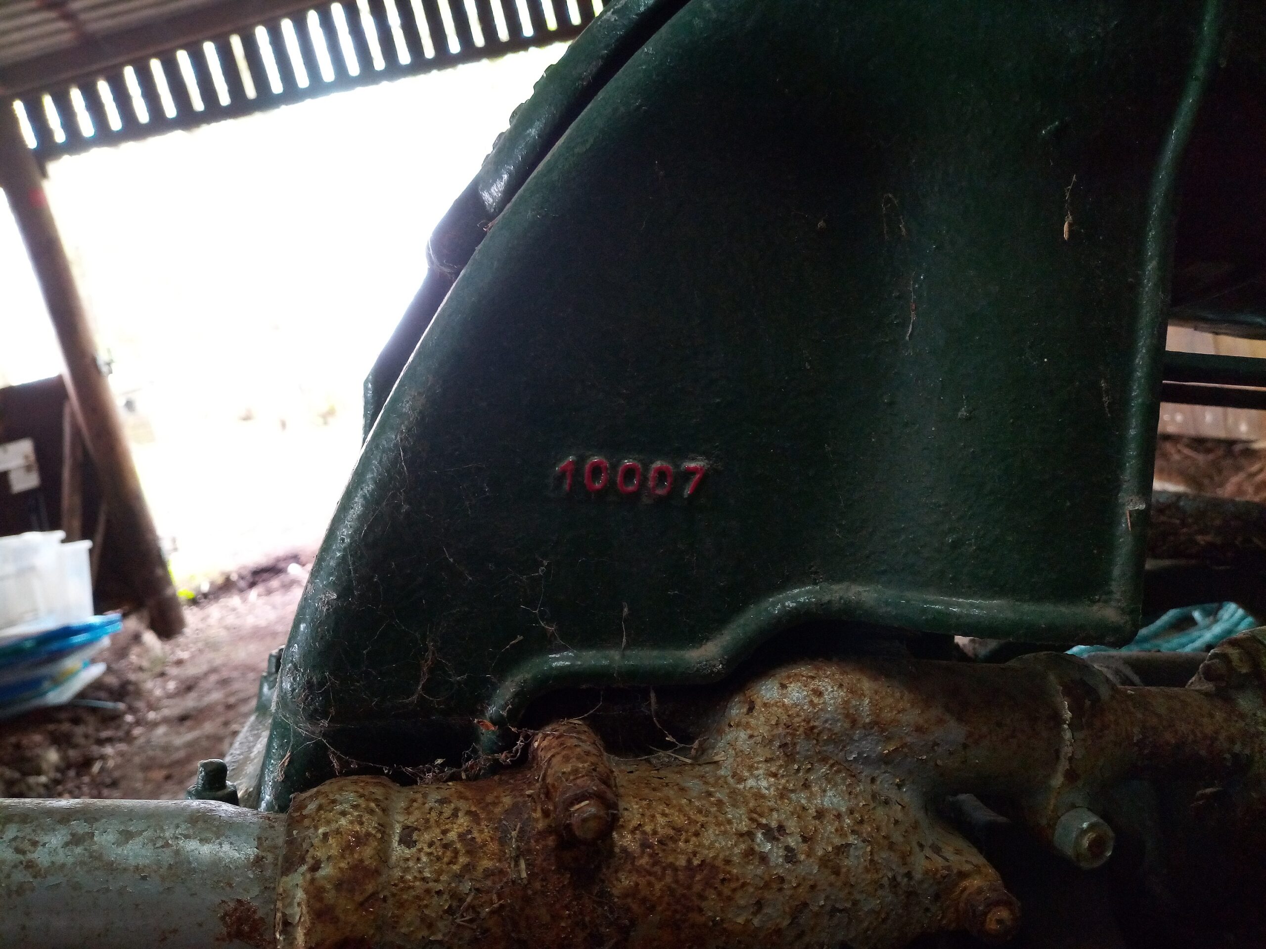

charlieKeymasterThe little brass plate with 16126 stamped on it is the engine number. The 10007 cast into engine top cover is the part number. The machine serial number on my model 50 is on a plate on the left hand (carb side) engine side cover.
May 4, 2020 at 7:22 pm #34164
vhgmcbuddyMemberAhh I see, the side plates are missing, so perhaps this one will remain a mystery… I assume that Geo Monro imported models other than the 35 and 56 from Switzerland?

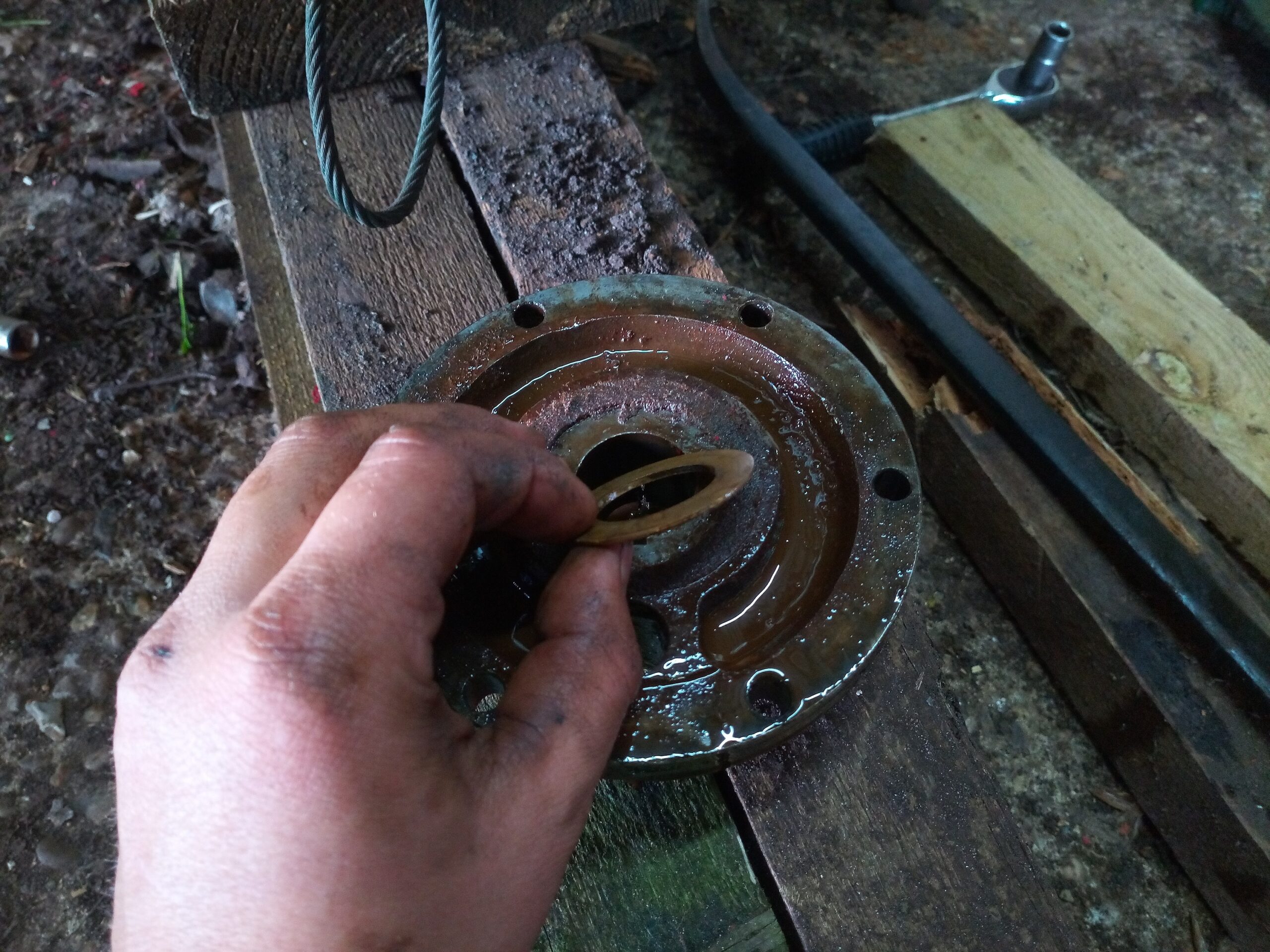

Did I see in another thread that you have access to some engineering drawings Charlie? After some investigative dismantling today I’ve discovered a rather well worn main axle bush on the right hand side (8317D), so it looks like the lathe will have to be pressed into service.
Embarrassed to admit that I made the mistake of pulling out the hub drive flange, my heart did sink when I heard the pinion drop… Fortunately after allowing the old girl a lay down I managed to wriggle it back in. Phew!
Though I can’t imagine the gearbox is going to hold very much oil without some remedial work… Video of the sloppy axle here:

Would be interested to hear your thoughts on how much play is too much play when it comes to the bearings? I’d estimate that there’s about 1/16″ of movement in the vertical plane, as shown in the video in my previous post.
