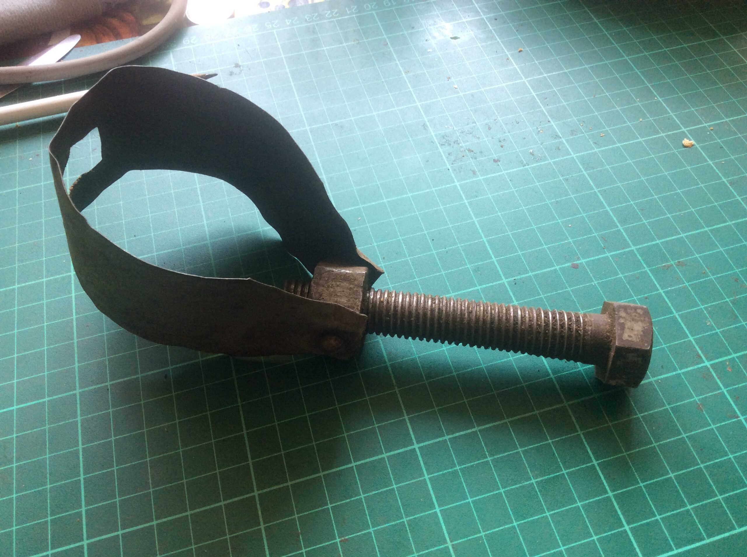

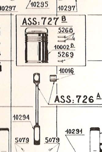

wristpinParticipantTo remove gudgeon pin (wristpin) remove the clips part number 10297, see parts manual plate 2 for illustration.
If it’s an alloy piston, with clips removed, suspend it in a pan of boiling water for five minutes and it will probably expand enough to allow the pin to be just pushed out. Failing that make a tool similar to this to push it out. No apologies for its rather crude appearance as I made it in about 1960 when playing with Lambretta scooters. Amazing how many pins it’s pushed out on a variety of engines since then.

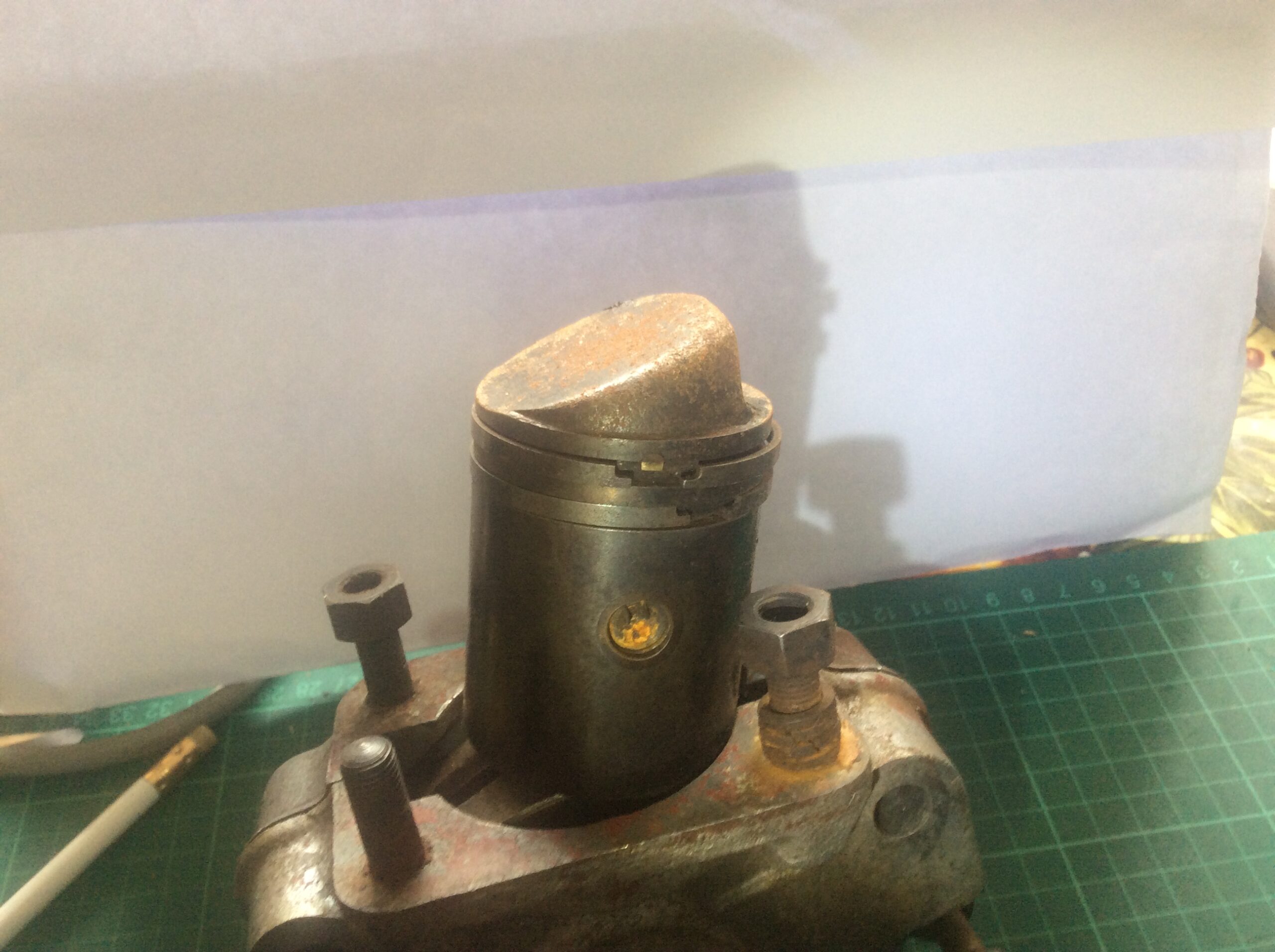

April 24, 2022 at 9:32 am #38885john-e-w
ParticipantNow that you have got the piston out – what happened to the split pin that was in the lower barrel?
John E-W
April 24, 2022 at 11:42 am #38887aquila787
ParticipantApril 25, 2022 at 6:18 am #38890
charlieKeymasterThe split pin is there to stop the rings turning in the groove. As a 2 stroke it is important that the ring gap does not line up with any of the ports in the cylinder bore, this could happen if the rings did not have the split pin to prevent then moving.
April 25, 2022 at 12:01 pm #38893
wristpinParticipantThe split pin is there to stop the rings turning in the groove. As a 2 stroke it is important that the ring gap does not line up with any of the ports in the cylinder bore, this could happen if the rings did not have the split pin to prevent then moving.
Seems a fairly crude way of achieving the desired result. Is the split pin an original feature or some “Bush mechanic’s” bodge after a happening of some sort?

The engine builder is finding it very difficult to remove the piston ring pegs on my piston (part numbers 5268 and 5269) Have any of you done this or are they available to buy. I seem to remember reading somewhere that there might be a fellow in Switzerland selling some parts for these Simars. I attach pics.
May 27, 2022 at 6:38 am #39109
charlieKeymasterI am fortunate, so far, not to have had to rebuild an engine to that extent.
Looking at the parts list diagram the pin will only come out one way. If it was me I would heat the piston to see if that helps.
I am not aware of anyone having spares, but there is a drawing held at MERL, drawing number 5269 MERL ref TR/DX/1607/8/5269May 27, 2022 at 5:38 pm #39111aquila787
ParticipantHe’s going to drill them out and tap the hole for a grub screw as replacement. I suppose it’s worth a try. I’m hoping he’ll put loctite on them and if he drills right through that he’ll put a grubscrew with a lock washer on the back as well as the loctite.
John
May 27, 2022 at 8:11 pm #39113andyfrost
ParticipantDoes your man really think that piston is repairable , from the photos I would say it’s a bit unlikely , it’s the breakage between the ring grooves that would concern me most. Were it a fourstroke , then yes there are ways you could have gotten round it.
May 27, 2022 at 10:32 pm #39114aquila787
ParticipantAndy
He thinks it’s repairable…..I don’t know myself…..I’ve seen a worse example of piston on here I think which was repaired. It had a large hole in the top. I’ll find a piston somewhere if all fruit fails. I know at the end of the day it will cost more than I can buy a good working machine but that’s not the aim. I want to experience the restoration of an old machine.
