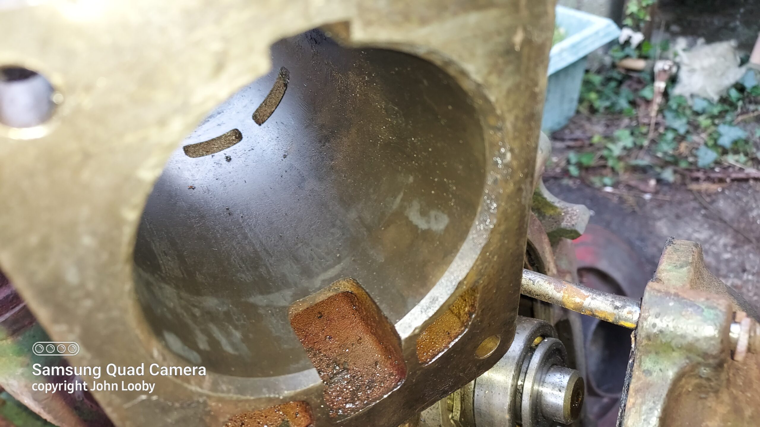

April 18, 2022 at 5:28 pm #38827aquila787
ParticipantApril 18, 2022 at 6:36 pm #38830john-e-w
ParticipantIs it a pin, or a broken piston ring?
John E-W

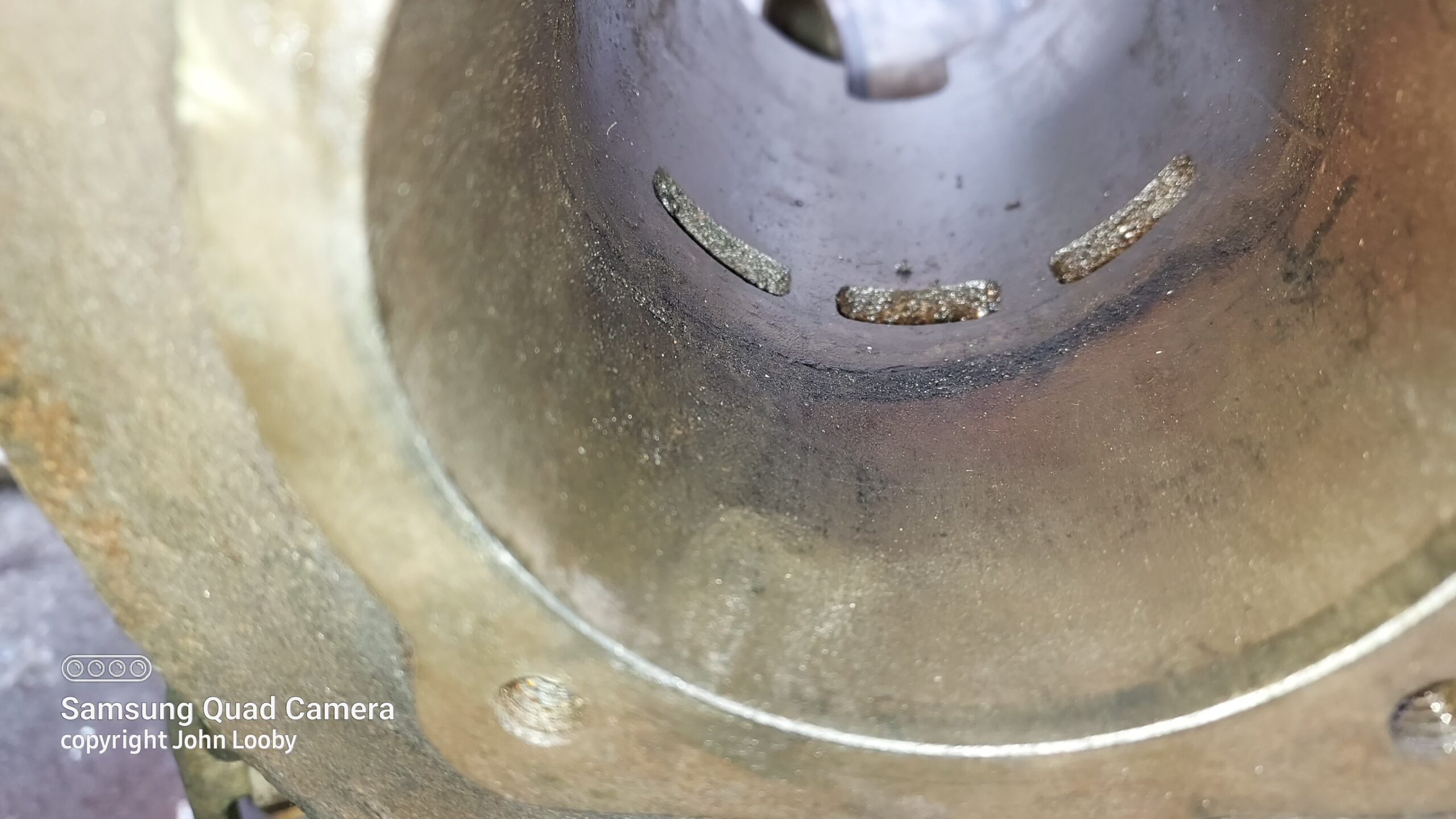

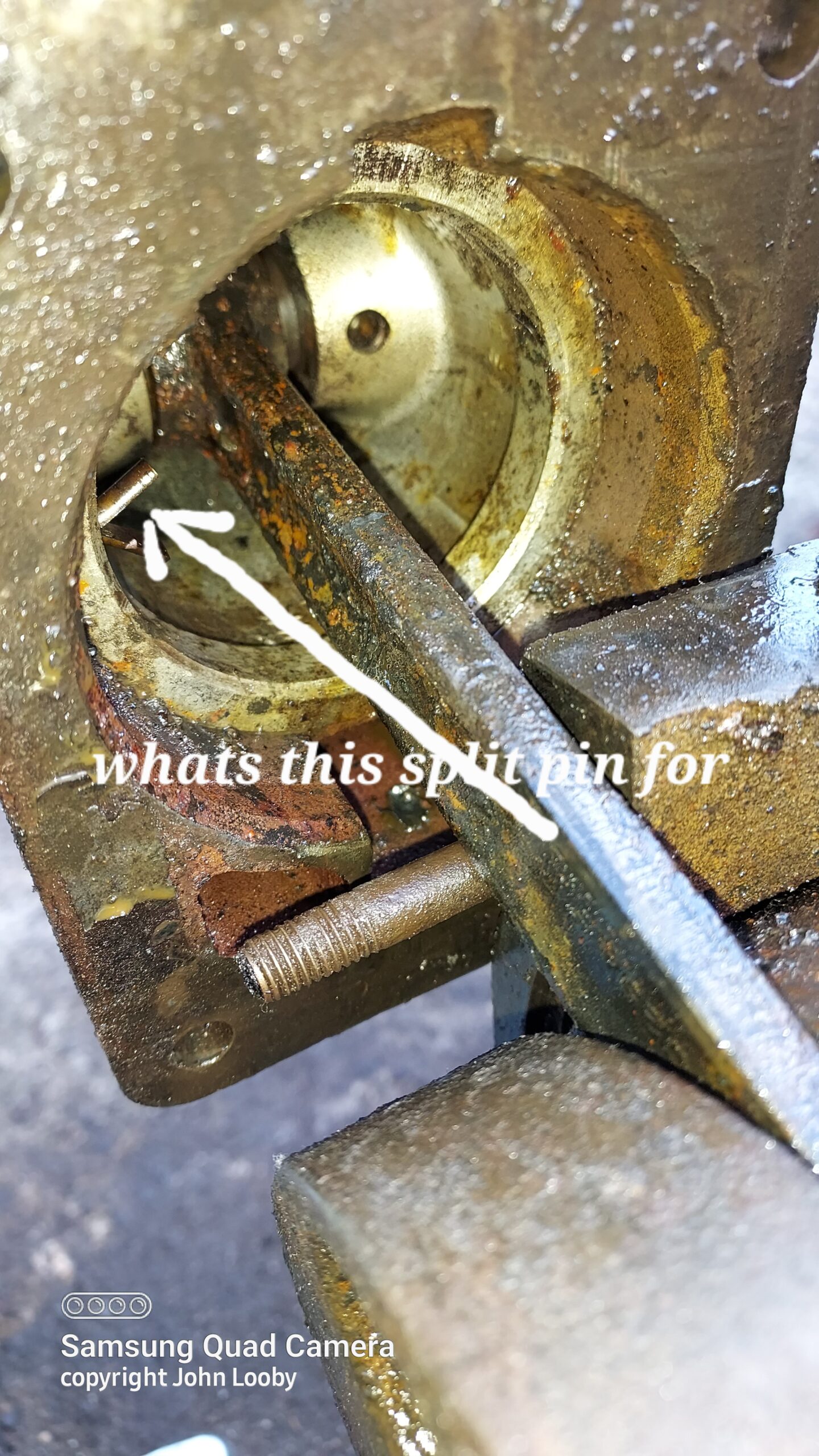

April 18, 2022 at 7:40 pm #38831aquila787
ParticipantIt’s a split pin for sure. Looks like there’s a flange on the bottom of the cylinder but I wouldn’t be sure. It stops the piston coming out the bottom. The pin doesn’t come out the cylinder either.
April 19, 2022 at 6:45 am #38832
charlieKeymasterWhen I have stripped one of these engines the piston comes out via the bottom of the cylinder and goes back in the same way. There is a chamfer on the bottom of the cylinder to aid getting the piston rings and piston in. I don’t recall seeing a split pin but will have to look at an engine I have in bits at present. It could be the pin that stops the piston rings turning.
Do you have a copy of the parts book? If not I can supply a scanned copy, very useful for identifying parts.

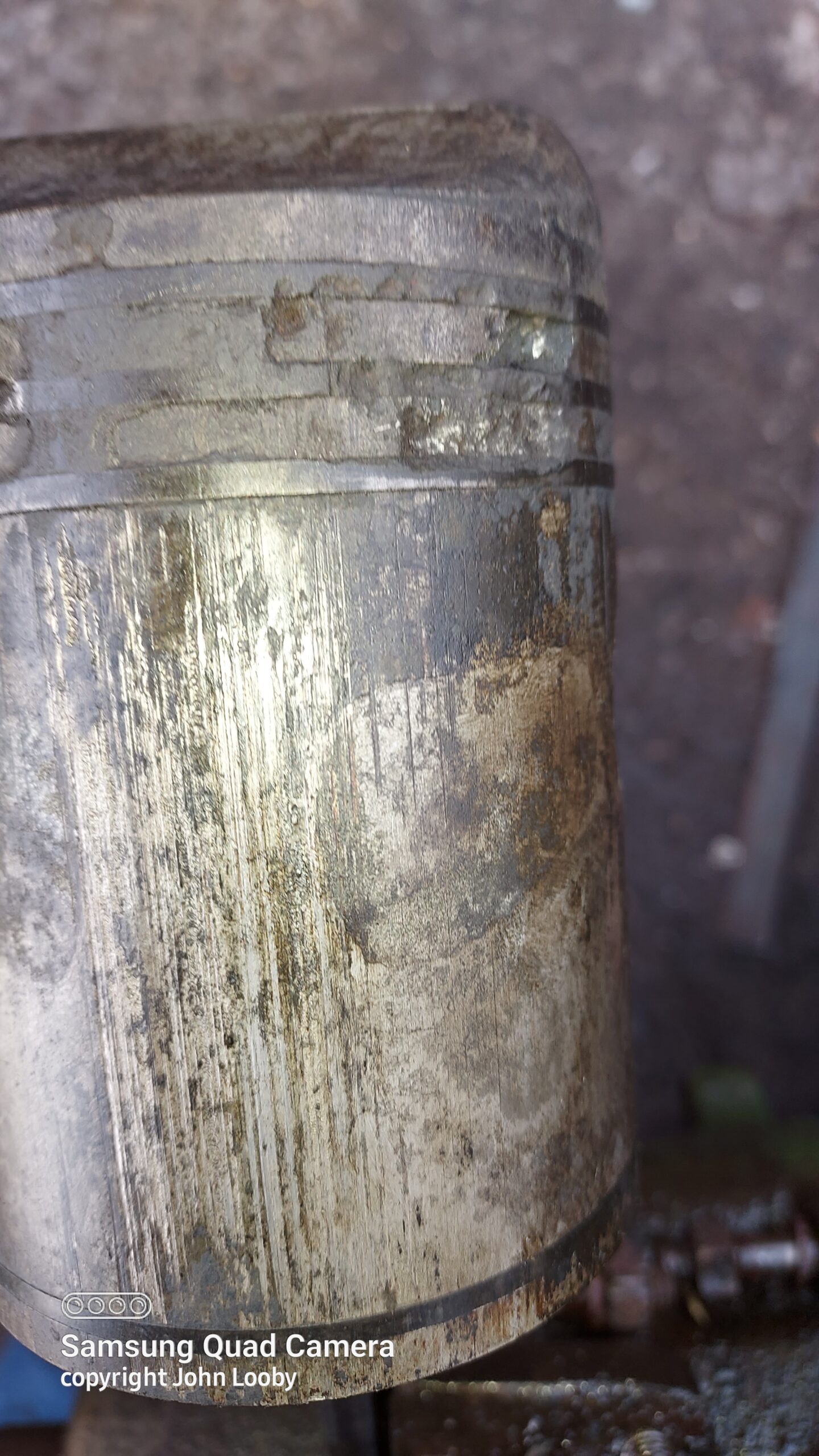

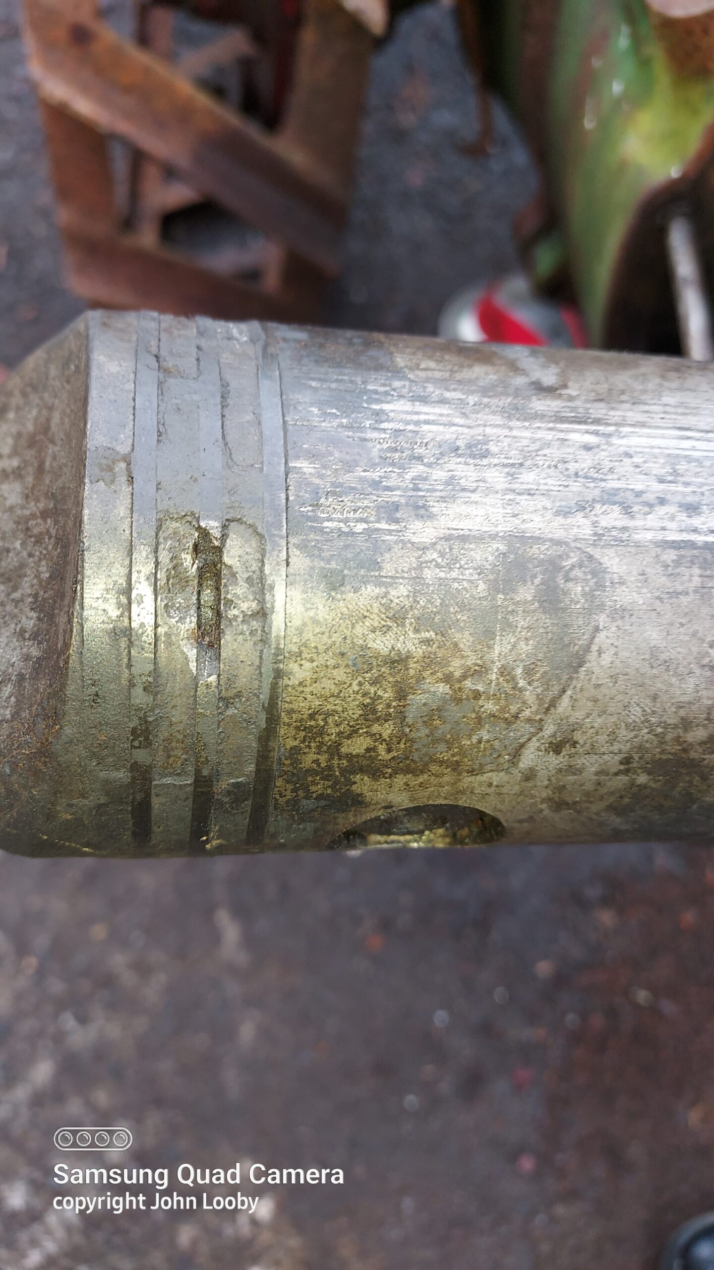

I attach pictures of the piston and cylinder which finally came apart just now. The cylinder looks OK but I won’t know for certain till later. The piston has a little damage. Rings were broken. And a break between the rings as well.
Anyway what do ye think…..is it repairable?
April 22, 2022 at 6:28 am #38861
charlieKeymasterThe break in the piston is probably where the broken ring came out. It would be worth cleaning the piston to see how bad the scoring is. You will need new piston rings, not sure if the break in the piston will cause ring failure again as ring will not be supported by groove in piston at that point.

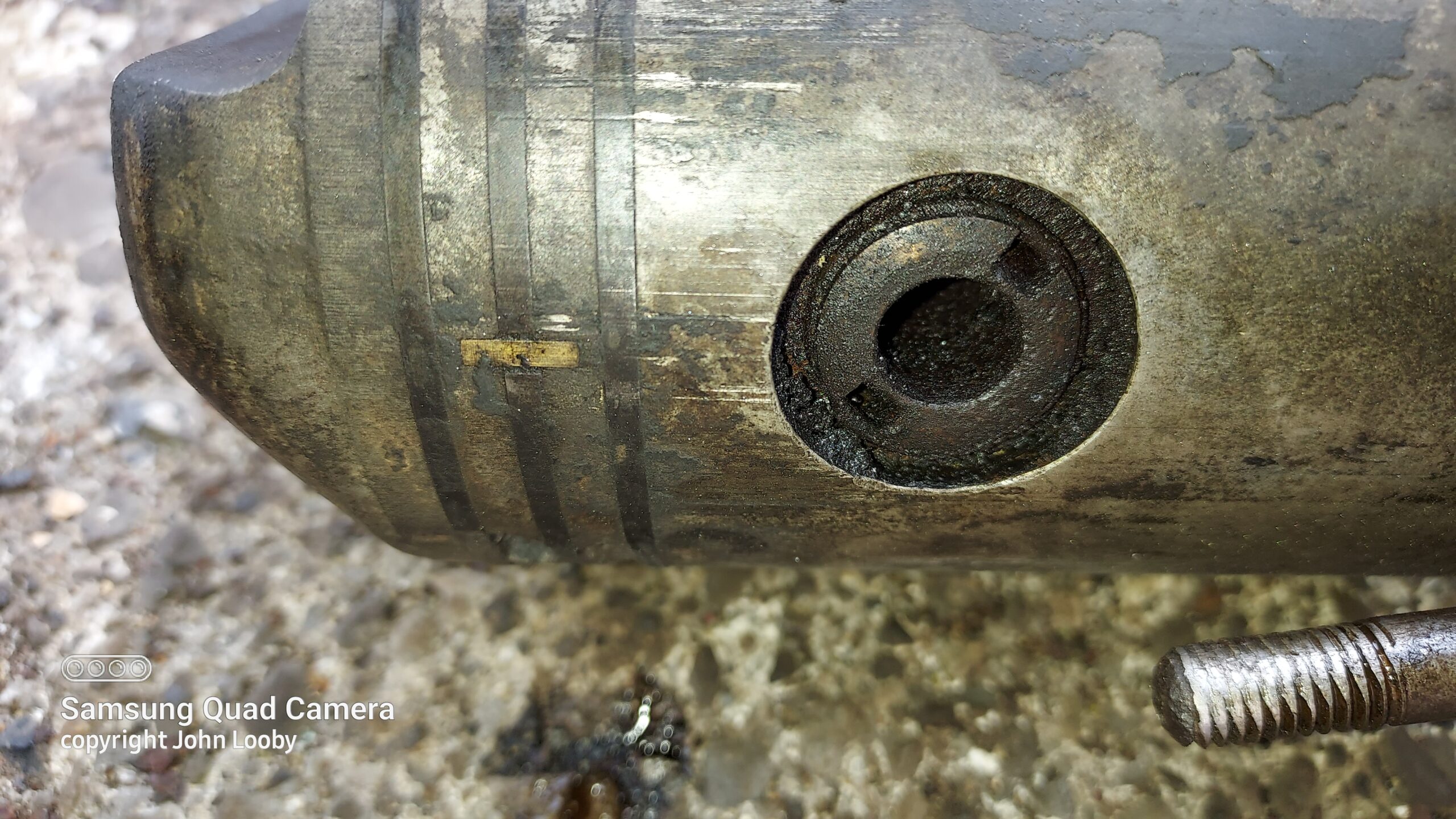

ParticipantApril 23, 2022 at 6:22 am #38876
charlieKeymasterTo remove gudgeon pin (wristpin) remove the clips part number 10297, see parts manual plate 2 for illustration.
