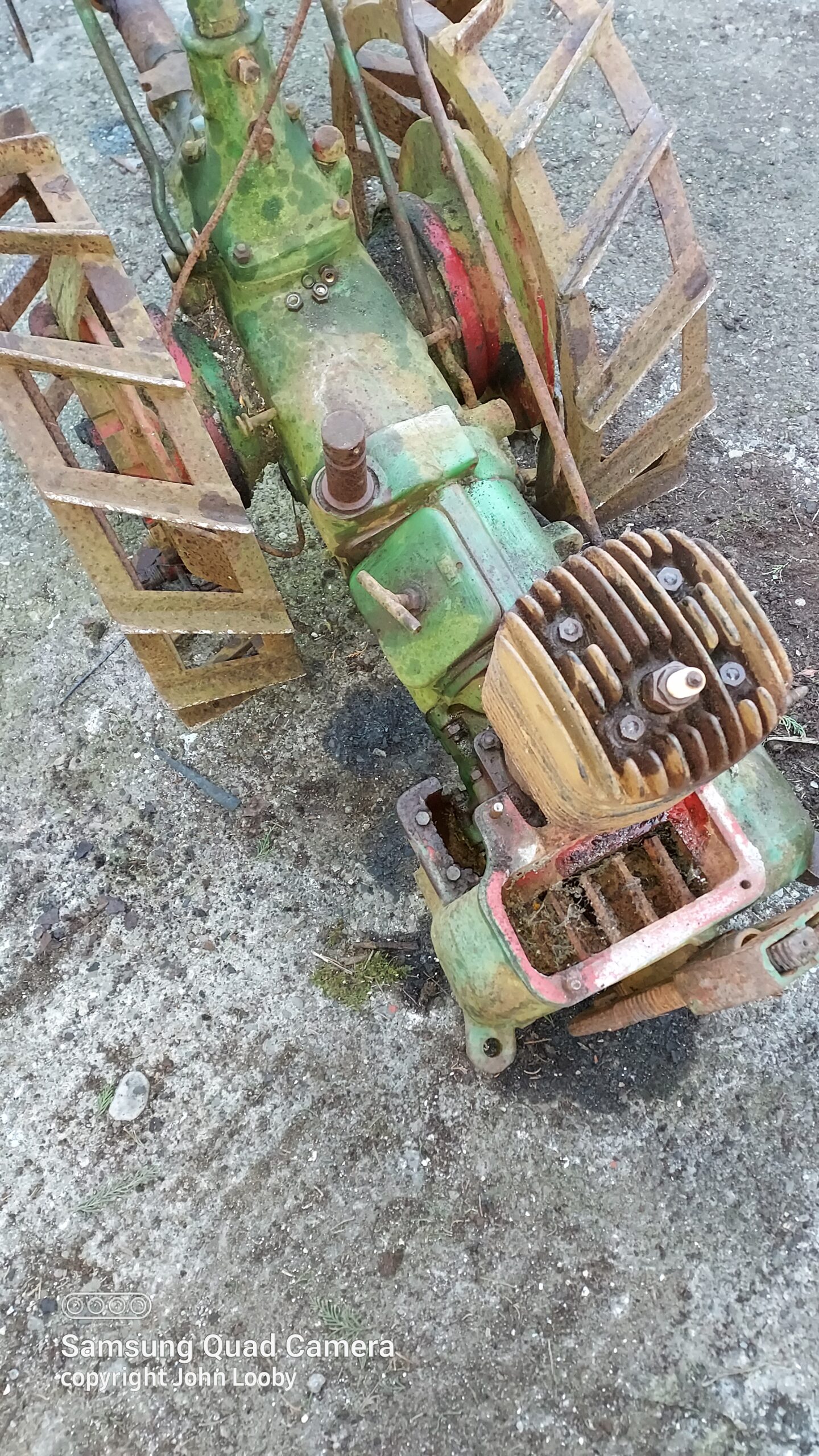

Just bought an old Simar 56 A. Serial number is 561473. Taking it apart at the moment. Last owner must have had an underperforming engine. Head gasket was damaged and leaking slightly. Where can I buy gaskets for this model. I want to do a full restoration if possible.

Thanks for that Charlie. I need info on the engine in this model. Think mine may be seized as when I took off the head there was a small piece of what looked like a broken ring on top of the cylinder. Is it a Jap engine. Anyone selling or making the springs in the picture. Where can I get gaskets for the engine and body?
Regards
John
March 23, 2022 at 8:10 am #38703
charlieKeymasterAs I said I do not know make of engine but do know it is not JAP, Villiers etc, it could be SIMAR own design.
It is not uncommon for these engines to be seized due to water ingress down the exhaust pipe.
Cox & Turner Engineering can supply or make piston rings. They may also be able to help with identifying a gasket supplier or someone that can make them, which is the more likely solution.April 7, 2022 at 6:01 pm #38755aquila787

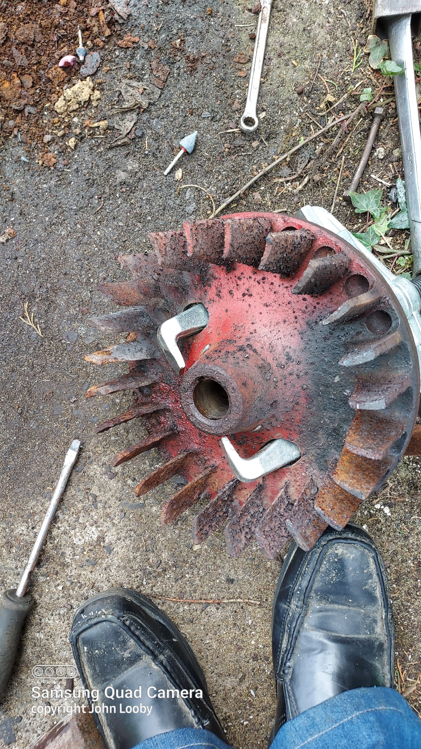

charlieKeymasterJohn, the flywheel is on a tapered shaft and can be extremely tight, probably never been off since assembled. I made up a puller to fit the holes in starting flange. I also applied heat to centre of flywheel whilst applying tension with the puller, also a good soaking with penetrating oil eg Plus Gas (not WD40). On my model 35 I ended up giving the flywheel a good whack with a soft hammer and the shock got it off. In fact it released with such a bang I thought I had broken it.
April 8, 2022 at 10:27 am #38757aquila787
ParticipantI tried most of that. The starting ring started to break so I stopped before it disintegrated. Thinking now if I drilled two holes in the flywheel big enough for the pullers to go through to the back of the flywheel might do the job. I’m using wd40.
John
April 8, 2022 at 3:08 pm #38758

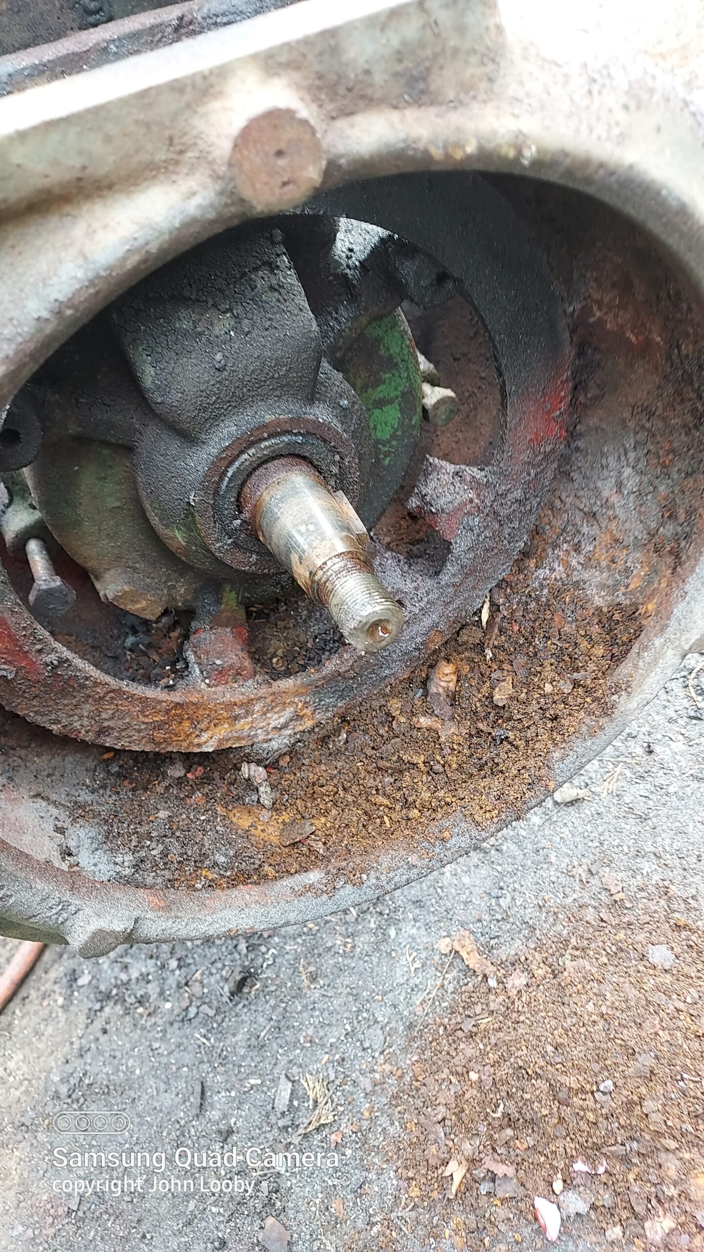

April 15, 2022 at 11:07 am #38811aquila787
ParticipantApril 15, 2022 at 12:00 pm #38814john-e-w
ParticipantWell done John.
It looks like there is a Woodruf key on the shaft which is good engineering and it’s a pity that Villiers didn’t use them as it would have made setting the timing a lot easier. When you reassemble the flywheel it can be easier if you “rock” the key so that the leading end is lower than the trailing end. Just make sure that it is all lined up with the cutout on the flywheel and as you tighten the nut it should “rock” back into position so that it is parallel with the shaft.John E-W
April 15, 2022 at 2:46 pm #38817
charlieKeymasterGlad to know you managed to get the flywheel off.
Removing the flywheel on the Simar does not affect the timing luckily. I do have the instructions for setting timing if needed. If you look carefully at the front face of the flywheel there should be a mark for TDC which lines up with the raised mark on the housing. -
