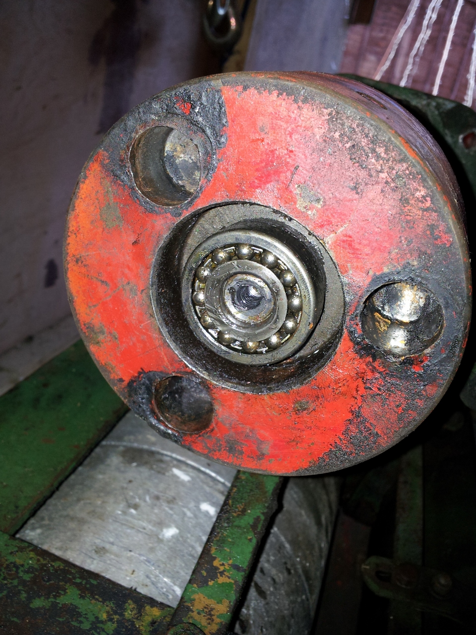

wristpinParticipantAh, just the support bearing for the sprocket on the other side.
Page 11 in the parts list.December 27, 2013 at 9:42 am #4564
vhgmcbuddyMemberAhh Har ! that looks like it does more than that ,but little mystery solved,thanks Angus. have not yet looked in the cover or it would have solved its self in time. going back to the shed demolition to get her under cover,i may be able to get it in if I remove grass box and the brackets which hold it in position on the main chassis.

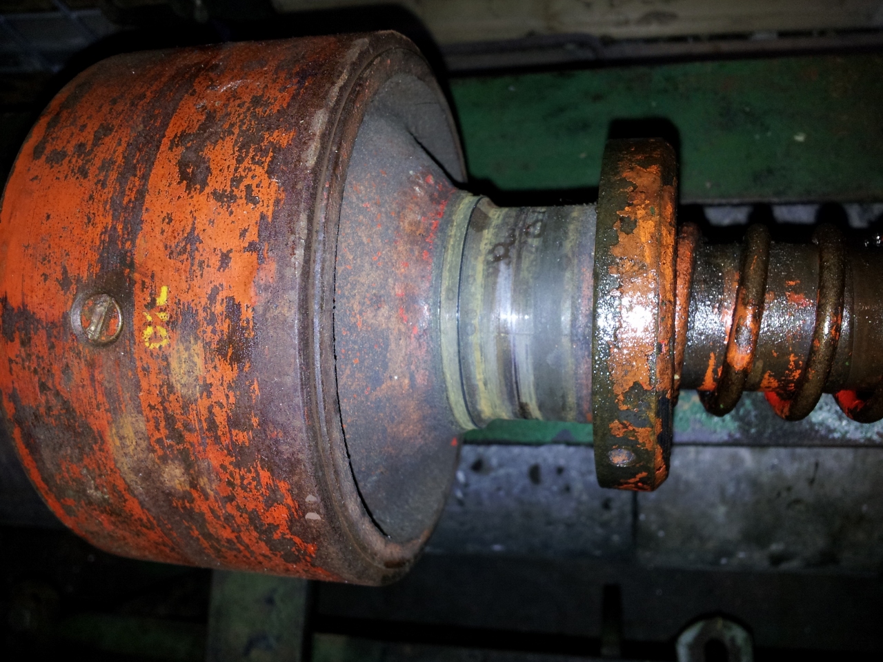

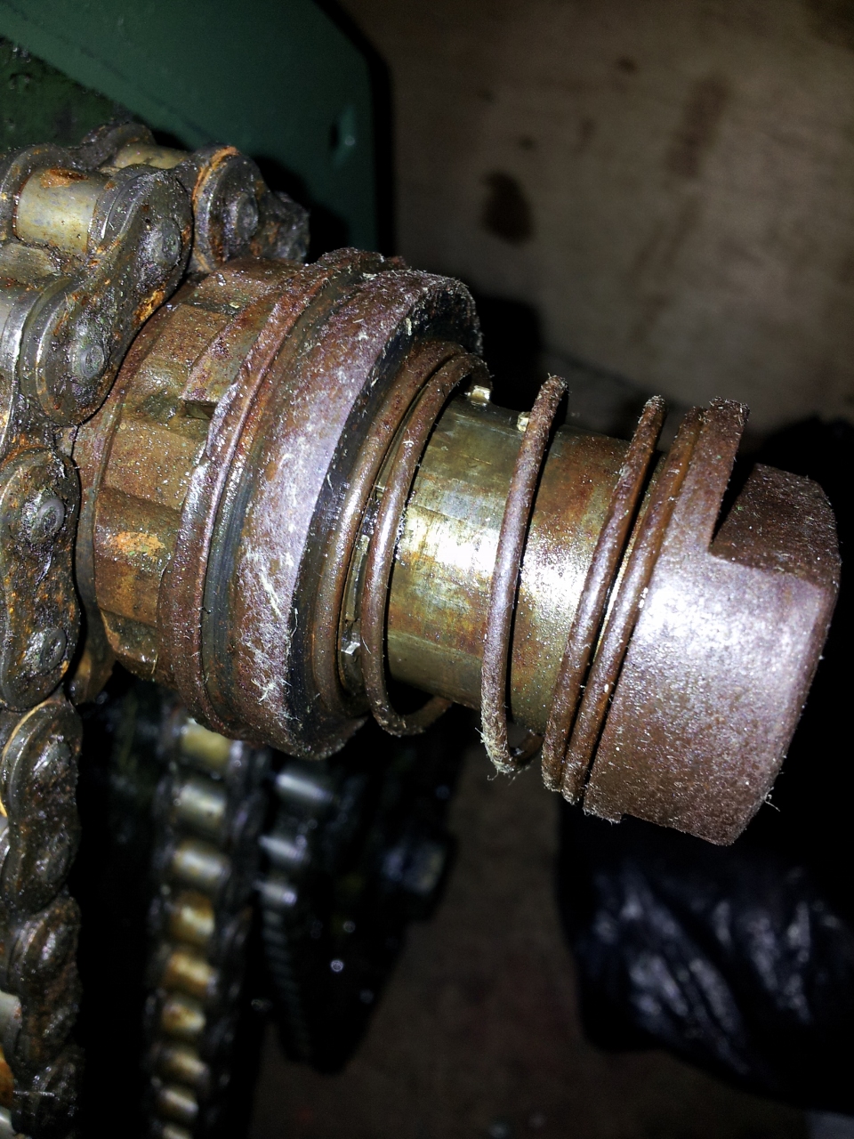

vhgmcbuddyMemberStrip down in rapid progress,and have now come to a halt on the clutch assembly. have looked at the parts list which I was sent yesterday,and as yet have not got it off. could be seized in the engauged position but just wanted to ask if I heat up the outer casing to expand it from the inner unit would any harm be done from inside the clutch unit ?
December 28, 2013 at 2:52 pm #4582
vhgmcbuddyMemberGot the little blighter at last ! a few delicate squirts of WD and a small loving tap or two from the Mash Hammer and I now have it parted. Thought it was not going to play ball,but persistence won the day. this now gives me the chance to start rubbing down with the fine flap wheel which I can recommend to beginers.

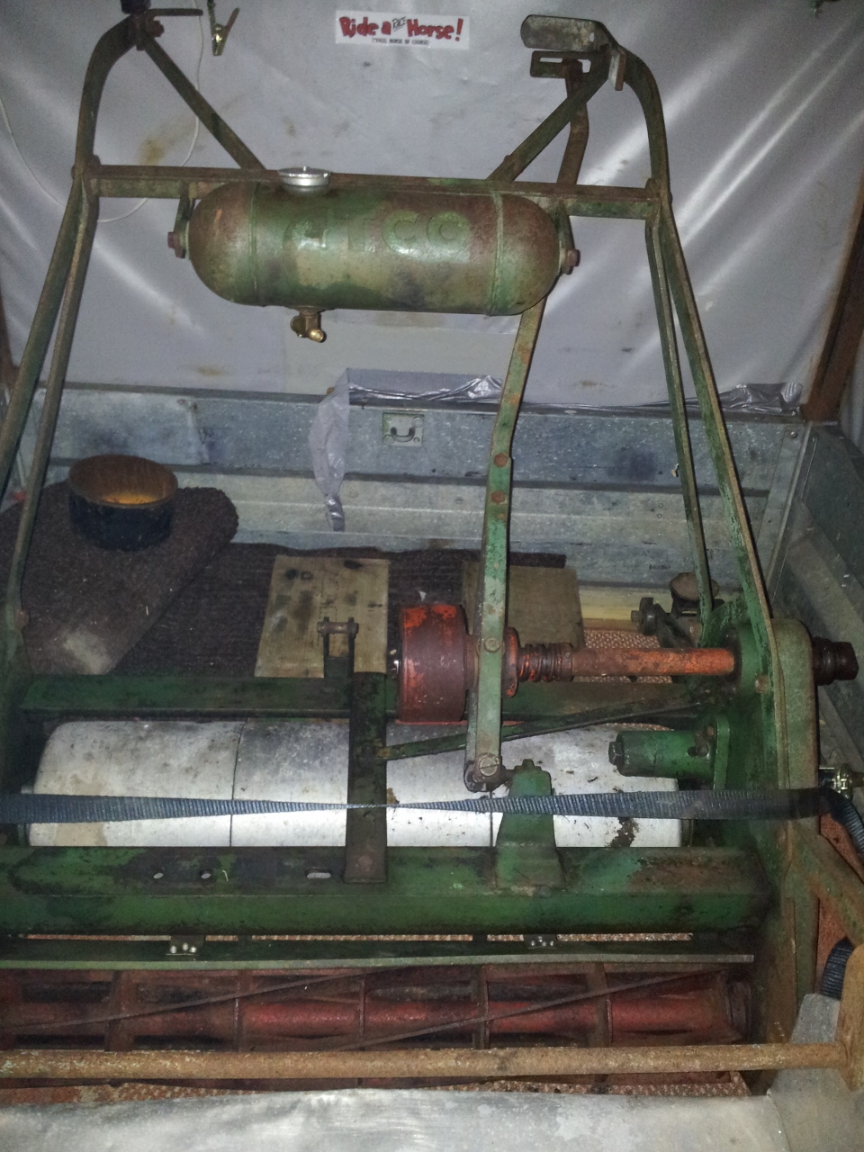

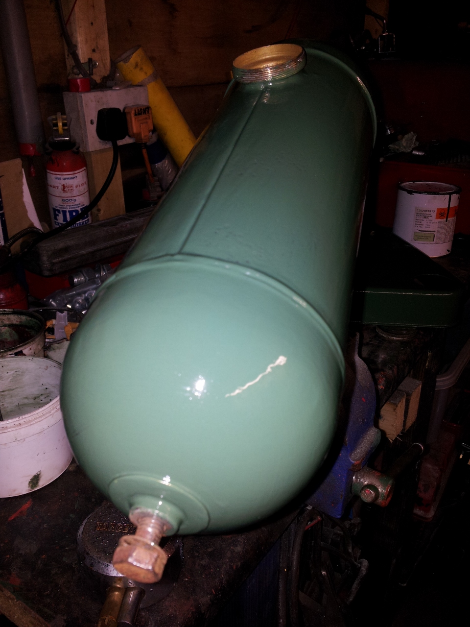

vhgmcbuddyMemberDuring strip down of the drive actuator,have discovered from an old photo that this tubeular piece which you pull and twist has gone missing. most Atco’s have it but I don’t. Has anyone got a spare or is it a case of fabricate another bit. the inside diameter is 46 mm,and I am not sure how thick the sidewall is but I know if its to thick it will foul on the chaincase.
Also a couple of snaps of the chaincase and tank.

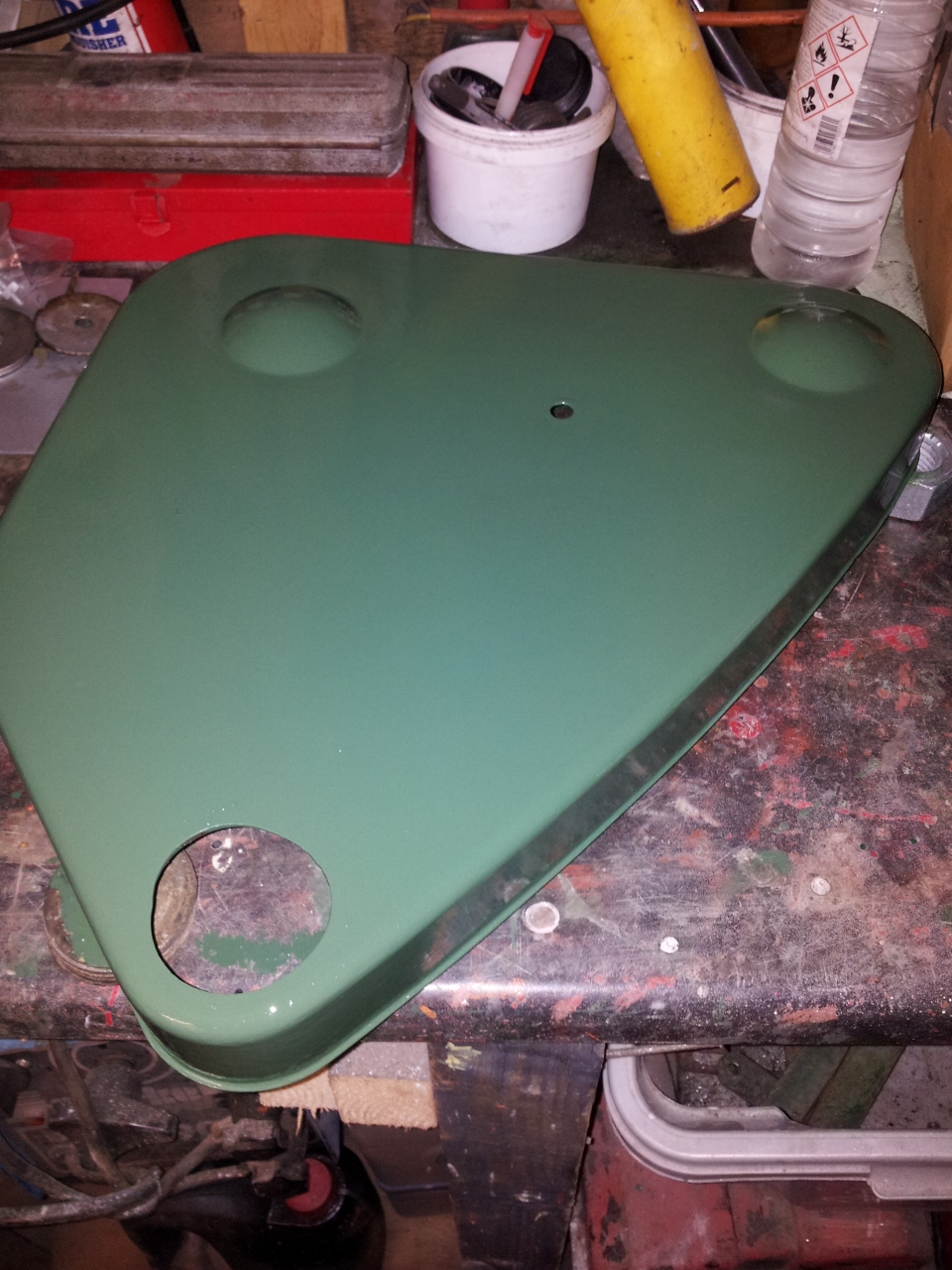

December 31, 2013 at 8:02 am #4658

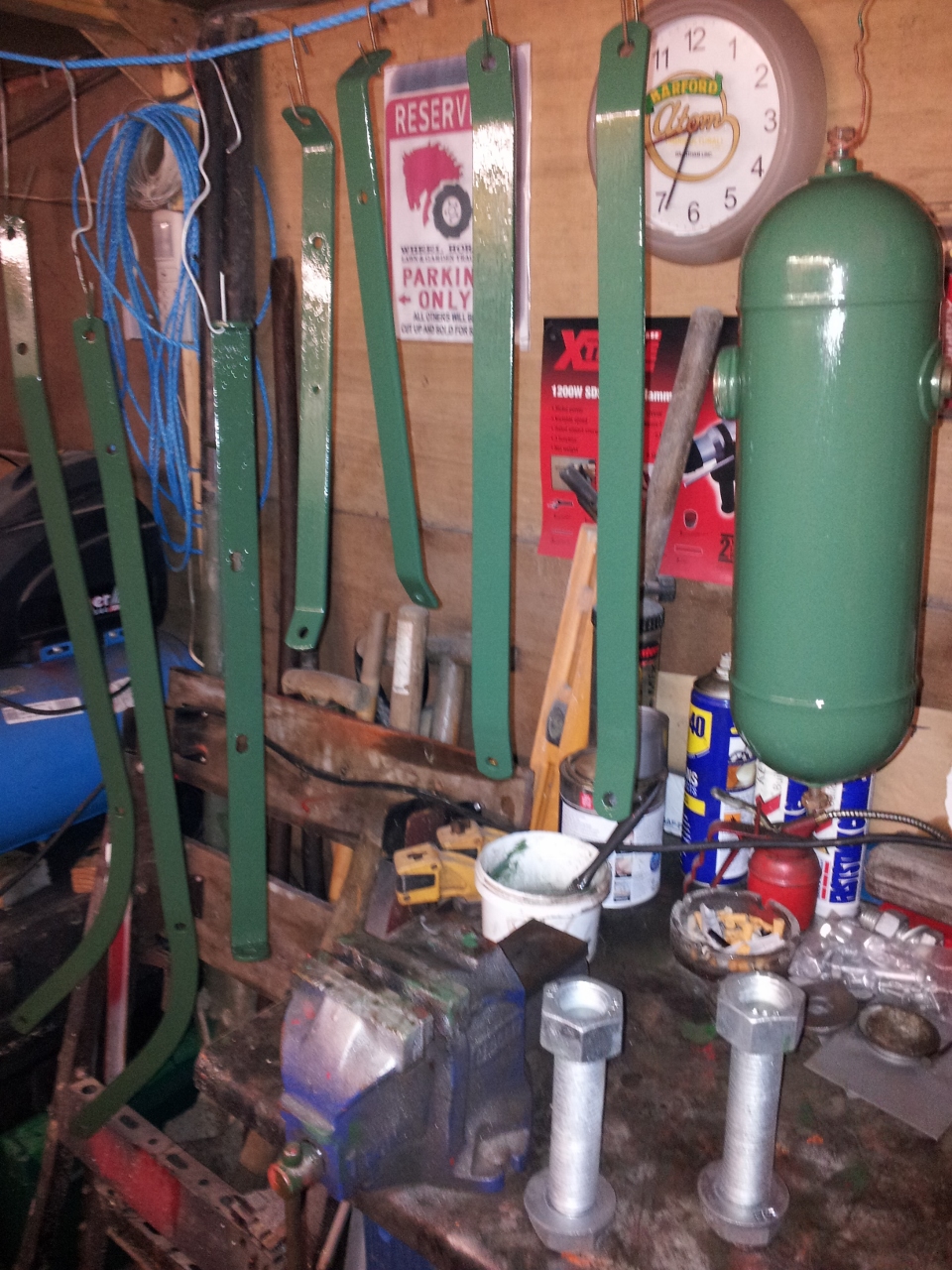

vhgmcbuddyMemberHandle bars and stays as well as the tank bracket have been stripped and painted and I must say they do look well. have had a look at the original tank bolts and not sure if they can take another 60 years. I have some bolts here see bottom right of photo,do you think they are up to it ???
December 31, 2013 at 9:33 am #4663
darmic1ParticipantRe the bolts, I think a certain Mr Frank ‘n’ Stein will losing his head, wondering where they went! Or he could be getting it in the neck from someone…… Taxi!
