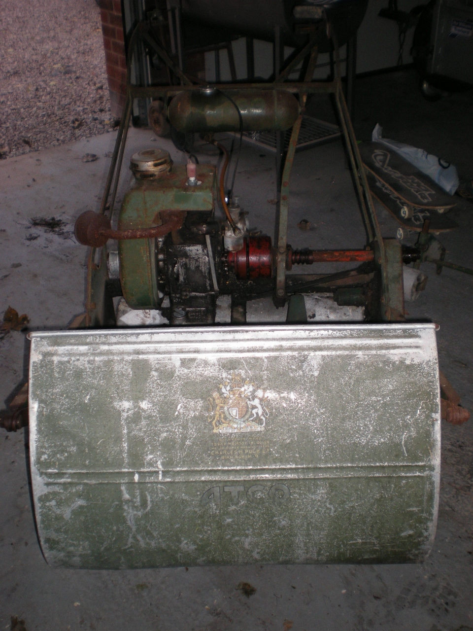

    This is a couple of photos of how it looked on collection.

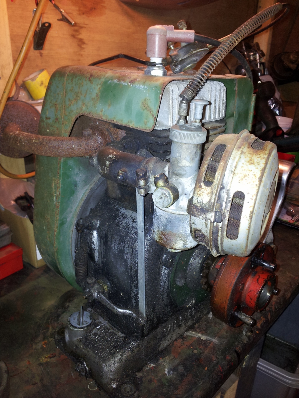

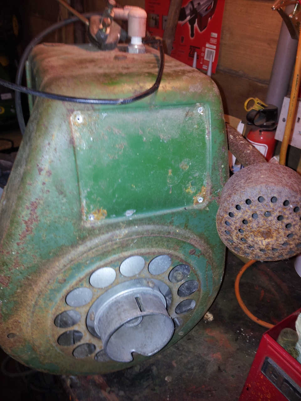

    First job as usual is remove the engine and find out where its weak spots are ,like no spark ,compression and general clean up in the back plate. This engine on the bench stands at 17 inches and its a heavy lump to move around into the bargain. 3 photos follow just before I get stuck into the dark unknown behind the tinwork.

    okay I will get off my soap box and continue with project. looked at the electrical side this morning and within 15 minutes I had it sparking like a good one. hardest part was getting flywheel off what a tight nut that was. hardest one I have encountered,even had to get a bit of extra help of a windy gun. carb all cleaned out and ready for petrol.
