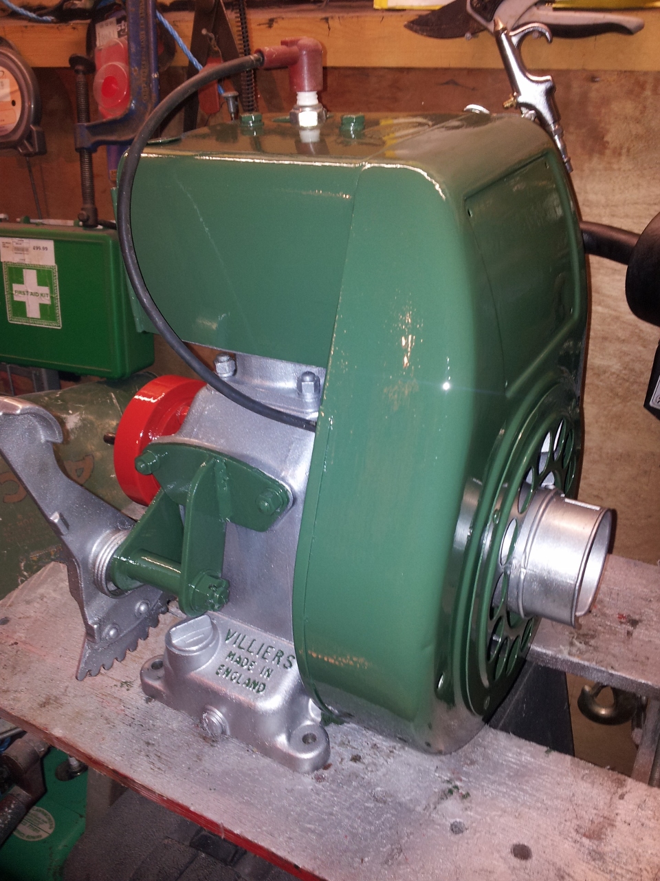

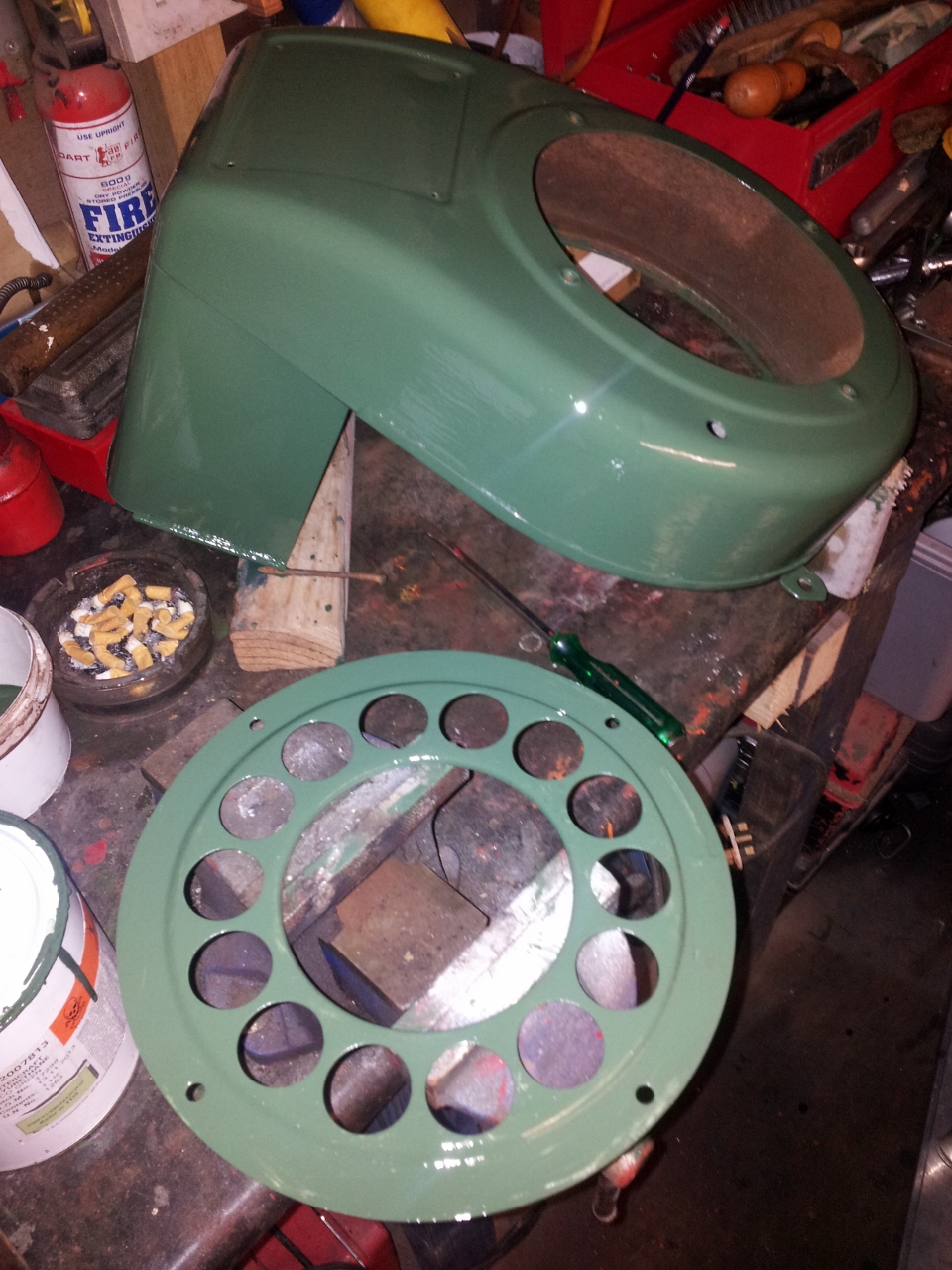

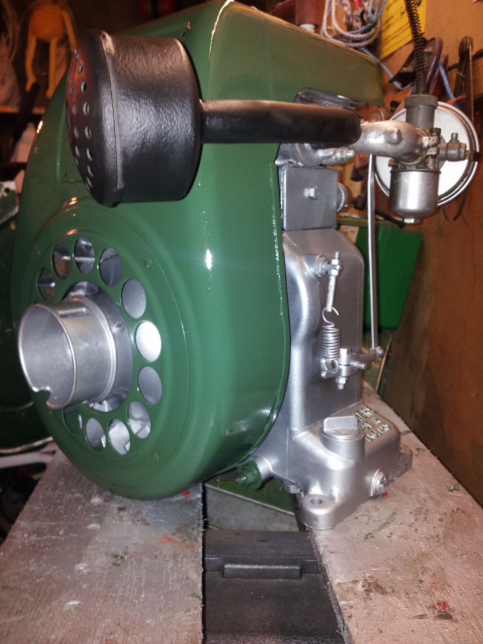

vhgmcbuddyMemberThese cold evenings just put you off going to the cold shed,but we are made of sturner stuff and have been beavering away at the engine for the last week.
with the temp being low the paint which I am putting on with the brush is taking 2 to 3 days to dry. but spray paint in cans is only a matter of overnight. this is as far as I have got this evening.December 12, 2013 at 7:22 am #3966
vhgmcbuddyMemberIt might be taking longer John, but your end results are looking good. I don’t do much evenings being retired I have time though the day. My shed has concrete walls and floor once that gets cold it would make a good fridge. On winter days when the sunshine’s I sometimes revert to the greenhouse to do a bit of tinkering.

vhgmcbuddyMemberOwen, thanks for the comment. About 25 years ago I used to spray old cars and vans in a farmers greenhouse between crops for a little earner. I used to use because of the cheap paint job,dulux metal paint. it was oil based and a high gloss if thinned down with terps. the finish after spraying on was awesome,you could shave in the reflection. also with the heat from the sun at about 80 degrees they had dried in an hour and a quarter.

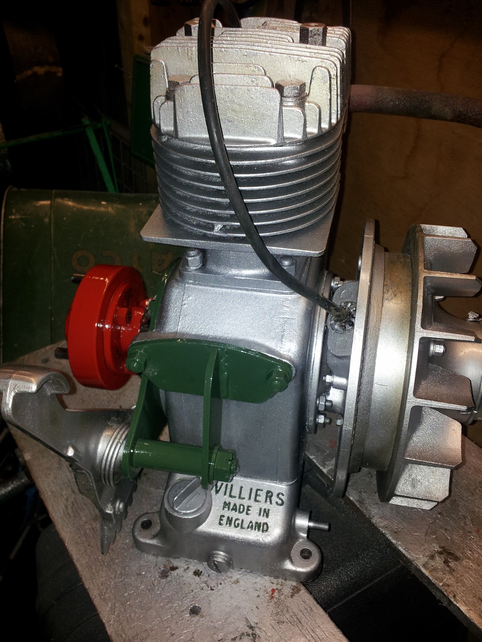

vhgmcbuddyMemberBeing a poor sleeper this hobby certainly helps me a lot with turnaround as some days I can get an extra 3 or 4 ours out of the standard day. many people comment on the fact that I have to much time on my hands but its only down to managing the time. a few updates on engine restoration…
Tried to clean up the makers plate but so worn that it definatly looks like when I order decals a plate will also have to be considered from Titch.December 13, 2013 at 4:25 pm #4007

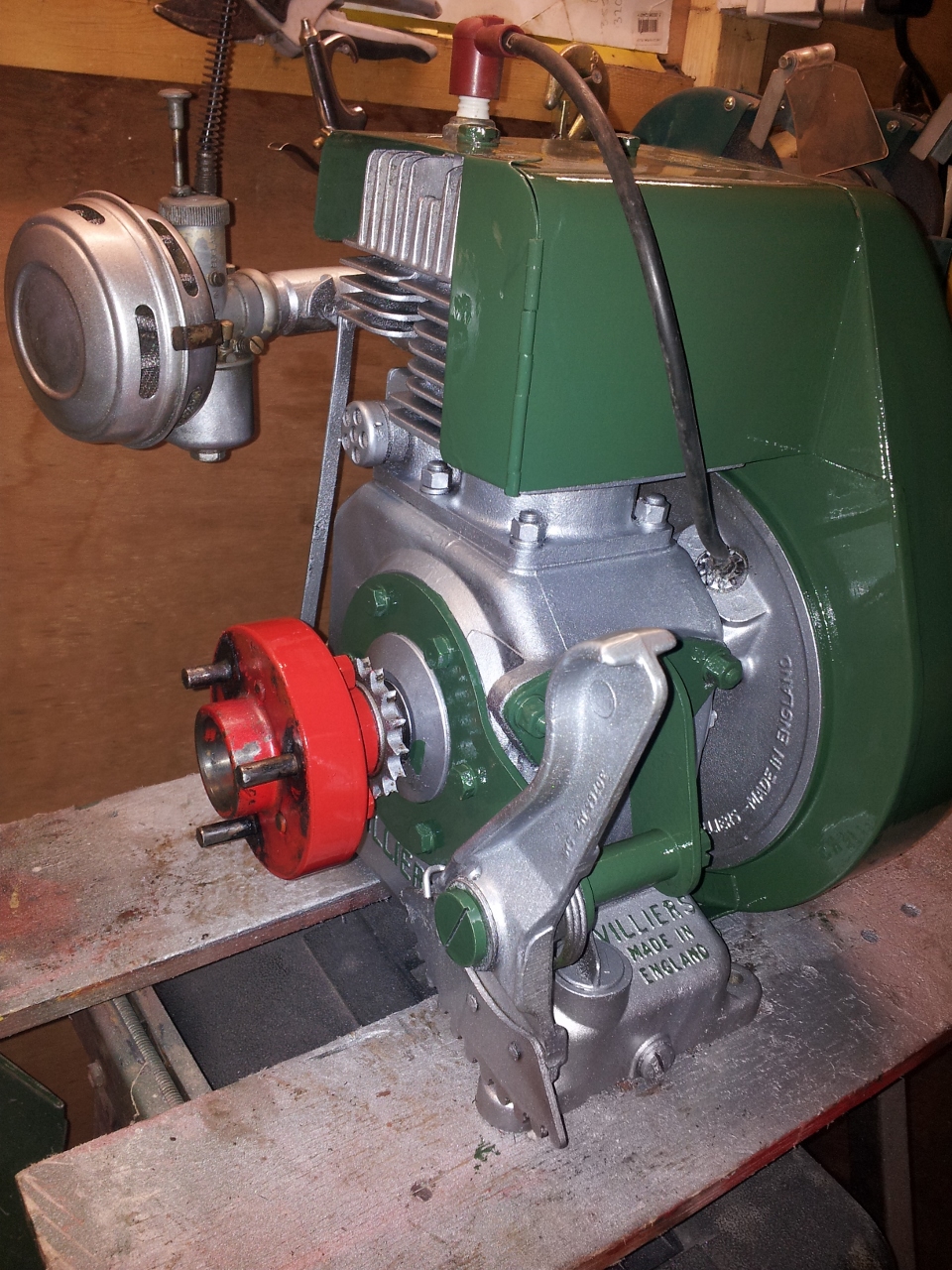

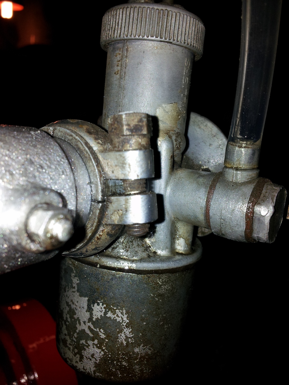

vhgmcbuddyMemberAlthough the fuel leak was there the engine ran so sweet you would think it was from a racing engine manufracturers in Italy……Dream On !!https://youtu.be/jITvQPKembE

vhgmcbuddyMemberIt sounds like you ought to put it in a go-kart John.

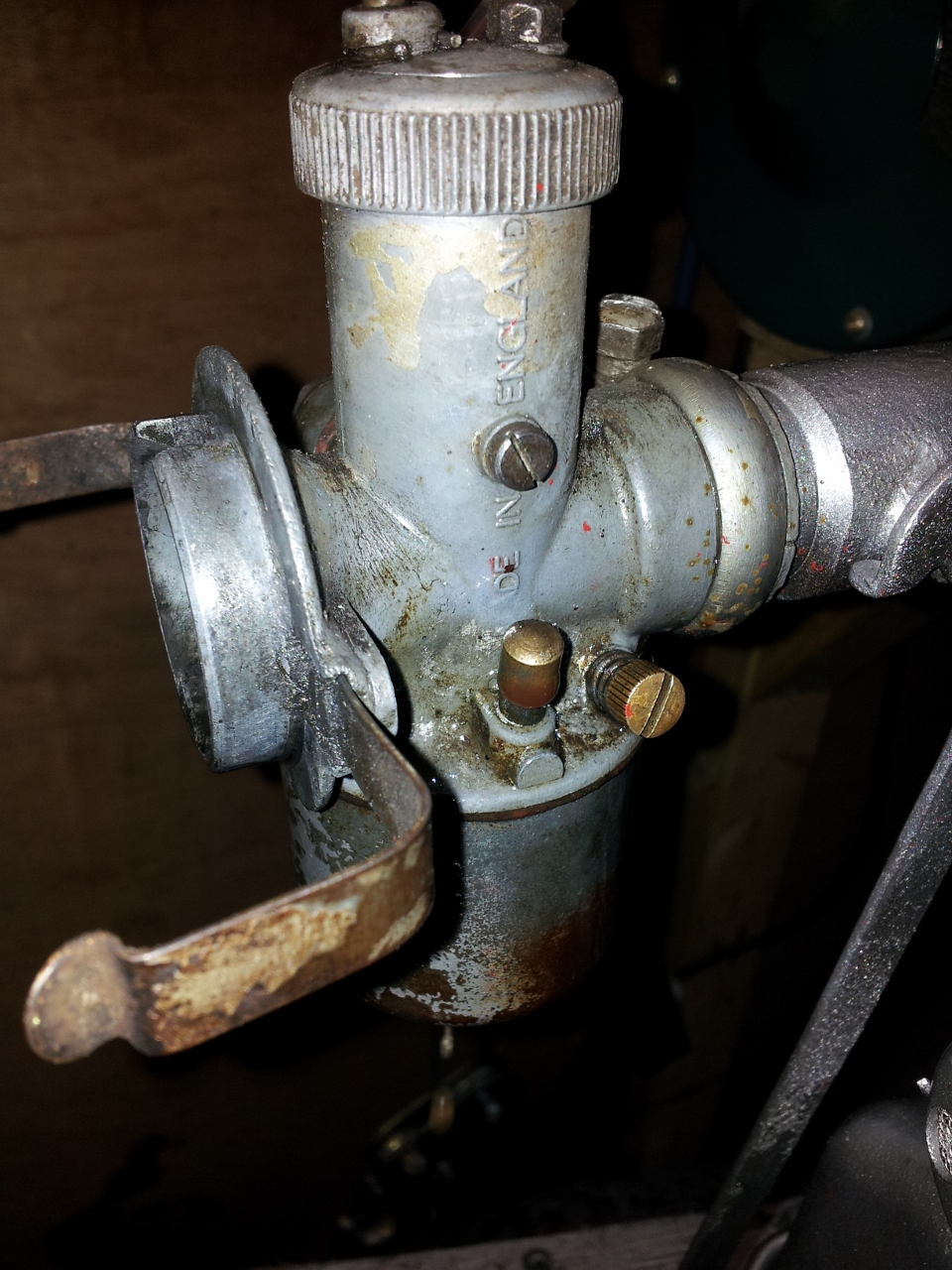

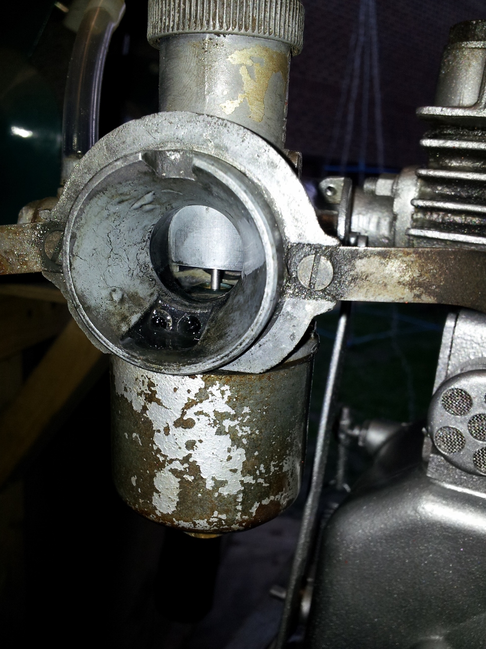

vhgmcbuddyMemberI had the hand throttle turned as far down as it would go,so now I think that the next time it is run to gently alter the govenor and get it to run more slowly. if I need more throttle I can always adjust manually on the throttle lever. Forgot to add the choke in the carb above surrounds the throttle slide from top to bottom. to operate there is a long rod which comes out of the top of the carb where the fixing ring is.
December 15, 2013 at 5:35 pm #4104andyfrost
ParticipantJohn , the needle and seat assembly is common to all those variations of Villiers carbs.
