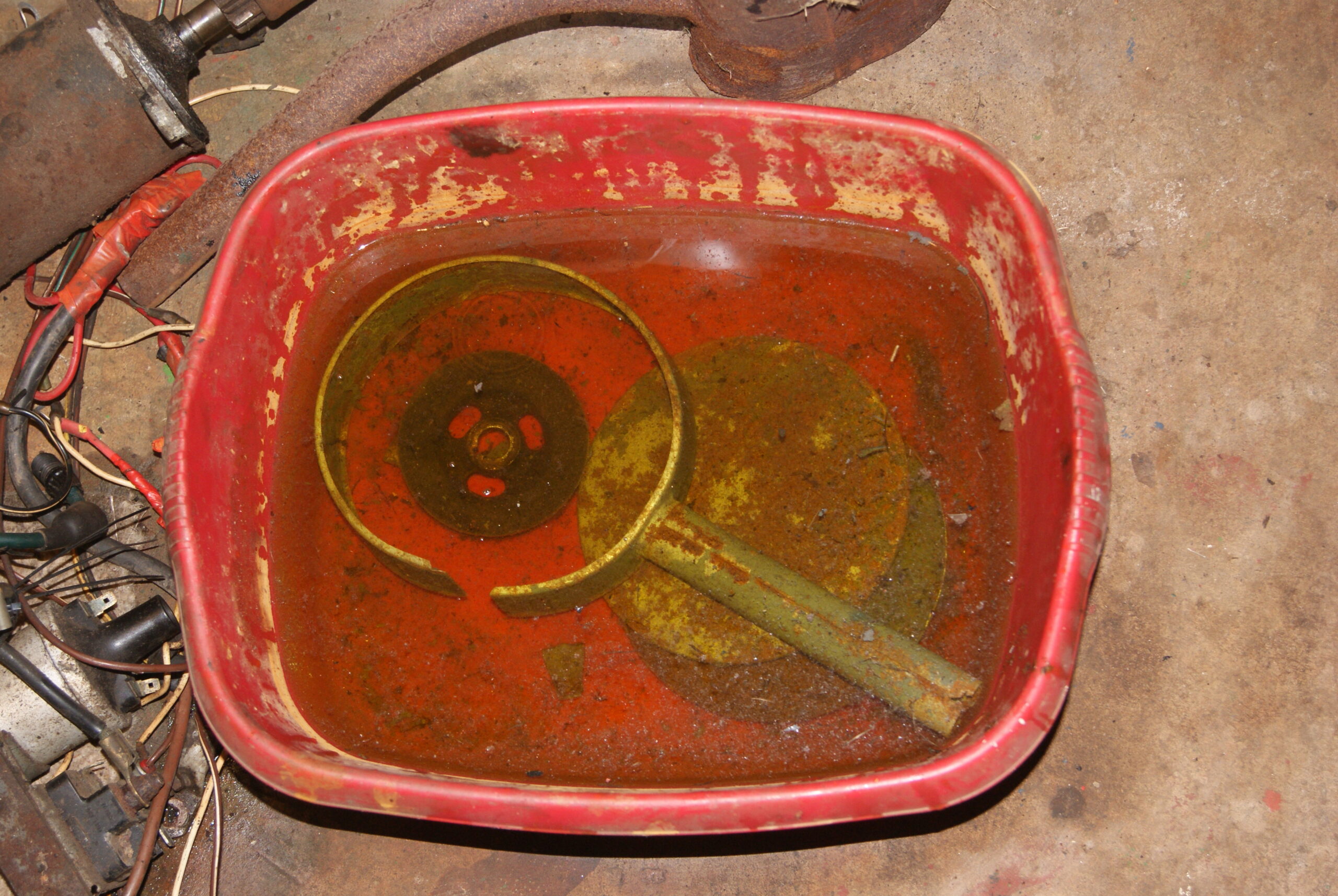

You will see from the pictures that the manifolds are now cleaned and re-fitted; the exhaust manifold came out clean as a whistle from the electrolysis so I treated it to a coat of high temperature paint to stop it rusting again. Both manifolds are attached with brass nuts to prevent corrosion which you may also pick up from the pictures.
The mower had a good clean today with some of Charlie’s degreaser from Screwfix. It is good stuff and at less than £10 for 5 litres it is good value but you do need to leave it to soak in, then rub it gently with a brush whilst washing it with water. I dowsed the whole mower with it and washed it off with a hosepipe, brushing it with a 2″ paintbrush and it really did get it clean. The only trouble is the dirt was hiding an awful lot of rust and paint loss so the machine looks a lot worse now for being clean.
The air filter housing needed to be cleaned gently so I’ve left it to soak for 24hrs in brick cleaning acid. It will have a further 24 hrs in a solution of bicarbonate of soda to neutralise the acid, then a thorough wire brushing should get rid of all the paint and surface rust.

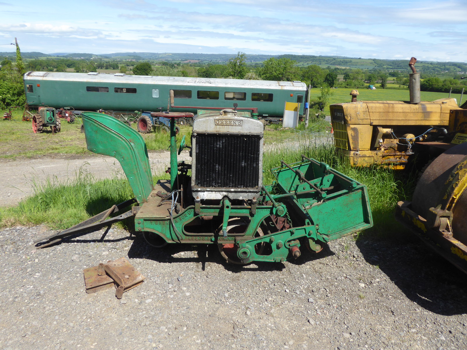

trusty220KeymasterIt will make a change from Trusty stuff, but I think I’ll finish the Allett first! There’s some interesting stuff in the background as well, do you need a hand to collect it?
May 29, 2022 at 6:55 am #39116
will-haggleParticipantOh Ahh, I do know where that be, down near Glass’nbr’y I’ll warrant!

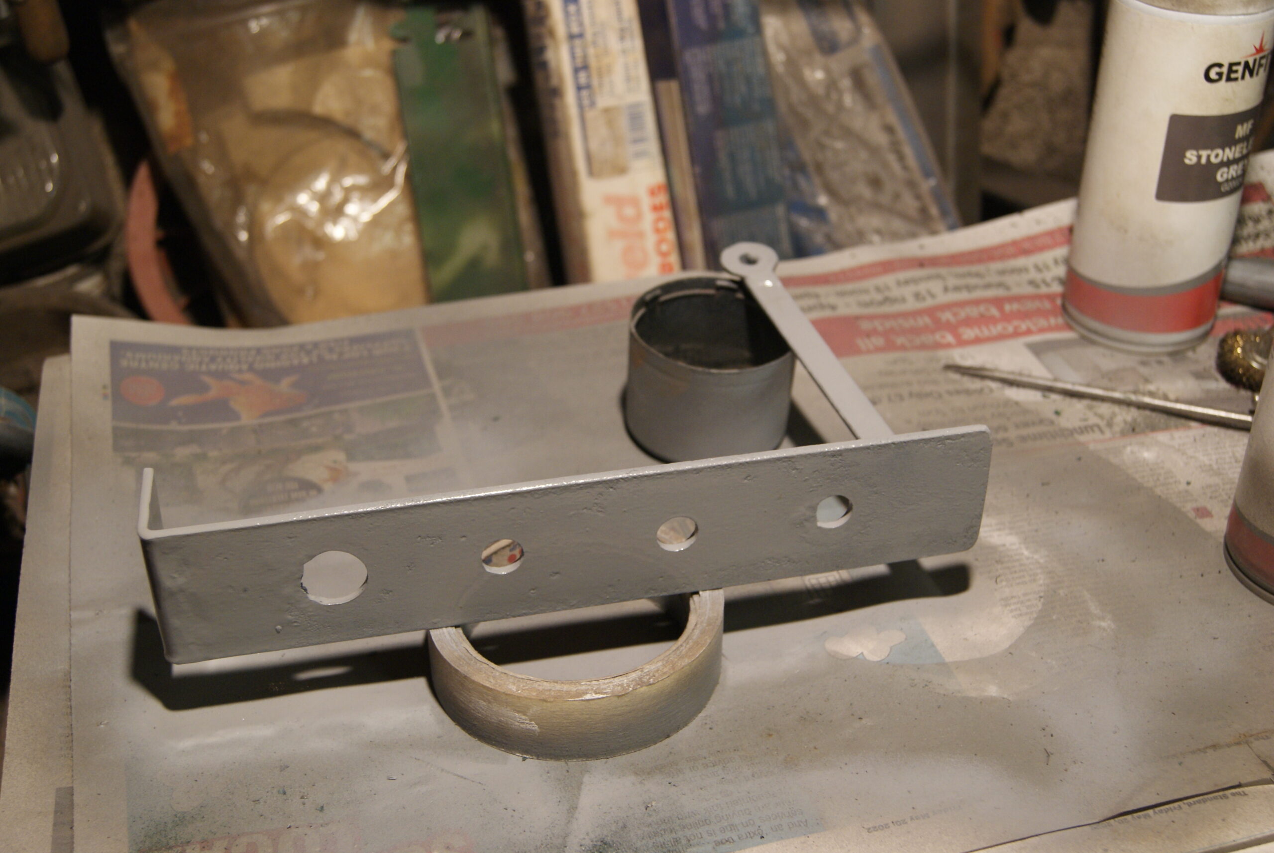

After the cleaning last weekend it was obvious that the rust had taken more of a hold than I had first thought. If I’d brushed up the rusty patches and painted them it would have looked awful so I decided to remove the large front crossmember which also incorporated two engine mountings. To keep the chassis in the correct shape I thought that if I put two wooden wedges under the engine to take the weight I could then undo the two end screws and remove it. There are two further crossmembers at the back of the engine so if I replace the front one before removing one of the rear ones it should always have two crossmembers attached at any one time.
The front crossmember is now cleaned off with a wire wheel and primed with grey primer. There are some other brackets that are undergoing the same process with the acid and soda and will also be painted with primer before having a coat of Allett green. The starter motor, fuel pump, radiator, cowling and distributor are also ready to be re-fitted once the chassis work is completed; the dynamo is with the local auto electrics expert who thinks he can resurrect it with a bit of work.
That’s about all for this update. Cosmetic work always takes time but it can either break or make this kind of job so it’s worth taking the time to flat things down, fill any blemishes then flat and fill endlessly until you’re satisfied enough to put the paint on.

trusty220KeymasterI thought for this update I would start with some comparison photo’s of old and new so you can see what’s available. I’ve also included a photo of the exhaust downpipe so you can see what kind of results that you can get from using the brick cleaner method of de-rusting; the dividing line is very clear cut and you can see for yourself why I do it. It’s ideal for more delicate items that won’t stand up to rotary wire brushing and it does leave the surface clean and rust free with no brown staining.

Paint has been the main topic this week with lots of parts getting cleaned off and re-painted using the matched synthetic enamel paint. Well worth it and the only way to get good results is to take your time; never be afraid to reject something if it doesn’t come up to standard, just flat it down again and try again until you get an acceptable result.
