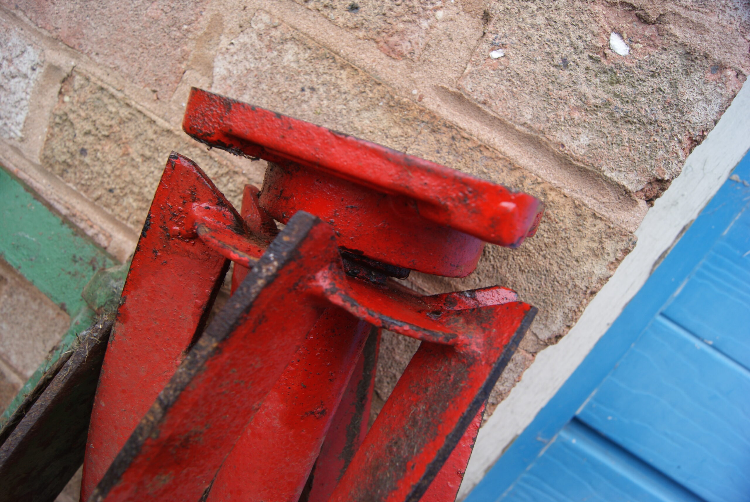

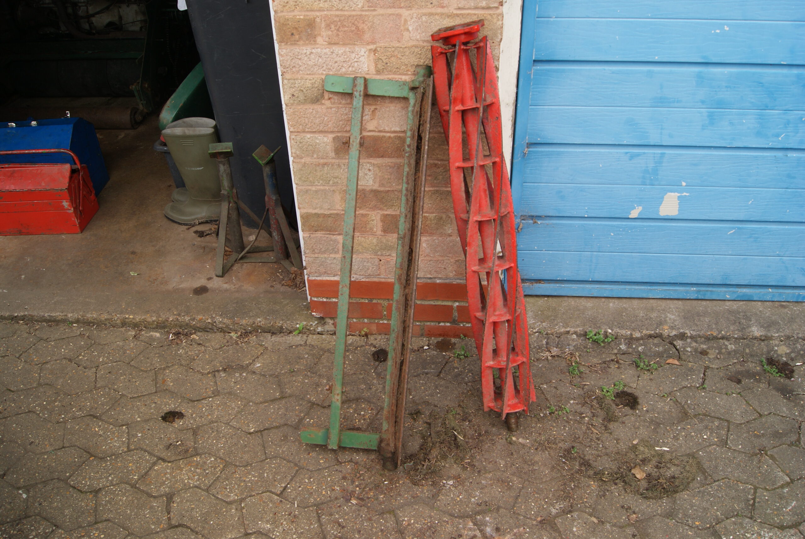

trusty220KeymasterNext on the agenda was the removal of the cutting cylinder and bottom blade carrier. The cylinder looked simple enough with four countersunk screws at each end holding the cylinder bearings to the frame, so I parted the chain, unbolted the sprocket off the drive end and removed it then attacked the screws. Luckily they all came out without too much trouble but the assembly would not pass through the gap, so the bottom blade carrier had to come off as well as the front roller.
It was a struggle- and I’ve found the first UNF threads which were on the front roller shaft- but after a while all of the screws and bolts gave in and I had the two pieces on the floor. Now came the trouble; the bottom blade doesn’t look too bad and could probably be saved with a light grind but the fillet piece on the carrier is rotten as a pear. On Ransomes machines it is usually made of wood (normally oak) but on this one it is a mild steel strip welded to the inside of the angle iron carrier, presumably to make it more rigid. The water and grass have got under it and broken some of the welds, pushing it upwards into the cylinder. As it is going to be for display only I think I would be justified in cutting it off and discarding it; it can’t be saved as it is too far gone, so I’ll make the decision once I’ve cut it off.

trusty220KeymasterThe cylinder and bottom blade are now with Allett Mowers at Stafford for sharpening. I hope they can face up the bottom blade as the screws look as if they’ve been in for some time; from experience I’m guessing that the countersunk heads will shear off if I try to move them leaving me with no alternative but to drill and tap each hole, quite a daunting prospect but not outside the realms of what’s possible.

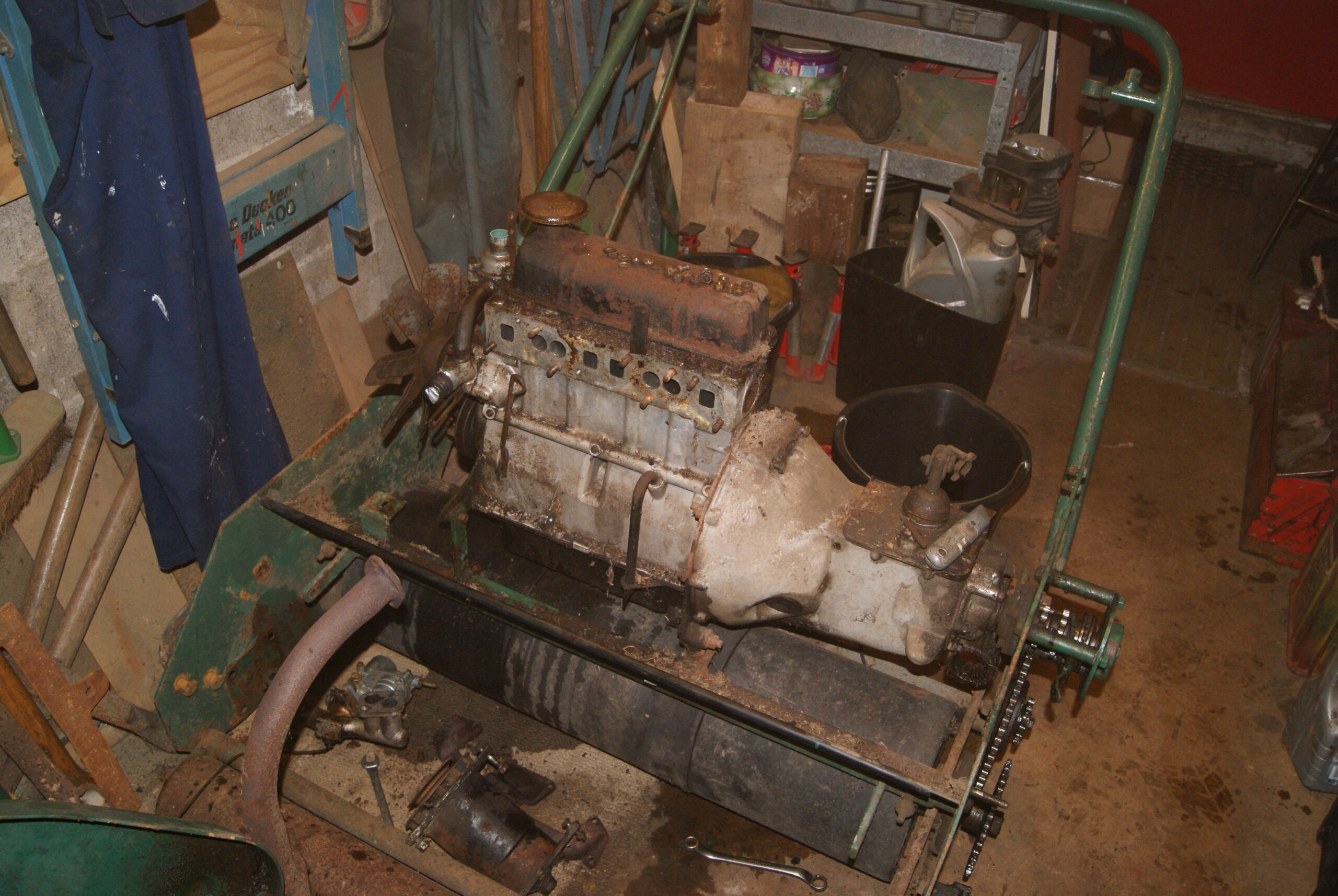

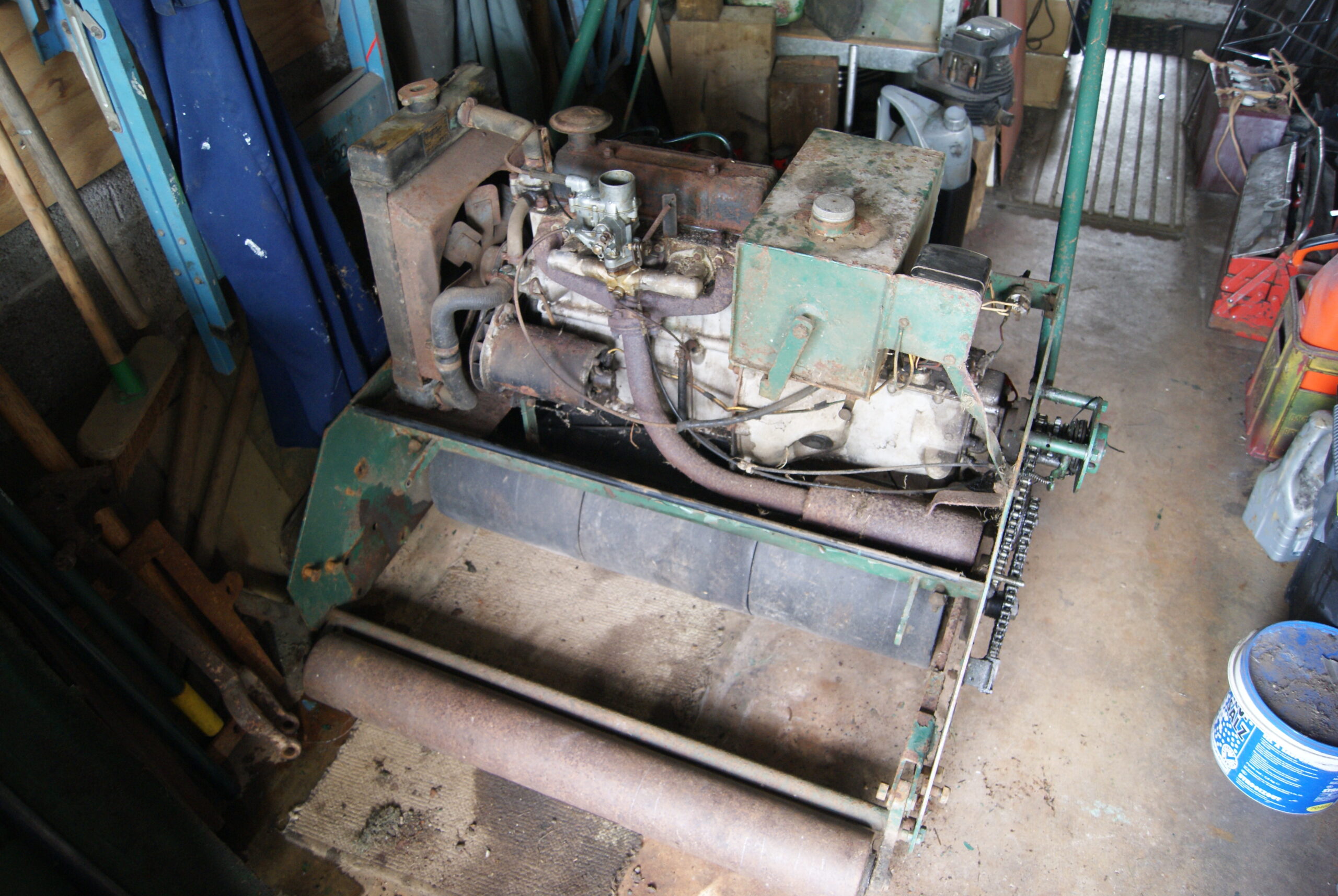

In the meantime I’ve been busy with the strip down. I simply could not put it off any longer now that I’ve got the engine running properly, so I took the whole weekend to carefully remove and catalogue with photographs all of the necessary details. One of the alarming finds was that the two wires coming from the dynamo to the regulator box passed behind the exhaust downpipe without any tie-downs and it was a miracle that the hot exhaust hadn’t melted the plastic and shorted out the battery. This will need to be addressed on build-up and the best way around it will be to pass the wires around the end of the block and along the side with the distributor and ignition coil. After all, it will keep the electrics all in one place and make it more practical.

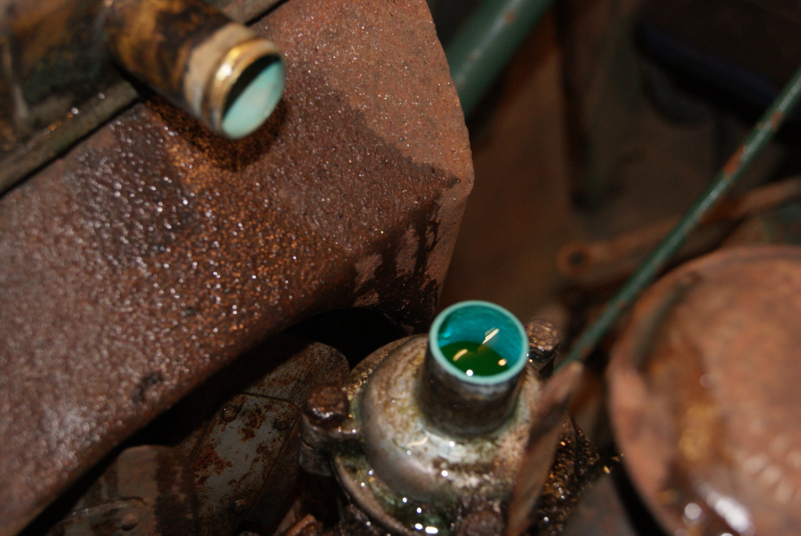

As we speak the mower is now completely bare of all of it’s ancillaries and the manifolds, exhaust, dynamo, starter motor, fuel pump, petrol tank, etc. are now lying in the corner waiting their turn on the bench. I took Roy Allett’s advice on the engine block and re-filled it with coolant once I’d removed the radiator. It was encouraging to see that the previous owner had kept up with the anti-freeze and there was no sign of furring or corrosion inside the waterways that are visible. I did have to make up a plug for the bottom hose so the block can sit there with coolant in whilst the hoses are off.
Tomorrow’s job will be to box up all of the hoses, gaskets and other consumables and set off to the Reliant specialist to see what parts he can sell me. It’s going to be a long struggle if he can’t help!
In the meantime I will be busy today making up blanking plates to cover the inlet and exhaust ports as well as the distributor drive and fuel pump access points. I do not want to get any dirt down inside the engine now that I know it runs so well. One of the dilemmas I had over the weekend was whether to have the radiator re-cored; the core is blocked with grass debris which I could blow out with the airline, but then what state are the solder joints in? At the moment they are watertight, but with a little vibration- who knows? For safety (and my reputation!) I think it wise to get it re-made and then the uncertainty is done away with.

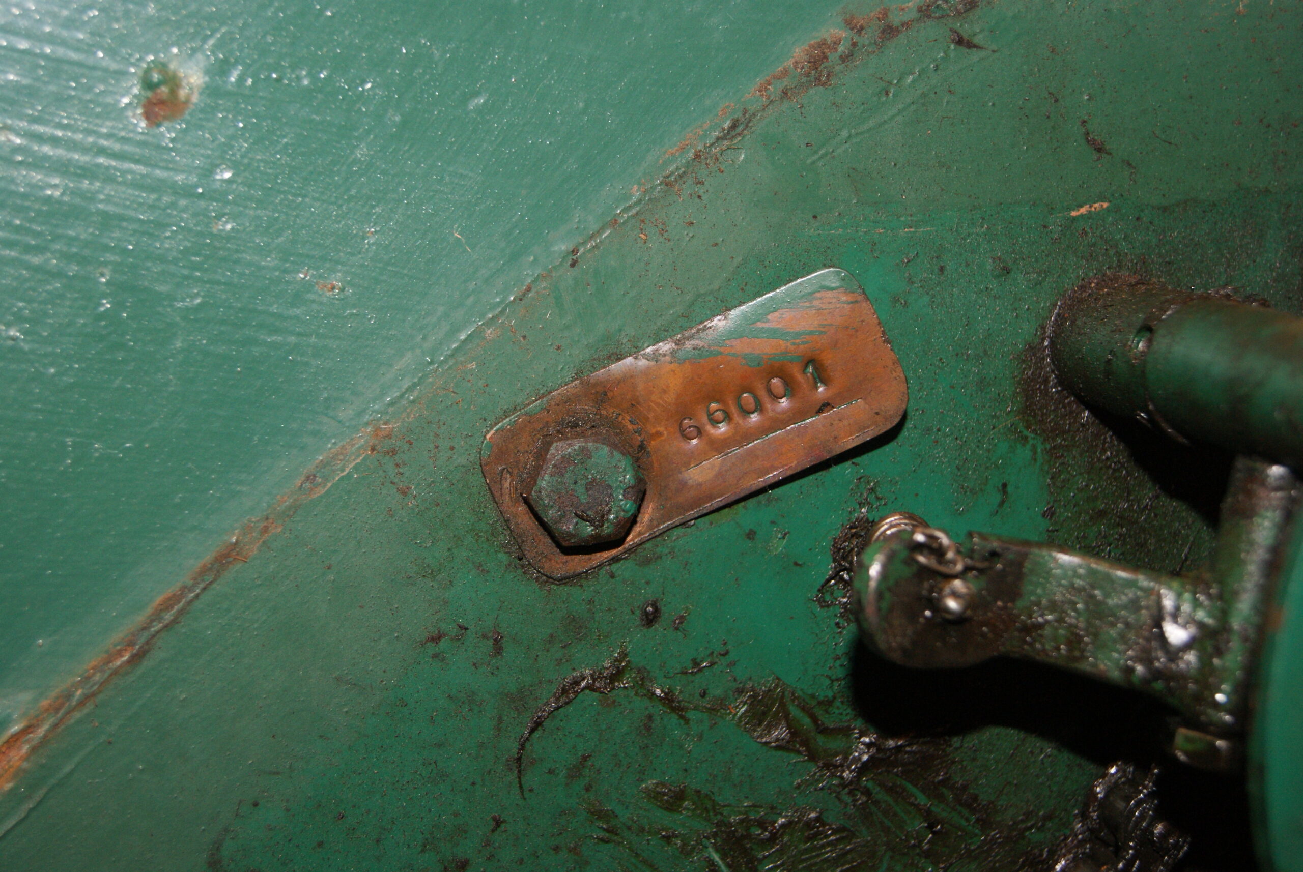

Before I forget, the one photo below shows the build number (or serial number) which confirms that this is the first production machine. The number is 66001 which points to it being made in 1966.

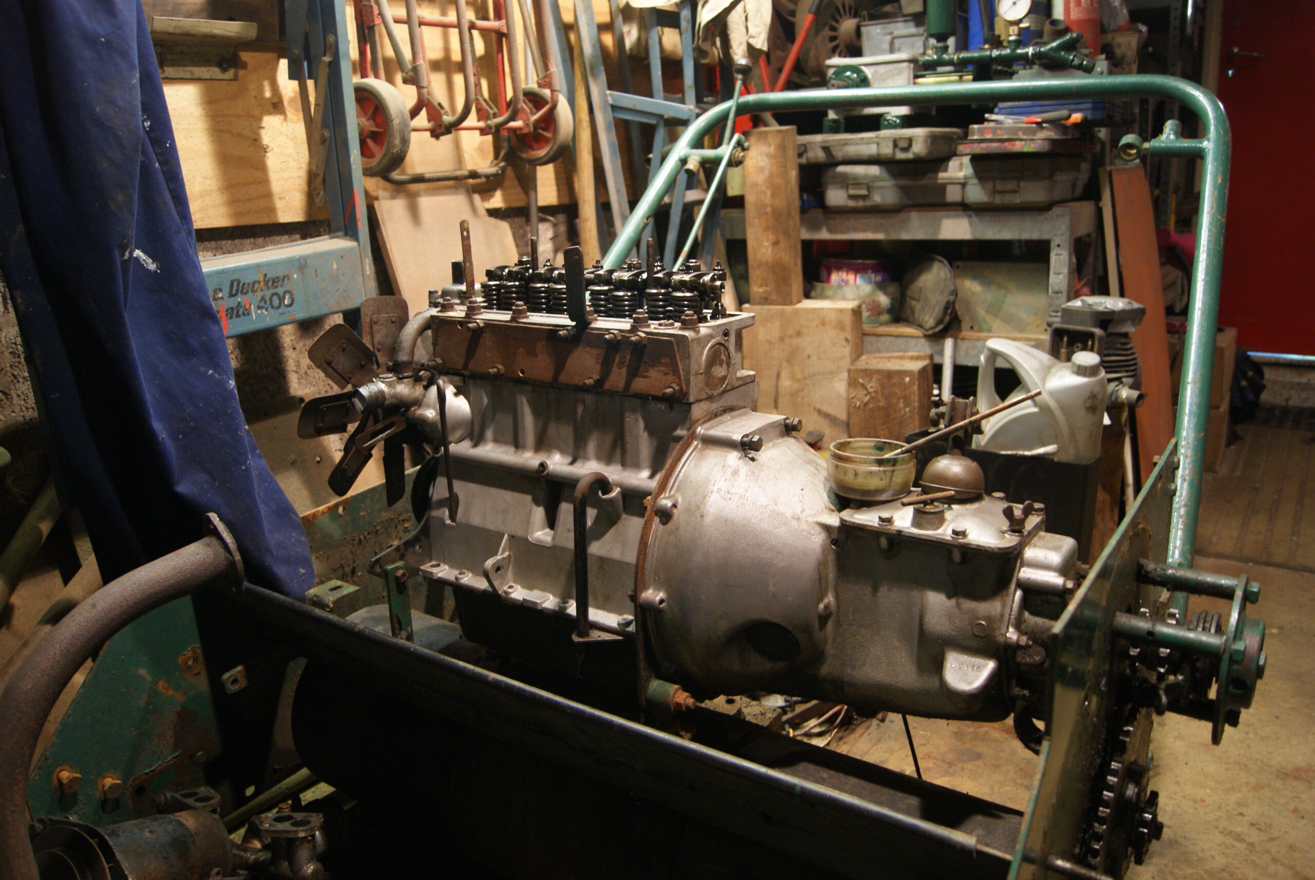

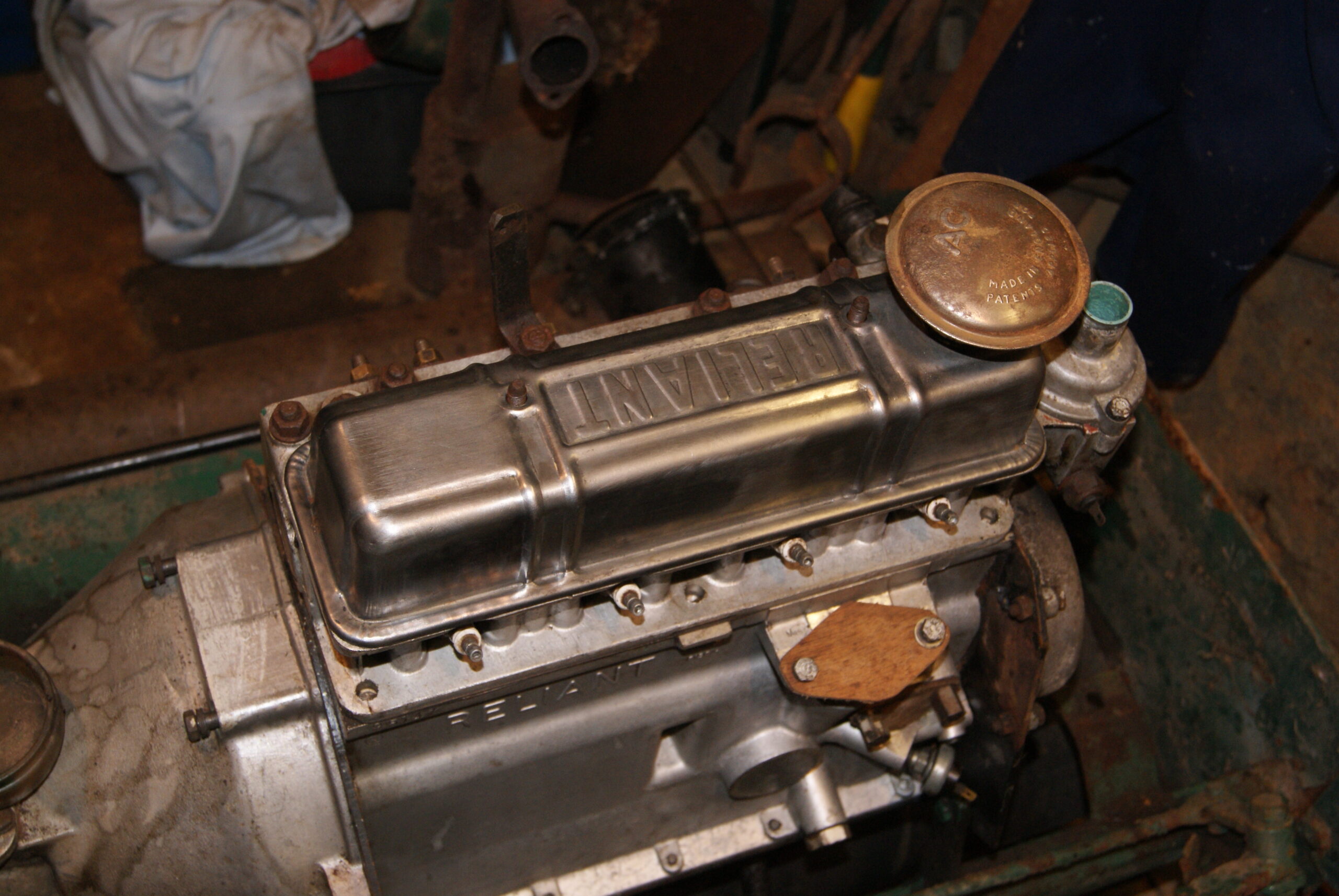

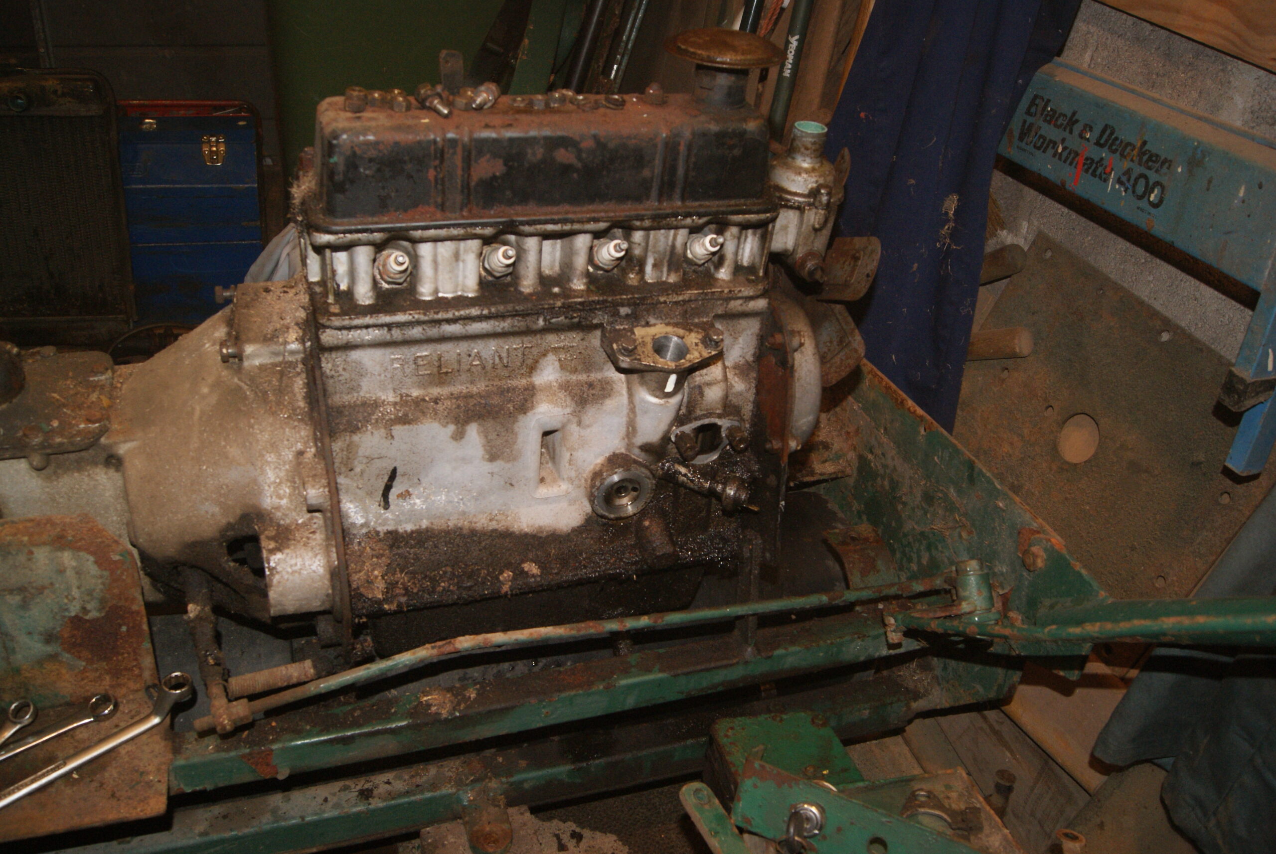

trusty220KeymasterThe engine and gearbox have now been thoroughly cleaned on the outside and what a difference it makes! Before everything just looked dull and worn out, but now the bright aluminium of the block and gearbox really do lift it. I would be lying if I said it was easy- I spent the whole day painting on brake cleaner then scrubbing it off, then repeating until all of the staining was removed. I could have achieved the same thing by blasting it with a steam cleaner but I didn’t want any water inside the workings and it would have taken some of the green paint off the chassis, something I want to avoid as it needs to be preserved rather than restored. The result speaks for itself and the brake cleaner was odourless, evaporating quickly after a quick wipe with a cloth; when I did the same with petrol to clean the carburettor I had to buy Mrs. Geoff a meal out to apologise for stinking the house out! Definitely brake cleaner from now on!
The next challenge will be to sort out the heavily pitted rocker cover. It needs to look good as it’s the first thing you see when you open up the covers, so a bit of panel beating to push it back out to the correct profile and lots and lots of wire brushing and sanding down to remove the years of rust.

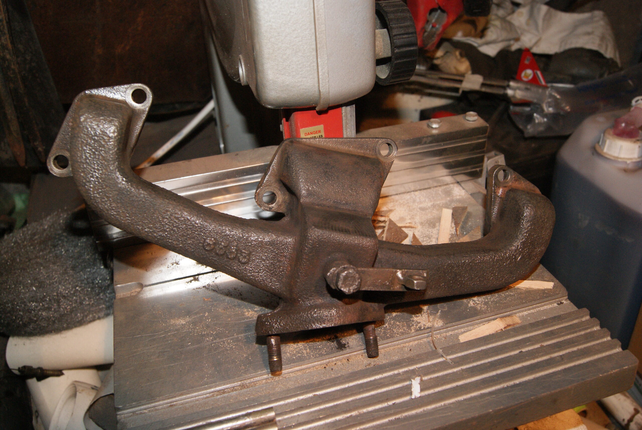

Whilst I’m doing this I’ve put the exhaust manifold into a bucket to de-rust it using electrolysis. Another odourless method but it takes a bit of time to do and must be done in a well ventilated space- my draughty garage is fine, but if you do it somewhere at home please be aware that the gas bubbles given off contain hydrogen, so if it builds up in a poorly ventilated room it can explode!

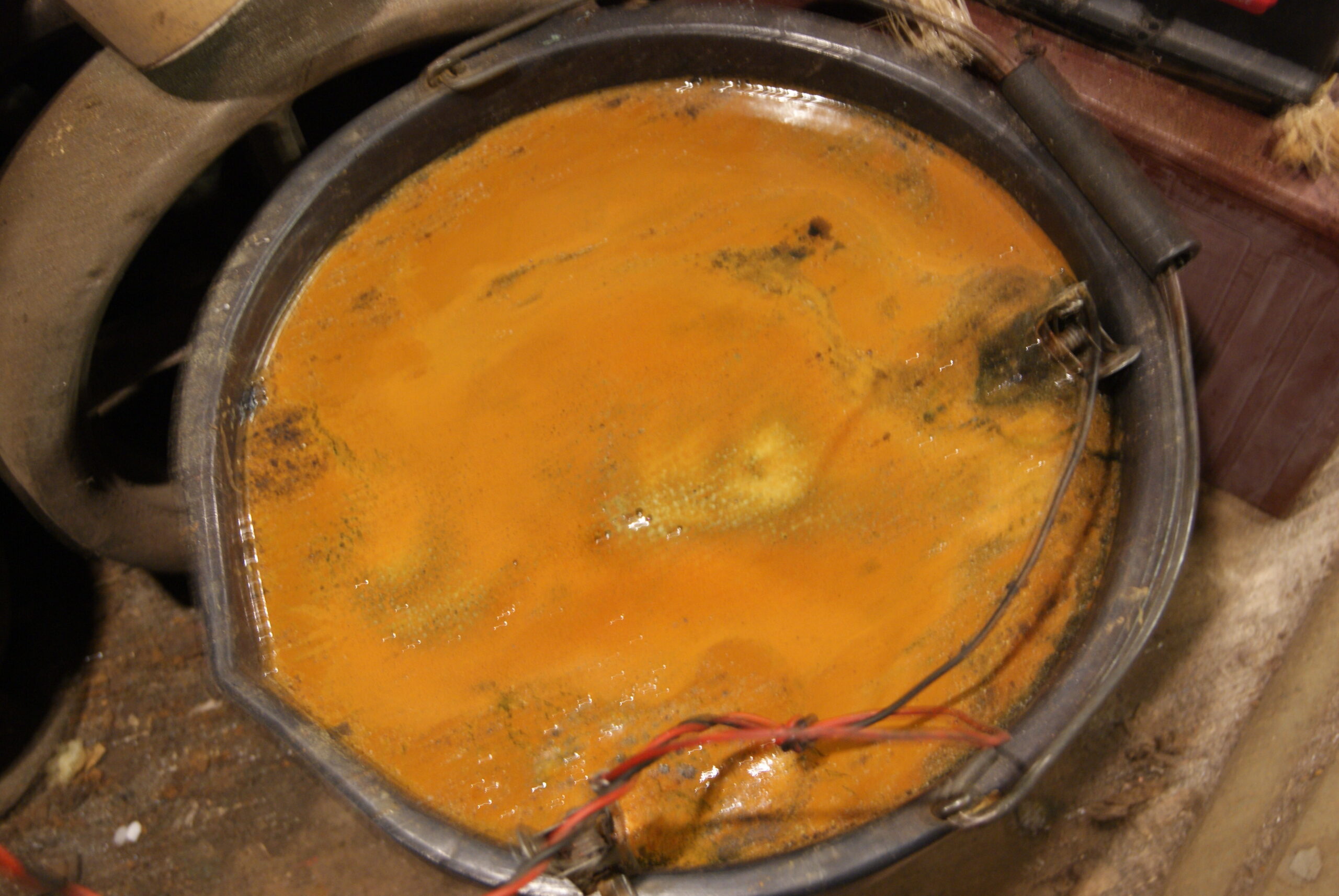

trusty220KeymasterIf you had any doubts about the efficiency of electrolysis for de-rusting delicate items, here’s the proof. The photo below was taken this morning, barely sixteen hours since I started the process, and you can see a thick layer of rust on top of the liquid in the bucket. It has removed all of the rust and all that’s required now is a wire brush and a coat of heat resistant paint.
The rocker cover is another story, however, and it has taken me simply ages to get it to a reasonable standard. Not forgetting that it will be the first thing people see when they open up the cover it needs to be in good order, and so it has had a thorough clean inside and out to remove all traces of rust. Now it’s nice and shiny I don’t have the heart to paint it black, but painted it must be!
