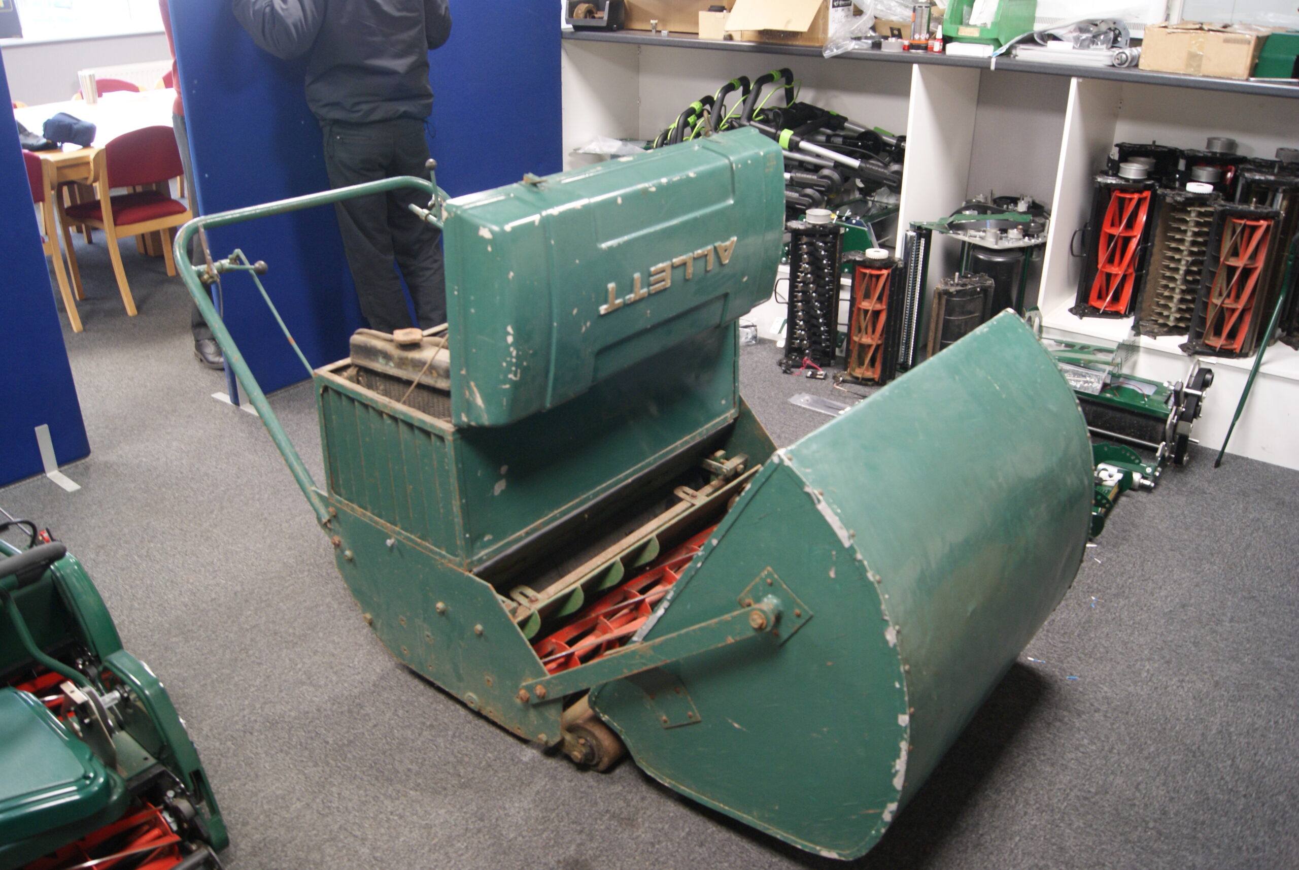

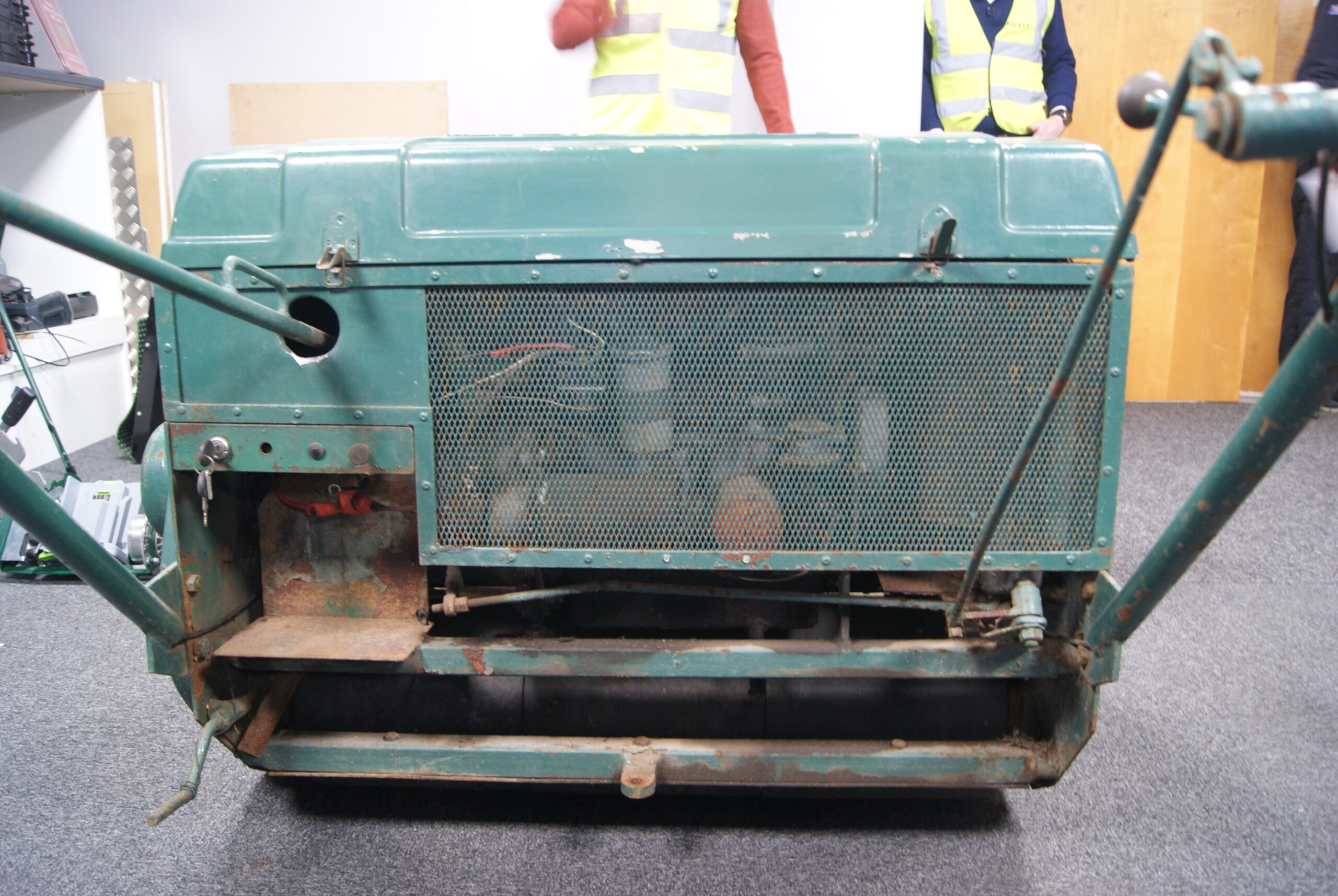

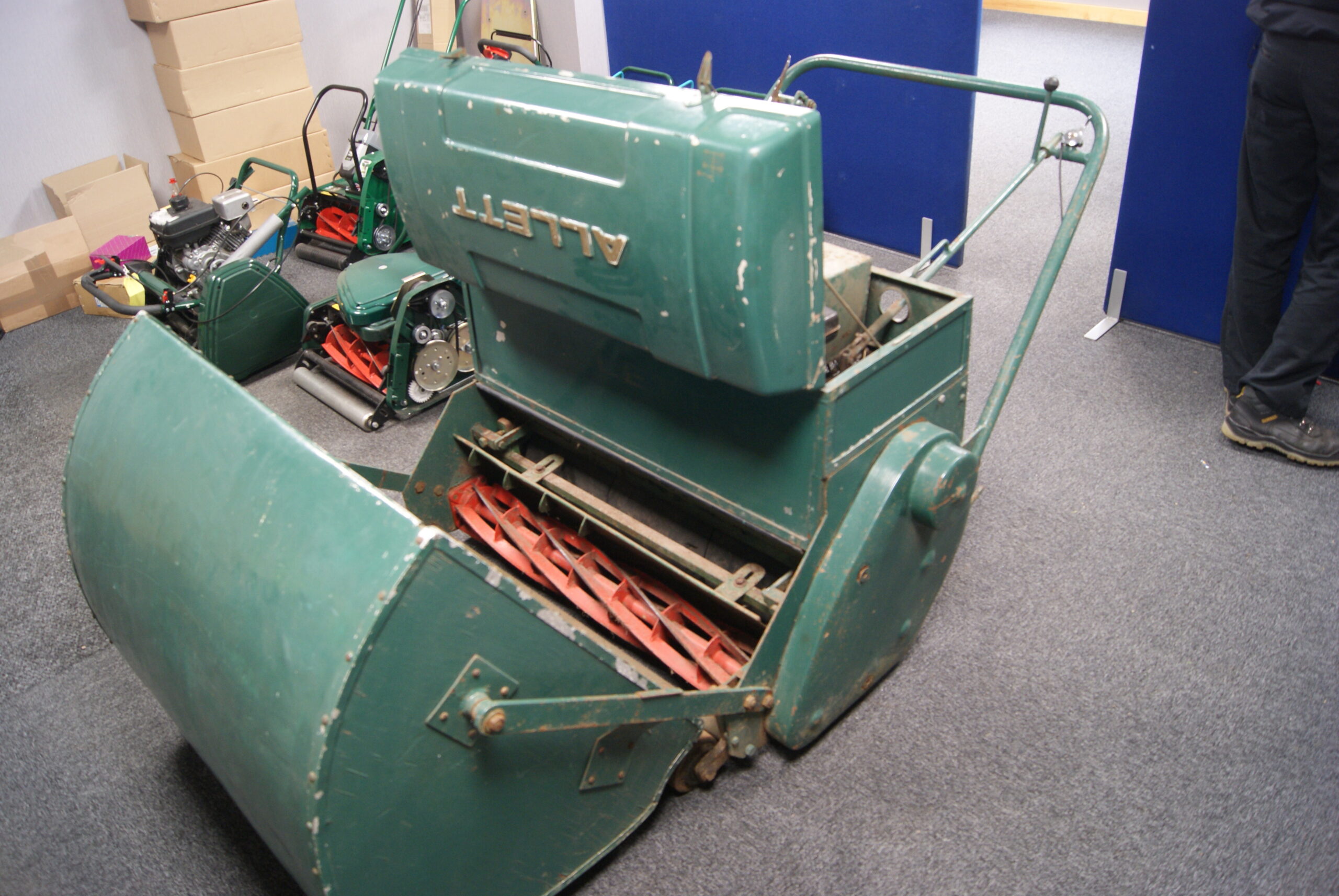

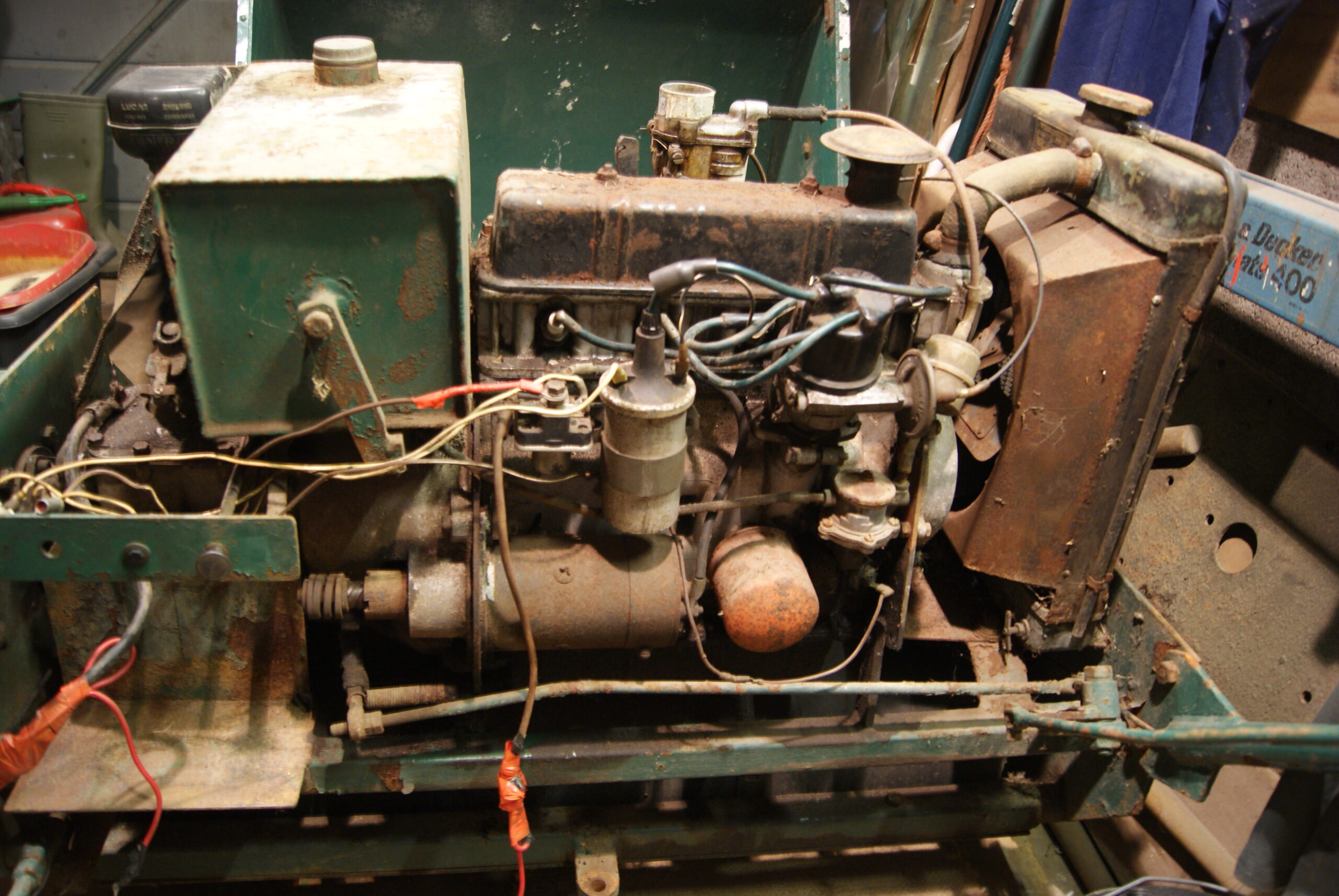

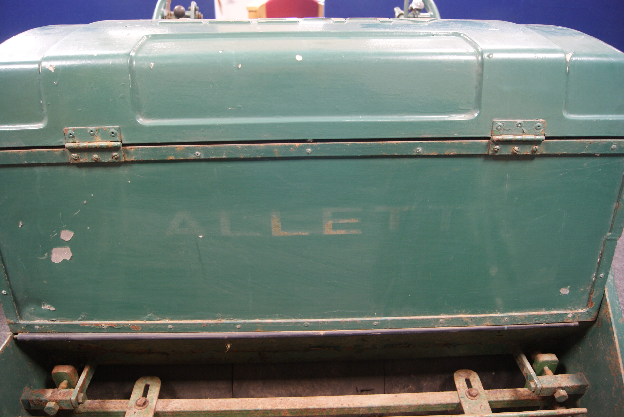

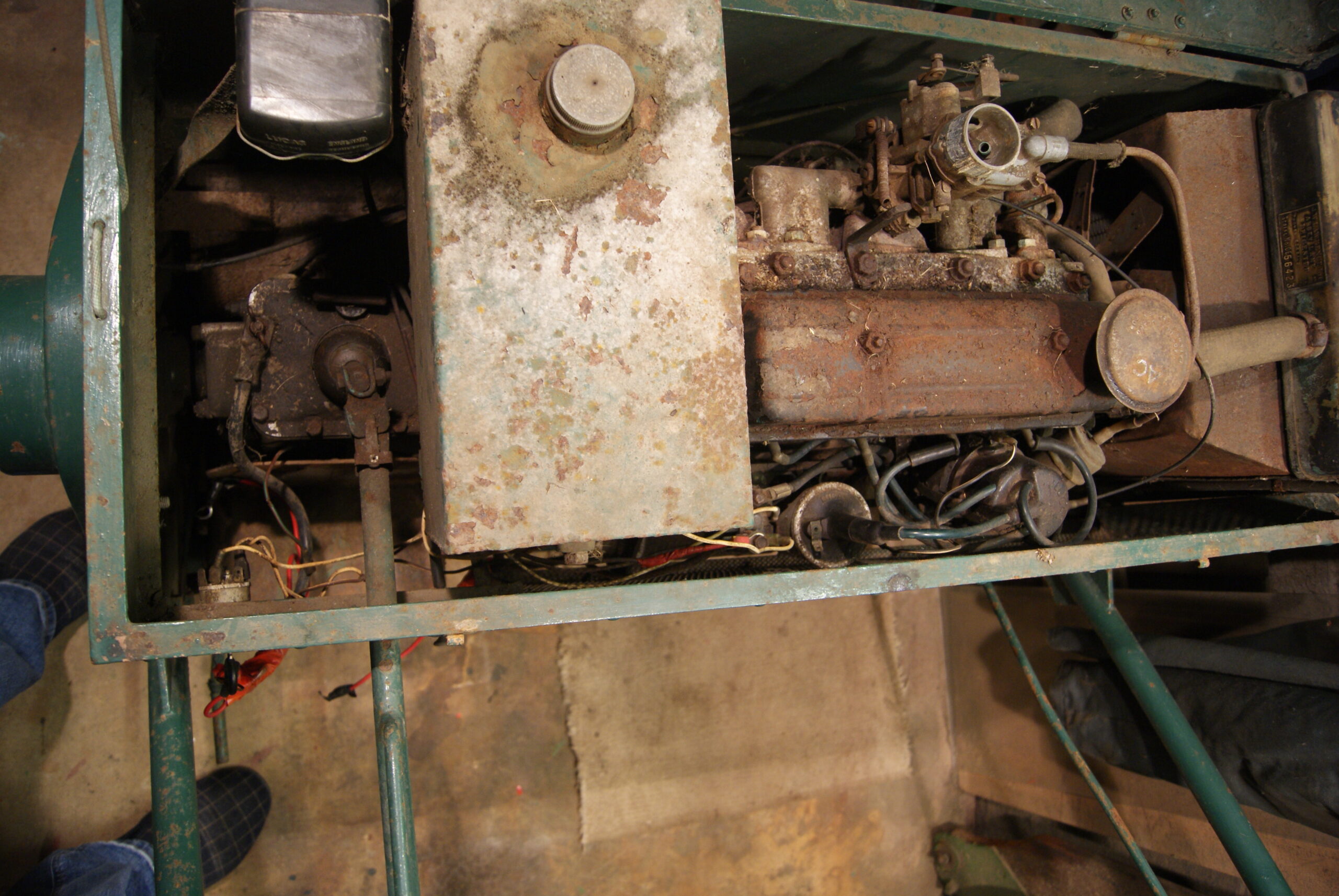

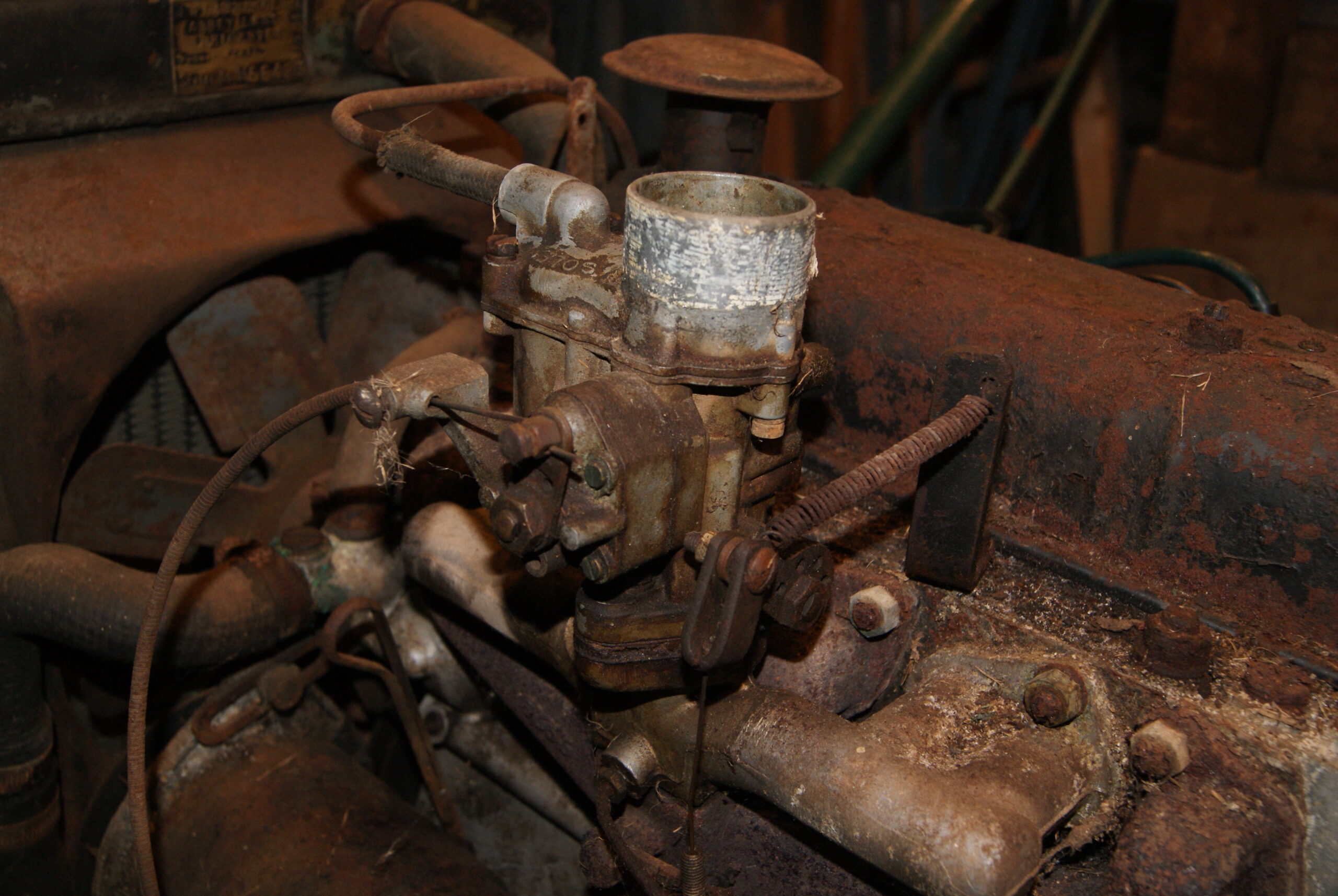

trusty220KeymasterHere are some pictures that I took of the mower whilst it was still at the factory. For it’s age it is in remarkably good condition and definitely needs preserving rather than restoring. A certain amount of paint re-touching will be necessary and the skill will be in blending it in with the existing paint.

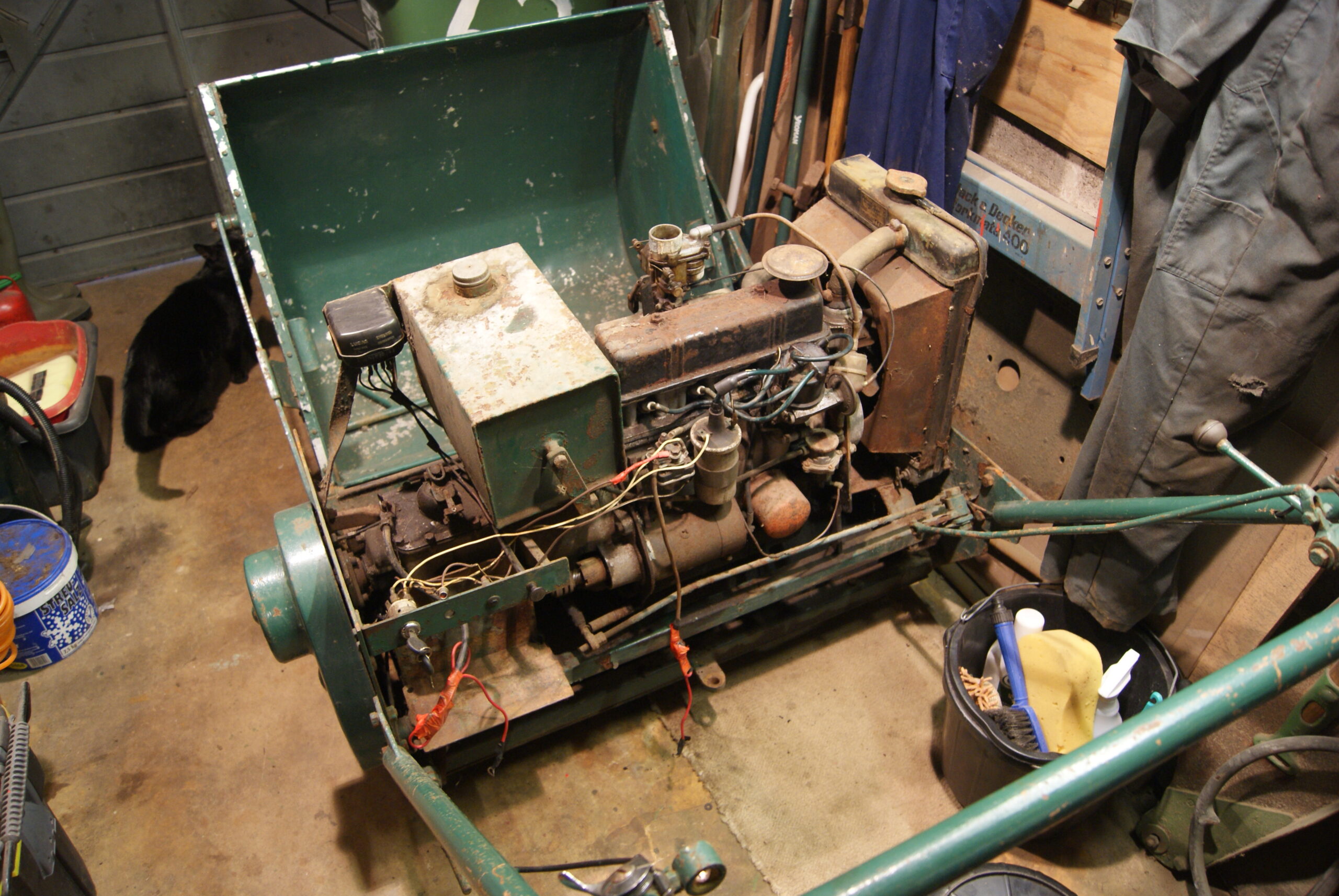

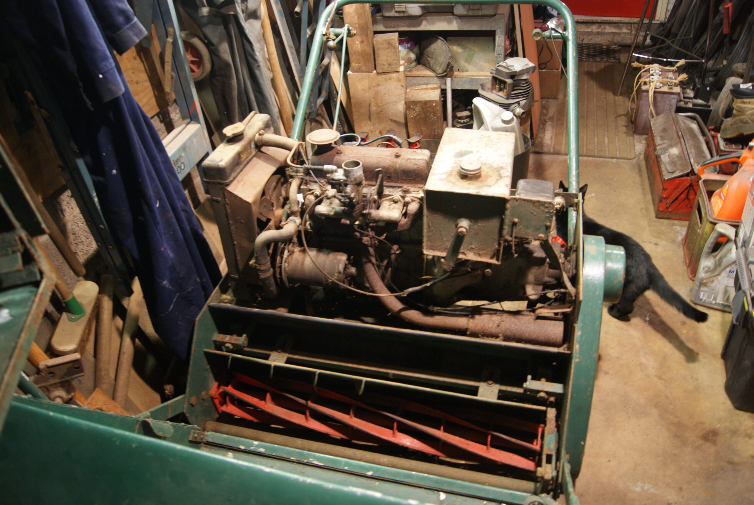

trusty220KeymasterIt lives! After a considerable amount of time and swearing the engine finally burst into life this evening. If I were to paraphrase Eric Morecombe, all the parts were there but not necessarily in the right place; the ignition coil took it’s live feed off the positive side of the starter solenoid which meant that the coil was live at all times even with the key turned off. The wire used was taken off and it was just the right length to reach to the correct terminal on the back of the ignition switch, so I’m guessing it was part of the original wiring loom. The way it was wired up would prevent anyone turning the engine off and it would have been a fire hazard, so it was indeed lucky to survive!
The ignition coil was only the first step, unfortunately. The live feed was traced as far as the contact breaker points before it vanished. Luckily the engine has a Lucas distributor; my GT6 also has a Lucas distributor, so looking in the stock I carry for it I managed to come across a brand new set of points complete with all of the insulating washers and bushes. The old points had one insulator missing which had the result of connecting both sides of the points to earth, which effectively meant that there was no spark at the plugs. Once put back to how it should have been in the first place the engine fired up and ran. The only thing now is that it will not idle even though the throttle butterfly is closed, so the carburettor is going to have to come apart.
Onwards and upwards, at least it’s coming together.

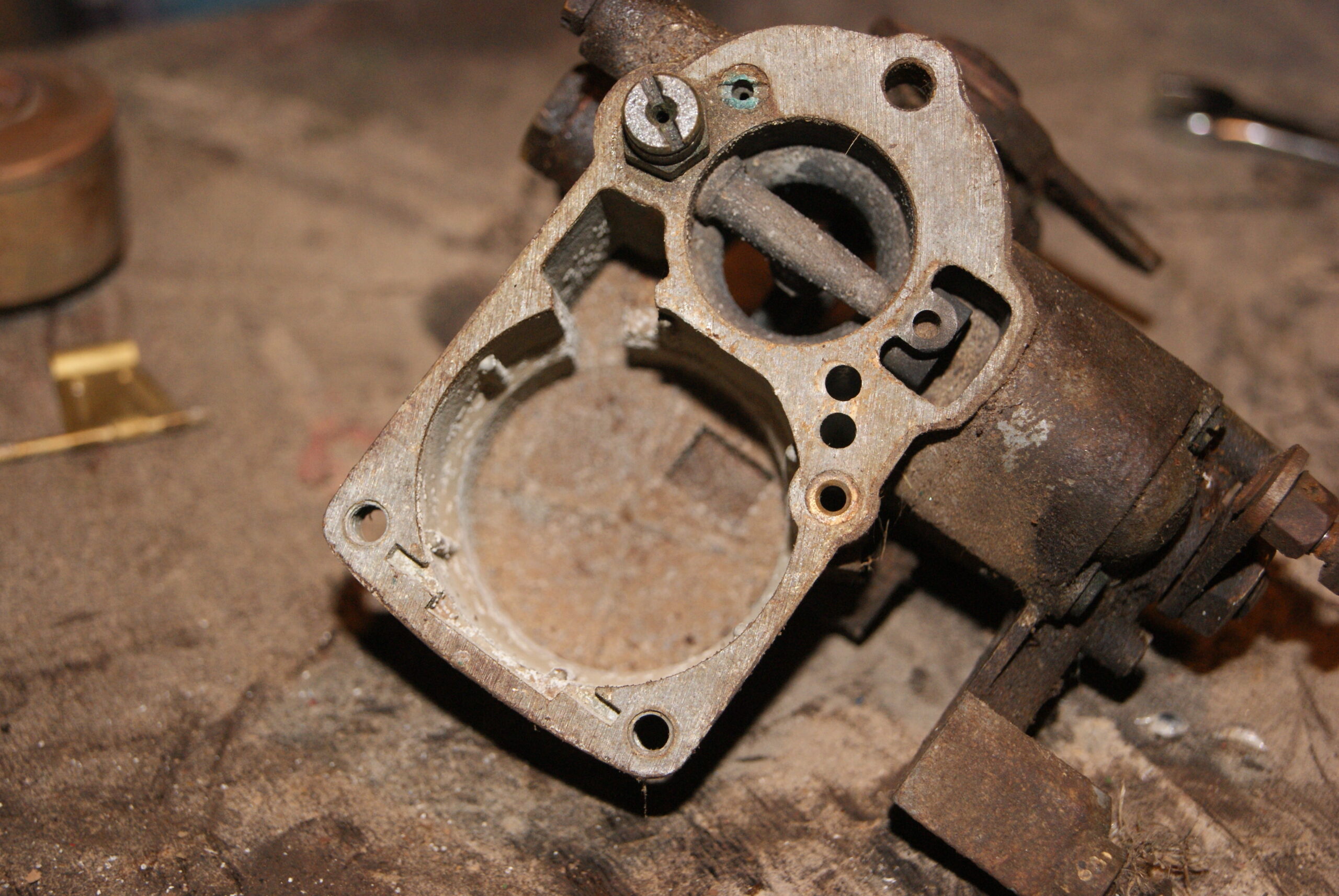

trusty220KeymasterI’ve spent most of the day on the Allett today. First off was to remove the grassbox and carrying brackets- I’ve got enough lumps on my shins from walking into Mastiff brackets so I’m determined not to add to the collection. Even the grassbox has had a lot of thought behind it so that the carrying bolts will act as pivots to empty it; the washers behind the bolts are stepped to provide a bearing surface on the carrying arms. I always thought that these mowers would be young enough to be made with UNF threads but all of the grassbox bolts and nuts are BSF. This theme was carried through to the thrower plate behind the cylinder, so I’m guessing that the whole mower is BSF throughout. Contrast that with the Reliant engine which seems to be UNF so far and it means that I’ve got most of my toys out of the box. I haven’t come across any metric threads yet but I won’t make any rash predictions at this stage.

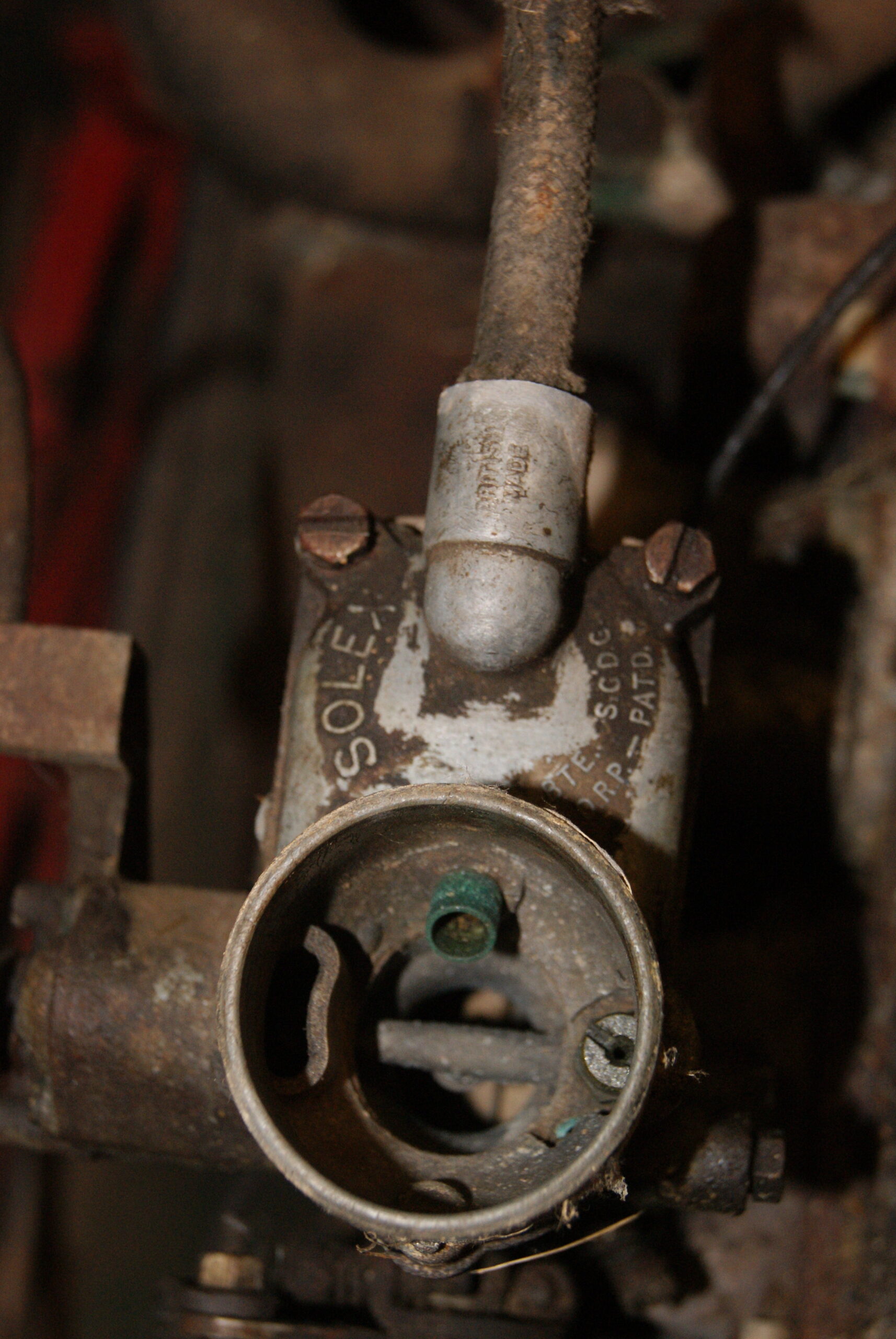

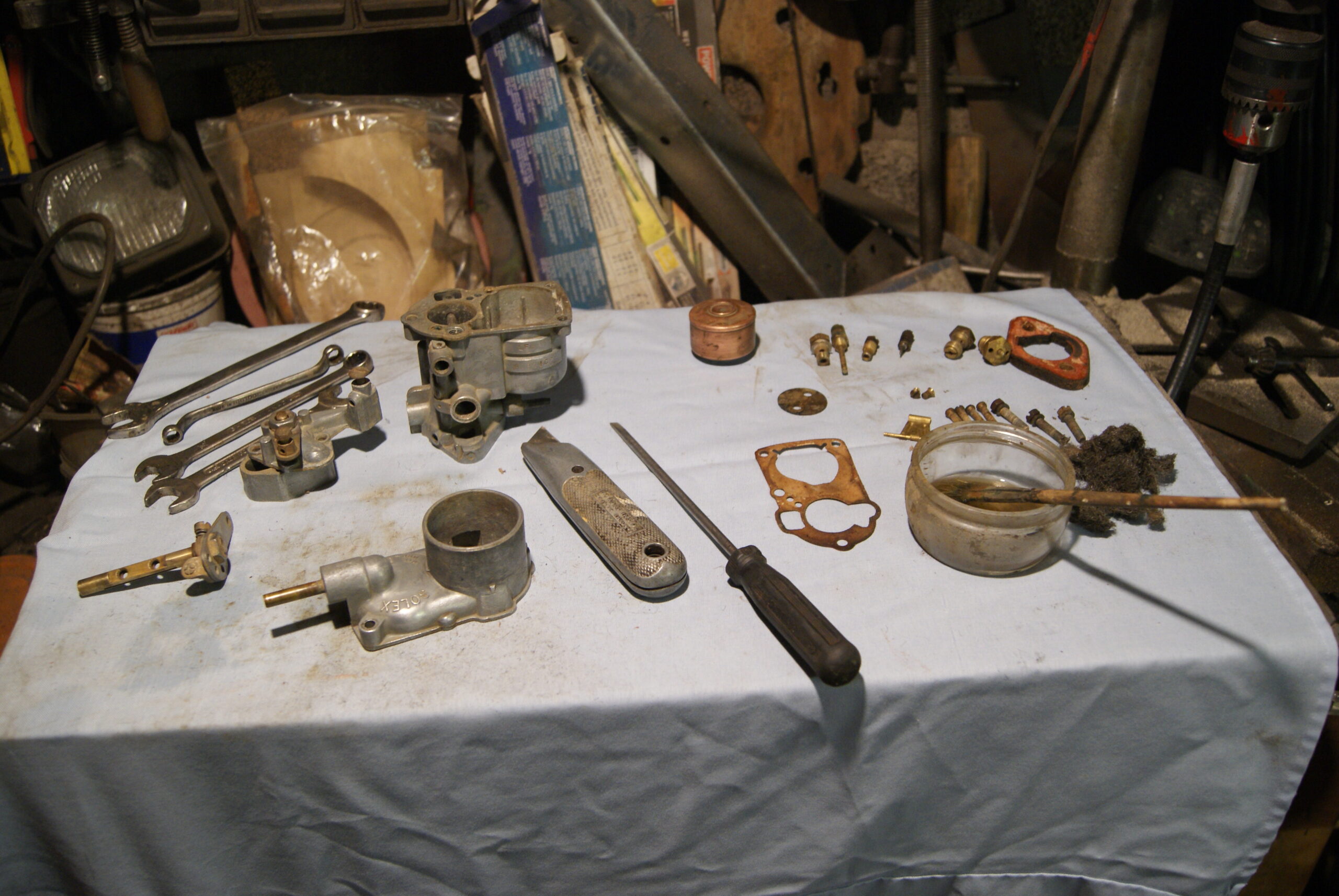

First major target for the day was to get the engine running properly, so off came the carburettor for a thorough clean inside and out. I always find that brake cleaner works the best on baked-on dirt on the outside but in this case it was that stubborn I had to soak it in a bath of petrol then rub it with fine wire wool. Several applications later it was good enough to pass muster so I started putting it back together; luckily there was nothing really wrong with it and the excess fuel causing the engine to run too fast was down to the choke assembly sticking inside the body of the carb. The actuating arm on the outside was in the correct position but the internal mechanism is pushed back to the “off choke” position by a spring- this was stuck with debris, so a good clean achieved the desired result.
In order to remove the carb. it was necessary to take off the rocker cover so that I could reach the nut on the inside of the flange. Whilst the cover was off I took the time to address the rattling tappets. The gaps varied between 6 thou and 12 thou in no particular order, so they were all adjusted to 8 thou as recommended by Roy Allett. He really is a mine of information and when he called me on Friday he gave me quite a few pointers from the time he used to make and market these machines. Apparently the factory used to remove the thermostats from the engines as well and block the bypass hose with a cork to improve the flow rate through the tiny radiator to prevent overheating in the summer months. This is something we used to encounter with some of the Ransomes machinery if lazy operators didn’t keep the radiator screens clear of grass cuttings, so I can entirely relate to his comments!
Anyway, all put back together and I fired the engine up again. The rattling had almost disappeared completely and once the engine reached operating temperature the choke was pushed in and the revs dropped down to an acceptable level. With a few adjustments a lovely slow and even tick-over was achieved, so target achieved and a well-earned beer downed!

daveParticipantPicture no 14. Is that your best table cloth? Get it in the washing machine quick before
Mrs R, she who has to be obeyed finds out.
For cleaning carbs etc I use 28 second heating oil and an ultrasonic cleaner.
