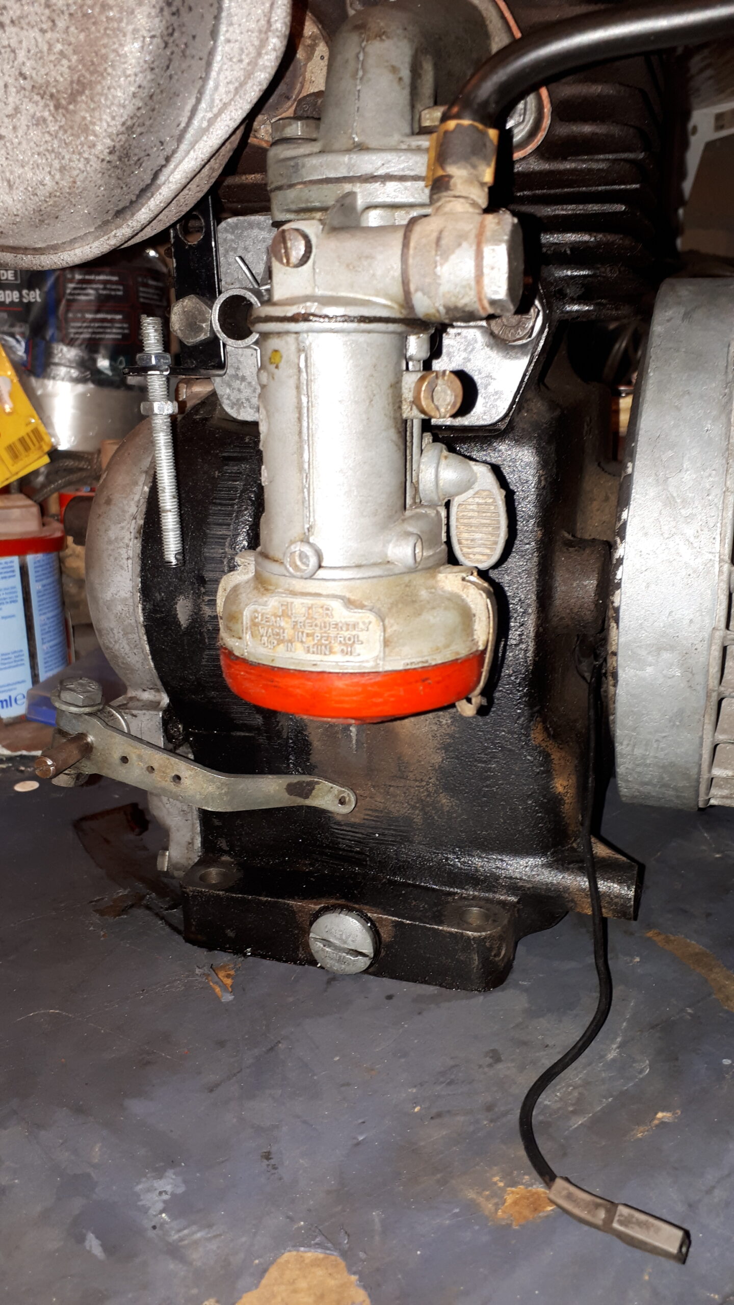

One additional question: my carburetor is a Villiers B.10/1. Which direction should the needle on the float be oriented? up or down? When re-assembling the carb I put the needle down, but I was not sure and the manual would not give that detail.
Of note that the engine works well with it’s carburetor and muffler. I filled up the carb hose with fuel (around 10 ml) and it worked for a few seconds. There is a small leak at the hose so did not dear using any temporary tank to get it running longer and do any carb adjustments.November 19, 2020 at 2:25 pm #35915andyfrost
ParticipantThe needle end of the float is uppermost , to seat in the brass seat in the top half of the carb.
Your carb has a fixed main running jet , the only adjustment is the slow running jet , wind it in to rich , out to weaken.
You may have damaged the needle by fitting it upside down , so check it before re-fitting.Andy.
