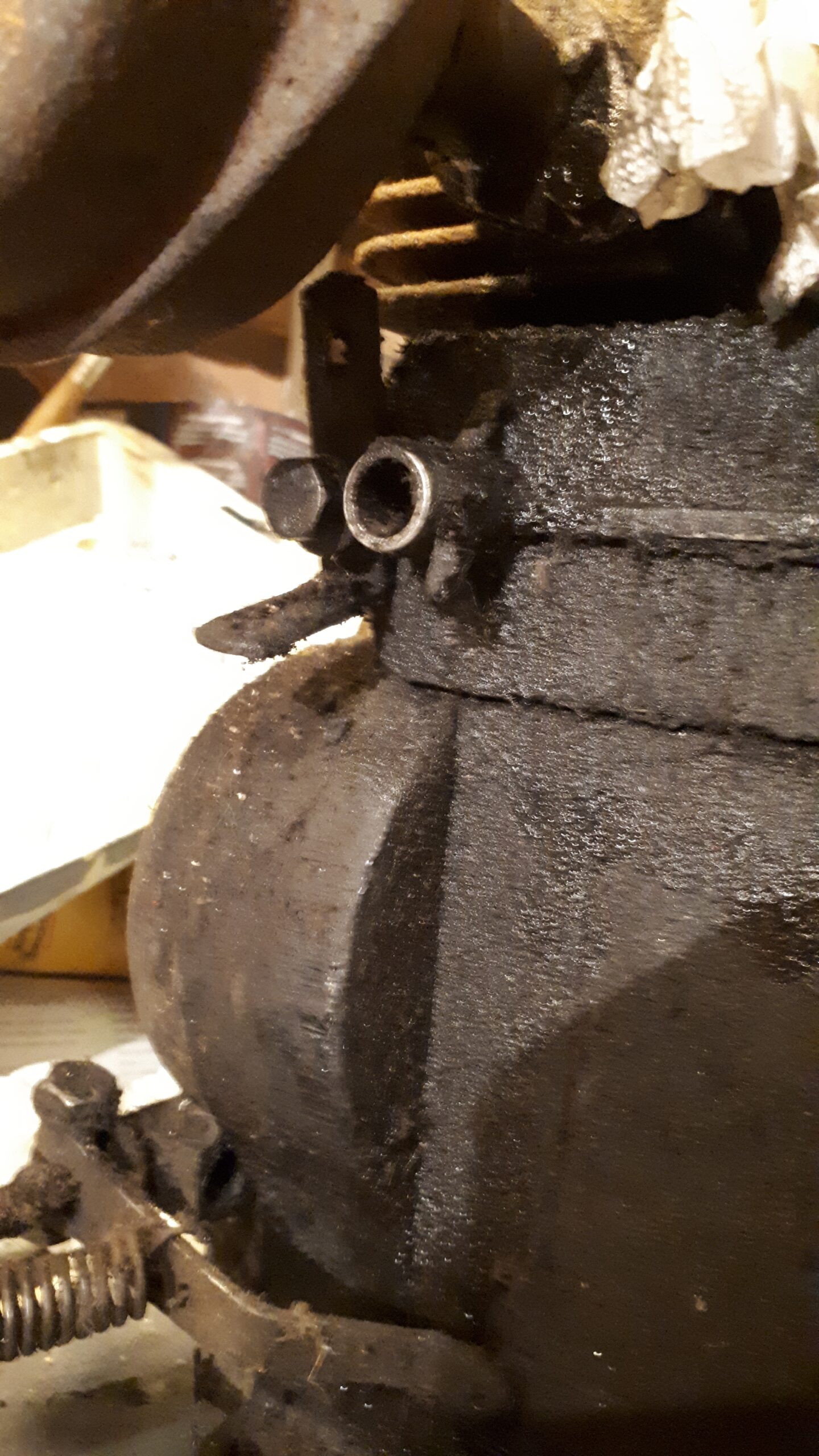

    The bracket on the valve chest cover is there, but what I am wondering is if there is anything between this bracket and the spring, something to adjust the load of the spring as I have seen on some videos on youtube.
    Jeff
    #35788
    “something to adjust the load of the spring”
    That is precisely how it works , a threaded adjuster for fixed revs , or the end of the cable for variable.
    Keith , we’re talking flywheel magneto here , not a CJ or A series which are of course seperate mags.

    Dear Andy and Keith
    Here 2 pictures that I kept on my phone. I am clearly missing the adjuster.

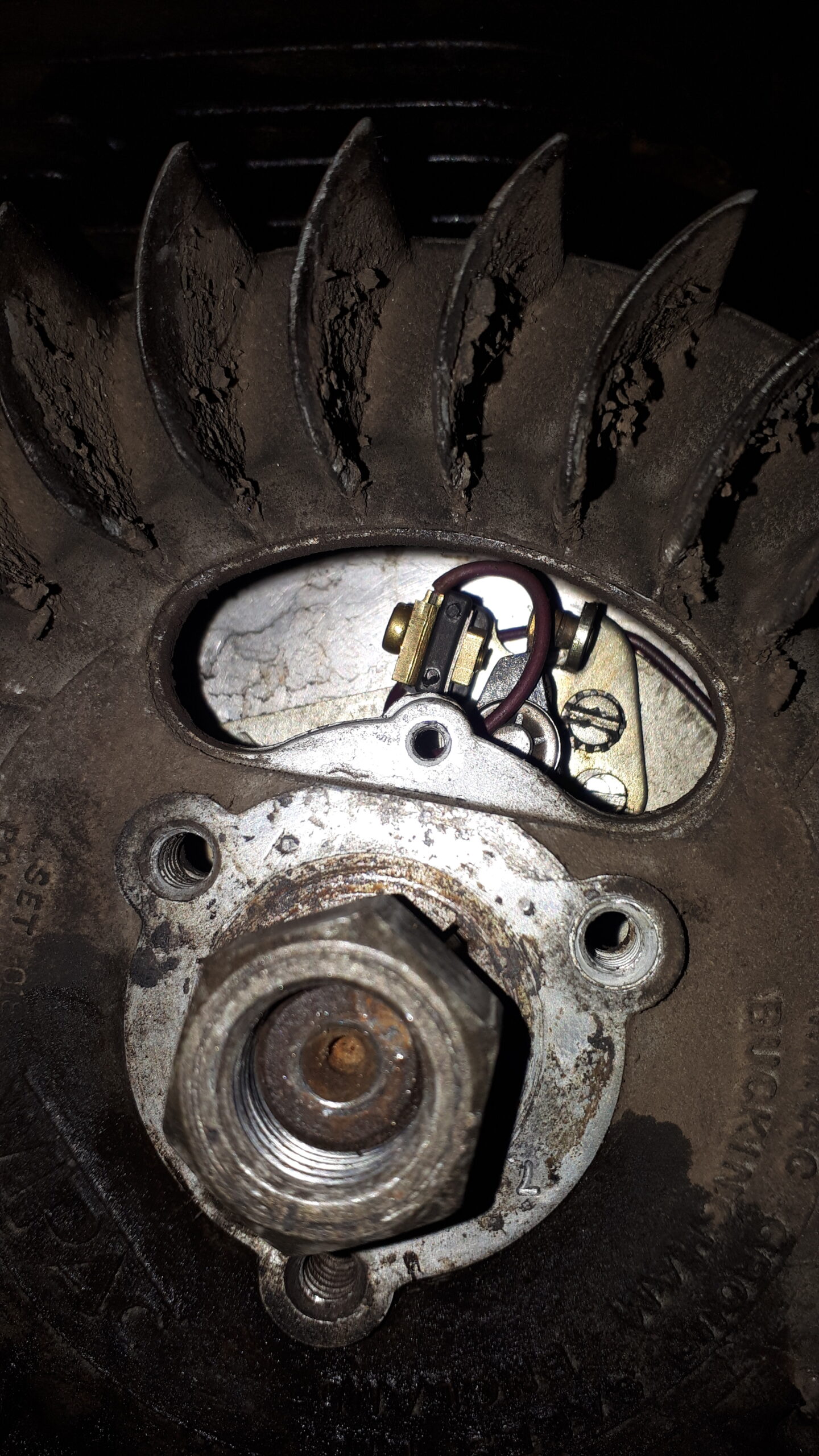

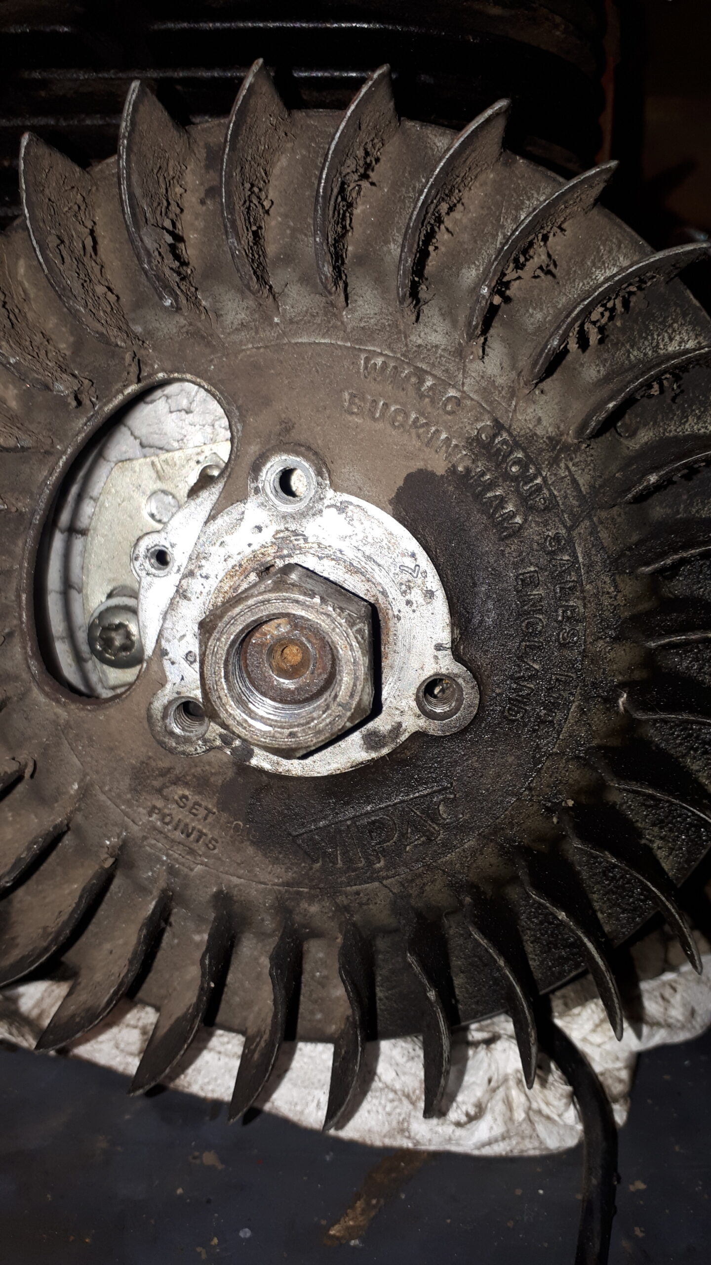

    Thanks Andy. I just want to get it to run, so will be an easy fix.
    Here is a picture of the flywheel if it can help identify the model.
    Warm regards

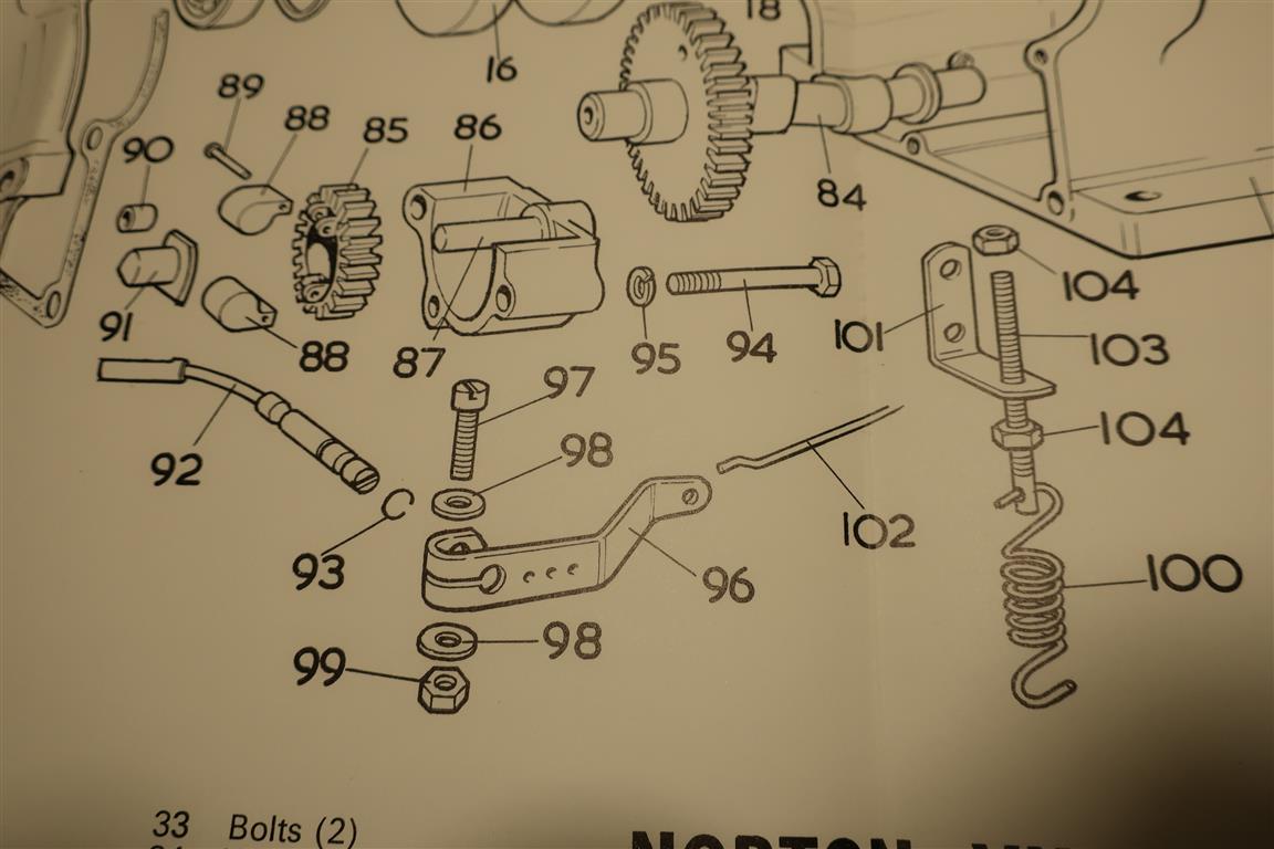

    F15 governor etc
    #35804
    Cheers Angus , as the song goes …….. a picture paints a thousand words.
    #35810

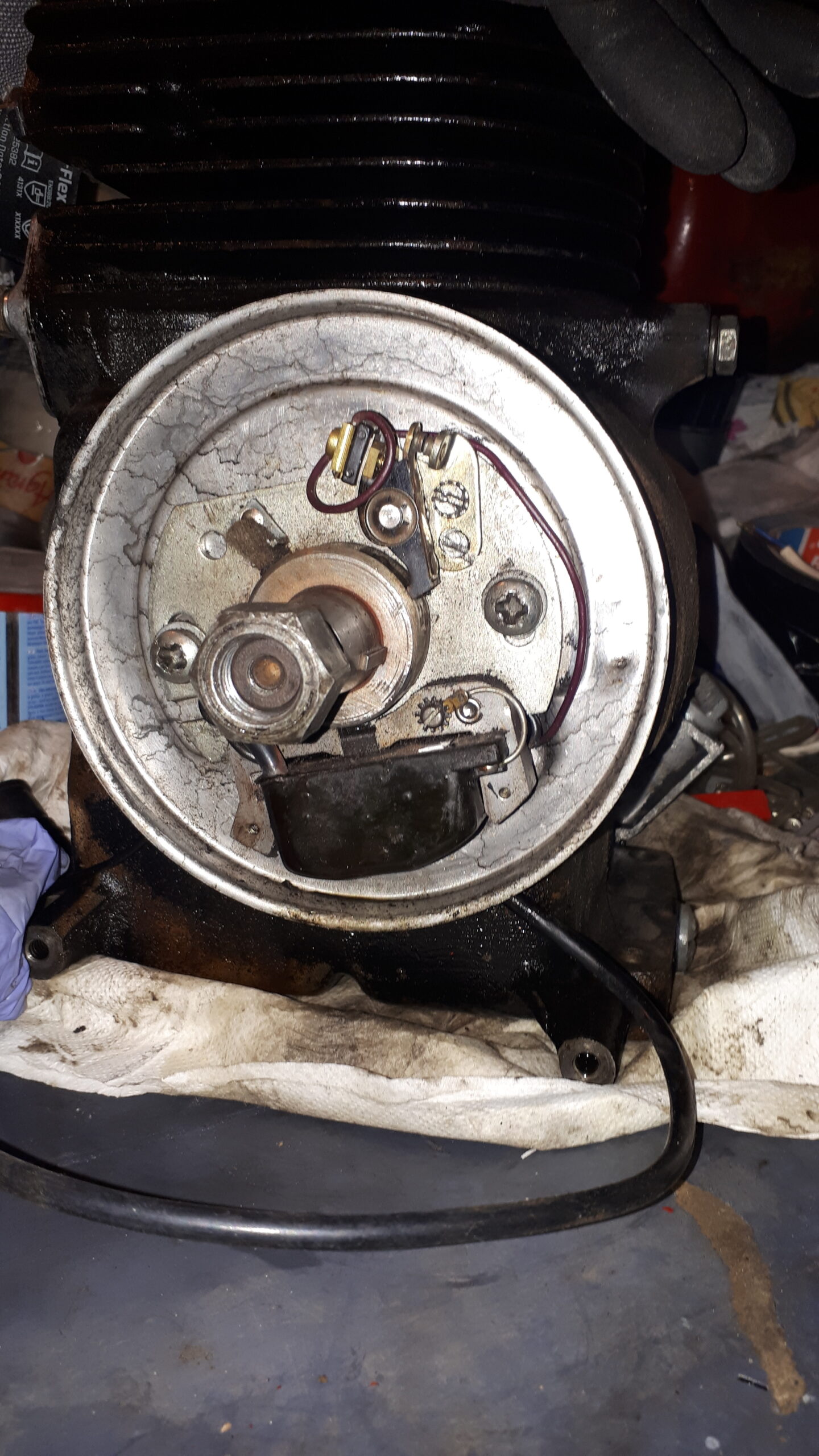

    Dear Angus
    Thanks for the pictures indeed. I can copy the adjuster.
    Here is a picture of the coil + points.
    What should be the opening of the points? I set them at 14 thou (0.35 mm)?
    What should I expect when testing the coil? I got 3440 ohms
    (3.44 with meter set on 20 k)
    Should received the spares I ordered within days: looking forward to get it all back together and see if it starts.
    Cheers Jeff
