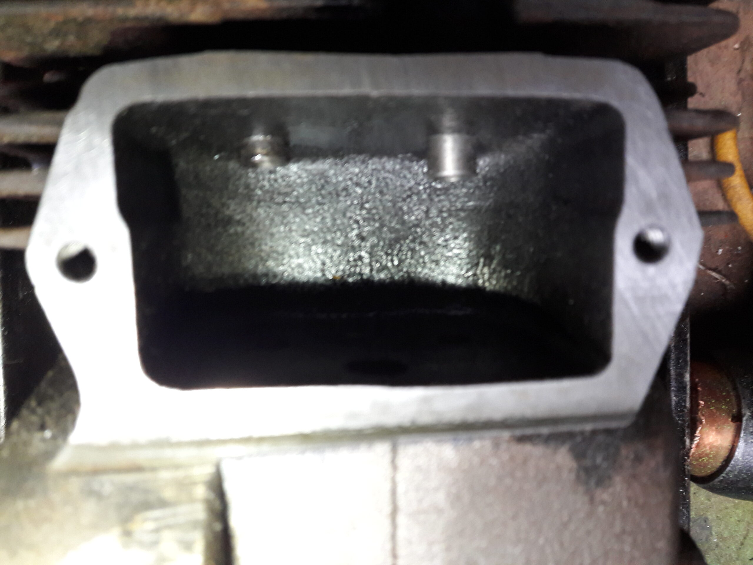

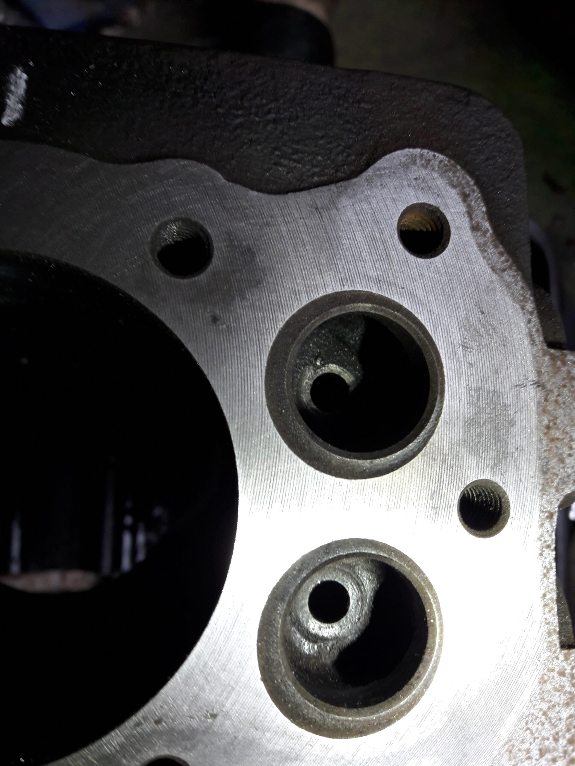

    Well, the guides have arrived and been fitted, a bit of a doddle really, as advised just used a well-fitting punch and very light heating, came right out/went right in..
    One thing I didn’t expect was that the guides are a little longer than the valve spring box is high, this meant that I had to give them a little tap with a hammer once they were down as far as I could get them and crack/pull out 3/4s of the guide and then tap through the last little bit. I suppose it wouldn’t be impossible to drive them up through the top of the block – but not easy.

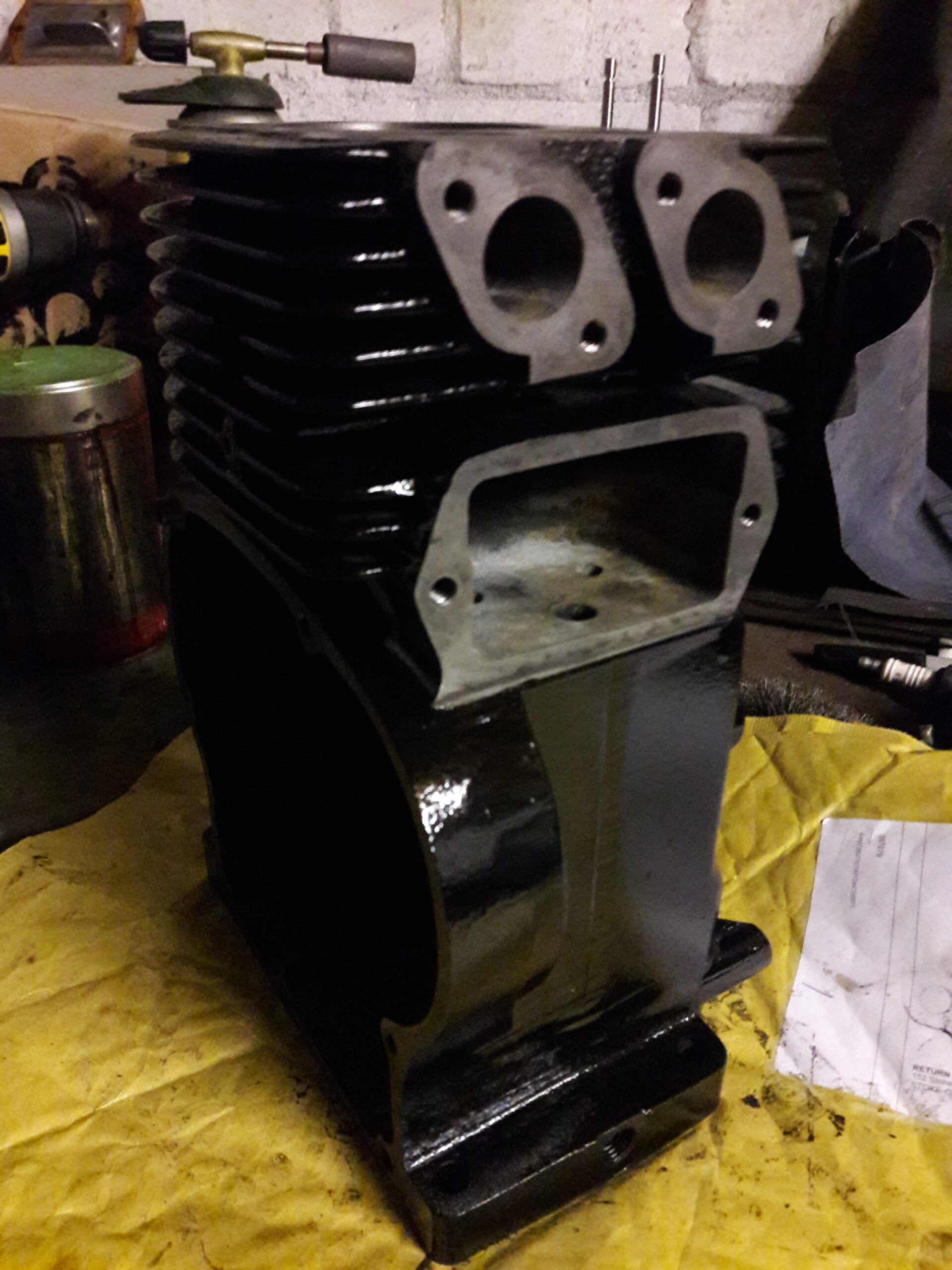

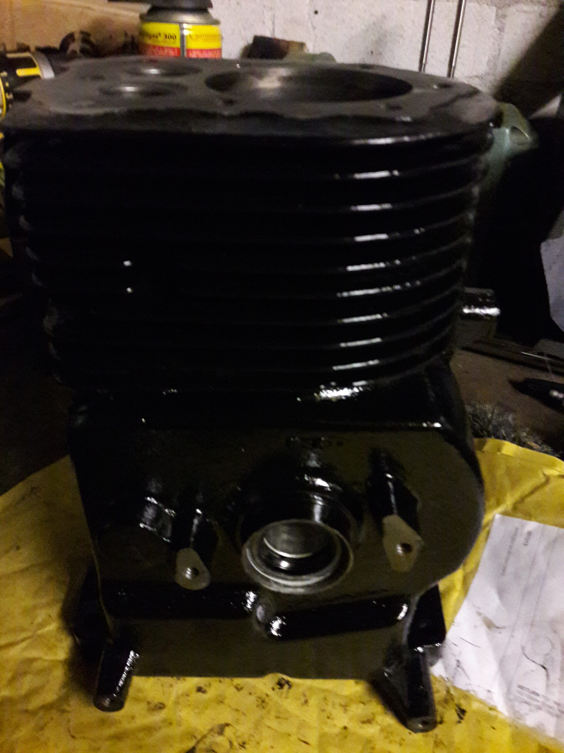

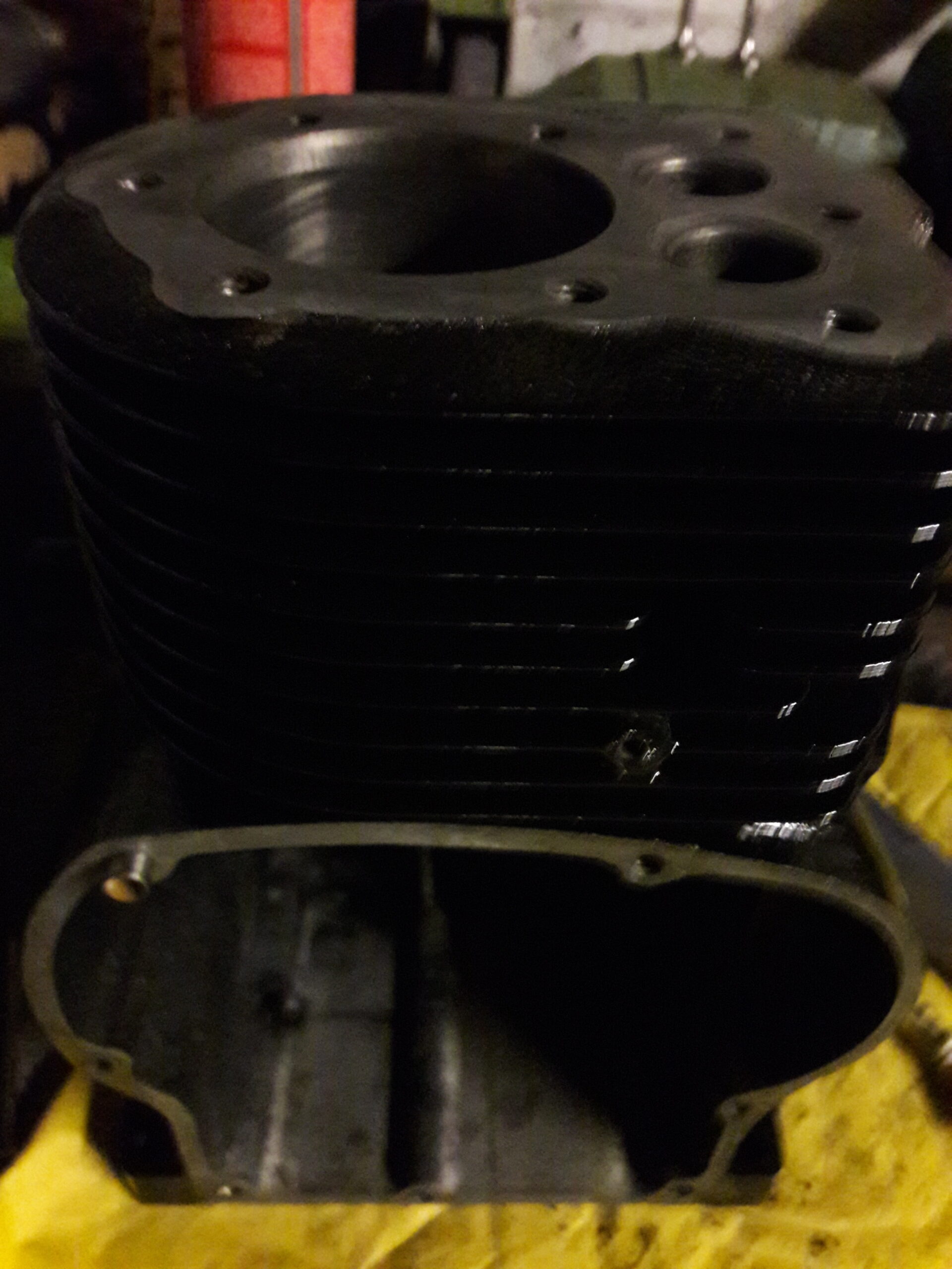

    I have also painted the block, cleaned up the gasket surfaces and run a tap down the threads. as I have found on a few engine’s when doing this – some threads, on a component that had obviously not been removed since new – had all kinds of gunk in them and some were clean as a whistle, I have never understood this!

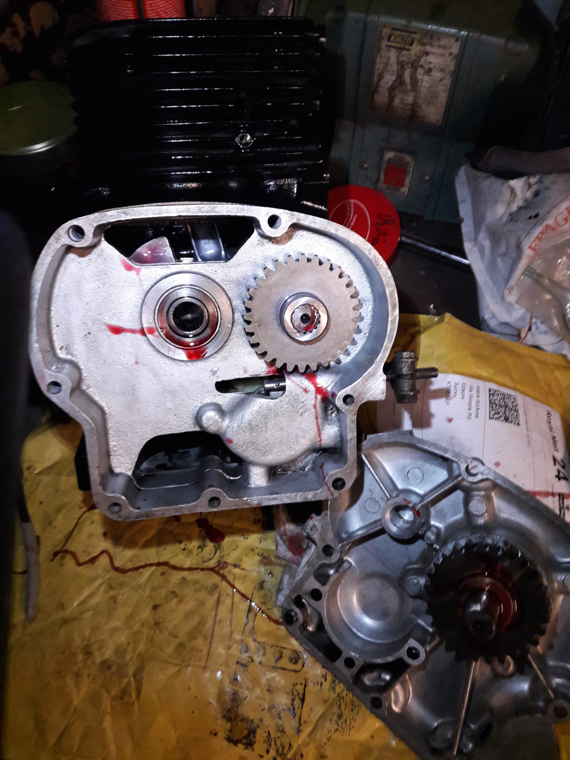

    Anyway, I put the bottom end together with new 3 shims on the crankshaft on the flywheel end of the crank – as was the case when I stripped it – but I also put a new thrust bearing on the gearbox side of the crank and when I reassembled the endplate the crank was very tight indeed – so I now need to strip it again to remove some of those shims – ho-hum, such is life..
