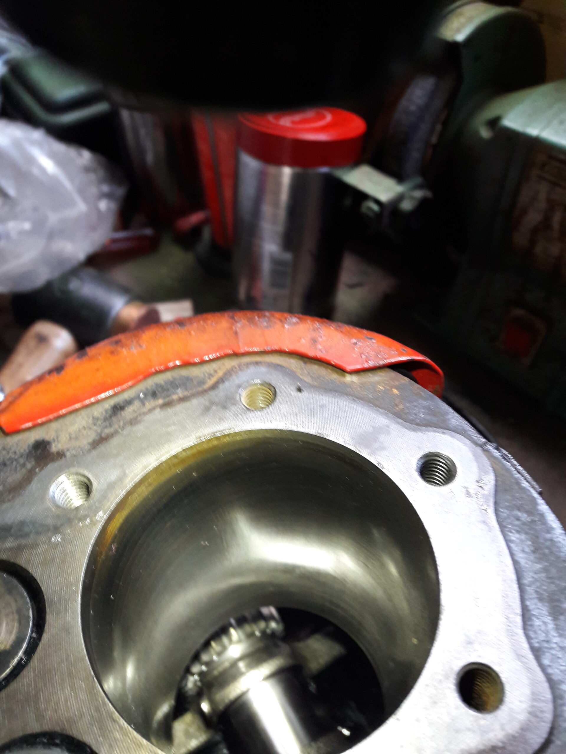

so, took the head off and had a look at the bore from the top. it was perfect. I mean nearly like new – honing marks visible. I then cleaned it and the valves up – the value guides seemed ok too -so, could it be that the issue was on the bottom half of the bore – sticky/broken/aligned rings? glazing? – who knows..

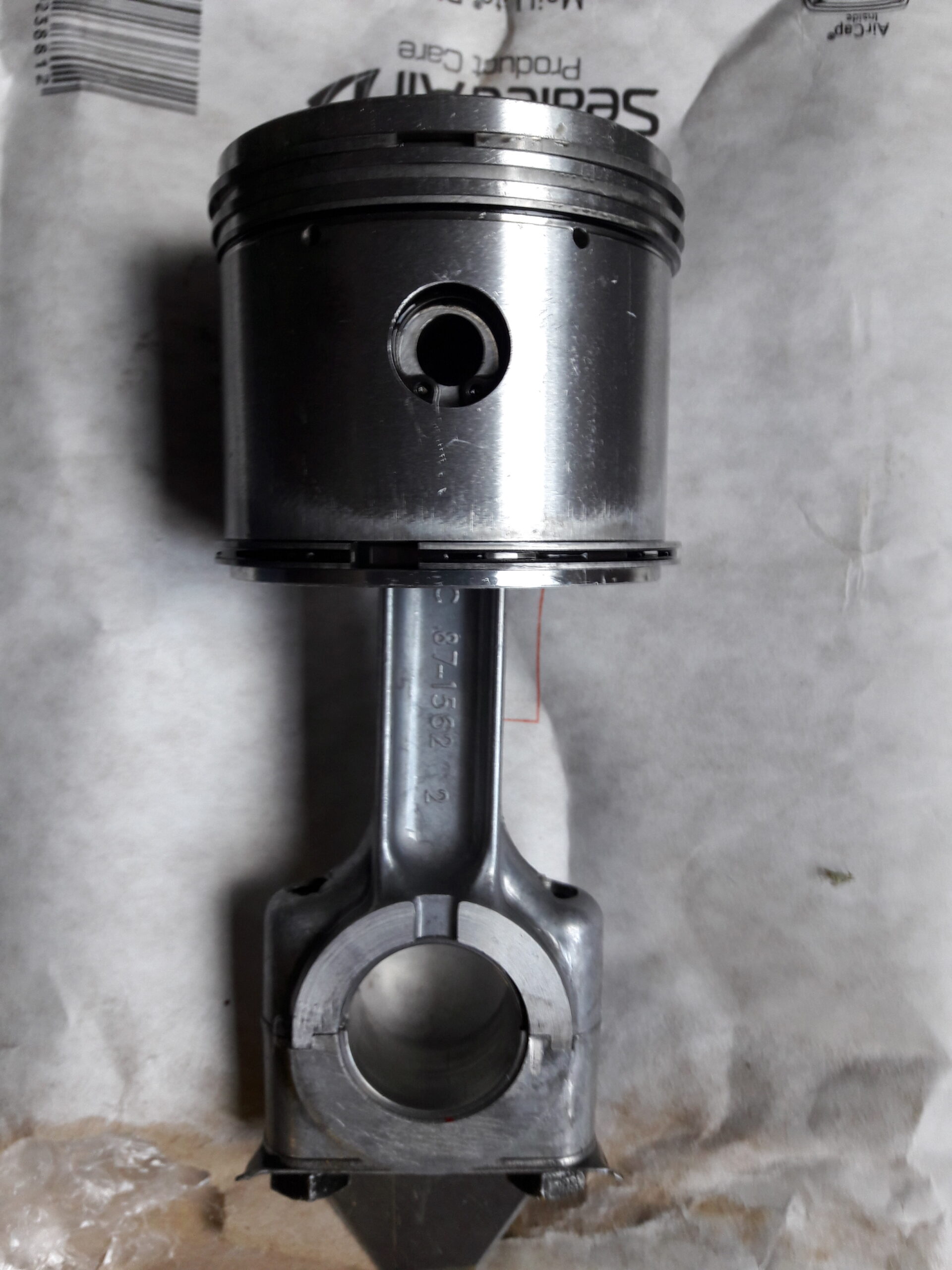

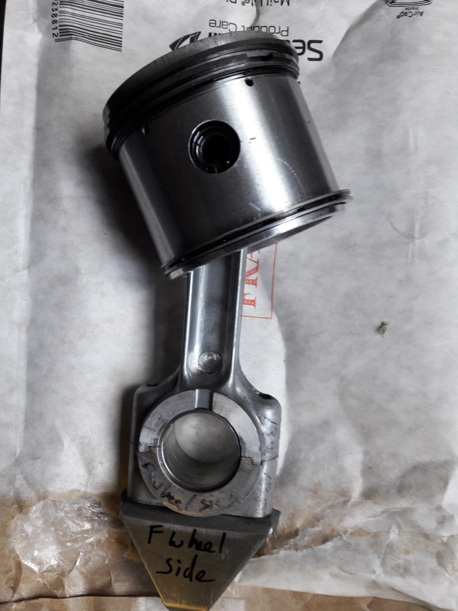

Today stripped the piston out and found: –
1 – a PUDDLE of oil on top of the piston!
2 – the engine is like new inside
3 – the breather works perfectly (not that there is much to go wrong)
4 – the rings and bore are perfectSo, all that is left is the valve guides – although I cant see why an engine that has so little wear anywhere else would have guides that were that far gone? – also, I haven’t removed them for the 2nd time yet but they didn’t seem too bad last time?

wristpinParticipantHave you actually removed the rings and measured the gap in the bore
If you have a look at “spec page” of the F15 manual scan that I posted there is quite a lot of info on ring sizes and end gaps – 6 – 11 thou, I think.
Take each ring off the piston – keeping them in order and correct orientation and poke each one in turn into the running section of the bore using the piston upside down to keep them square and then check the end gaps . Then push them down to the unworn area at the bottom of the bore ( remember that the oil control ring is at the very bottom of the piston) and check / compare again. That will give you an idea of what and where the wear is but, of course it is more meaningful if you have some new rings as a “control” .November 4, 2017 at 4:19 pm #27011
vhgmcbuddyMemberI am about to check the ring gap, but initial eyeballing would suggest its tiny!
also, and I am equally confused as to why it would be so, the exhaust valve moves approx. 1mm side to side in the guide – there is about 0.01 to 0.02 mm variation along the valve shaft, the inlet less so but a significant build up of carbon in the inlet port would suggest that too much oil is arriving under the valve?
Lastly I see that the valves run directly in the block – so its not as if I can just get more pressed in!
I am going to go and check the ring gaps now (watch this space) but I really think its the guides – I wonder if fitting new valves would be enough? or maybe I could get proper, phosphor bronze guides from something else and have the block machine to fit?
