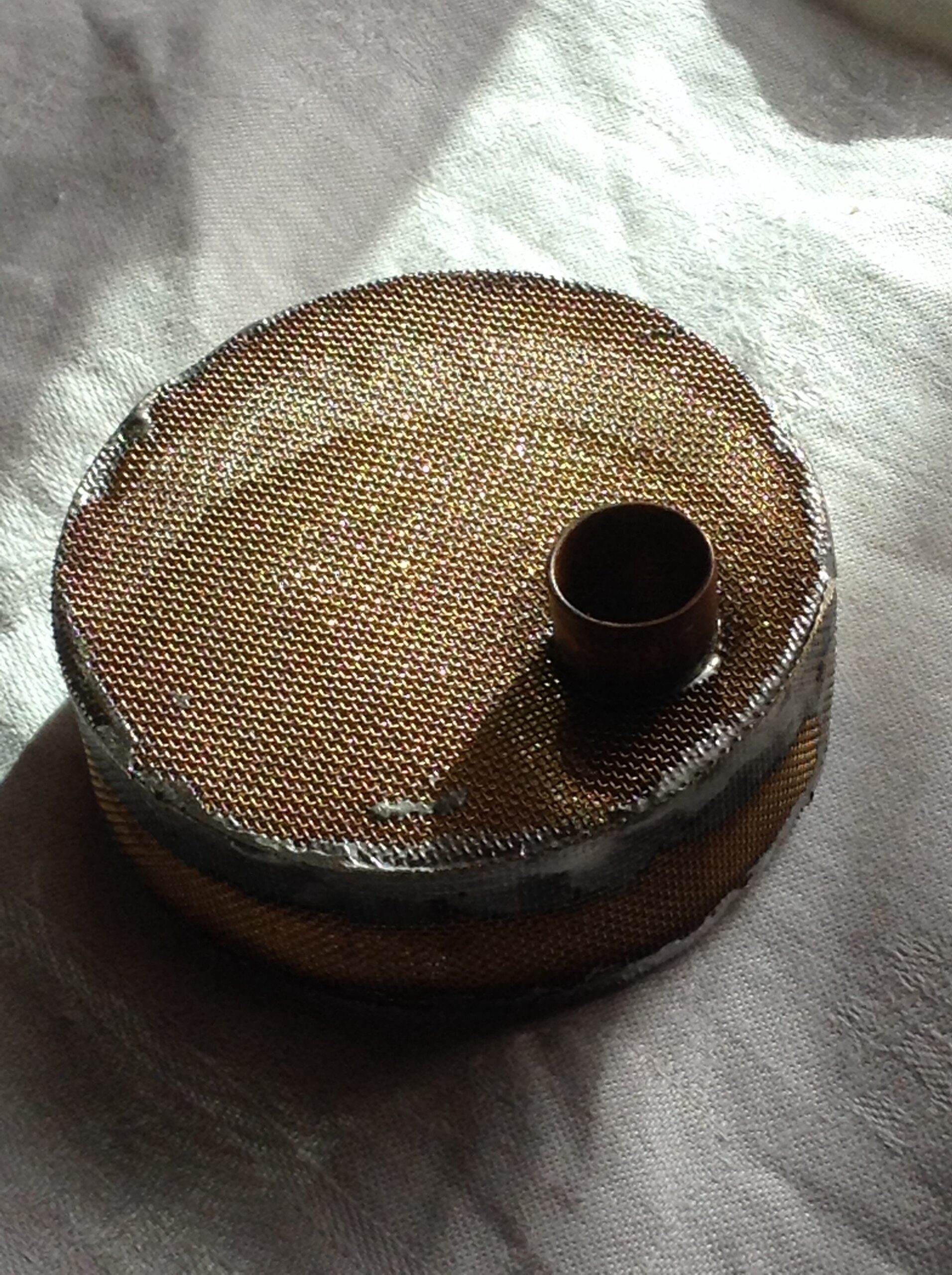

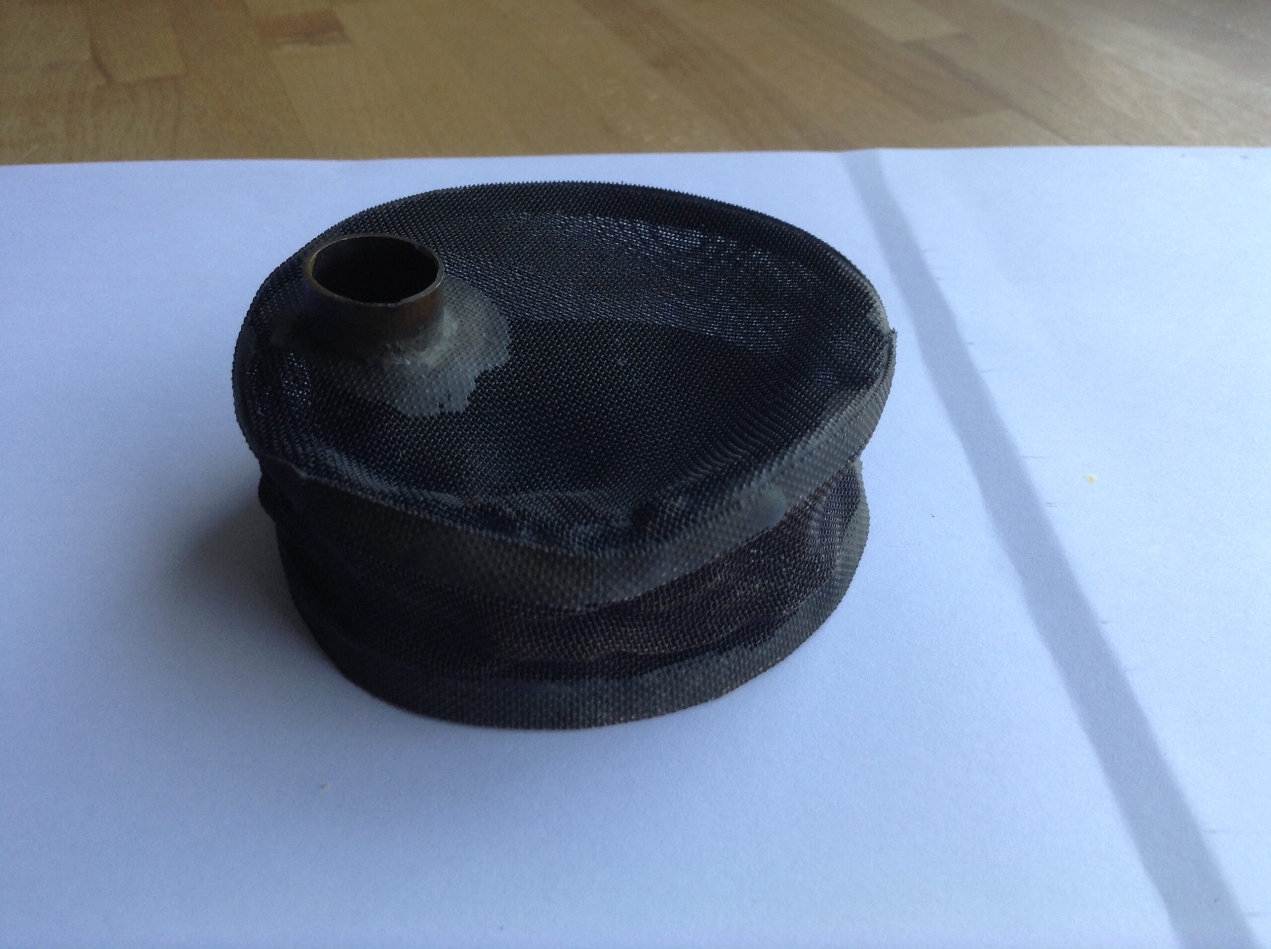

    The next problem is the oil suction filter located in the sump.
    It has been damaged in the past.
    I may be able to solder up the tear, but it is a bit distorted.
    A replacement will have to be fabricated.
    Can anyone point me in the direction of a supplier of a small quantity of Brass mesh?
    #14882
    Try eBay, you can buy A4 size sheets.
    #14900
    silverfoxfintry
    Thanks for the info on the brass mesh.
    Made a new suction filter today.
    The crank is away for grinding and the broken foot on the crankcase s being welded.
    Things are progressing.
    SILVERFOX
