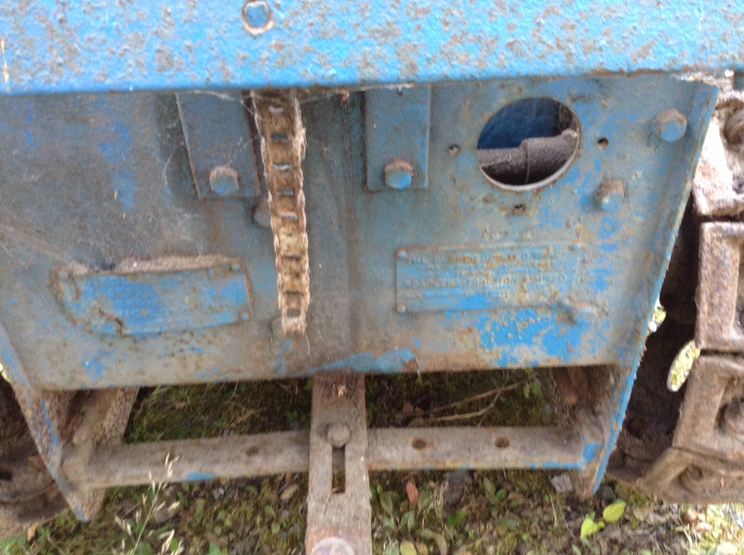

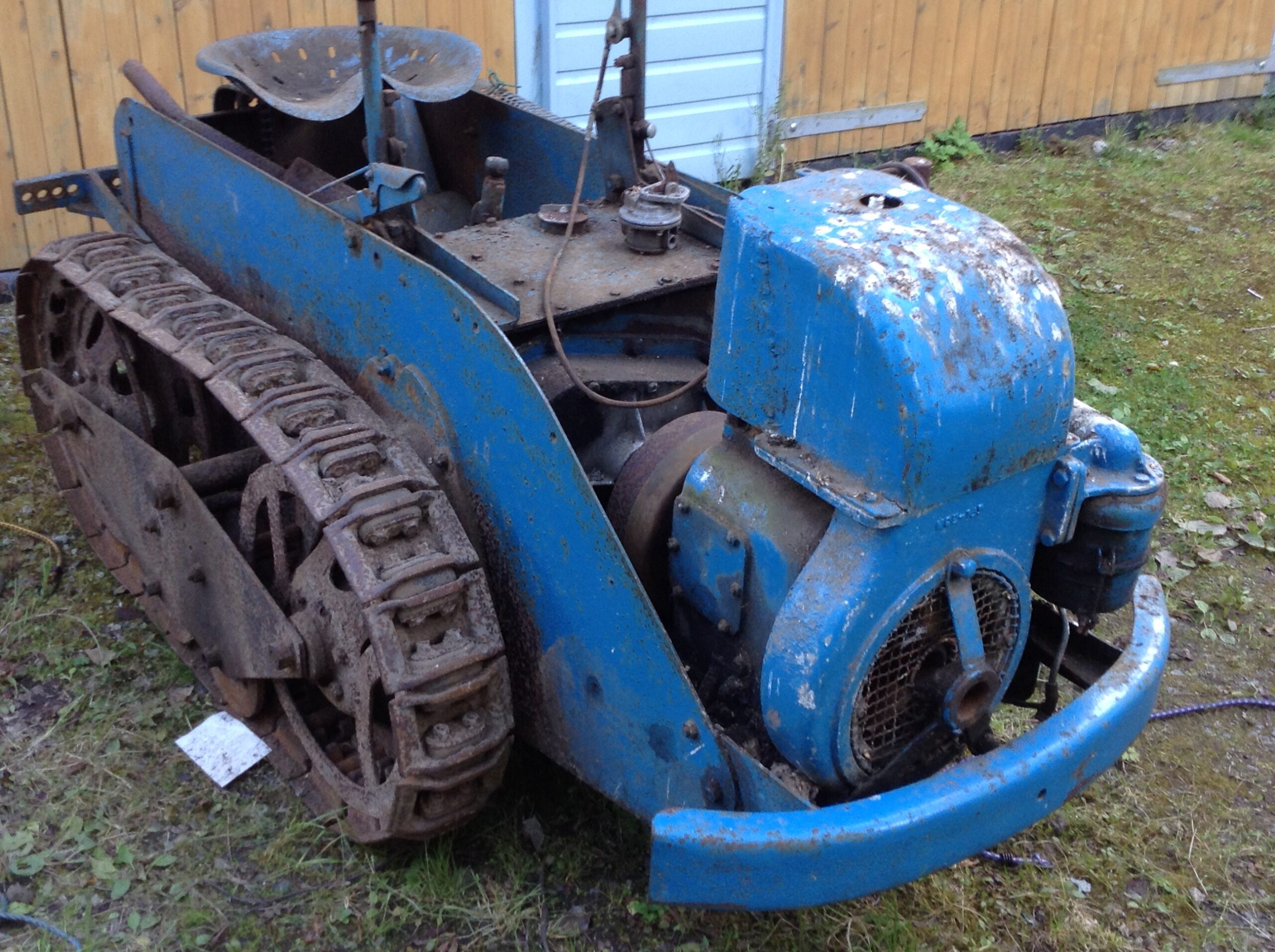

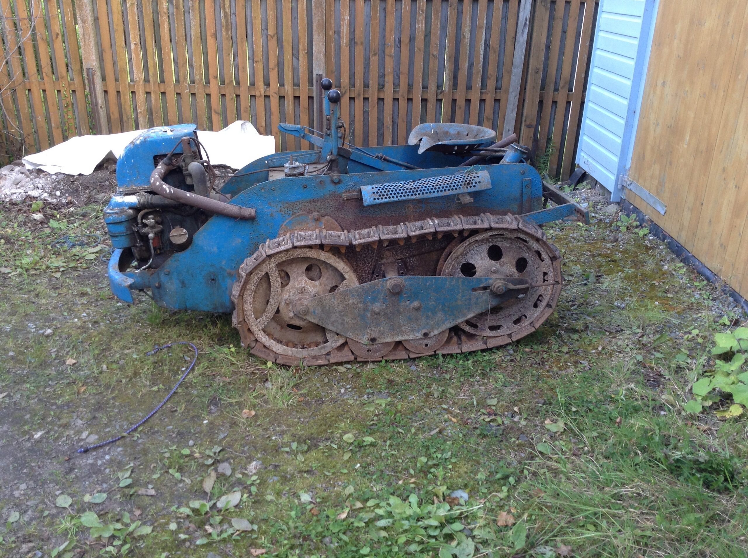

I have just acquired a Ransome MG5?
I have been looking at this languishing in a barn behind a load of Wood for a number of years.
Now I am retired and have the time I have taken it under my Wing.
I can not find any serial numbers or even any name or number on the Engine.
It looks like a Mg5, but!
I have located a couple of Plates riveted to the back of the frame, but they are quite badly rusted and I can’t make out type or serial numbers.
Can anyone advise me on the location of the serial number etc.

ransomes256ParticipantHi,
Another machine rescued.
Photographs will be best way to ensure identification.
If the Id plates on the back of the machine are beyond reading it may be possible to see a shadow of the stamped number in the chassis under the plate as they were stamped in situ. Rubbing with chalk and using a digital camera then playing with the contrast on a computer may reveal info. If this fails I am sorry there is no other location for the serial number but the date may be possible to establish from an engraved code on the edge of the main gearbox crown wheels.

Dave.September 3, 2015 at 6:18 pm #14303expeatfarmer
Participantsome paint stripper on those id plates should reveal the numbers. If not try the photo method.
September 3, 2015 at 6:28 pm #14304expeatfarmer
Participantsome paint stripper on those id plates should reveal the numbers. If not try the photo method. You are right about it being an MG5 and from the photos it looks to be in good condition. You mention knowing of other machines, if they are safely stored in the dry, bide your time and keep watch for the day when the bug bites you! If they are at risk of rotting away then try hard to persuade the owner to offer them to a caring new owner who will preserve them.
