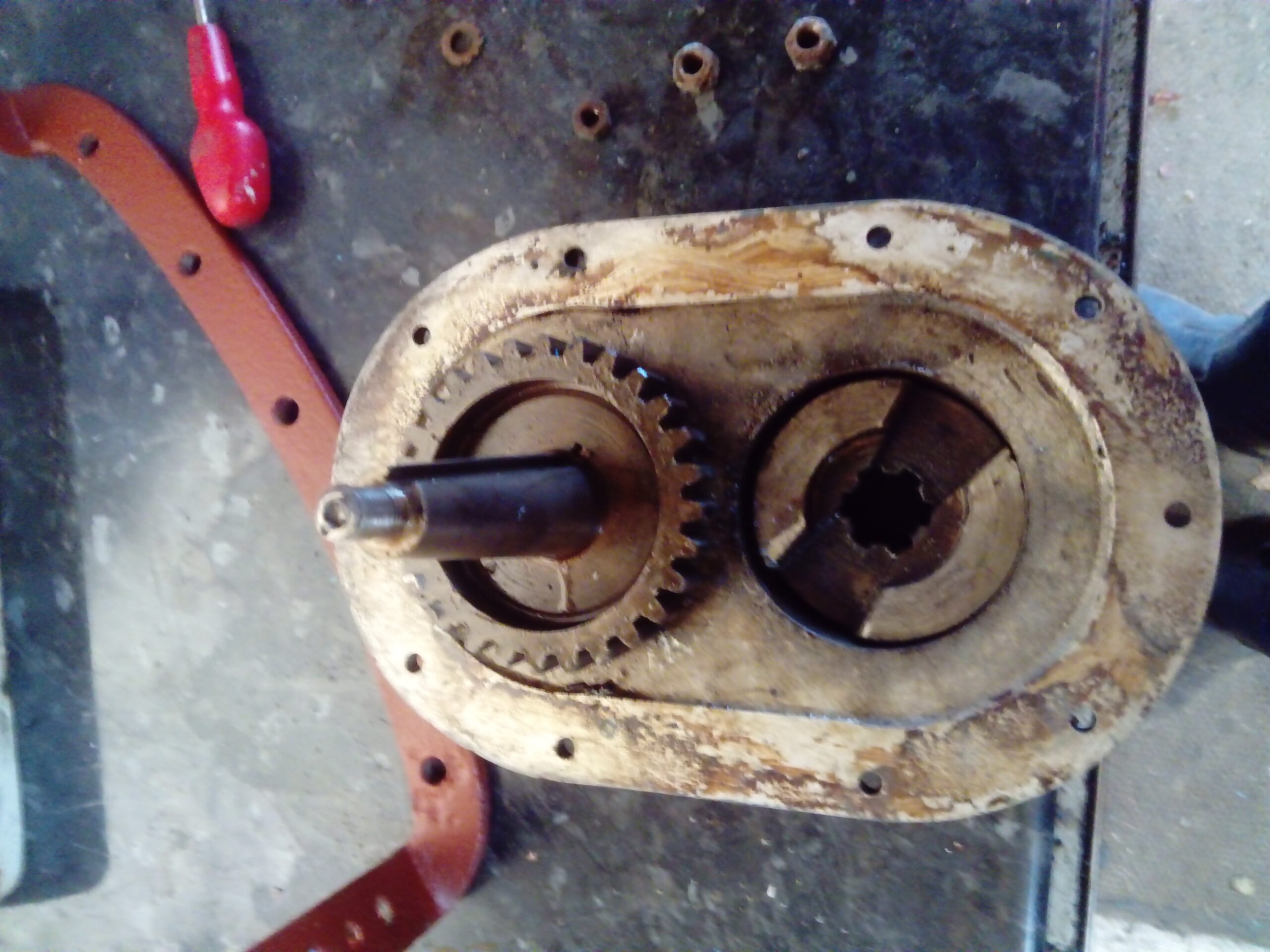

    #24044
    joegrgraham
    Hi all.
    Progress on 551 has been non-existent of late, mainly due to it being cold, dark and wet (and a lack of beer tokens!).
    Currently at a bit of an impasse waiting for it to warm up a bit so I can do some painting.
    Anyway, I ventured into the shed today and had a look at the PTO unit.
    The drive shift has a lot of play, so I presume that the bearing needs replacing, but how do I get at it? Am I right to presume that the gear pulls off?
    Secondly, the PTO engagement unit looks to have a seal, again, how do the parts separate?.
    Lastly, I noticed that the detent ball is missing, any ideas what size it should be?
    Thanks,
    Joe
