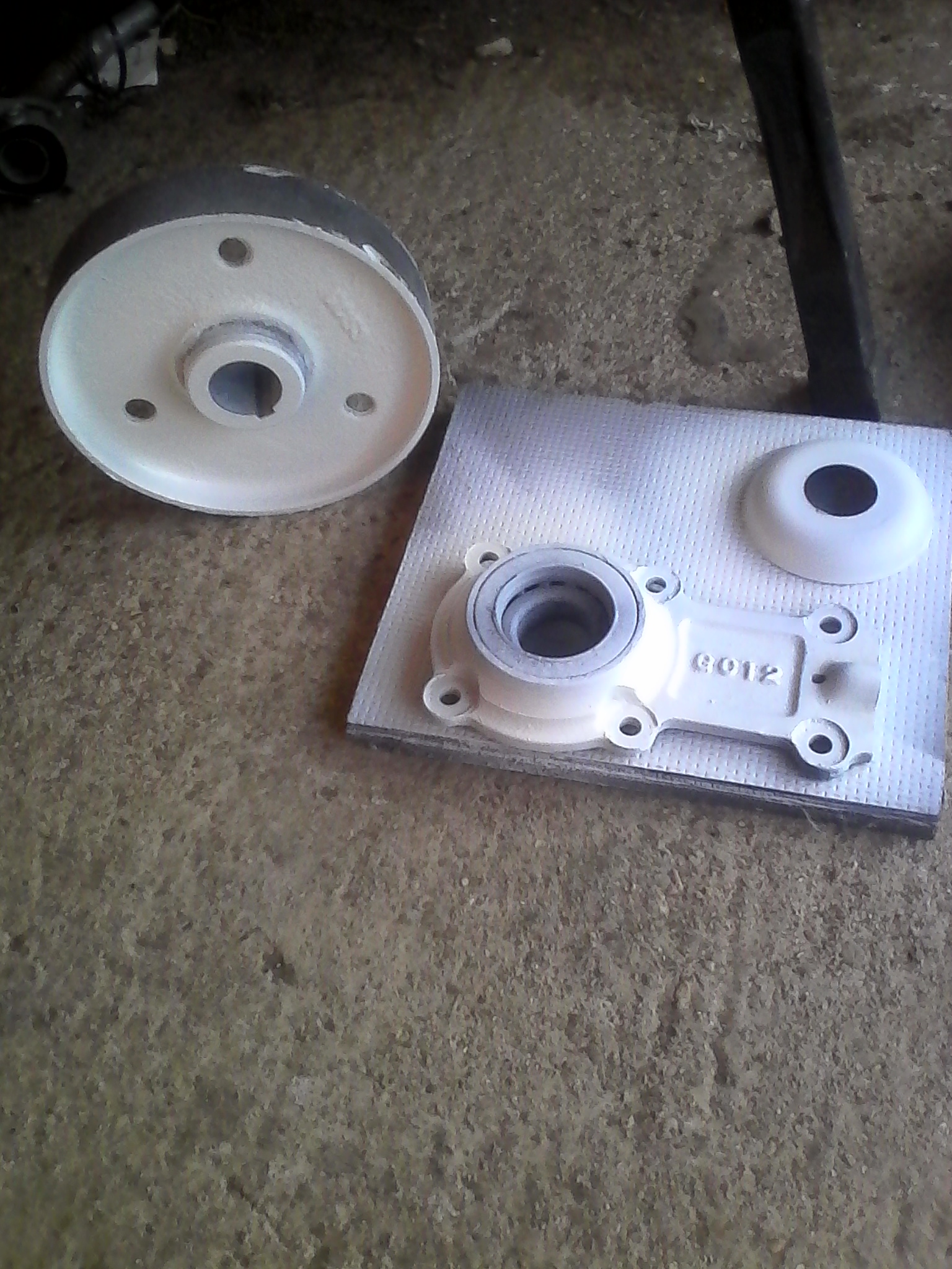

  • #21946
    joegrgraham
    Little victories!

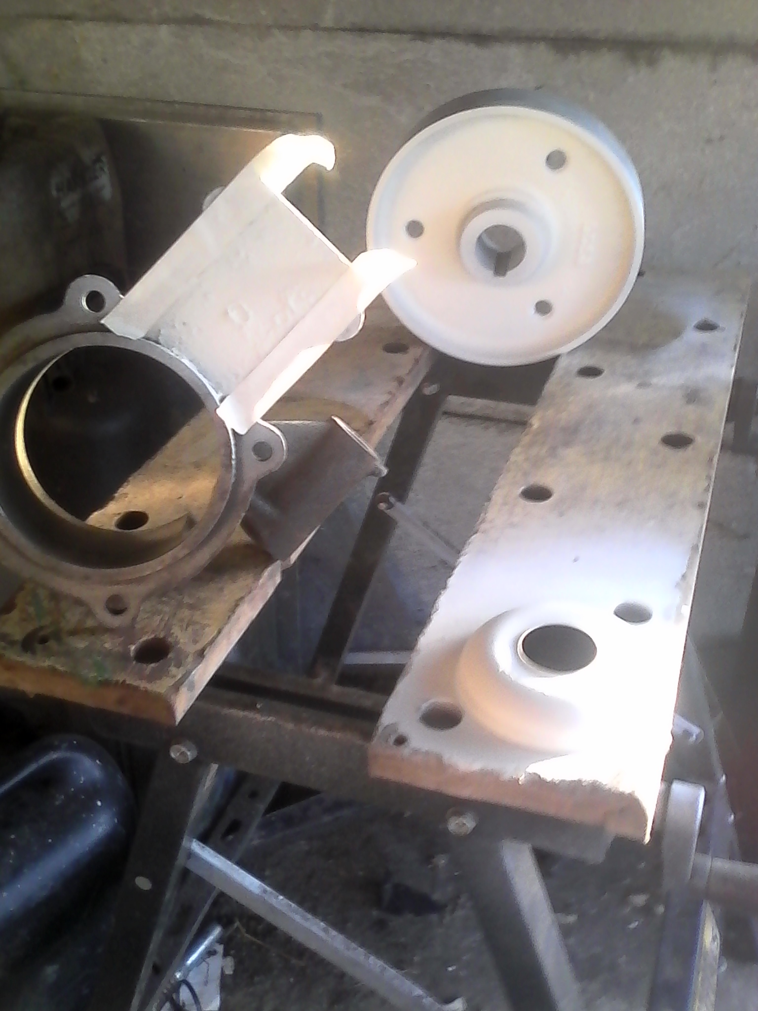

    The first parts have been painted!
    Sadly, it’s bits no one is ever going to see.
    #21947
    joegrgraham
    Forgot the pics!

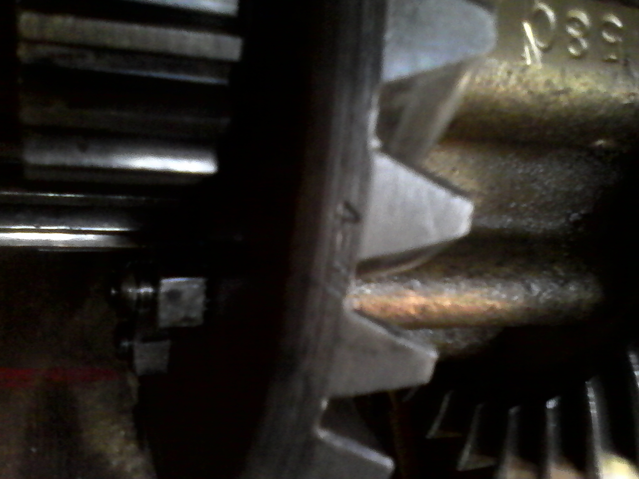

    Hi all.

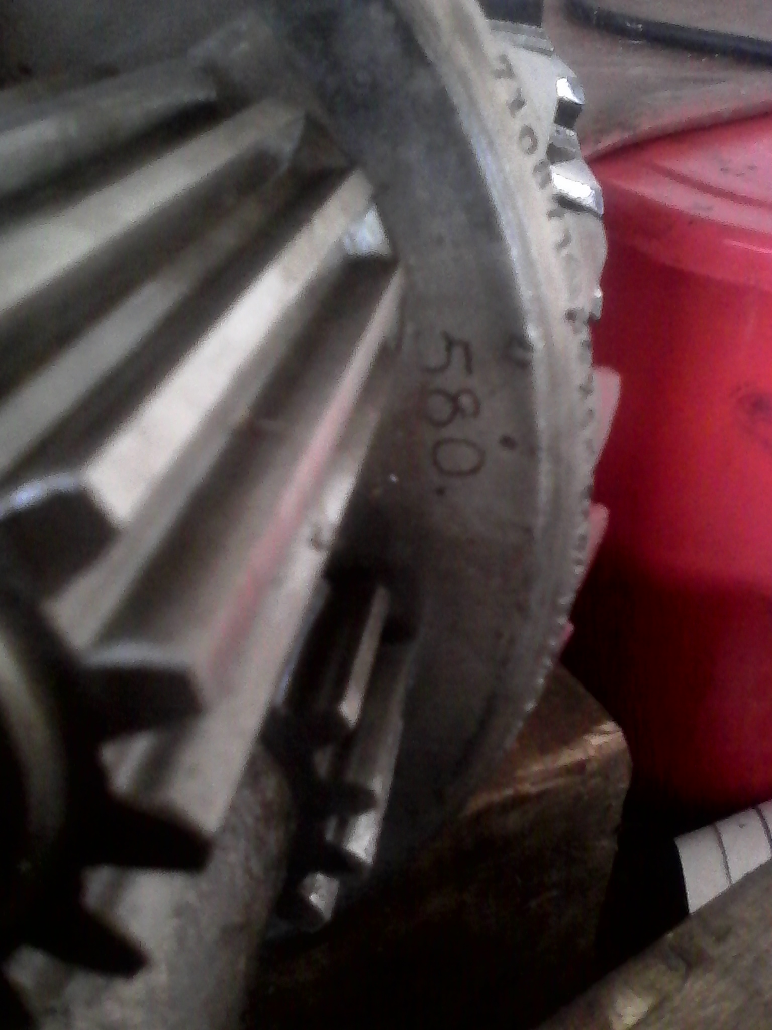

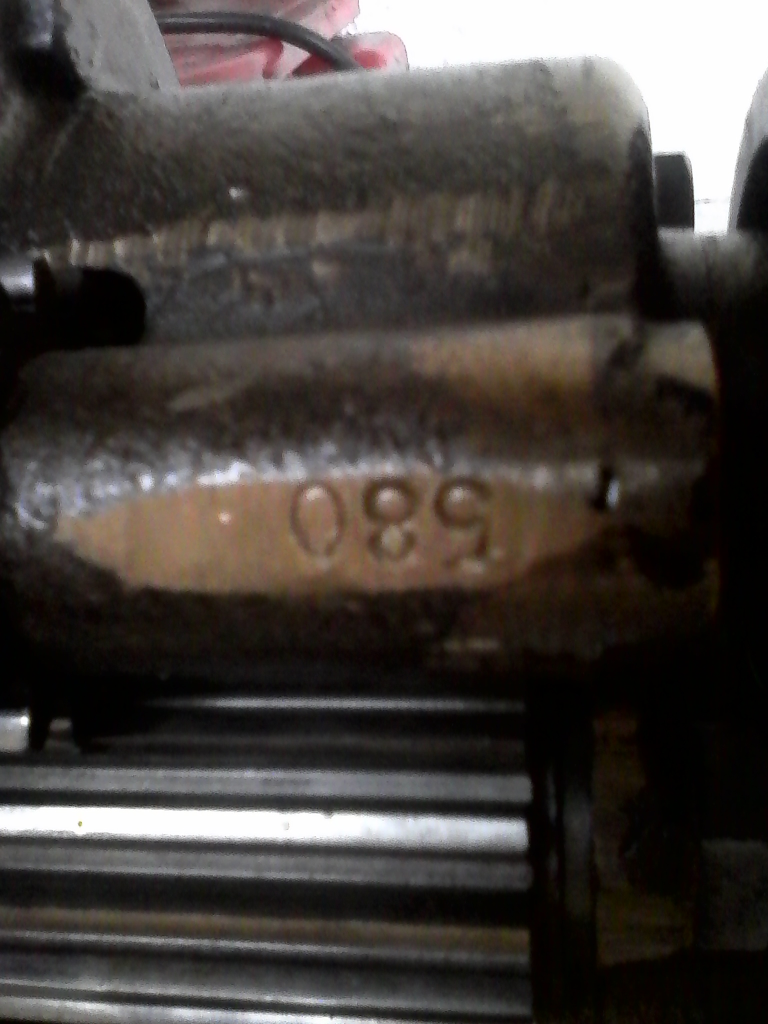

    Please could I have some thoughts regarding my serial number.
    My data plate reads 551.
    However, stamped twice into the gear assembly, and etched into the crownwheel, is the number 580!.
    To further confuse, the date stamped into the crownwheel is 4-37?!?.
    Firstly, assuming that 580 is a serial number, it would seem more likely that the data plate has been changed rather than the gear assembly?
    #22096
    ransomes256
    Joe,
    The 580 is just an assembly number and I do not believe it applies to the serial number. The 4-37 suggests the crown wheels were produced in April 1937 which seems a long way in advance of the serial number 551 which is 1940. Please see Diesel Daves investigation into serial numbers.
    Neil

    Someone else struggling with establishing the true identity of an mg2.
    From what i can make out from a fairly well corroded back plate is that my machine is number 1573, dating it to 1944/45 but my crown wheels are stamped 1/47 as in january 1947, my grandfather bought the crawler circa 1968 always said it was a 1937 and the engine number appears to have evaporated into the ether of time.
    Was there a mass mg2 ringing operation going on in the past?

    Thanks for the info Neil.
    As it was built during the war, I suppose it is feasible ransomes were using what they could get their hands on, bits dug out of the stores, maybe a defunct machine that had been returned to the factory was cannibalized?.

    #22226
    joegrgraham
    Final drives are stripped and cleaned, got some primer on a couple of bits.

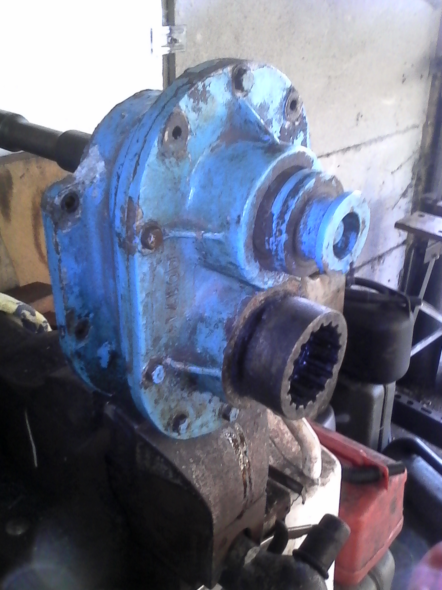

    Tonight I split the PTO unit in order to reseal the joint in the casings.
    Where the engage/disengage slider passes through the front casing, there appears to be some sort of seal. Is this an oilseal or a cork washer? and is it replaceable?

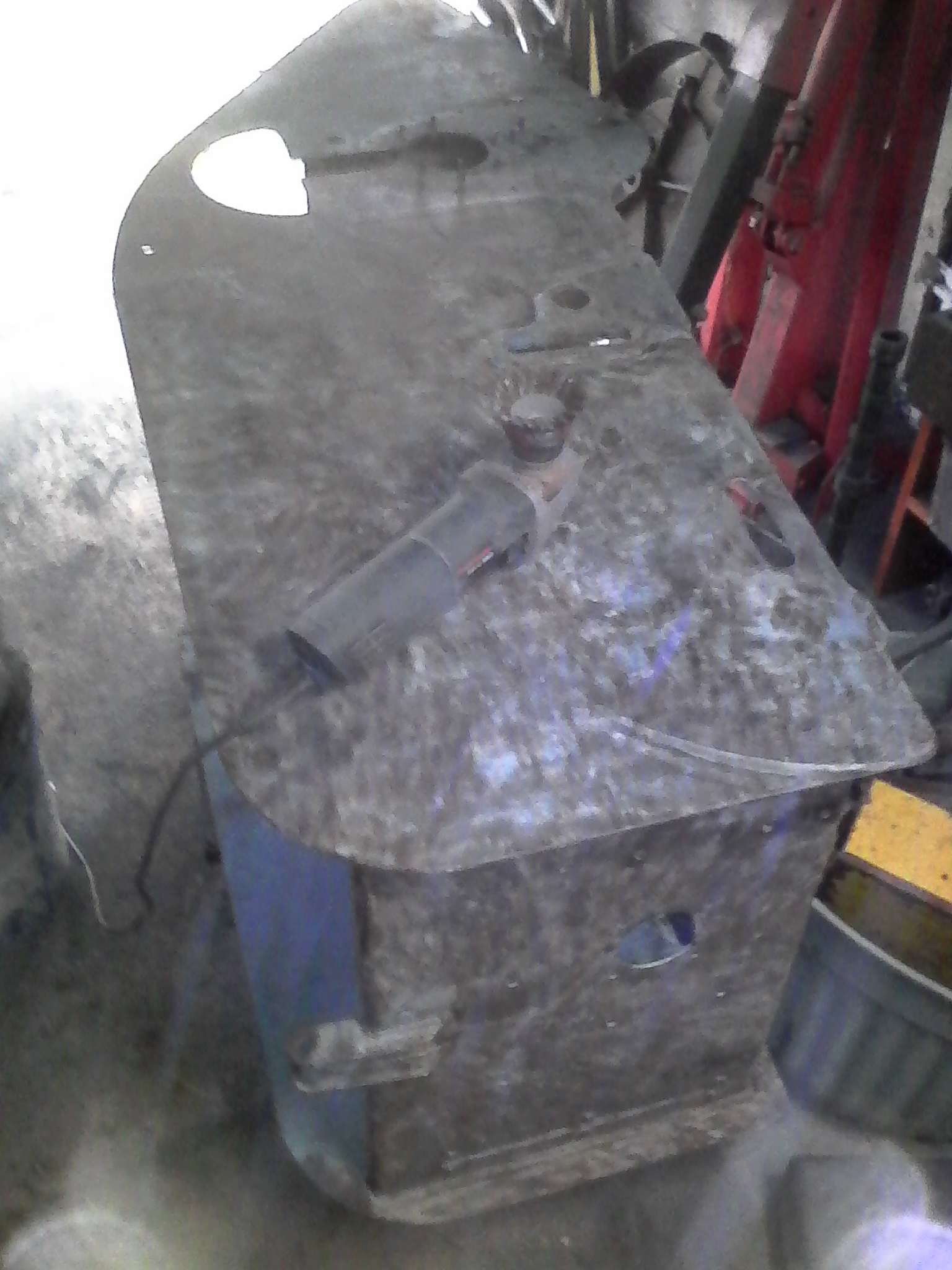

    joegrgraham

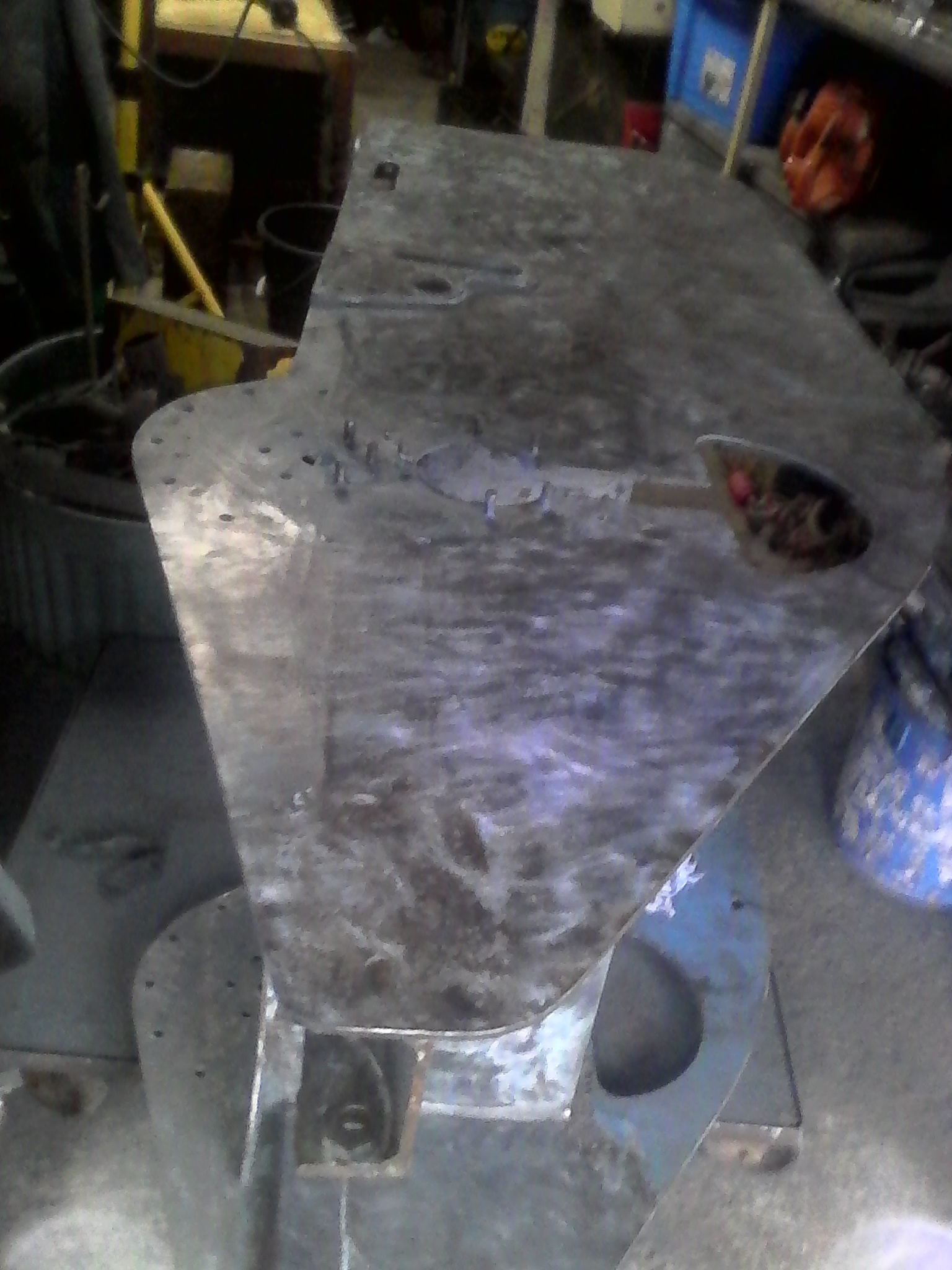

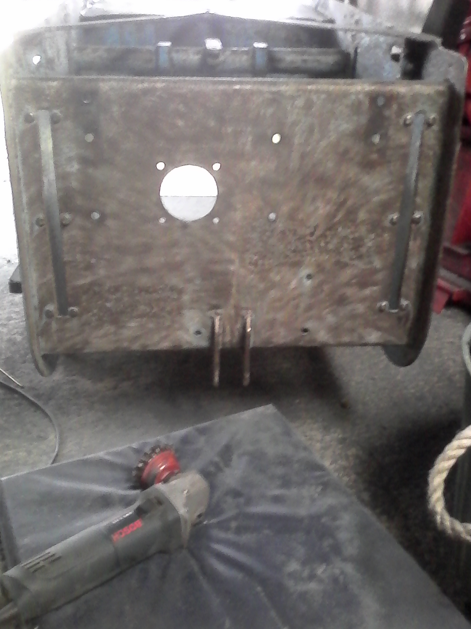

    So, I got bored today and decided to start wire-brushing the tub.
    And yes, I emerged from the shed looking like a Smurf…..
