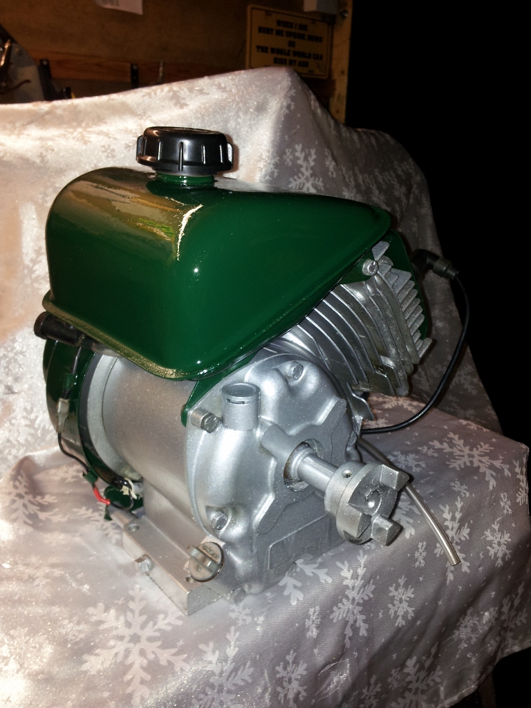

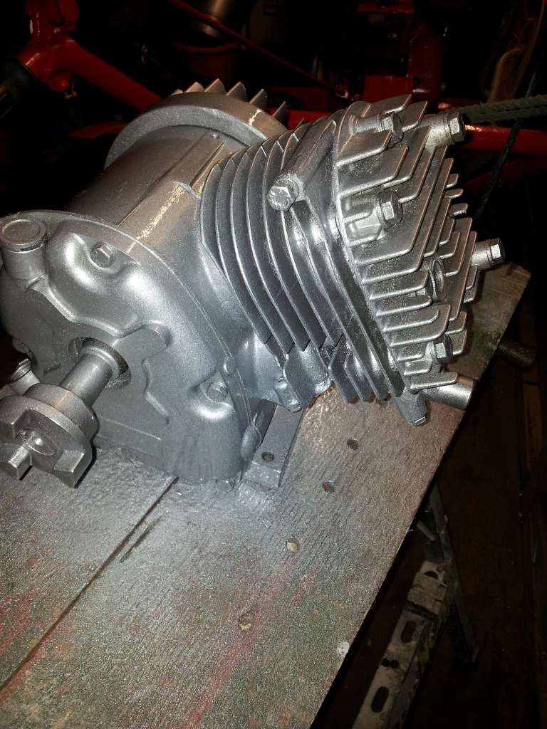

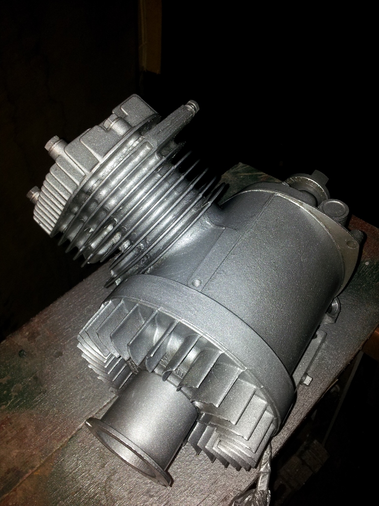

    Over my lunch break today I came across some engine paint which when applied looks like aluminium with a laquer mixed in with it. so have applied some to the engine. not to bad a likeness,at least it gives it that fresh look and stops the aluminium oxydising.
    #1888

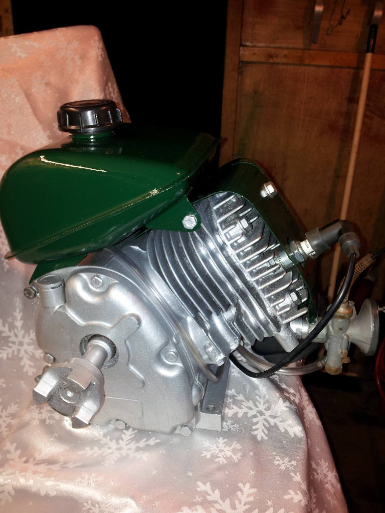

    Rain,Rain etc drives me to the shed. not a bad place to be ,I am sure we have all been there. RANT OVER ! well have the engine back together. was not such a big job once the carb was sorted. all electrics checked and cleaned plus the new on/ off switch.went the whole hog on the switch by getting the waterproof gater cover. also just remembered a new fuel line as the old one was petrol stained and brittle. Just need to get the other part of machine here to rub down etc.if this weather keeps up it may have to wait as its that big it most certainly will not fit in the workshop.

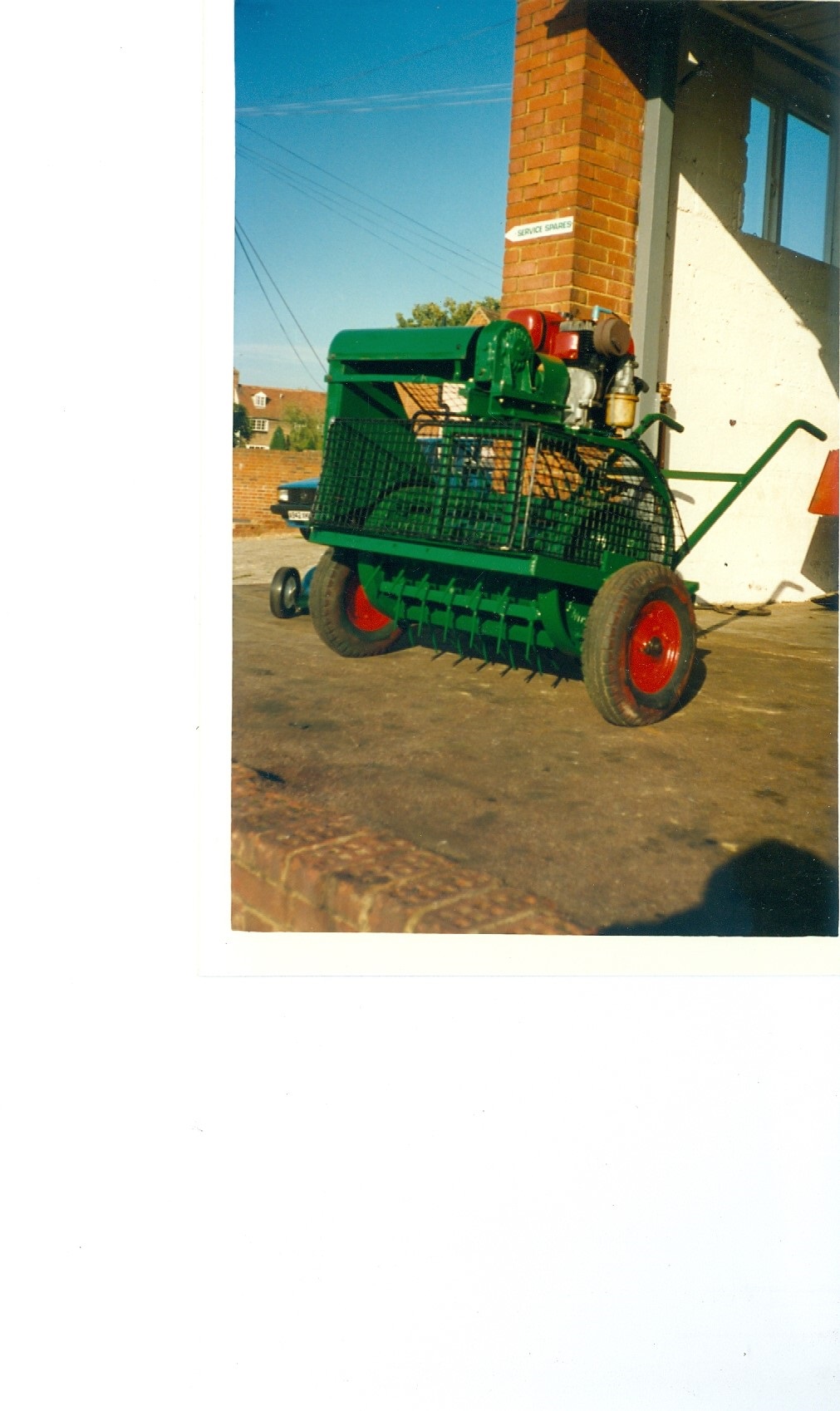

    #1903
    One of several ex council machines that we bought at auction (ex local authority), refurbished and sold on to sports clubs etc.
    On edit- having a problem with attaching the image . Half of it being cropped and as there is no preview option no way of seeing what will be shown without submitting it. Going to try again with reduced image size but will admin please remove the second post.
    #1905
    One of several with Villiers F15 engines that we bought at auction (ex-local authority) , refurbished and sold on to sports clubs etc.
    #1911
    Angus,can you explain how this moves when not spiking turf ? I have a horrible feeling the operator has to chew himself when moving from site to site THUMBS DOWN BIG STYLE
    #1924
    hillsider
    Do I sense that this machine could for static display only? Unless you can aerate the arena as you parade the machine.
    #1927
    Strictly mandraulic until in work! Long time ago but I seem to remember that they roll freely on those pneumatic tyred wheels. In use,definitely for the wide open spaces!
    #1938
    I had better make sure that i have eaten well before a parade. Do not want a static display and yes to engauging the drum i may as well do some good to the land on the way around
