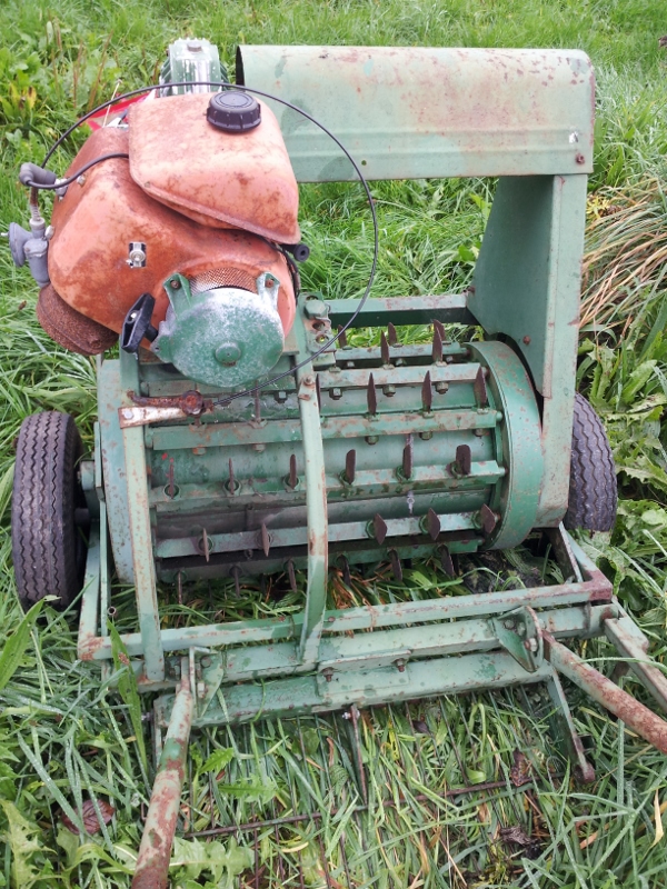

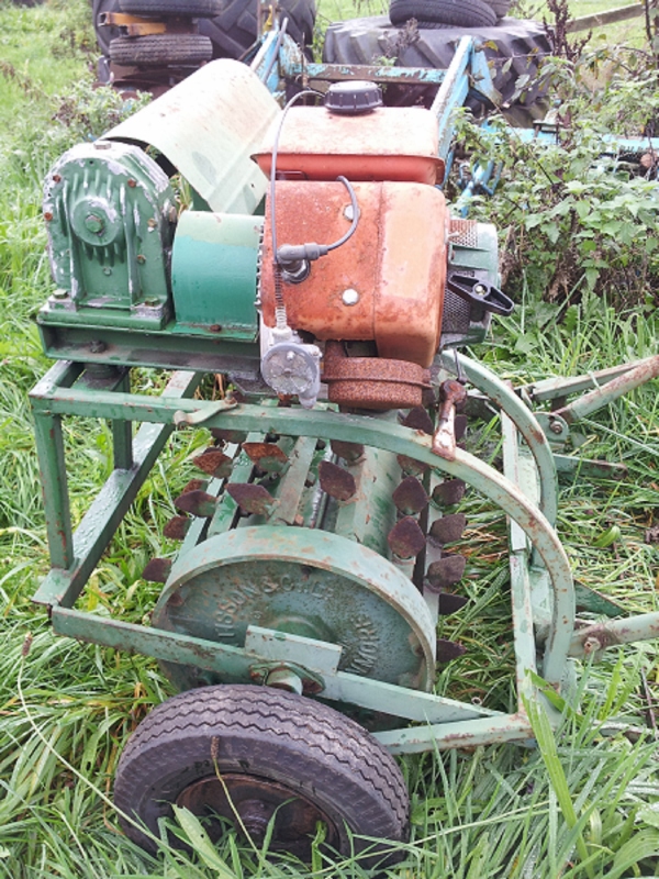

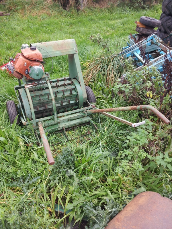

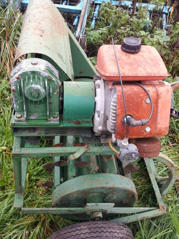

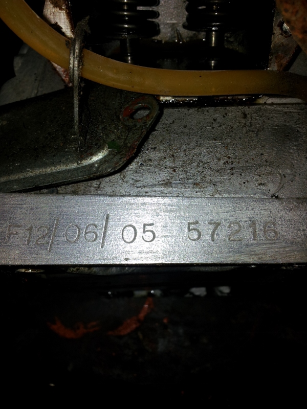

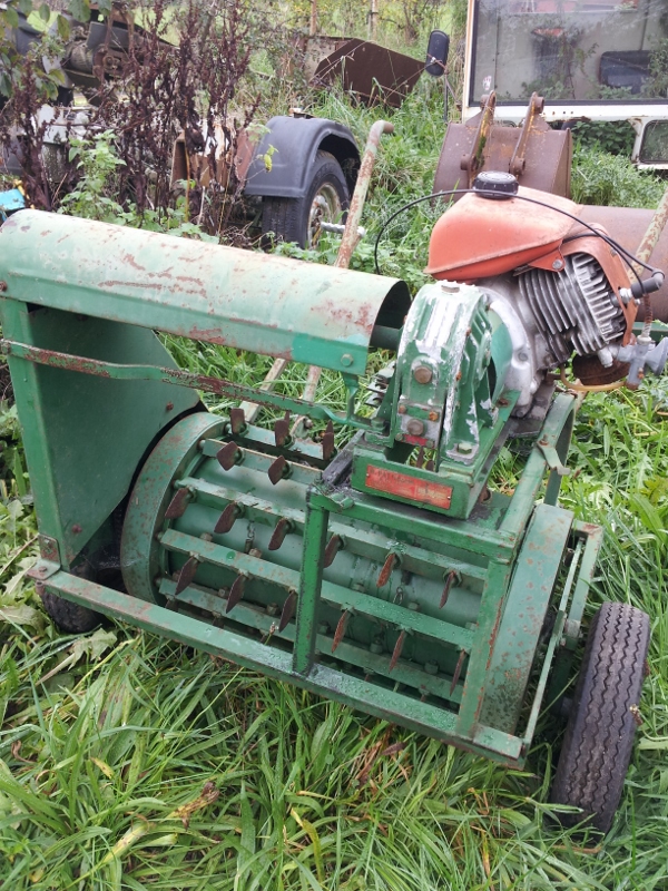

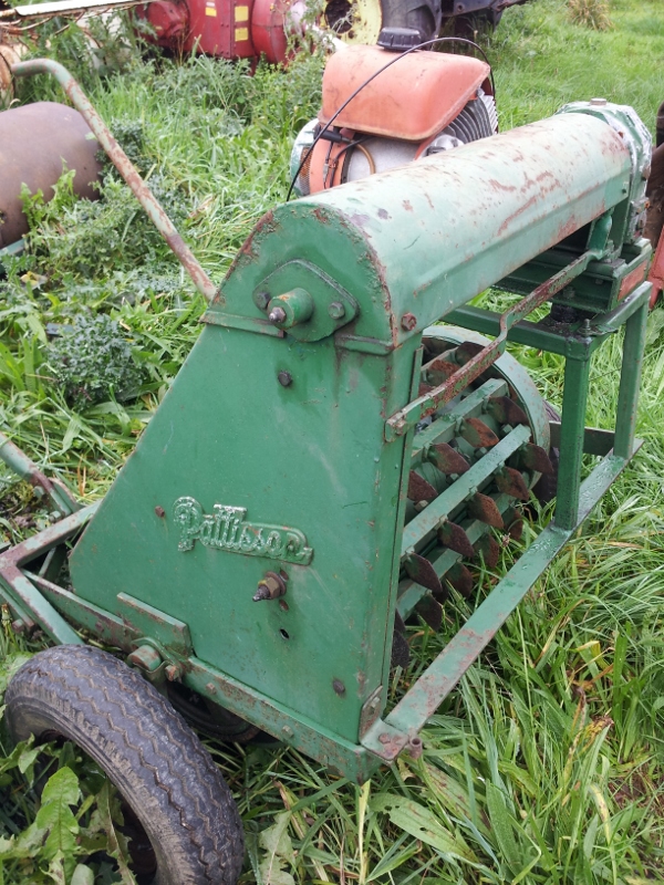

    Okay I think I have grasped the problem. I was not down sizeing the photos. Here I have this as a new project. the pattinson aerator powered by the sloper engine. sticking valve was the first problem,then the off on switch was rusted in the stop position. so here are some photos pre restoration. anyone with knowledge of these please step up as its a total unknown machine.
    #1429
    a few more.
