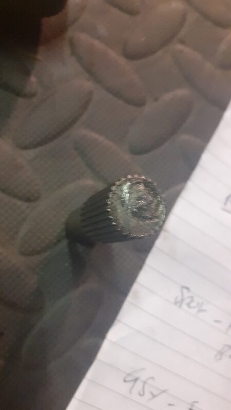

vhgmcbuddyMemberpic 4 is a diagram of shaft
pic 3 is how it sits
pic 2 is shaft removed
pic 1 is shaft
pic 5 is busted end of shaftDecember 8, 2020 at 6:42 pm #36139
ssorthiekParticipantFor me, the spline is an issue and not something I would attempt at this stage, it’s step too far for me I’m afraid. Looking at the fracture it looks as if the steel has been hardened although the photos isn’t too clear in this respect.
If it wasn’t for the spline, I would have loved to have a go but I’m sure that a machine shop can knock something similar up fairly easily.
Certainly, on paper this is achievable. but I haven’t resurrected my skills enough yet. Sorry.

ssorthiekParticipantDo we understand why the shaft failed in the first place? There are a few other ideas I have but this will leave he shaft weaker and more prone to failure. Of course a failure could totally destroy the gearbox which wouldn’t be good. I would be happy to play with my Colebys since I know that they will never be used again for ploughing or any hard labour.
