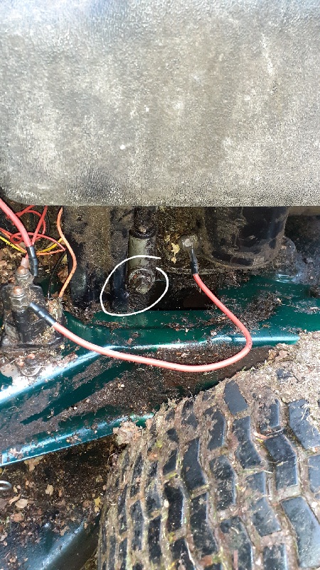

    I have a hayter 10/30 ride on. A superb single blade gear shift ride on.
    The issue is when it comes to oil changes the drain plug is so inaccessible I have never managed to not cover the LHS in oil draining it.
    I have tried a machine that sucks it out from the filler but it I am sure never gets all the oil out.
    Has anyone solved how to drain oil with an inaccessible drain plug where you cannot catch it ??
    I almost need a pipe to extend to a container. anyone mastered this ?

    any idea how I get the oil out of this drain plug into a container ?
    it is so inaccessible I cannot do this ever without getting the frame covered in oil

    Using a proper vacuum extractor with the machine tipped towards the base of the filler tube gets most of the oil out and if changed regularly what’s left is not worth worrying about.
    Alternatively get a quick release drain valve. Tip the machine away from the drain plug and fit the valve . Then, when it comes to change time, warm the engine, push a tube onto the valve with the other end in a catch can, and twist the valve to release the oil.
    A brick under each of the row opposite wheels helps in both cases.

    Superb idea. I never new such things as oil drain valves were even available.
    I do have a good engine oil pump that sucks it out but my old mower deserves a good clean out…..
    I’ll check the size and thread today. I dont suppose you can recommend a good oil drain valve ? … must be
    old imperial thread on a Briggs and Stratton

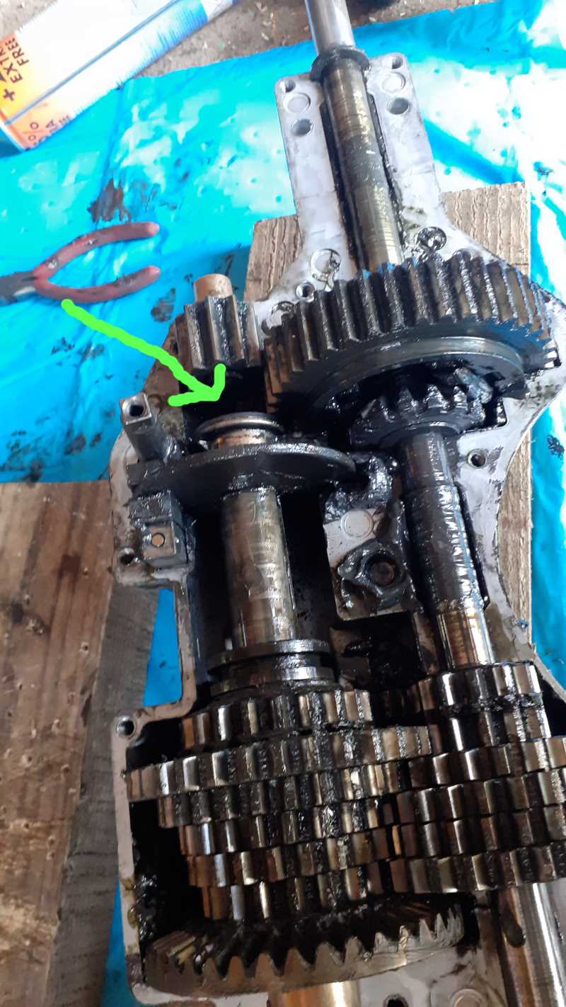

    I still think if it goes again I am gonna have to; like for spitfire parts, get one made. Do we have a resident obsessional engineer on the site who can make drive shafts …..

    If you can put a photo of the drive shaft on this post then I might be willing to have a go at making one, depending on how complicated it is. I’m starting to get into machining again and looking for simple projects. I suspect that this will have splines and will probably be a step too far for me at this stage, but lets see what’s involved.

    It seems to be a 8″ long bar ? and cogs slipped onto it.
    I am yet to look further at it as i got another.
    I did put a post on here for my old transaxle but i cant find it.
    I attach some pics and have the old transaxle still.
    I can send details if you request.
    Be great to at least know if on paper you could do it ?

    This certainly looks possible, what sort of diameter is it and how quickly do you need it. I guess there are bearings on the shaft and that’ll be the more difficult bit with tight tolerances for an interference fit and to get a smooth enough finish. They keyway shouldn’t be too much of an issue. What neck of the woods to you live in? I’m up North, Charlie might be able to give you my details.
    If I can’t, most machine shops should be able to make one if they have the original part as a pattern.
    The big issue for me is do you know what caused this to snap in the first place, it looks as if it must have been quite a load on this shaft for it to snap on the larger diameter. Also is the machine going to be used at it’s full capacity since any part machined is likely to be weaker than the original part.
