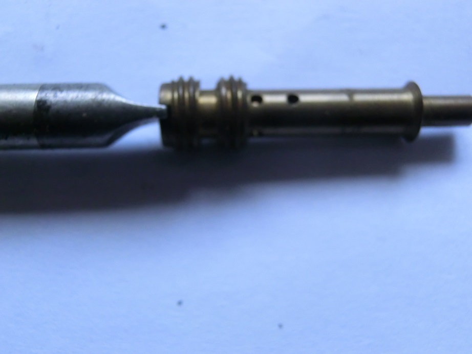

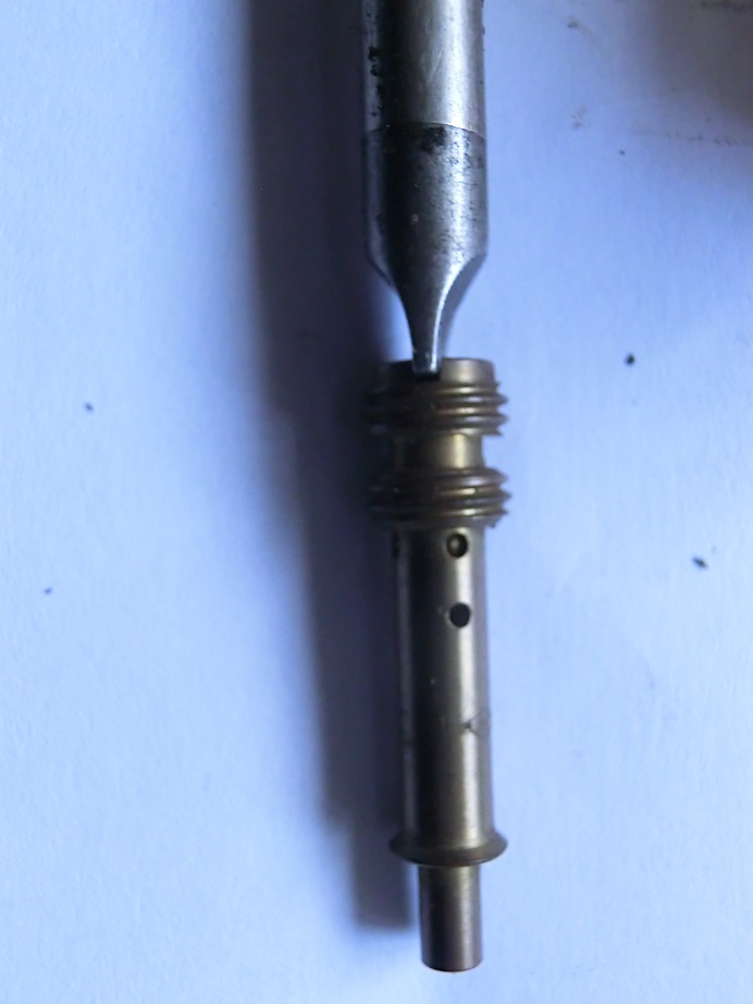

    This link written by a Briggs and Stratton Master Service Technician (now retired) tells you all that you need to know about Flow Jets. Far better advice than most of the YouTube chancers!
    https://www.perr.com/tip9.html
    Couldn’t find my image of a jet removal screwdriver earlier but here it is. That’s not a Briggs jet.
