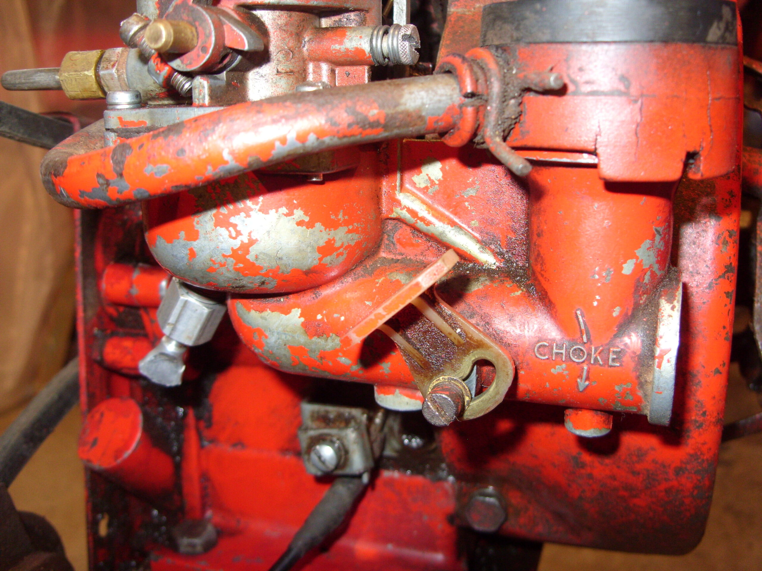

    Hi. This is a my flo jet carb, is yours like this. I got the kit on Ebay old stock. If you Google Briggs flojet, it will give you lots of advice. This kit would be no good if your carb is a different type.

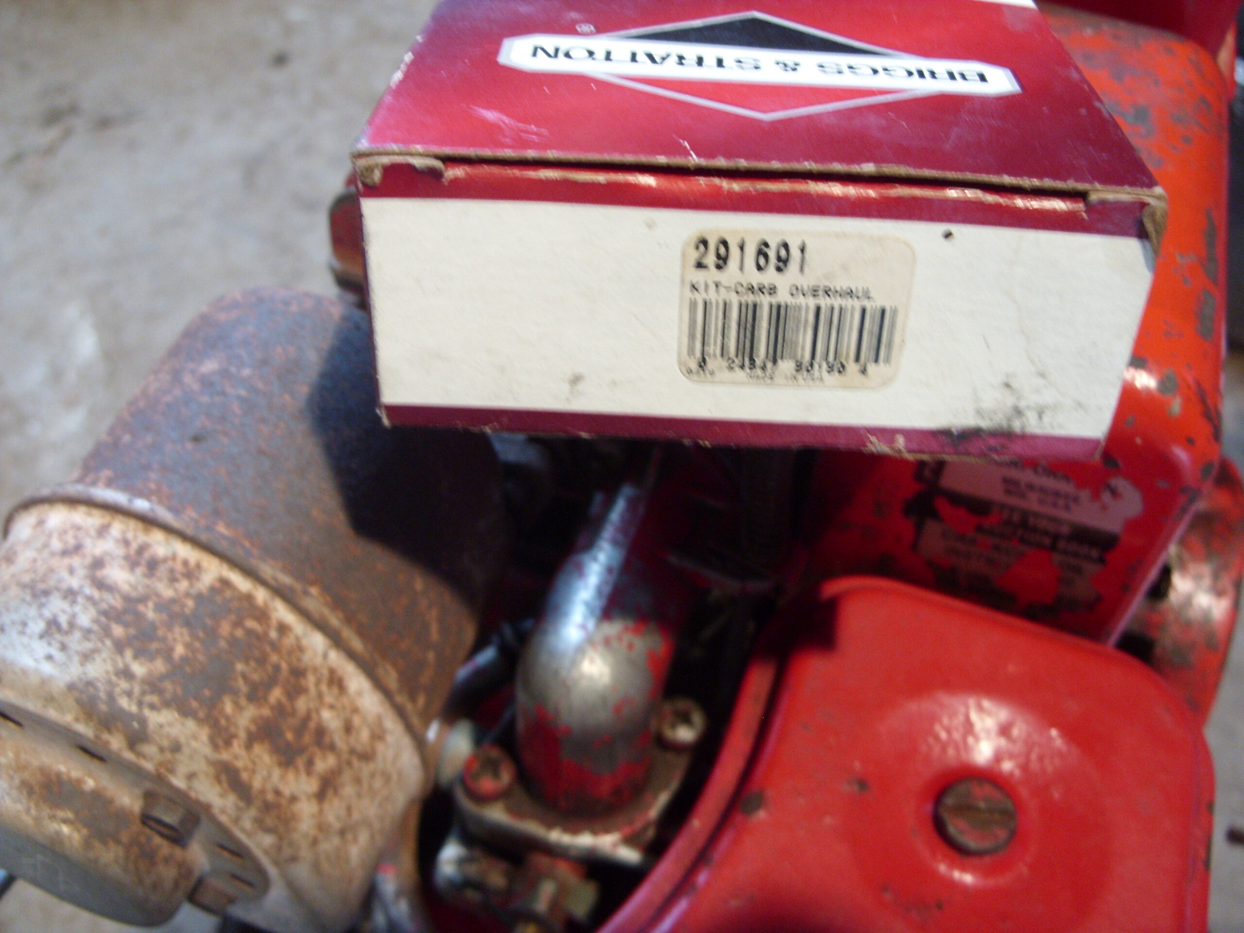

    Thanks for those nugets chaps 🙂 i now know what a flow carb is …and mines not one …but i did come across a diagram that was mine whilst looking at them…..i got a part num off it and found a service kit on ebay for £16 new tube needles gaskets, o rings etc………this is the link if anyone else has the same problem 🙂 https://www.ebay.co.uk/itm/231108048018?ssPageName=STRK:MEWNX:IT&_trksid=p3984.m1439.l2649 could still do with a peek at a manual if anyones got one ? cheers

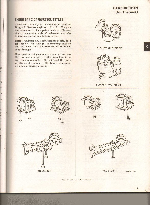

    It appears you have a Flo-Jet two piece carb see illustration.
    #8276
    As Charlie says, two piece Flo Jet. Just Google Briggs 803020153 and you’ll get an illustrated parts list. Cannot over emphasise the need to remove the angled jet (Briggs call it a nozzle) before trying to separate the two parts of the carb.
    It’s situated behind the mixture adjuster that looks like a fuel tap sticking out of the bowl at an angle.
    For safe removal of the nozzle you need the correct tool or a good fitting parallel sided screwdriver. An old screwdriver ground down for the purpose will be a useful addition to the tool box!
    #8278
    Attached is extract from workshop manual which covers Flo-Jet carb.
