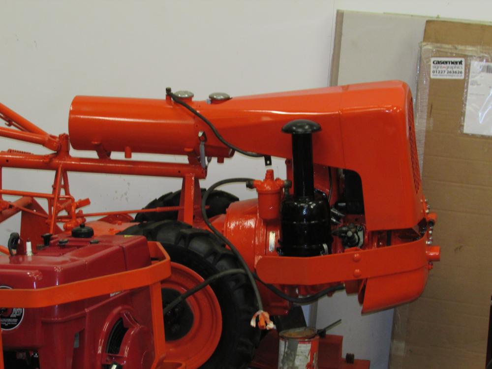

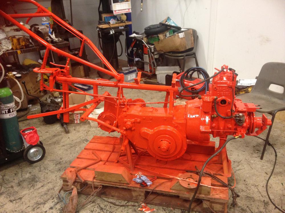

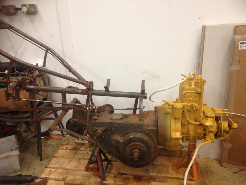

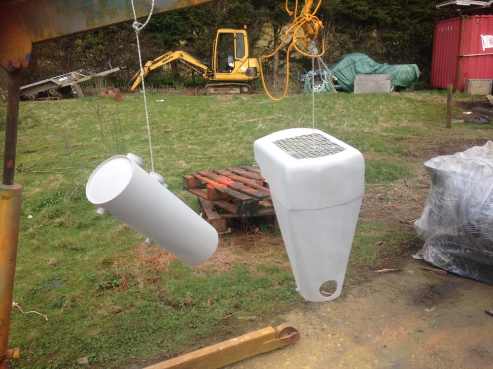

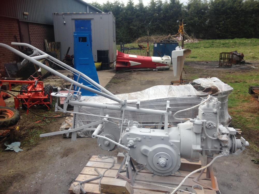

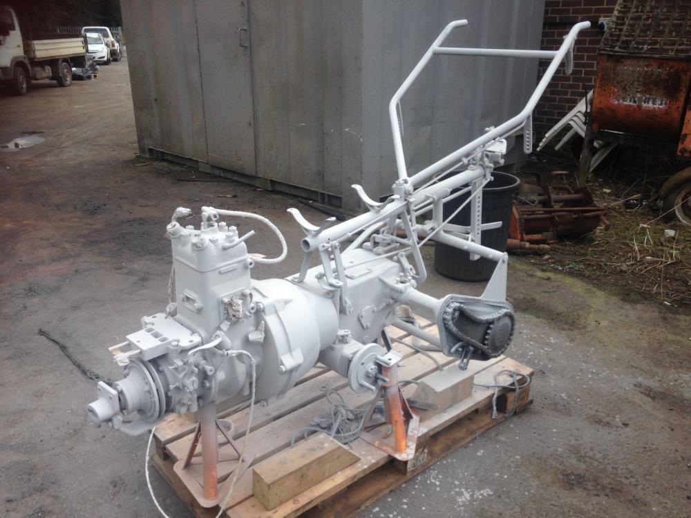

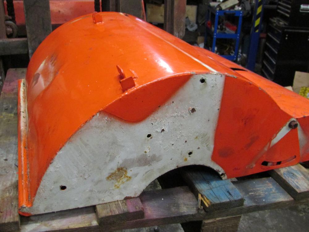

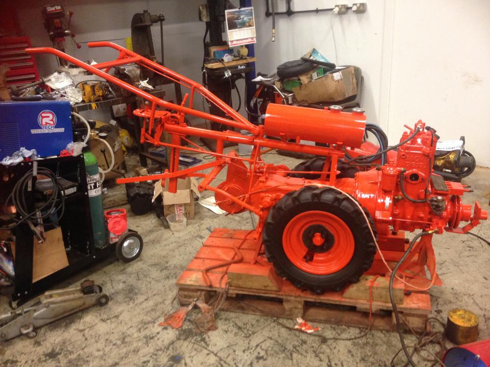

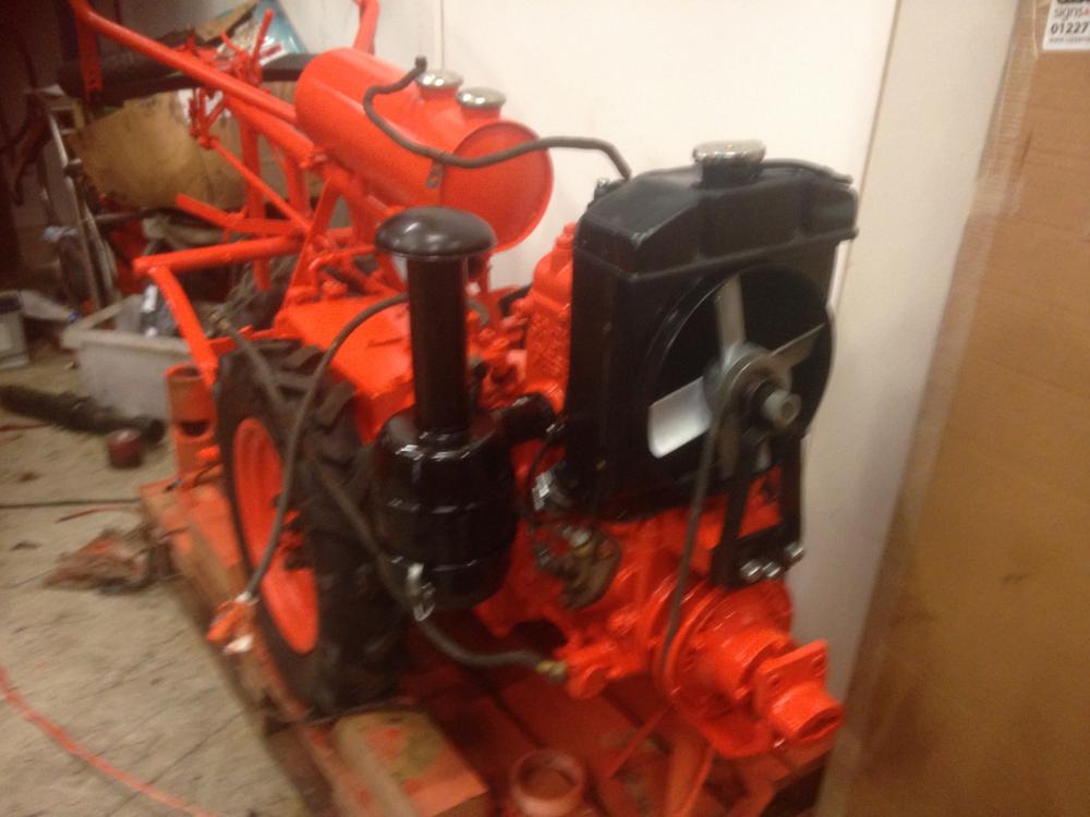

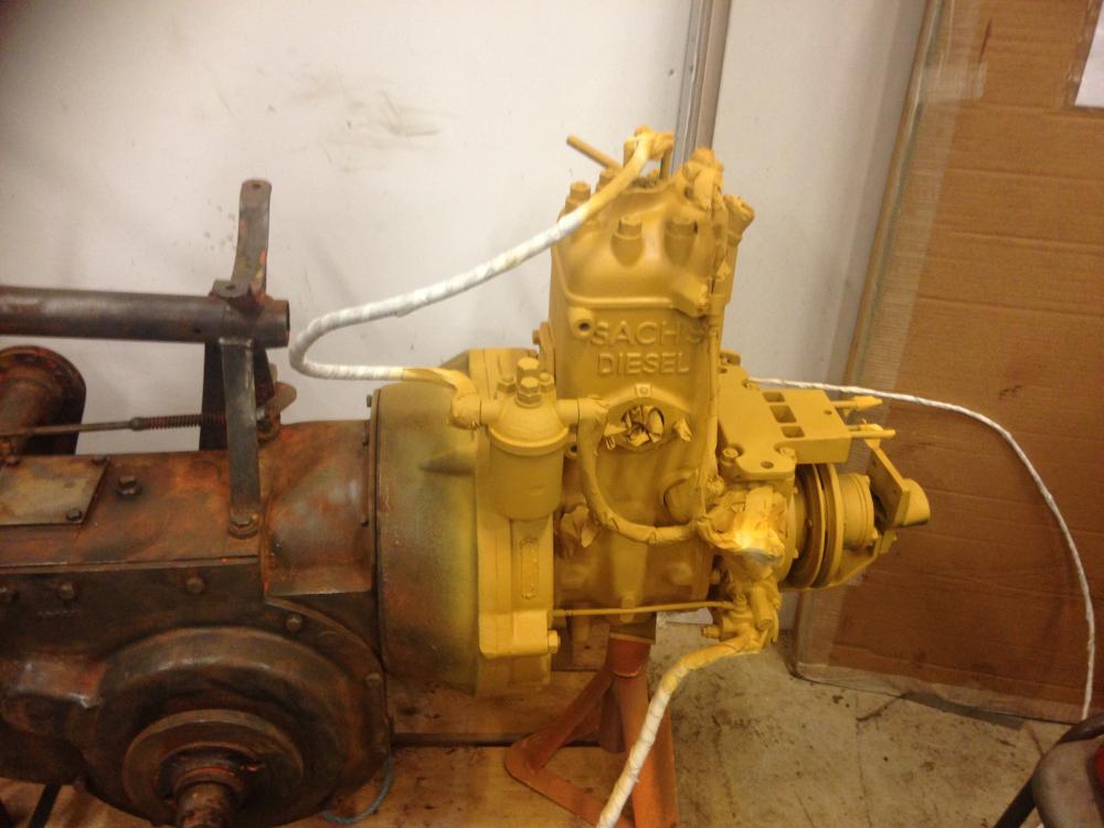

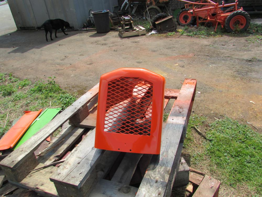

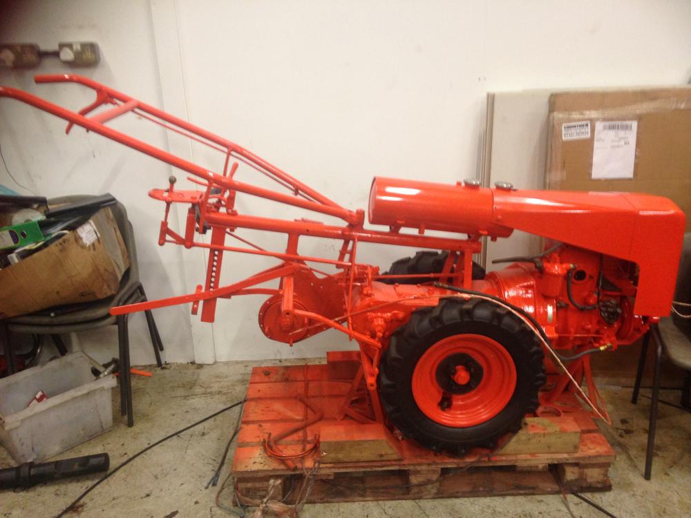

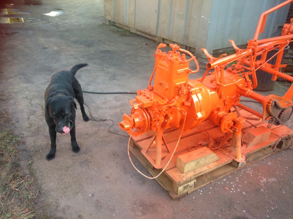

    At long last I’ve finally started making some proper progress. The main chasis was wire brushed down and then after what seemed like an enterinity the pipes and cables were masked up. The engine was etched primed then the whole thing was primed and sprayed in my favourite top coat colour. Overall I’m happy with the way everything has come out bar the bonnet which will need flat ting back and another top coat applied.

    Looking very smart.

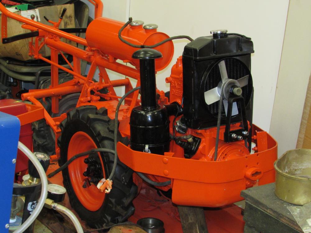

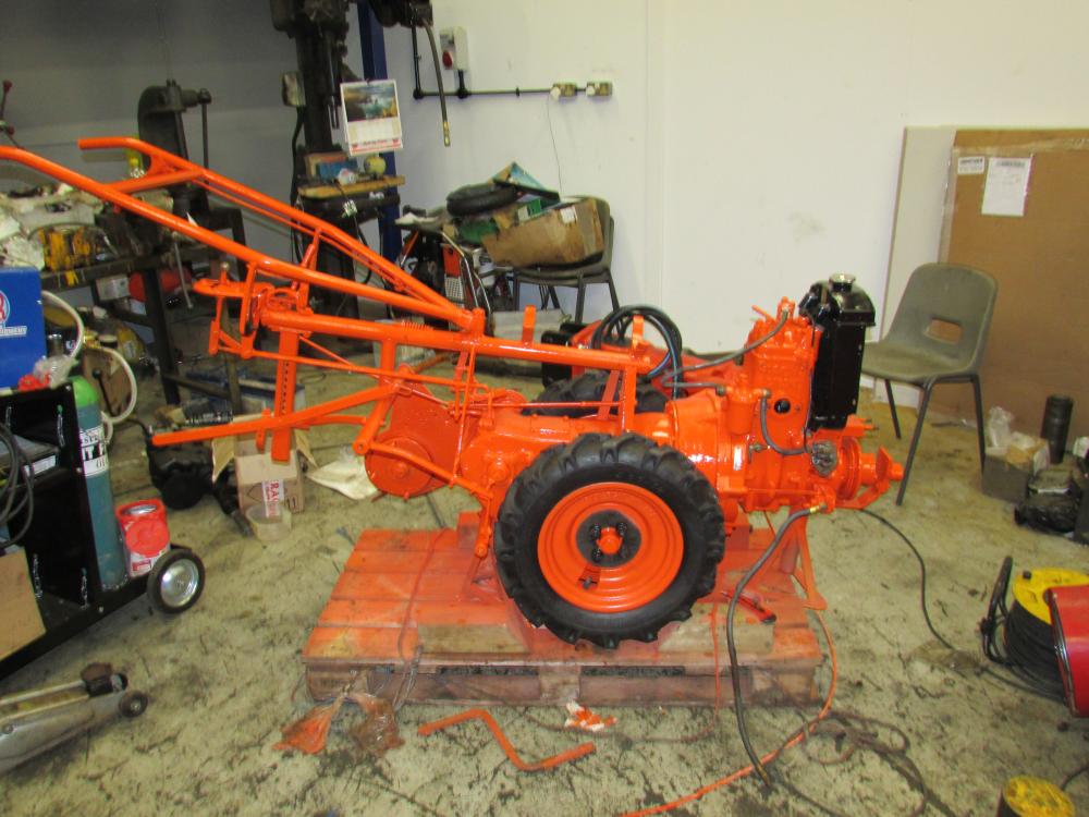

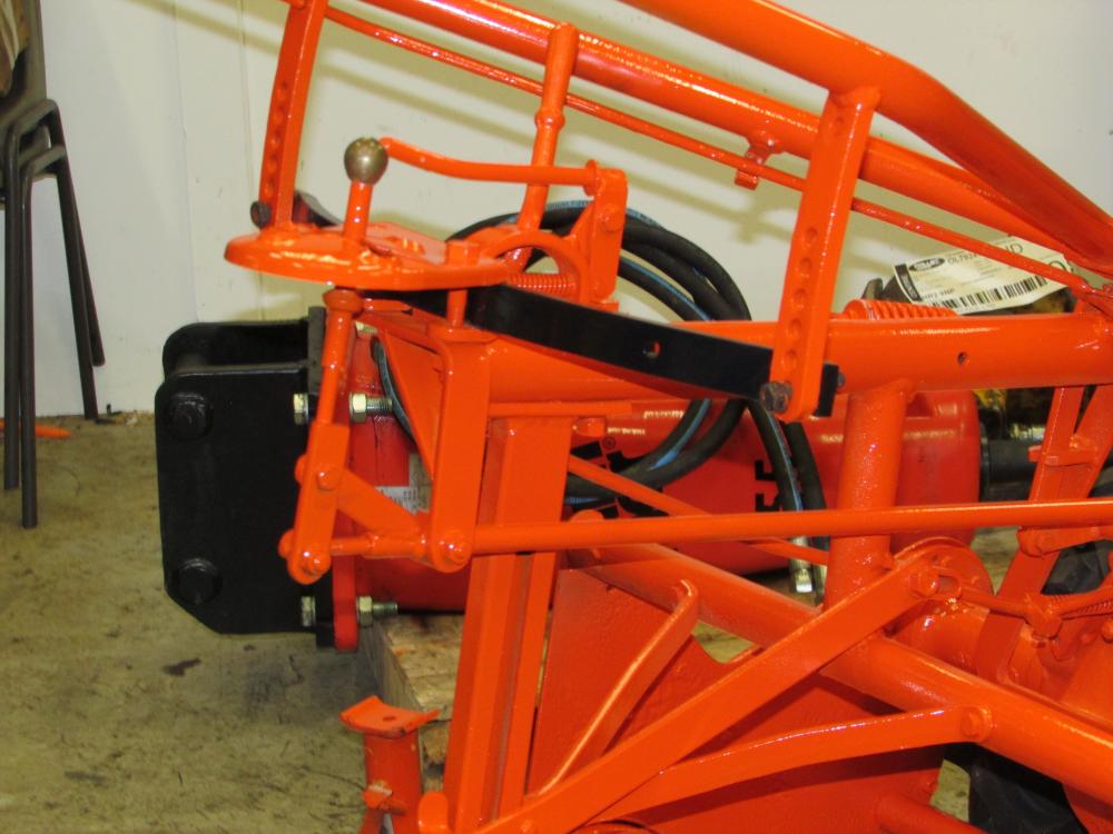

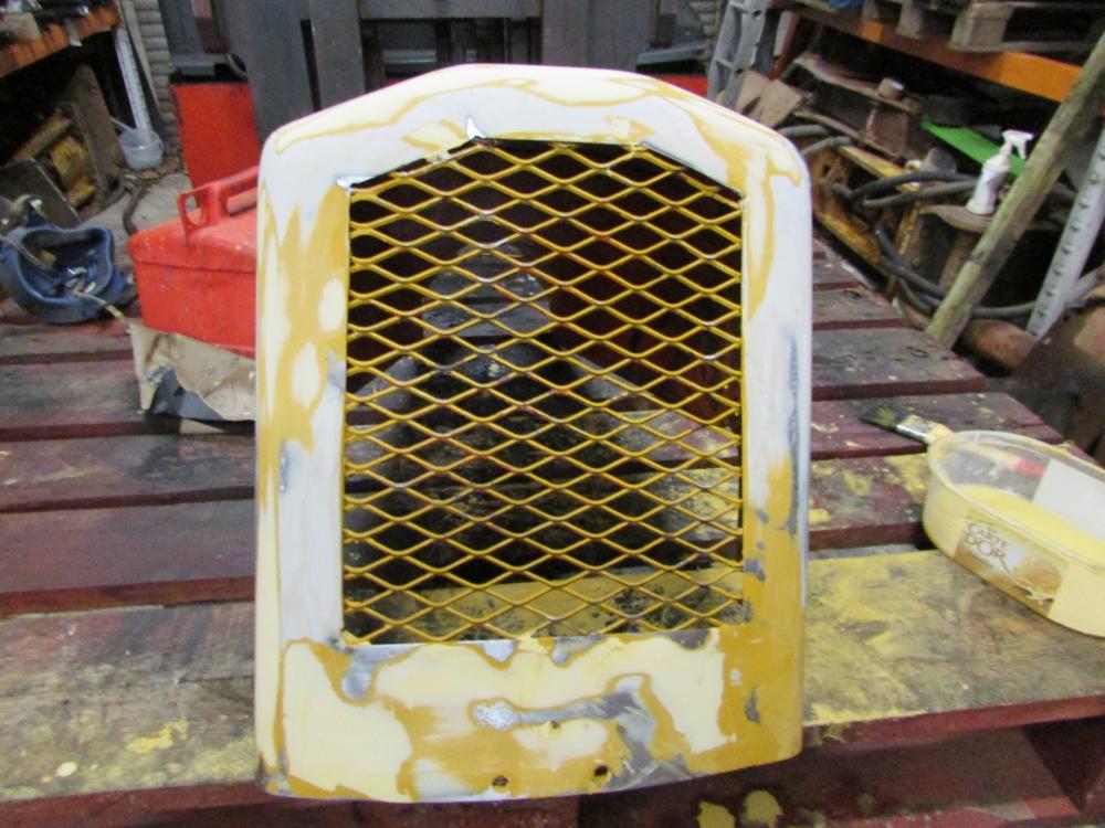

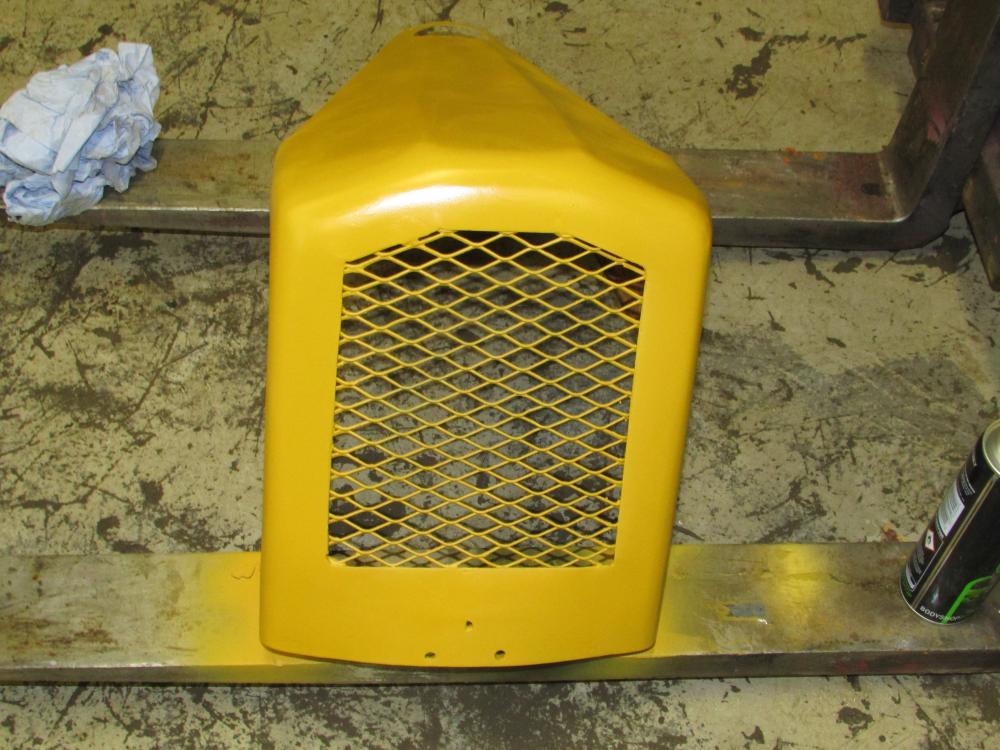

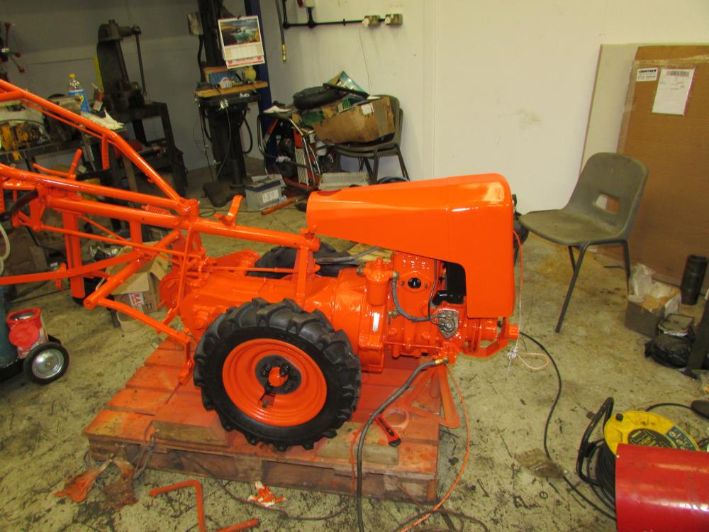

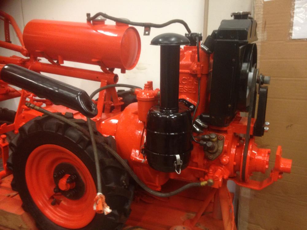

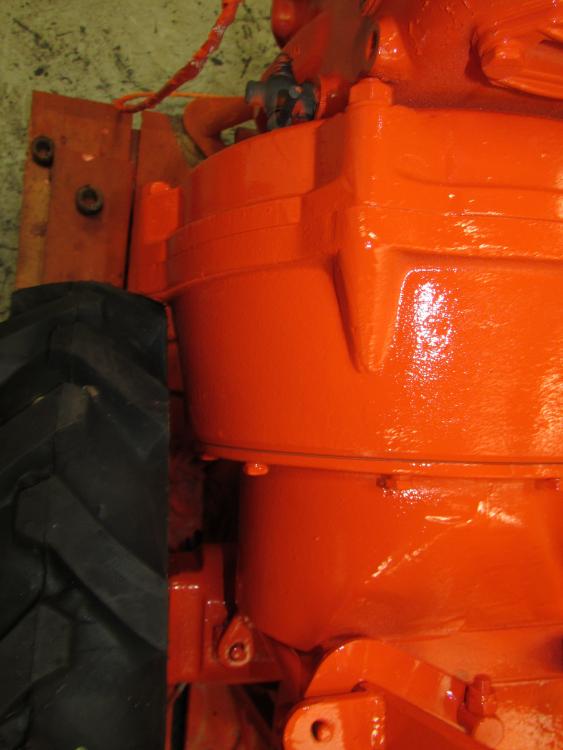

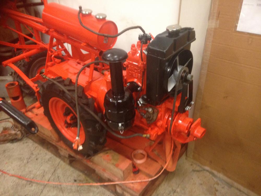

    Have now started fitting the gem back up. The first job was the wheels. Had a bit of trouble with the near side one as usual- such a pity you can no longer get the original Dunlop tyres, the used to fit a treat. In the end I’ve resorted to using another wheel disc to act as a spacer to get the necessary clearance(just) on the bellhousing but this in turn will mean that the springs need shortening. I have also refitted the radiator. After having a proper look at the bonnet now it has dried I’m hopping to get away with flattening it back with some 2500 wet and dry.
    #24821

    The size is in theory the same, it’s just originally the gem would of had Dunlop diamond pattern tyres. These tractor type patterns are just a lot chunkier on the cleats and often cause clearance issues on the near side. If you look at the bellhousing on this one you can see in the one place where the metal has slightly worn away due to rubage. Most Sachs diesels that I see have the inside edge of the cleats removed to overcome this problem.

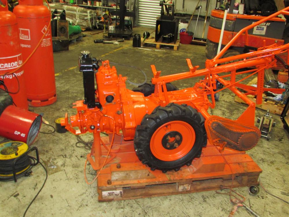

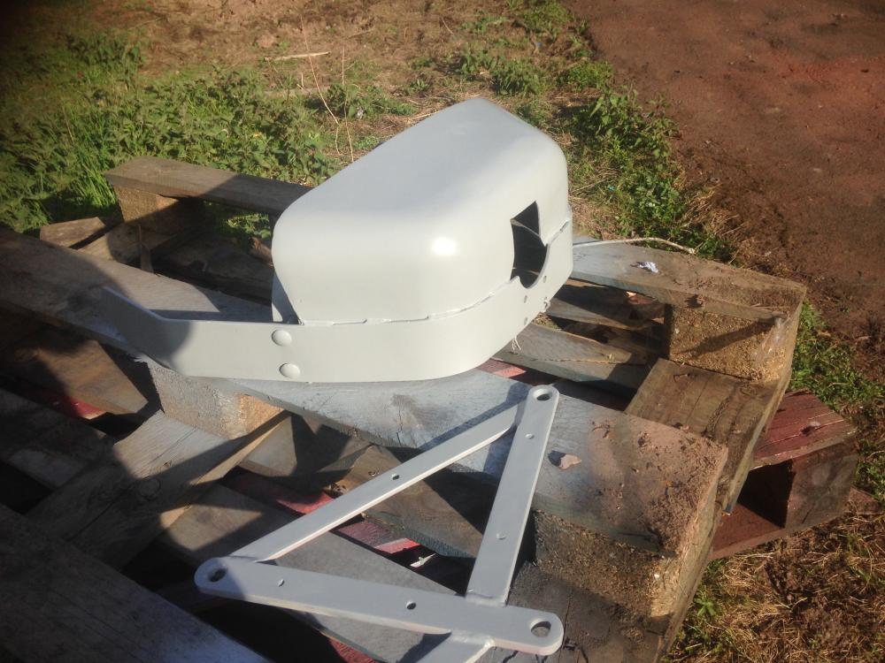

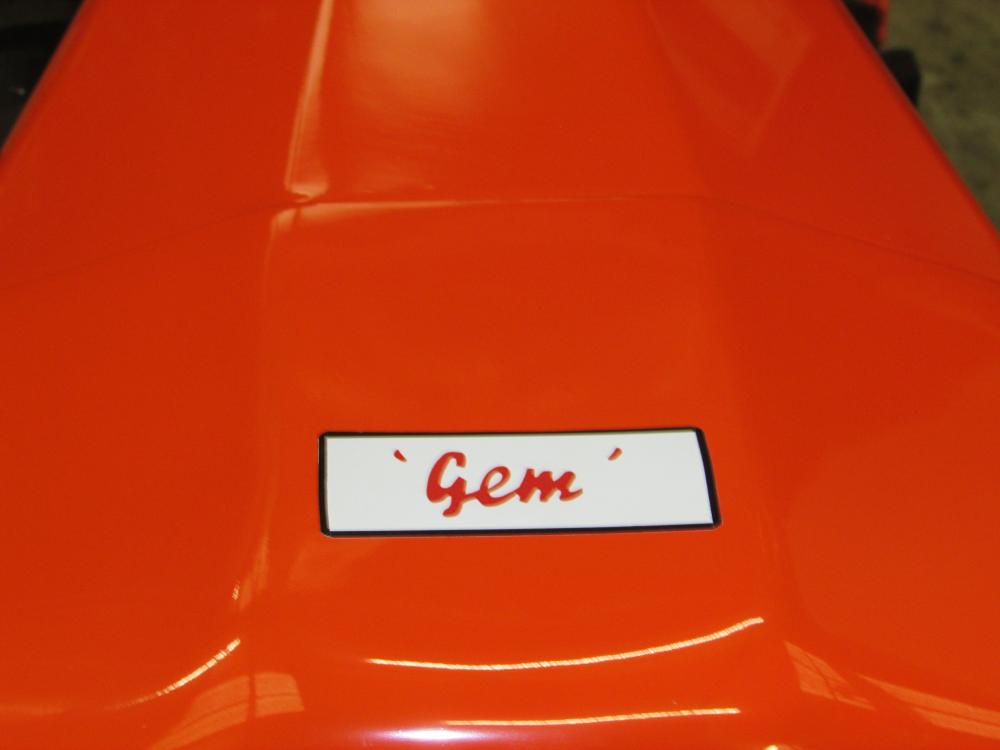

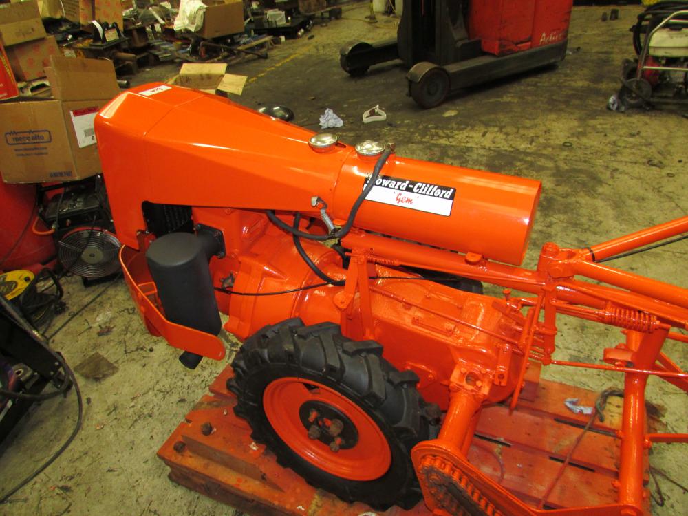

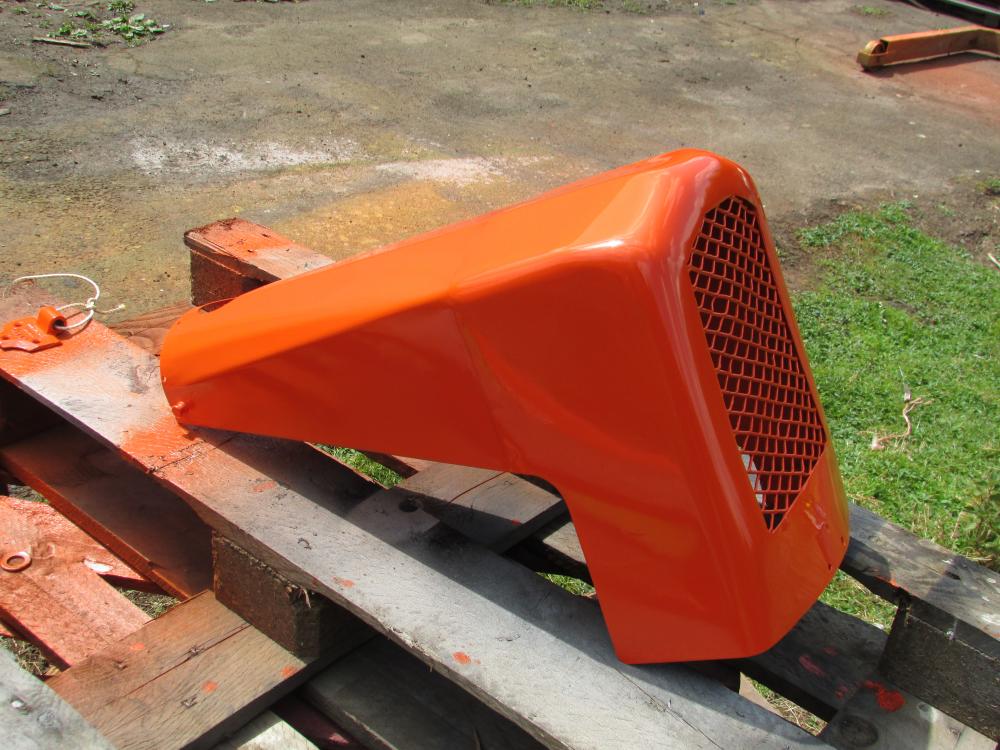

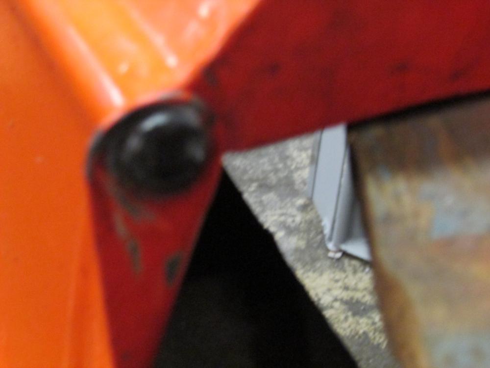

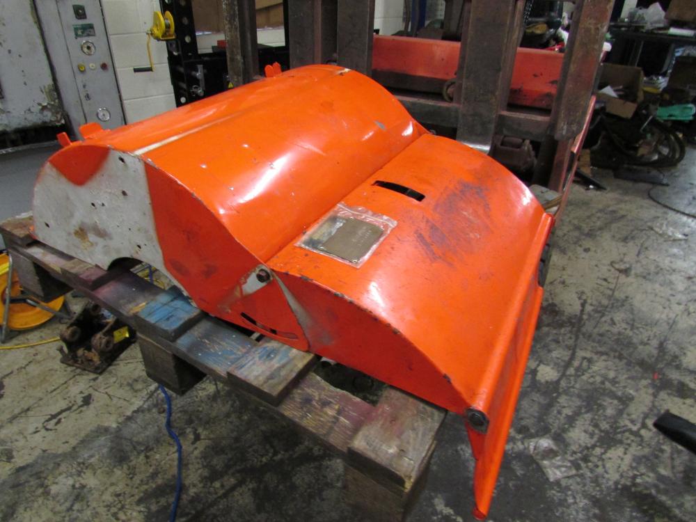

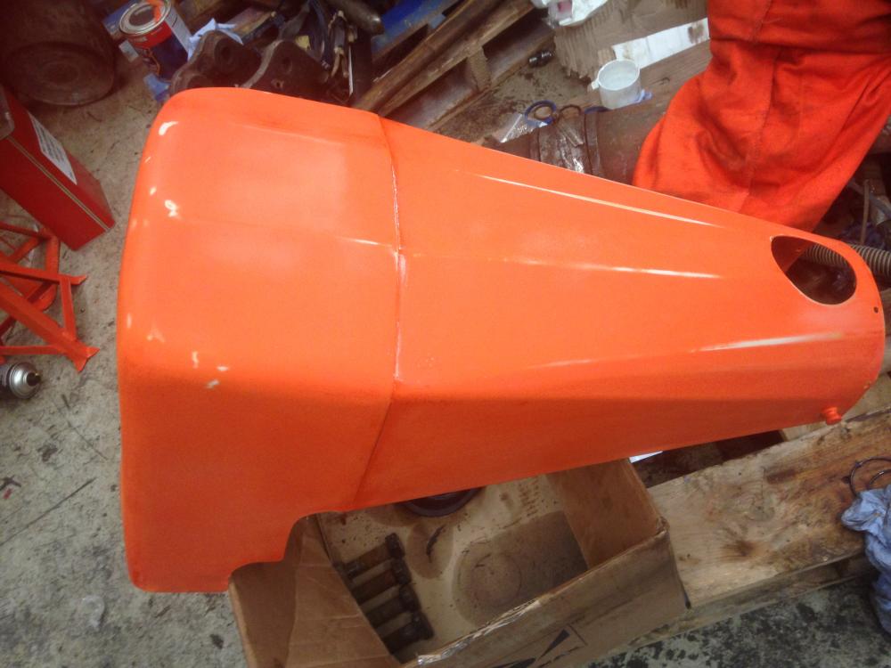

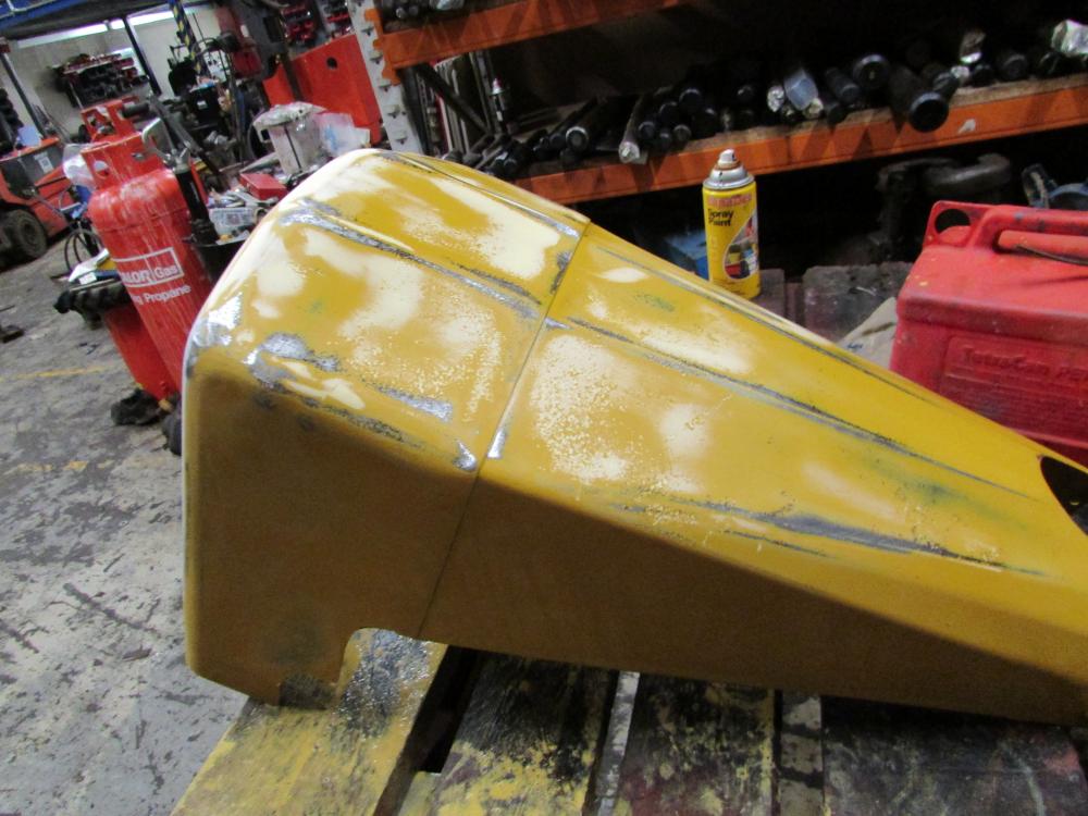

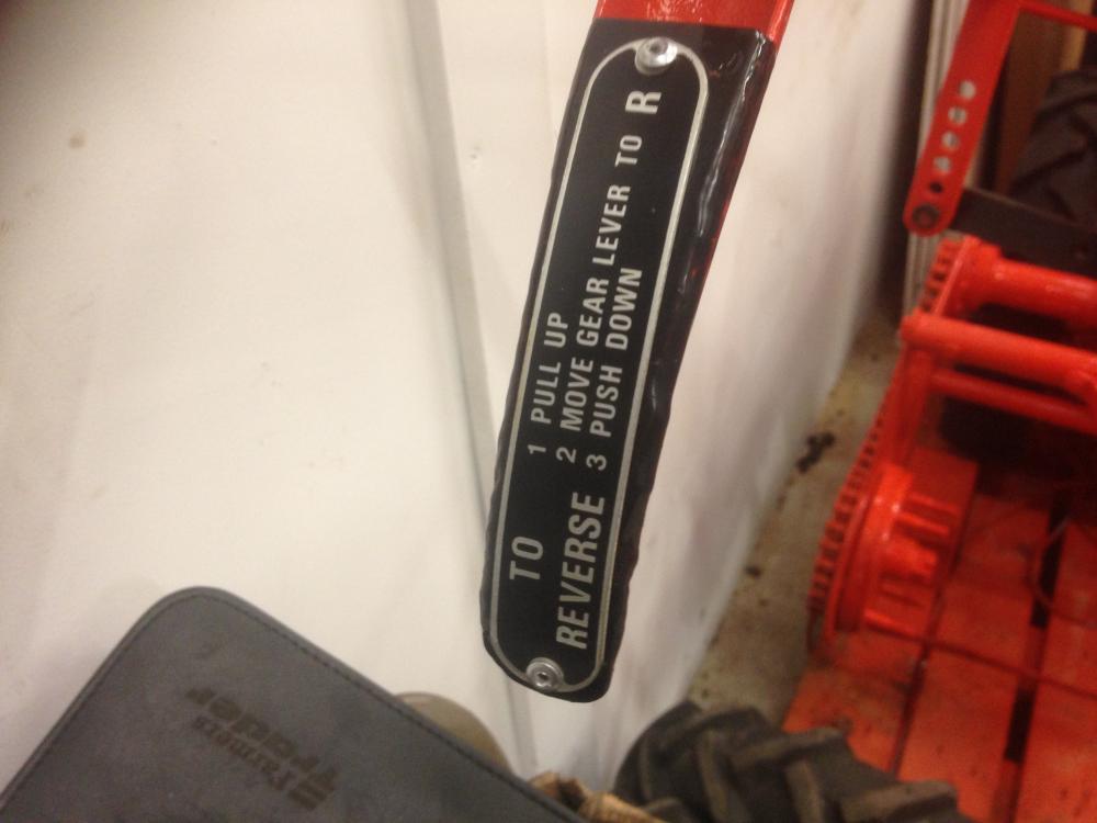

    Been meaning to update this project for a few weeks. The build up has slowly continued. After flattening back the bonnet I decided the only thing to do was to resprayed it again. New old stock badges have been fitted all round as well.

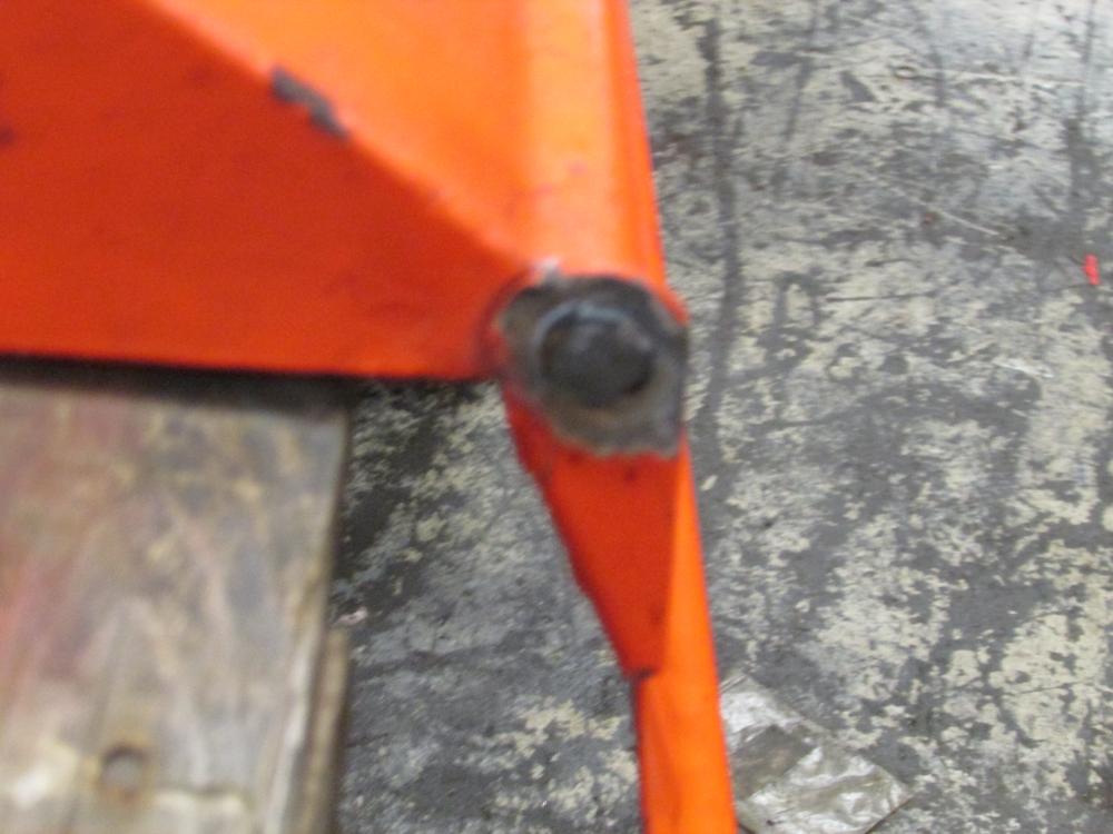

    Originally I was going to fit a salvaged set of rotor covers off a Dowdeswell, however without going into boring rivet counting details, they aren’t quite right. So I have swapped some engine parts for a good second hand set of period correct ones. These will need a bit of straightening and I’ve already welded the rear trailing board back into place.

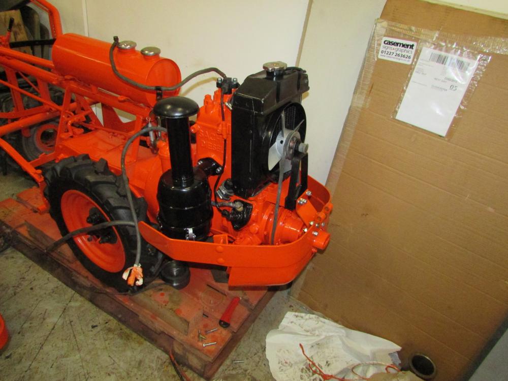

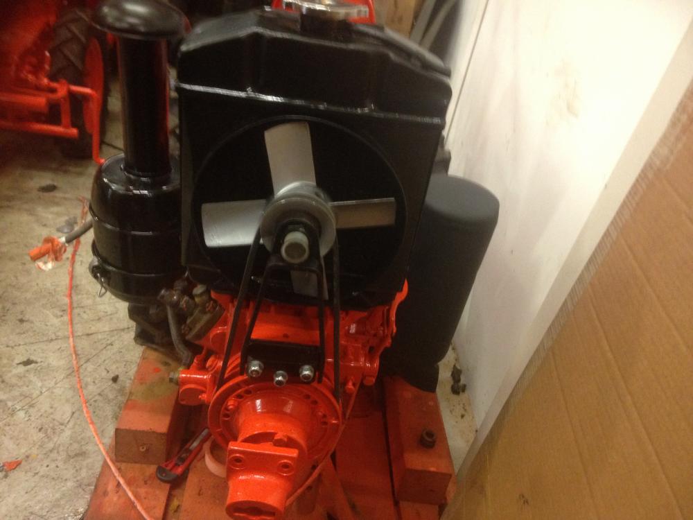

    Here’s a couple more photos that for some reason didn’t up load first time?

    #25196
    It ran when I acquired it, however it was a pig to start. Since then I’ve had the injector rebuilt,so should now start well. As soon as the back end is on to balance out the machine(it’s very front end heavy and has a habit of tipping up) I will bleed the fuel system out and try again.

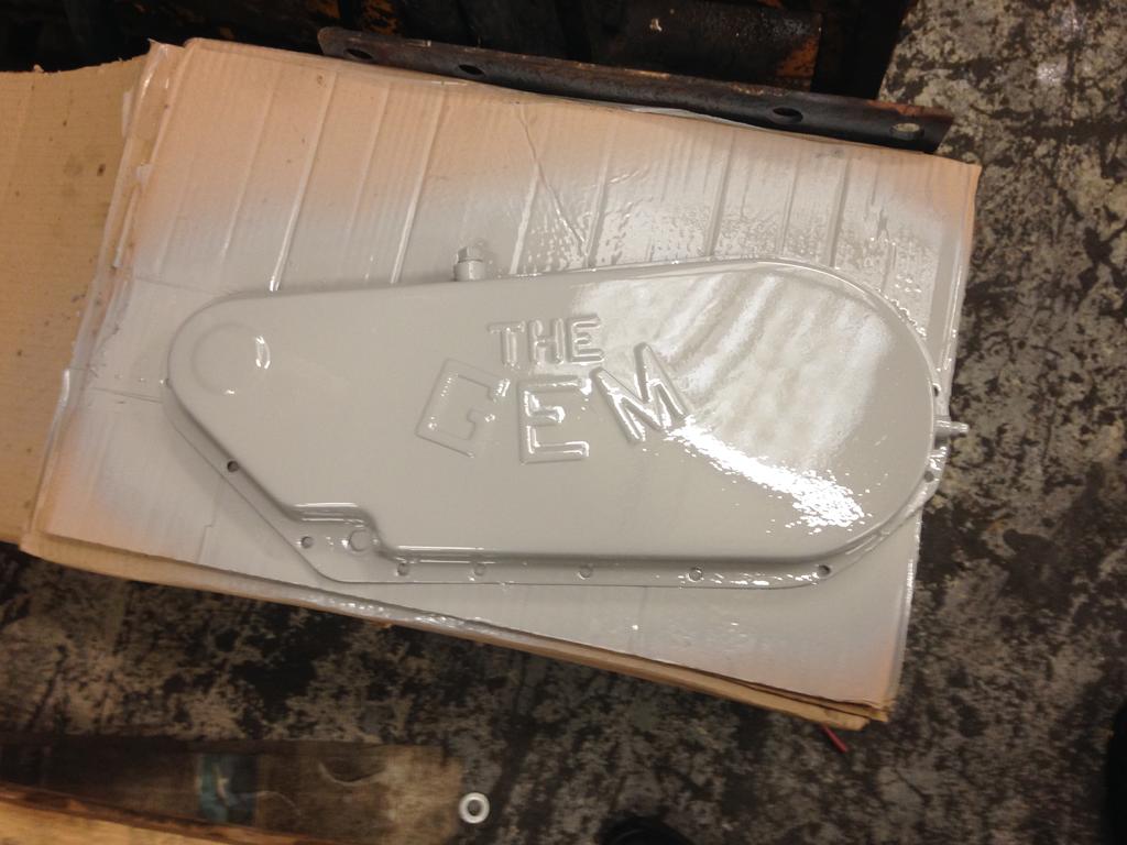

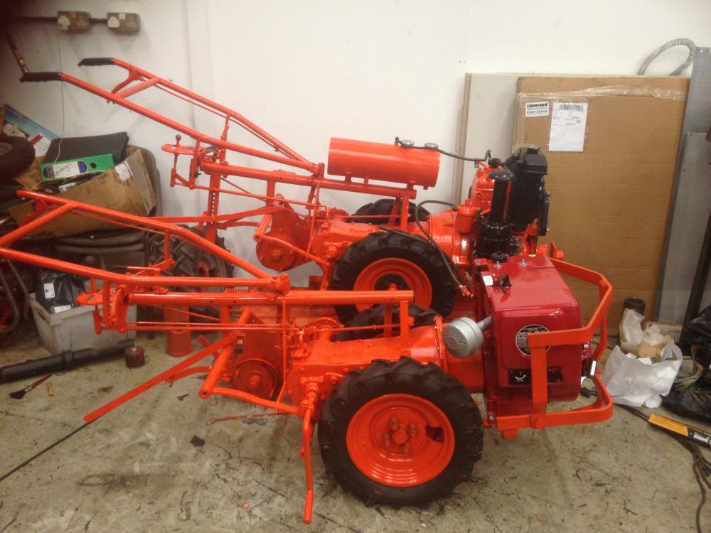

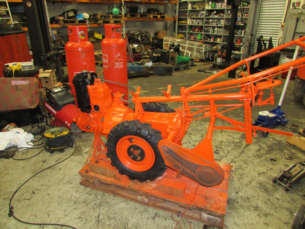

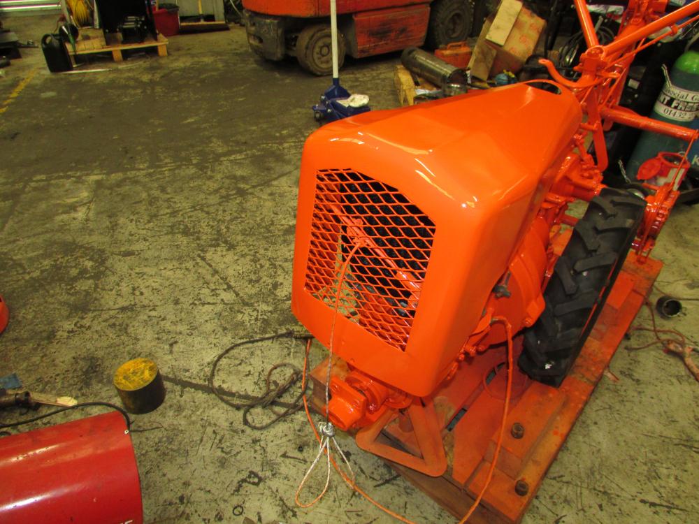

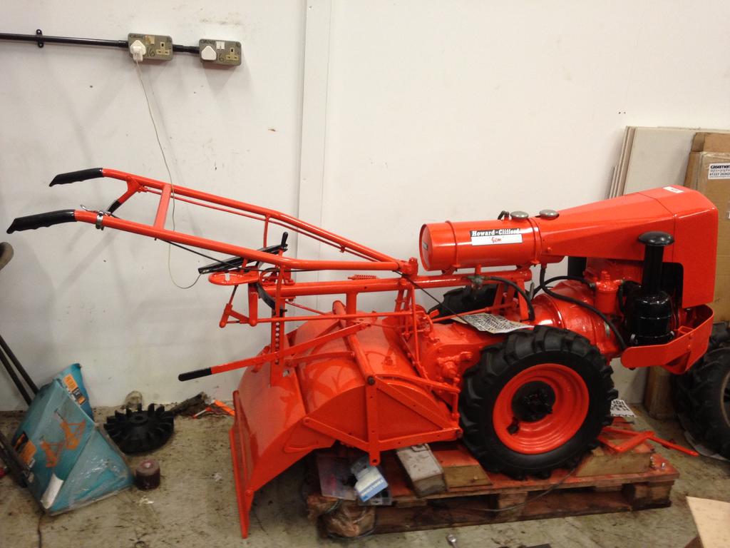

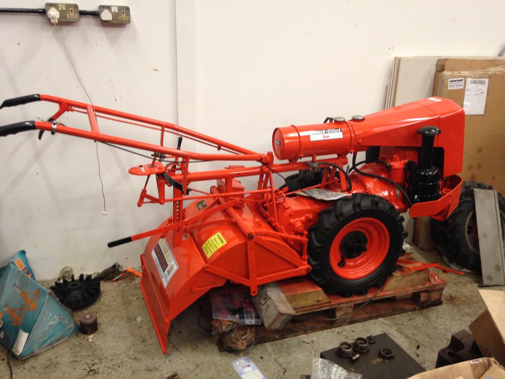

    Have had a lot of issues going on recently so haven’t touched this in nearly two months. Here’s where I am up to at the moment. It’s nearly finished, just the rotor shaft, chain cover and depth foot to do, along with probably loads of little finishing off jobs.
