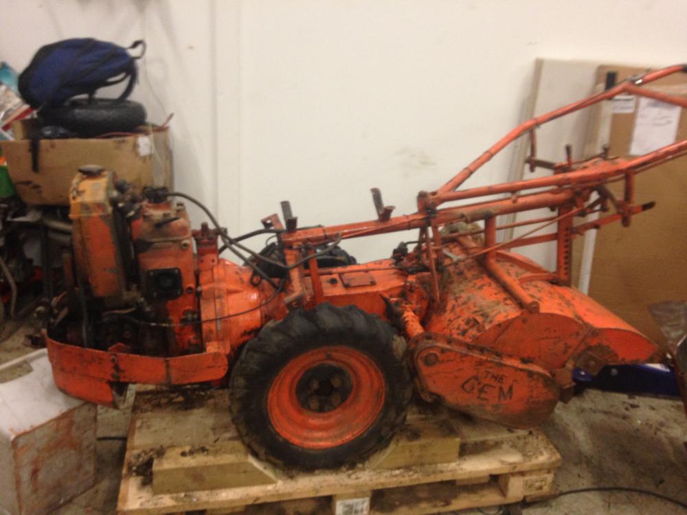

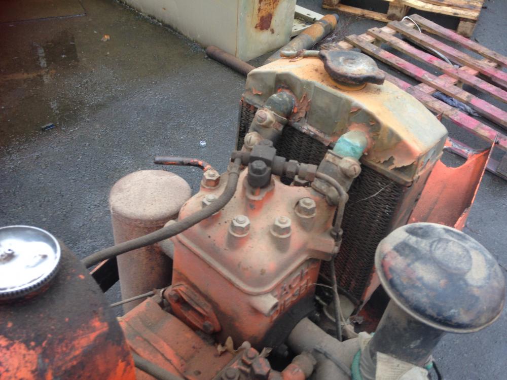

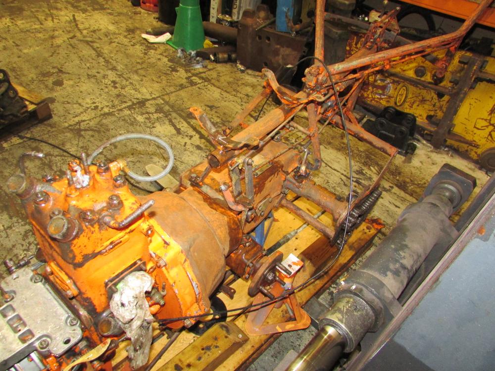

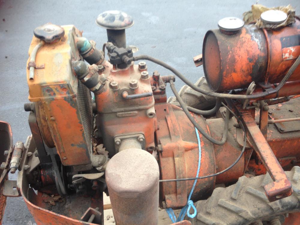

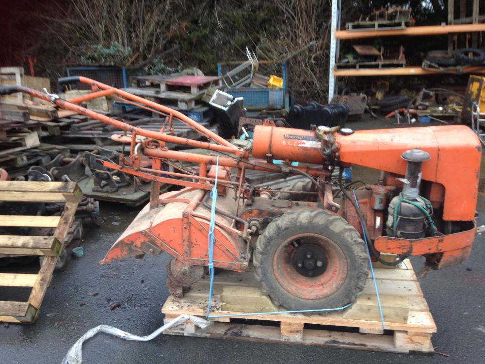

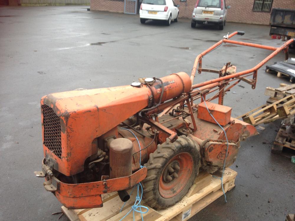

    Here’s my latest project. A 1961 Sachs diesel engined howard. I was offered it free of charge by a total stranger through my website. What’s more it’s a runner!
    I sent my carrier in for it unseen, however when it got back to my yard I was pleasantly surprised just how good it was.
    #24195

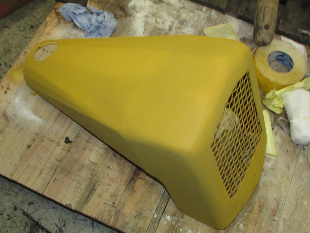

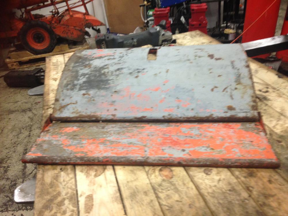

    I started off removing the bonnet, air filter and exhaust etc. The bonnet is one of the straightest I’ve ever seen with just a bit of panel beating and a small crack welding required.

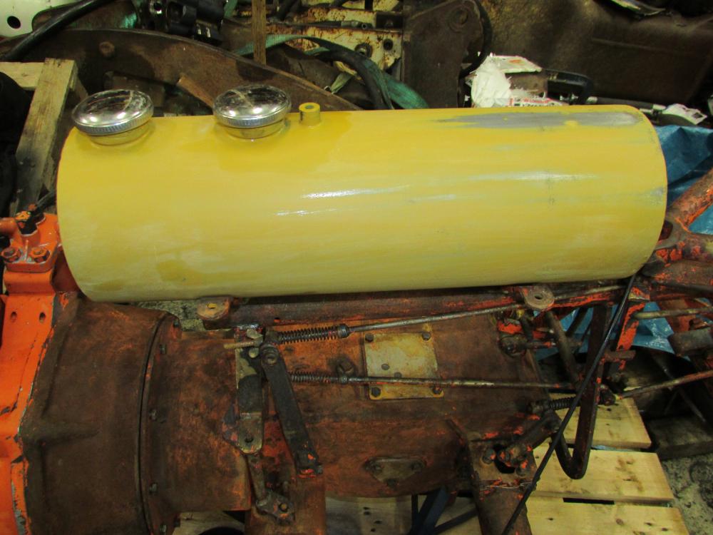

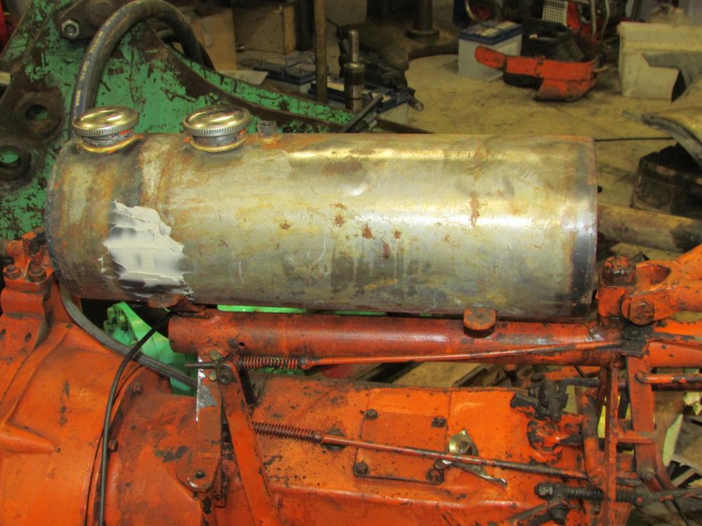

    #24199

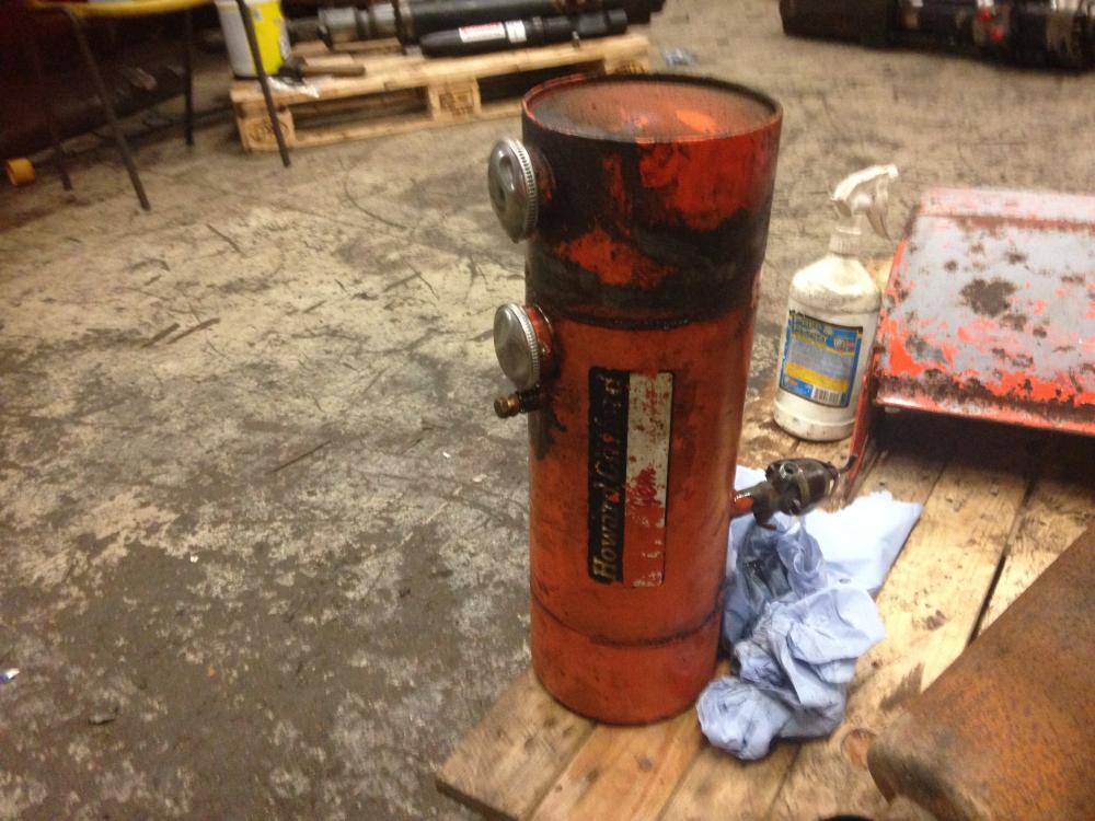

    The fuel tank has been very well preserved, probably as a result of spiller diesel and oil over the years.

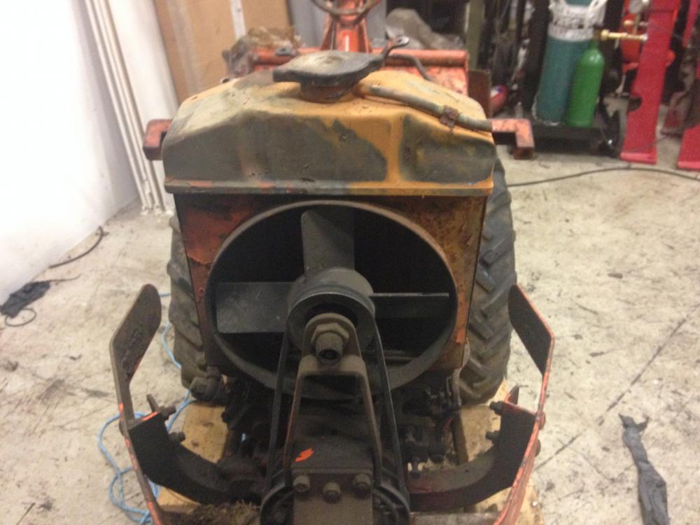

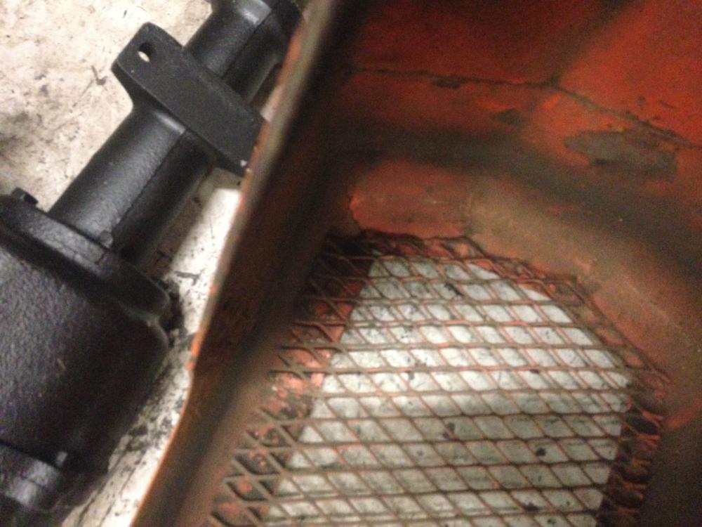

    #24207

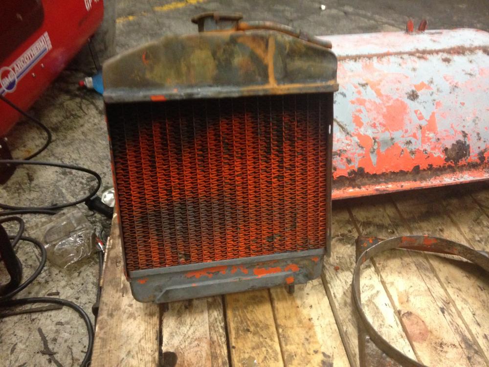

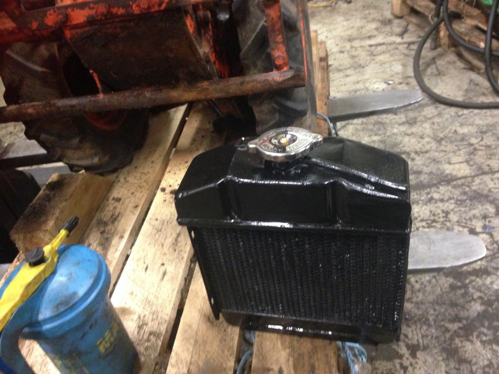

    The radiator is in good original condition, after straightening out a few fins and a new cap followed with a coat of paint. Here it is.

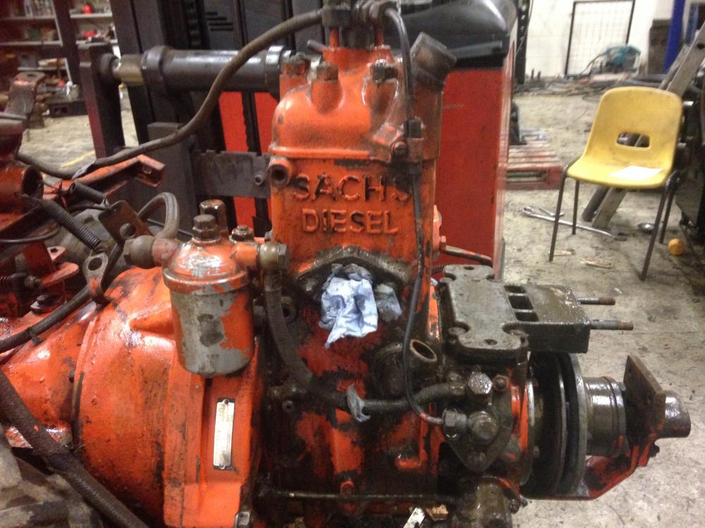

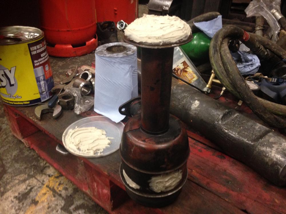

    #24211

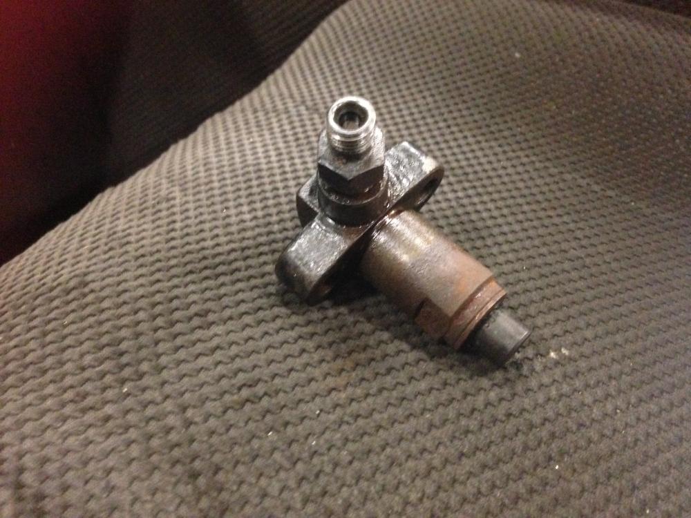

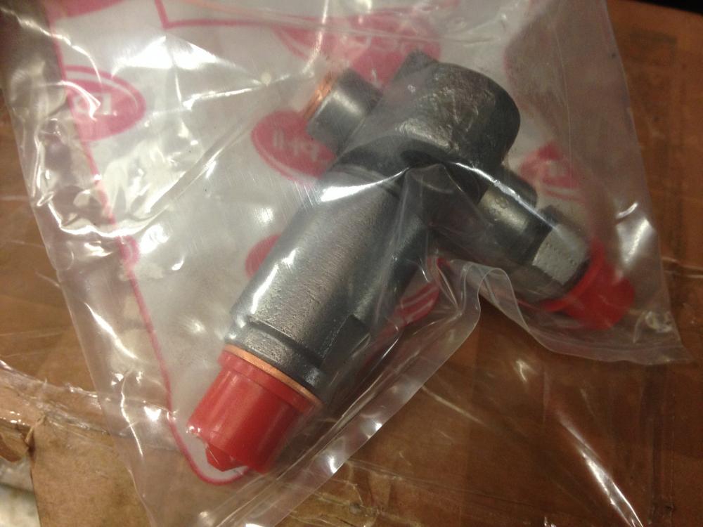

    The gem run, however it is a bit of a pig to start. The general consensus is that the injector wants overhauling. Following advice on here I have removed it and am going to send it to diesel Bob.

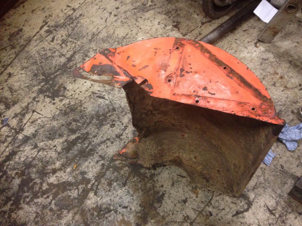

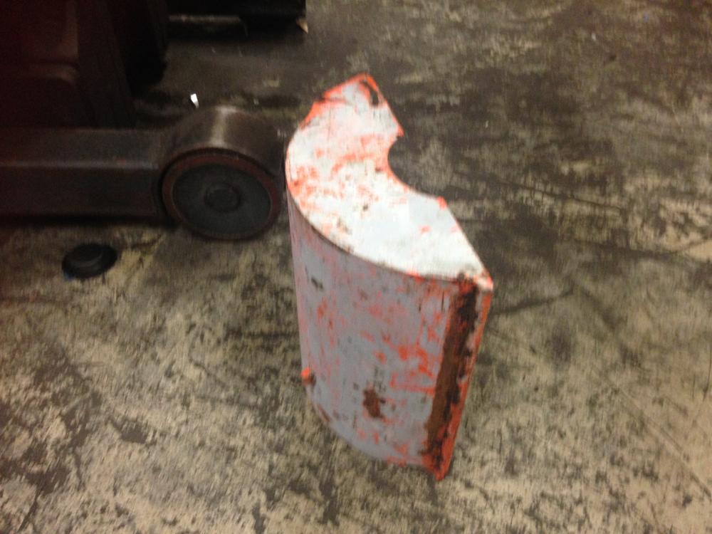

    #24213

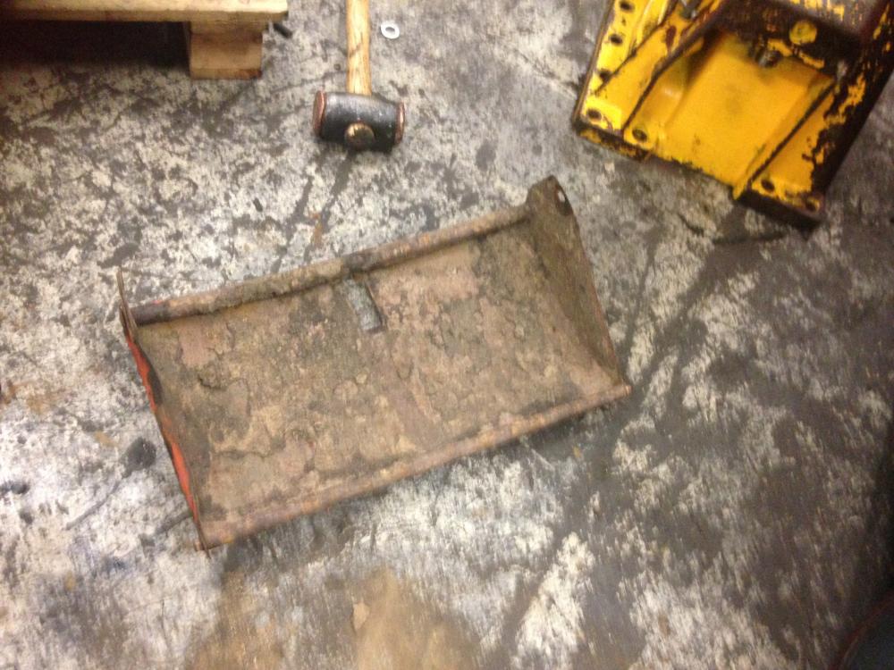

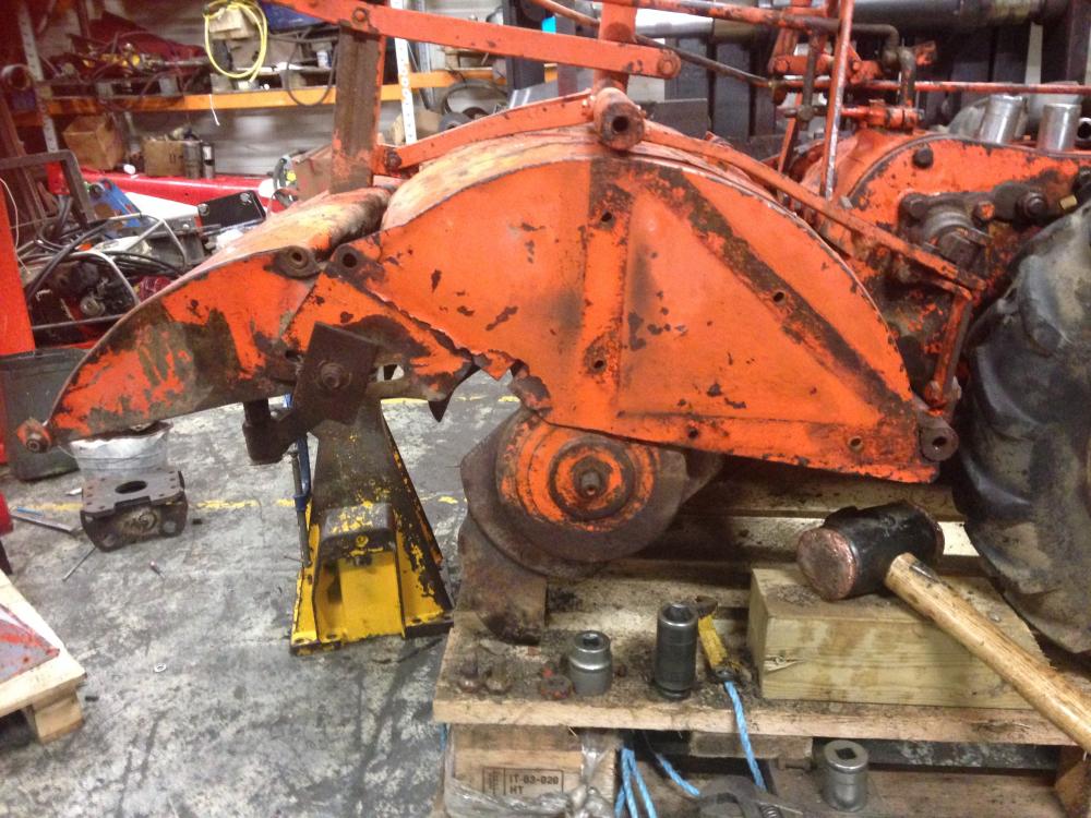

    Last night I started removing the rear rotor covers. Once off they were actually worse than I thought. With this project I’m trying to stick to a strict budget so I’ve dug out a good second hand set and have started the laborious task of stripping the old paint off.

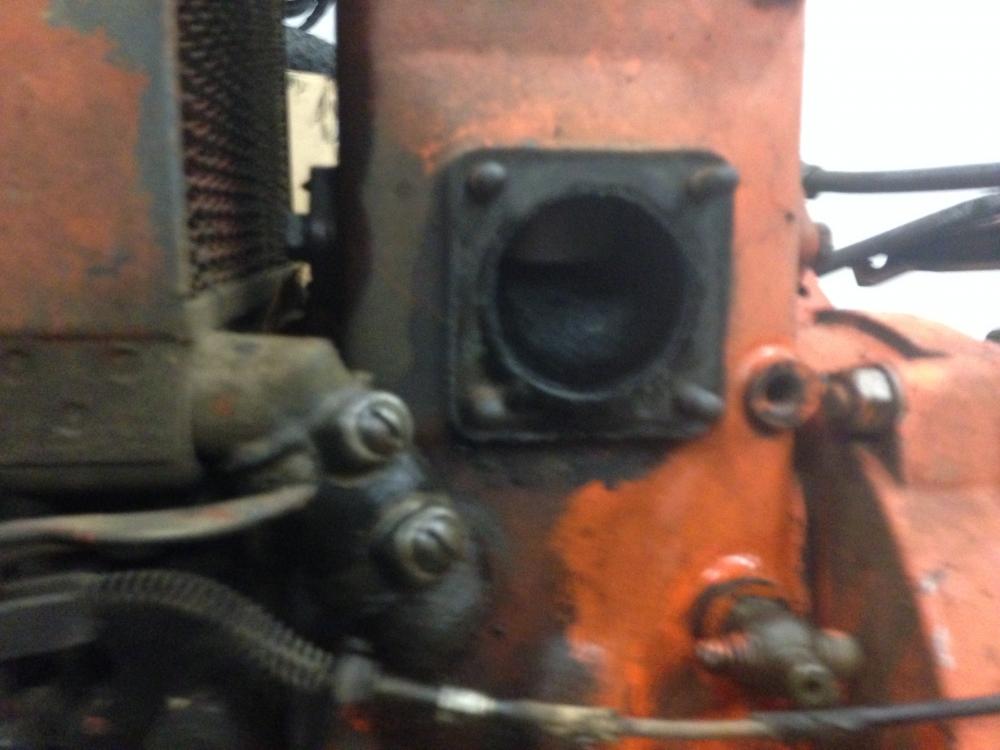

    That’s what I thought. The previous owner was a land scape gardener. This was the first machine that he had a go with when he was about 10. Unfortunately health and safety meant he no longer felt he could give it to his employees to use, but didn’t want to see it scrapped. I said I could give it a good home. So here it is. I’d been after another Sachs diesel gem since I sold mine when keri told me she was expecting, but every example that had turned up was too expensive. Looking through the ports the bore and piston is still like new. I would say that it has been very well looked after over the years.

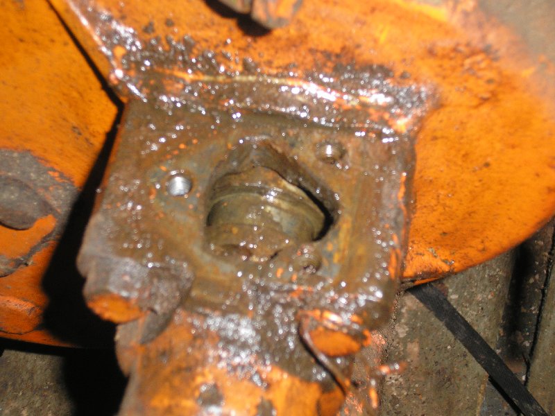

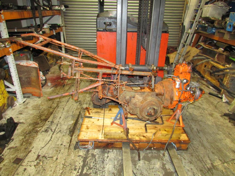

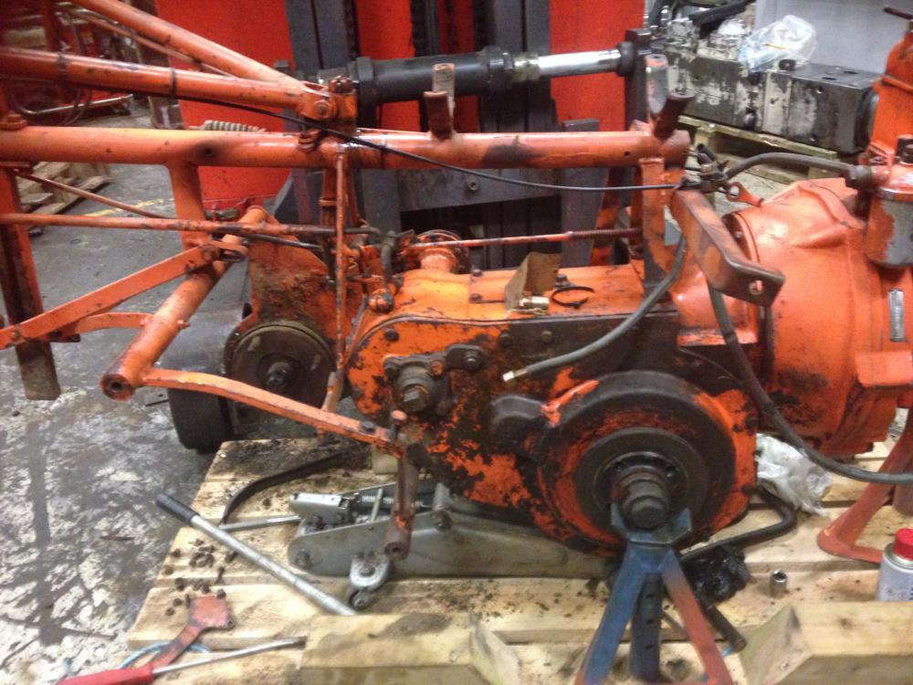

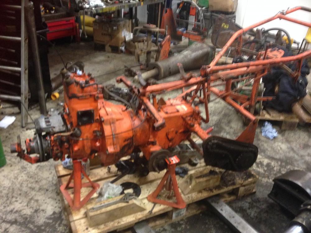

    #24236
    The strip down continues. Nothing major to report. The only things wrong ive found is the chain case was devoid of oil, instead full of soil. The gear selector bush is worn, one wheel hub is loose and the rotor shaft dog is seized.

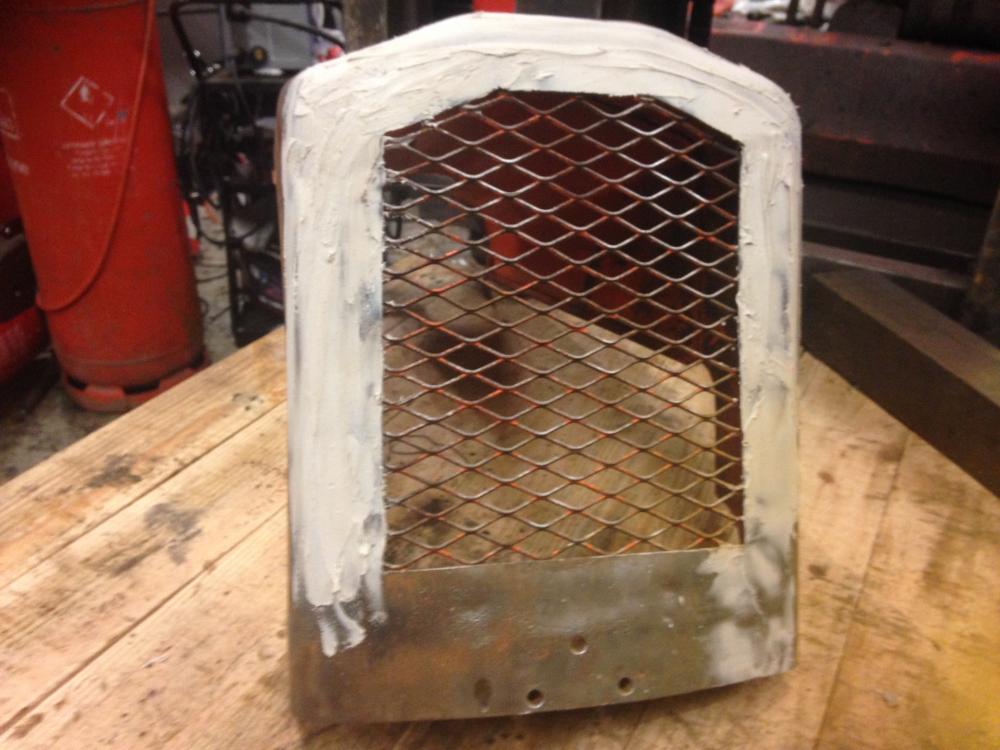

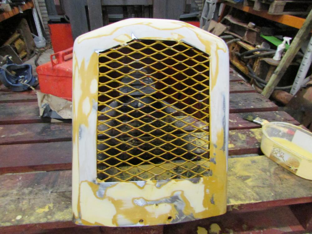

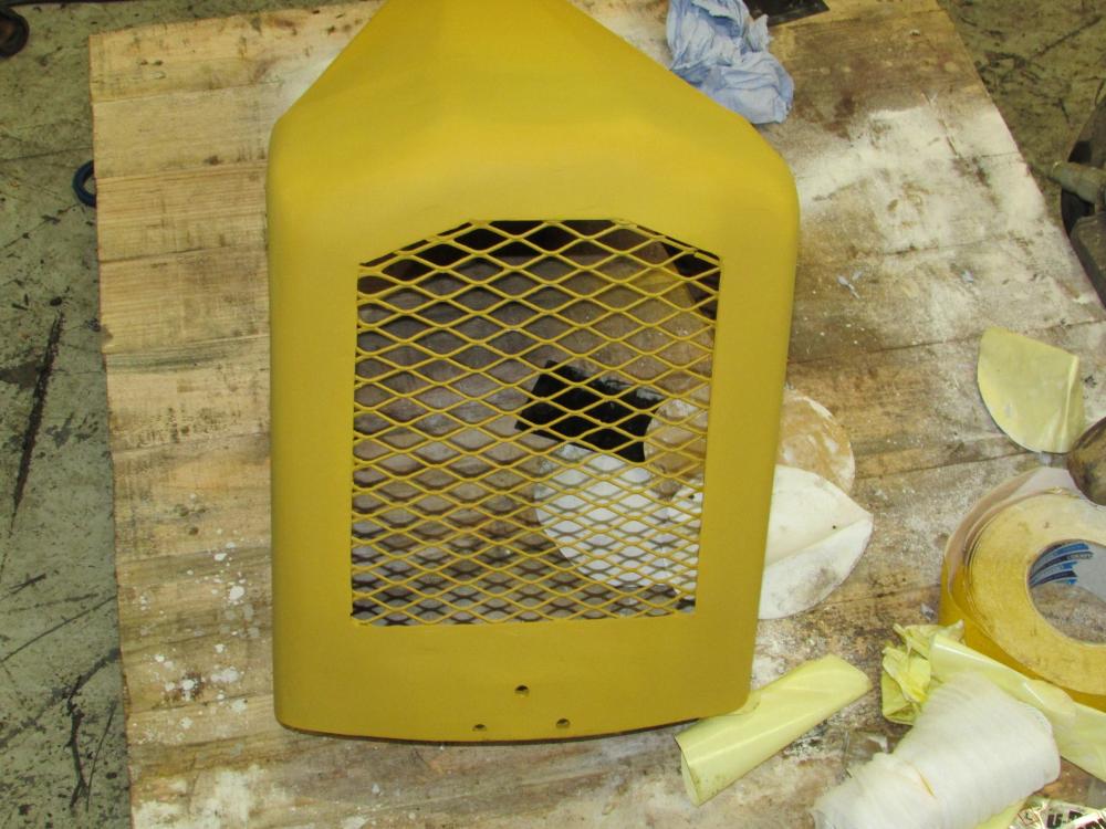

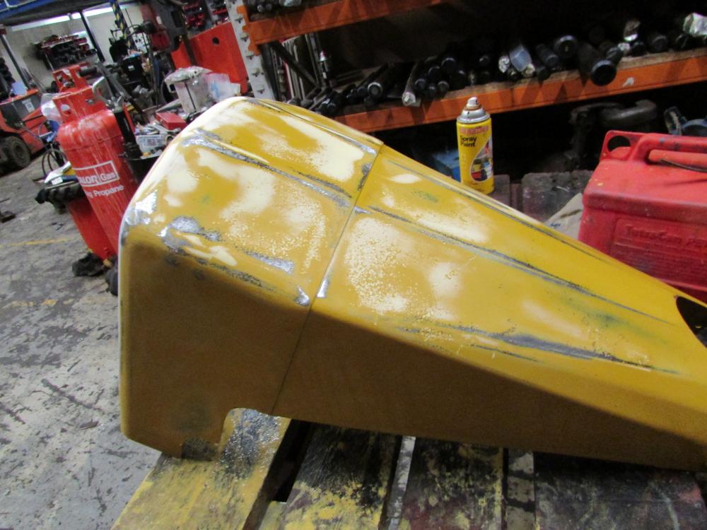

    #24370

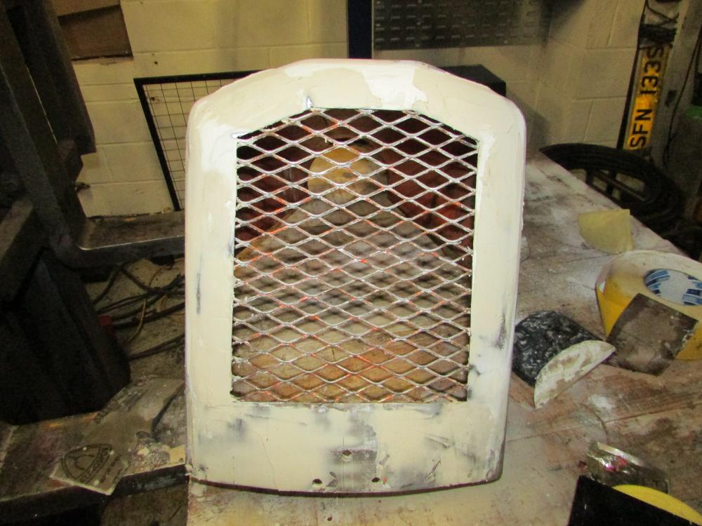

    Progress has been slowly getting on. The bonnet has had the crack welded up and ive reshaped the front as well as I could, now the longwinded task of filling it.
    The injector has come back from being refurbished, not bad at £65 with the carriage.
    All the paint has been stripped off the gearbox and handles, just got to wait for it to warm up outside so I can wire brush it.
    Also ive now had the factory records back on this one, it was apparently built on 10/03/1962 and dispatched to W.Wood Ltd in Horsham on 16/03/1962. The records also confirm that the engine is the original one.
