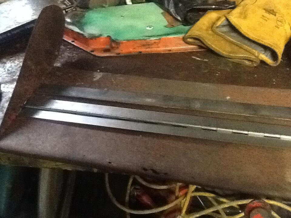

vhgmcbuddyMemberHave just been rummaging through the unit next doors scrap bin(with permission) and have found a few off cuts of steel plte that will be ideal for the rear flap, hopefully I can replicate the original.
