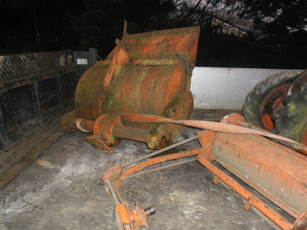

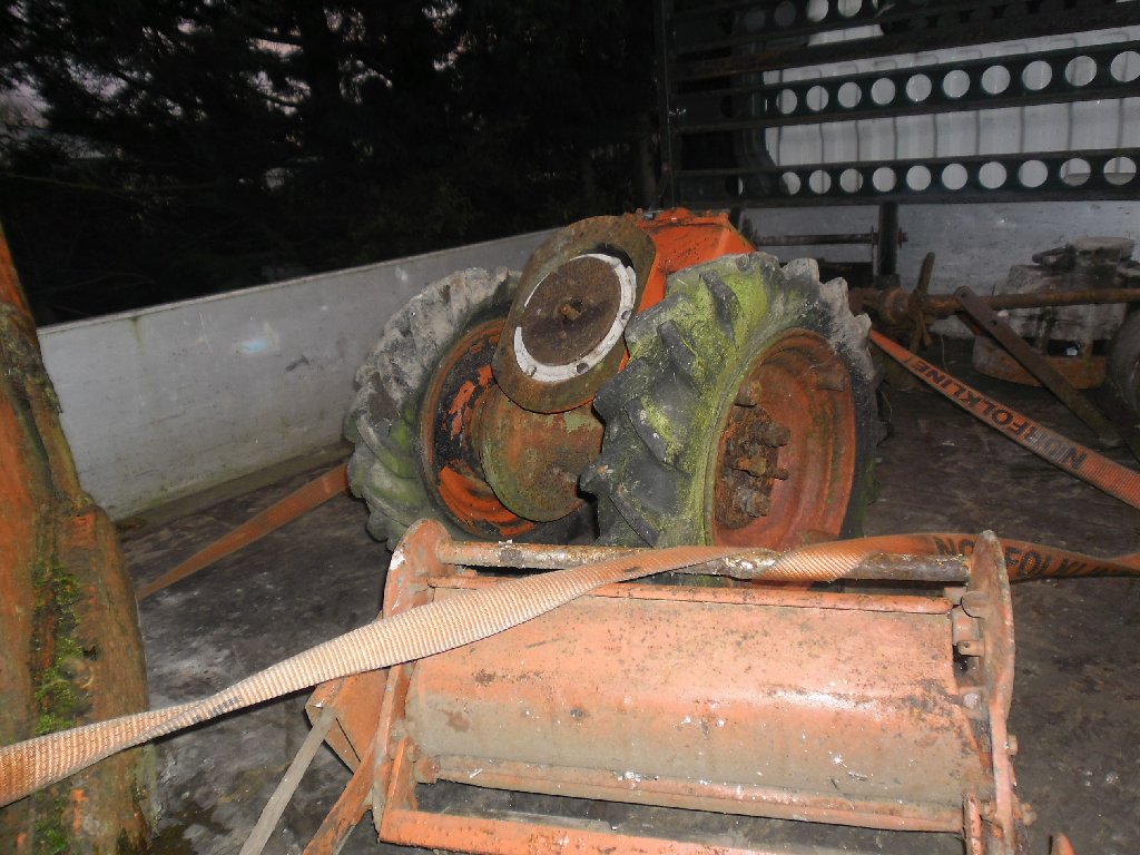

    As purchased

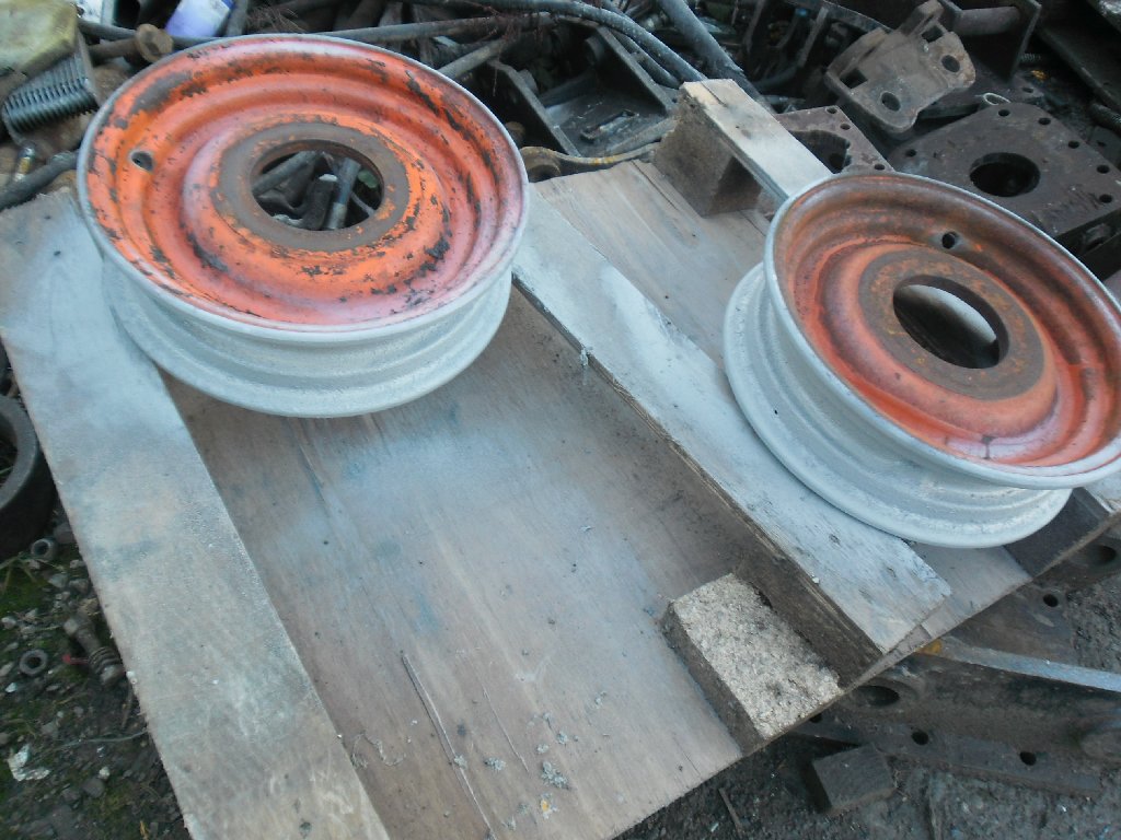

    #2746

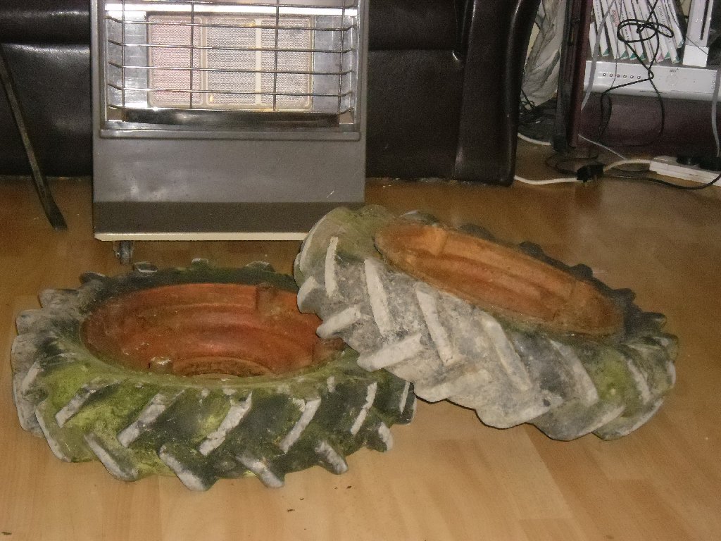

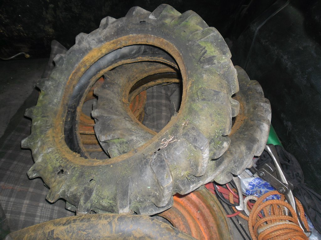

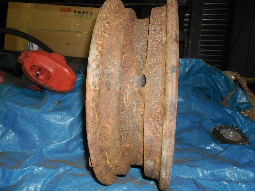

    As i had a spare set of tyres in my store i started by warming up them up and then removing the very perished rubber.
    #2750

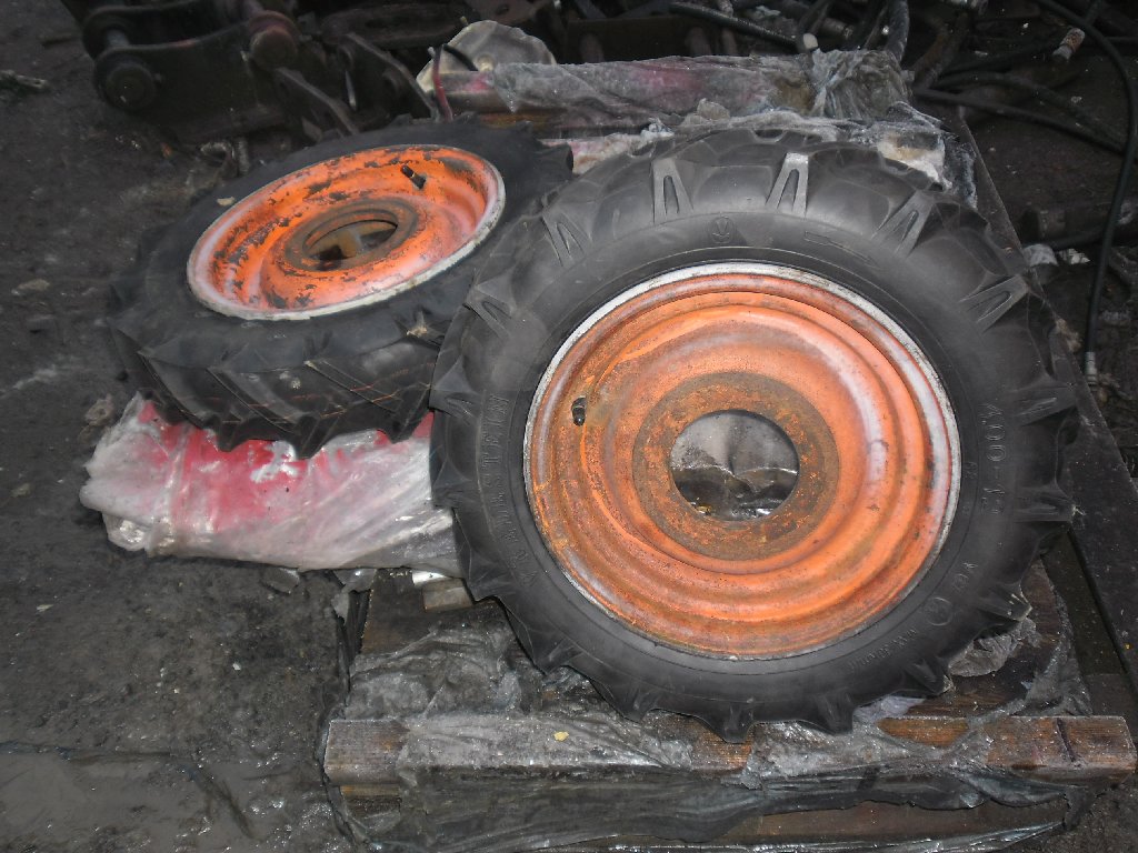

    The insides of the rims were very rusty so these were cleaned up and primed before new vedestrain tyres and tubes were fitted.

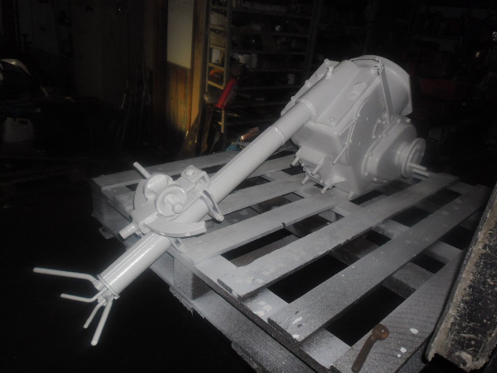

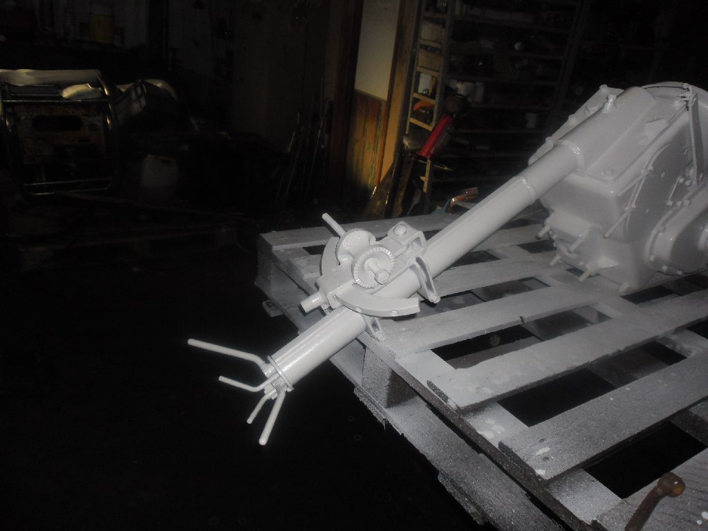

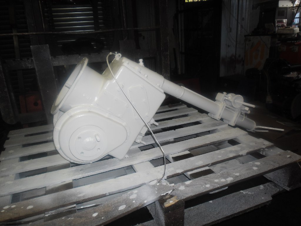

    #2755

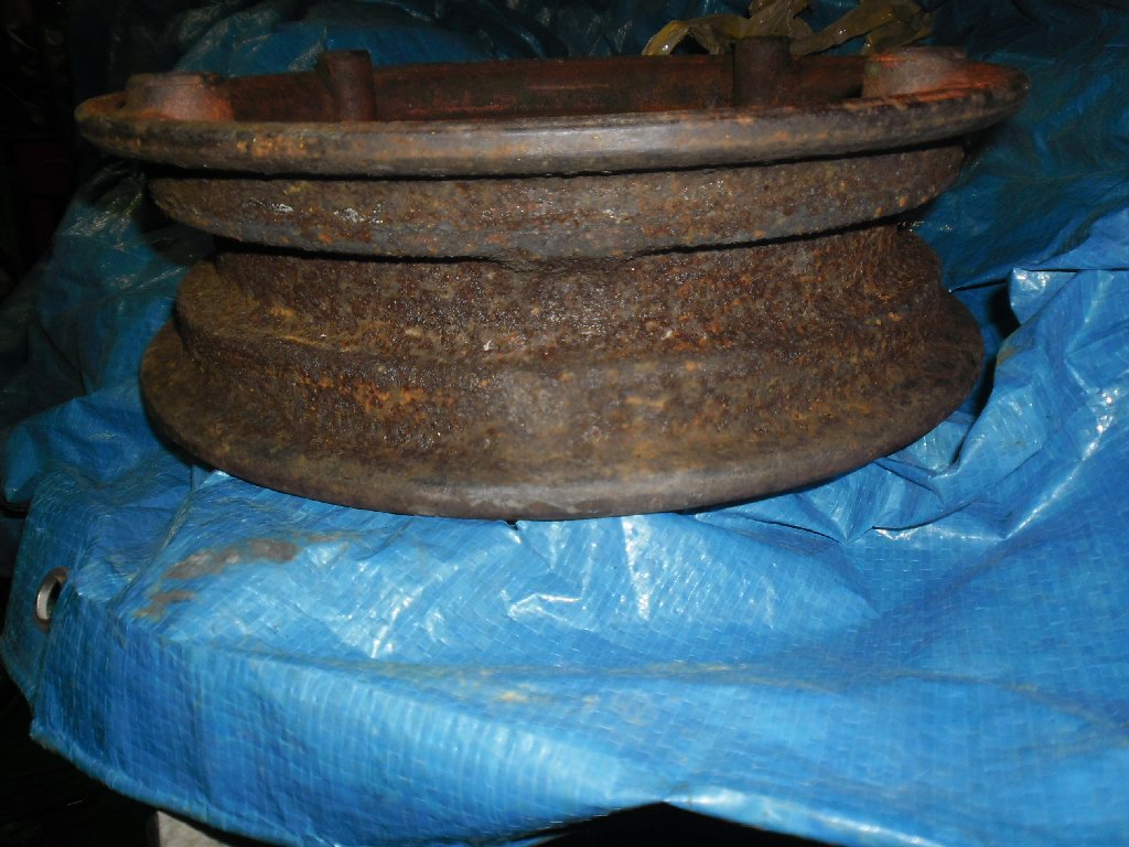

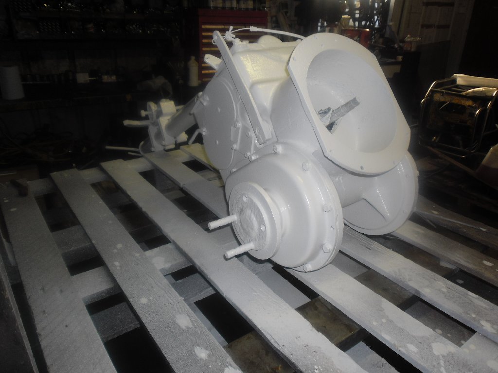

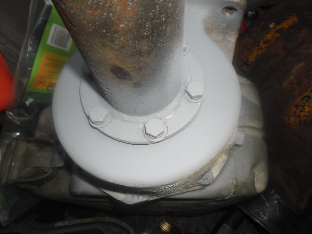

    All gears have been checked and fourtunatley work well, so the gearbox assembly was taken to bare metal this morning and several coats of high build primmer applied.

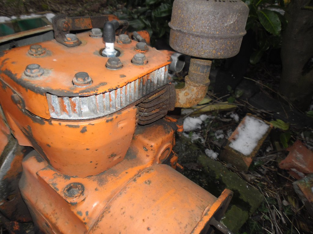

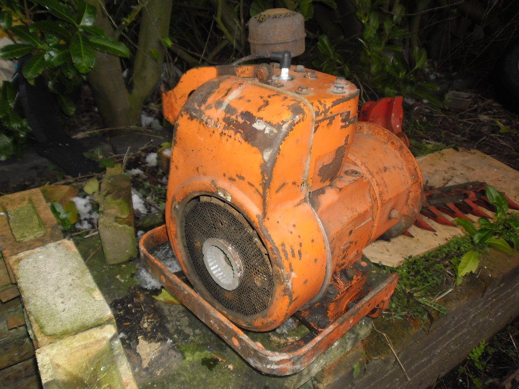

    The most major component to sort out is the engine. After a lot of consideration I have decided to rebuild this machine as a Kohler example so the hunt for a doner was on. Once very plentiful now it appears that they are very hard to come by. At a local plant sale i purchased a Complete gem, however on dismantling the engine it was found to be shot!
    #2765
    The engine side is on hold until I can turn up a good bottom end, hopefully one is comming my way in the new year.

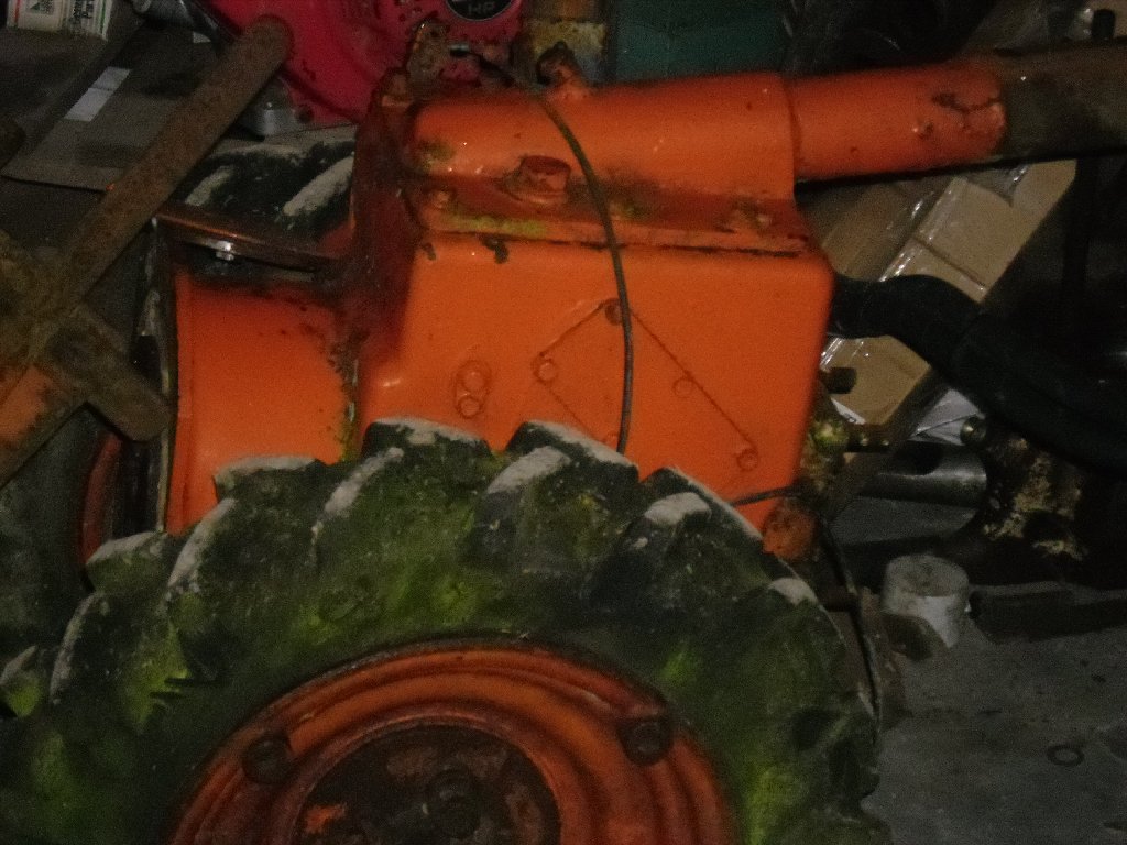

    #2766

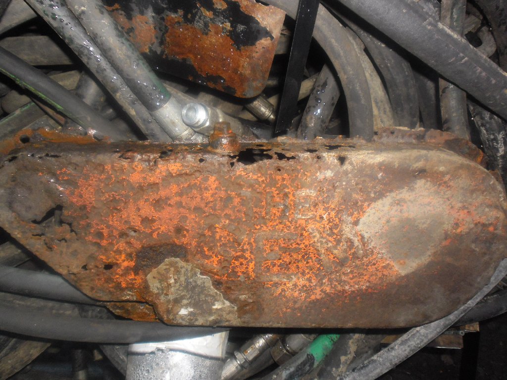

    Is this the worse chain case ever? Originally the 800 had a plain example fitted so this one must of been retrofitted at some point.
    #2769

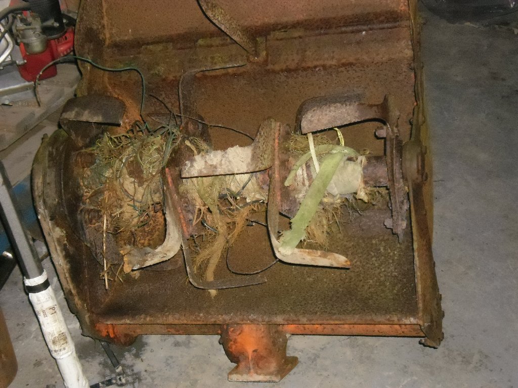

    One place of rot in the rear rotor covers.

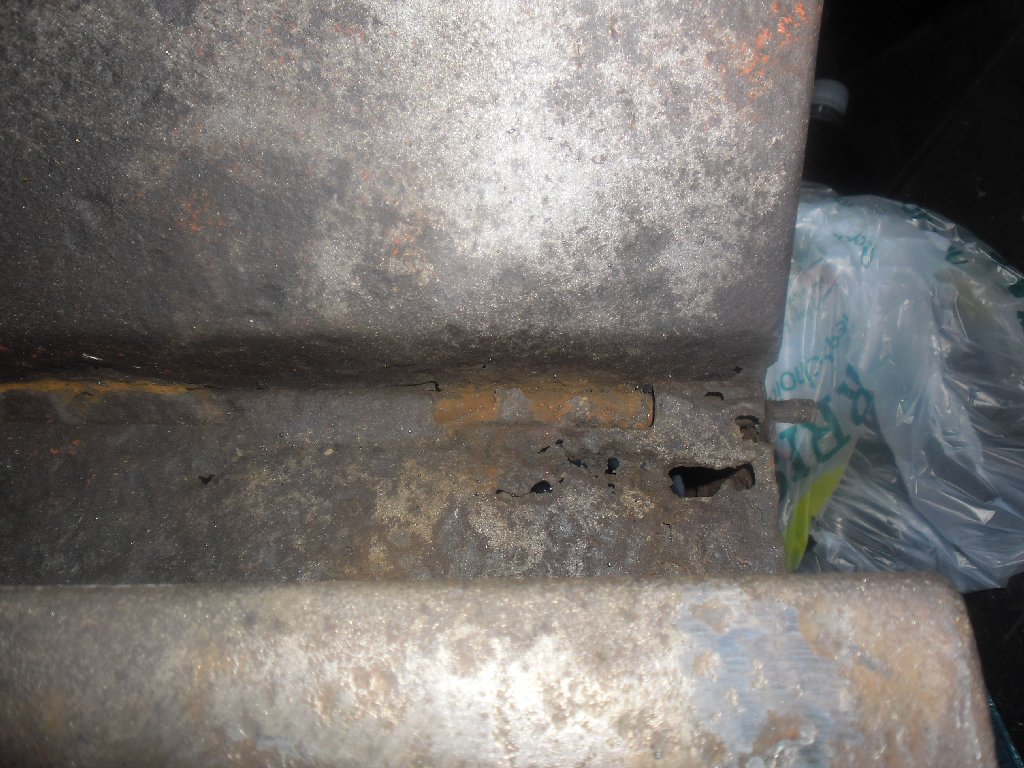

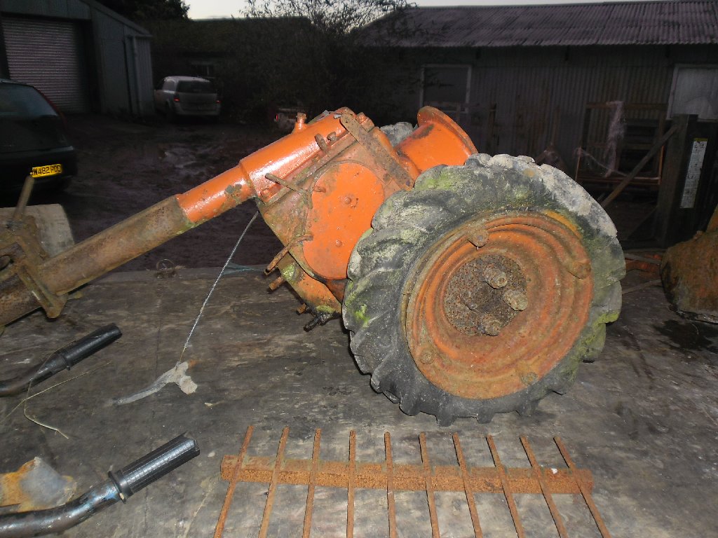

    The rear diff unit had been badly welded up so after cutting off the bolts and weld etc the damage was ground out and filled, along with most the threads being helicoiled.

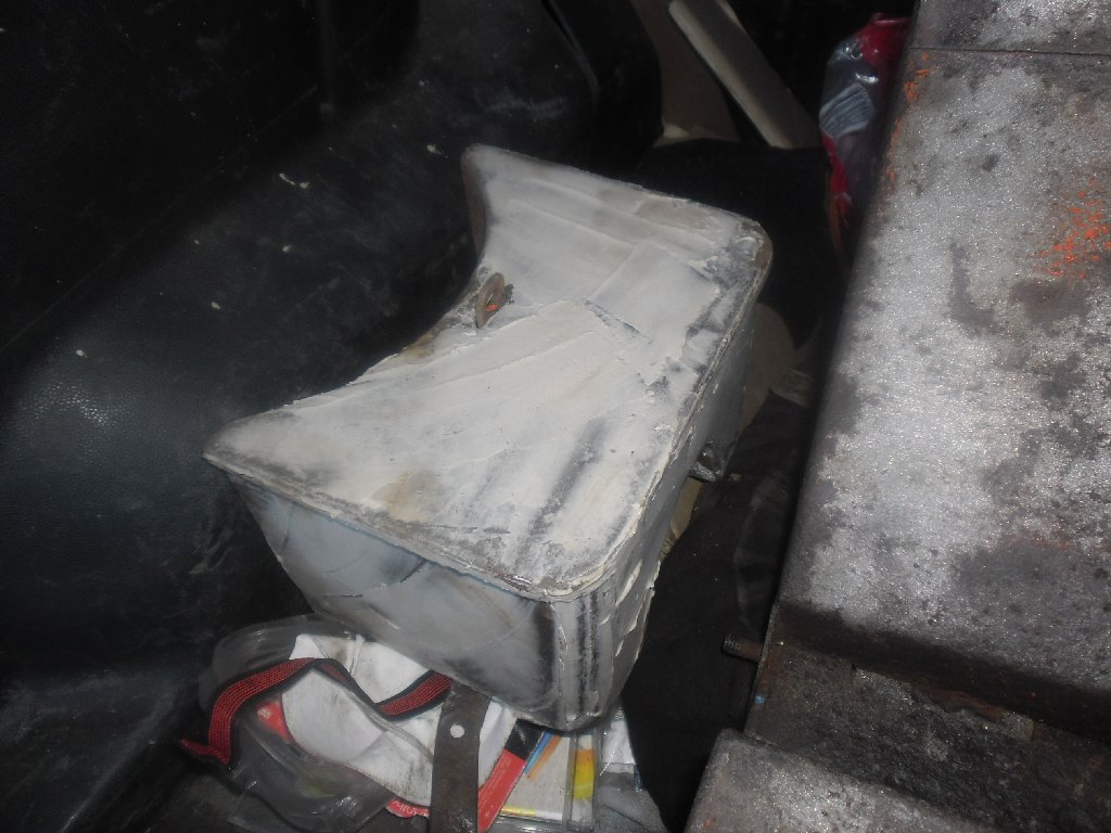

    Tool box all welded up and skim of filler applied.

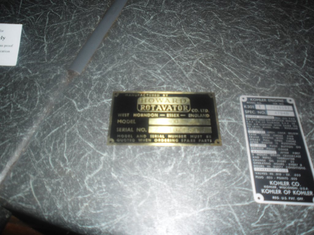

    #2778

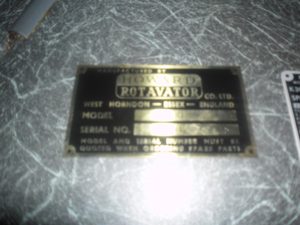

    After seeing examples of his work at Tractor World I bit the bullit and ordered up new i.d plates from http://www.vintagebrassplates.co.uk not cheap at £45 each but I felt it was money well spent.
