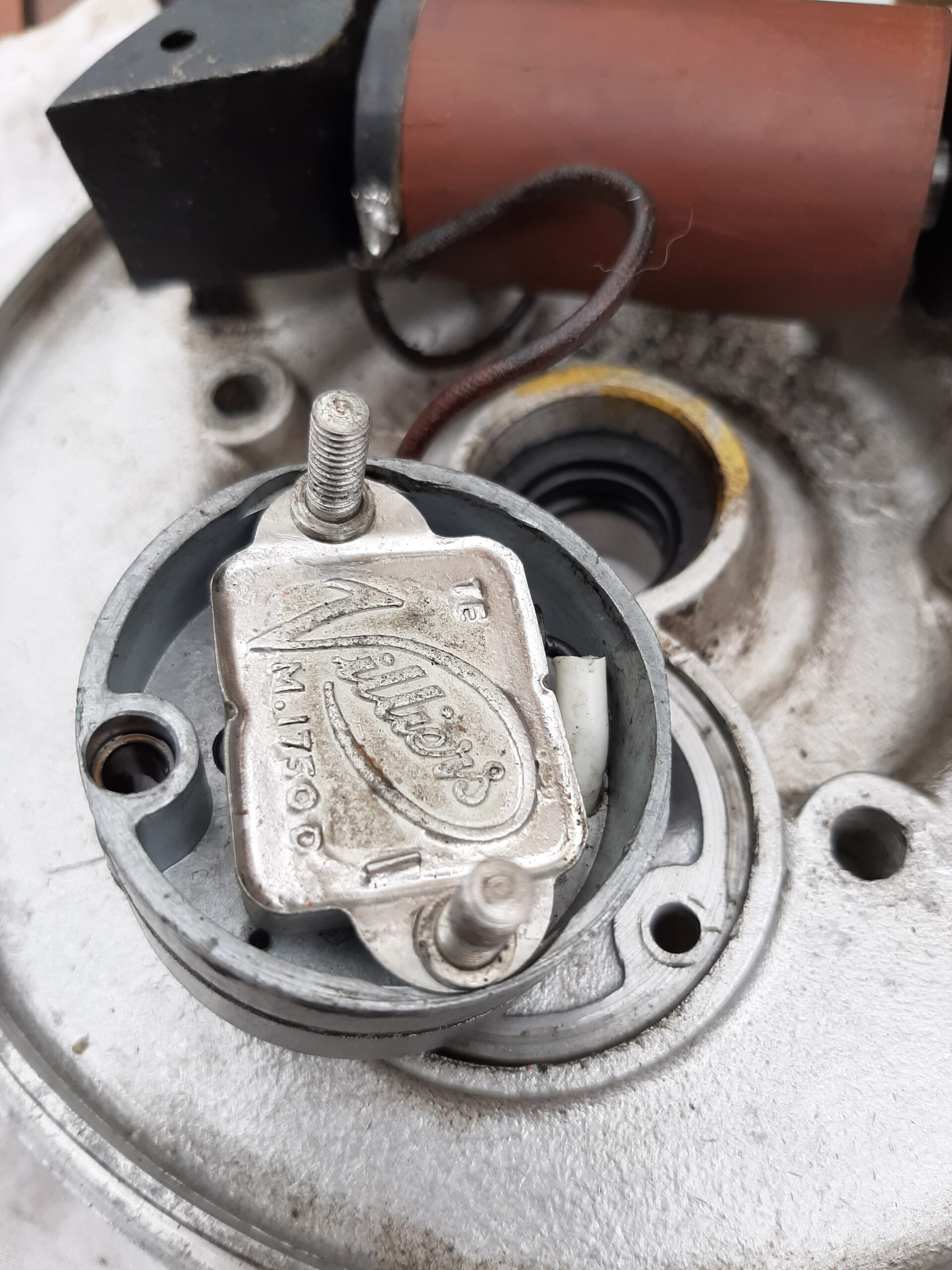

    #34933
    Hi Andy,
    I have got round to doing some more checks on the Villiers 15HS engine.
    I removed the cylinder Head – Valves ok – normal build up of carbon on the valves.
    Top of the piston had a sticky tarry looking layer it – it wiped off with some white spirits.
    The bore looked ok although as you manually turned the engine over there seemed to be a trace of oil being wiped above the piston so possibly the rings need replacing? It did smoke a bit but could be unburned fuel and carbon mix due to the timing issue?

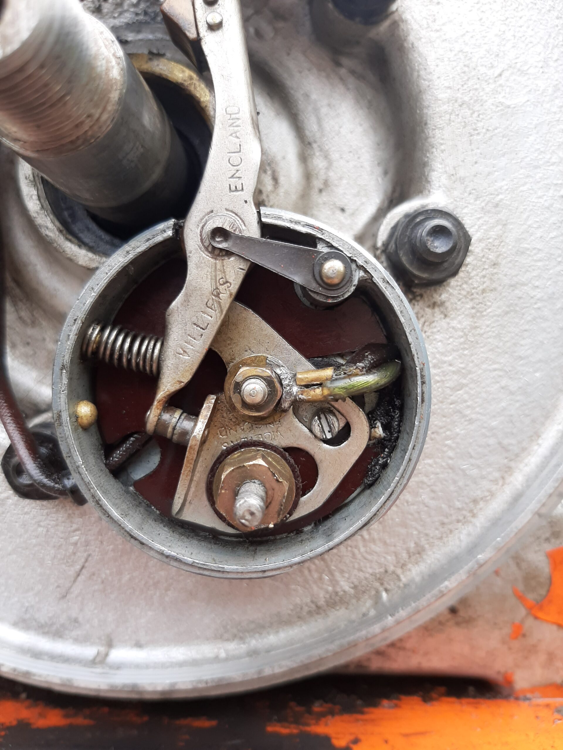

    Got the points visible and rotated the flywheel.
    Points where just opening with the piston about 7/16″ BTDC so timing does seem to be out.
    I have removed the flywheel rotor.
    Couple of questions:
    The sprung tin lube pad was missing – broken off – should I replace?
    The points had a typical small peak and crater but not excessive and can stone off to make more flush.
    The crank oil seal E.9718 on the parts list in the armature plate has been leaking.(picture added already cleaned oil off back plate) Is this easy to replace as the bearing needs pulling out first?
    While I have the rotor off and armature plate off:
    Can you advise where to get the following:
    New Condensor
    Sprung tin lube pad replacement
    Shall I change the points?
    New oil seals both mag and drive side?
    Spark plug recommended – what equivalent to the Parts list – Lodge C.14?
    Thanks again for your comments and advice.
    Steve
    #34937
    Sorry the points opened at 7/32 BTDC not 7/16 BTDC…that would be a long way out!
