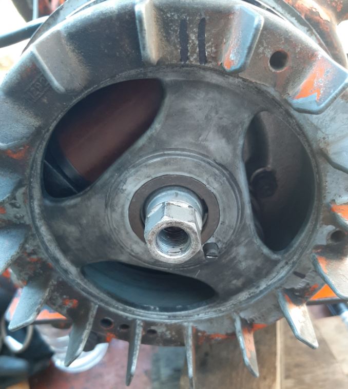

    Howard Bantam did not run so I stripped the carb which I believe is an S12 type. The throttle cylinder was stuck so i freed this and cleaned the inside and blew out all the jets.
    The villiers Mark 15 engine starts ok now but the throttle does not seem to increase the speed of the engine? The governor seems to be coming in and out (hunting) a bit too much as it just ticks over.
    Is the air intake not correct or fuel intake is not right? Adjusting the mixture screw or the cable adjuster for position didn’t seem to change the engine speed either? Any ideas.
    I thought I would check the contact breakers for enough spark and maybe replace the condensor which I know from past engines can cause problems.
    I have undone the 13/16 nut holding the flywheel rotor on but it clamps tight again, do I use this nut to pull off the flywheel rotor? I didn’t want to strip the thread so have been reluctant to lean on it and give it too much force. Should it be that tight and will go eventually?
    Any advice is greatly appreciated.

    The nut in centre of flywheel should go loose then start to tighten again as it pulls the flywheel off the taper. Beware removing the flywheel will require resetting the timing on assembly as there is no key on crankshaft. Timing is easiest to do with cylinder head removed to accurately measure position of piston.

    Thanks Wristpin, regarding the valve gaps and spark plug I have checked and adjusted these already. The points didn’t seem to be visible through the flywheel in that there seemed to be a cover over them… I don’t recall seeing the actual points through the 3 gaps when rotating the flywheel.
    If there is a cap or plate over the points…which is removable through the flywheels 3 gaps (see pic above from my first post) to get access and check and adjust the points without removing the flywheel.

    There is usually a cover over the points which can be removed by sliding the retaining clip across and to side of cover, it is a bit of a fiddle.
