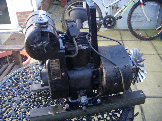

vhgmcbuddyMemberI have a briggs engine fitted to a genny and wandered if someone can tell me anything about it.
the model No 207027 and serial No 70109. i think its pre 50s but any info would helpNovember 7, 2013 at 11:15 pm #2682
wristpinParticipantNot sure about that serial number. Briggs Id is normally by model, type and code. Those words are usually stamped into the blower housing (cowling) and below each word there is a series of numbers. Your model number 207027 is good for a 20 cu inch engine with a horizontal crank,diaphragm carb and pneumatic governor,sleeve bearing,flange mounting and splash lube and 12v electric starter. The type number (missing)gives further mechanical and trim/spec details. Finally the code dates the engine to the day of production and shift or production line but your number may have a missing digit or may not be a code number at all! For argument let’s say it is 701009**. That would be 1970 , October the 9th with no line details.

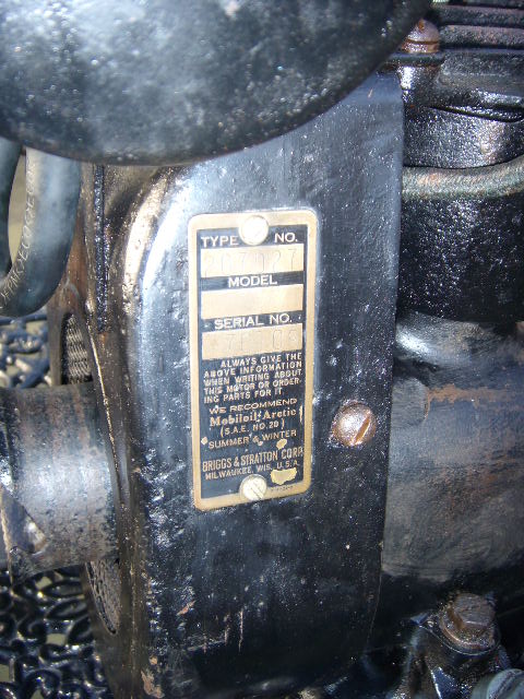

vhgmcbuddyMemberthanks guys for your responce.
next time iam up the shed i’ll take some photos of it.
it has a small brass plate riveted and i’am sure it only had the 2 numbers ,but will have another look, thanks againNovember 8, 2013 at 11:17 pm #2700
wristpinParticipantNormally stamped into the blower housing (BS for engine cowling) either horizontally adjacent to the spark plug or vertically on the back partly obscured by the carb. Not usually on riveted plate until much later intro of the Vanguard series of engine and they were a silver on black ally affair.
November 9, 2013 at 3:57 pm #2703
vhgmcbuddyMemberWhat the showman describe would be the correct type tag for a Brigg made before the war. Possibly its off some military item. All my Briggs from the 30’s and 40’s used a brass tag held on by a rivet top and bottom. Its usually found on the front face of the blower housing. These tags either say the engine size ie A B Z K ZZ or have some number on them that was used by the original maker. The other number is usually the serial number of that engine. Without a picture it could be narrowed down by its head, which in the older models had enclosed cooling fins, and the later ones open cooling fins.

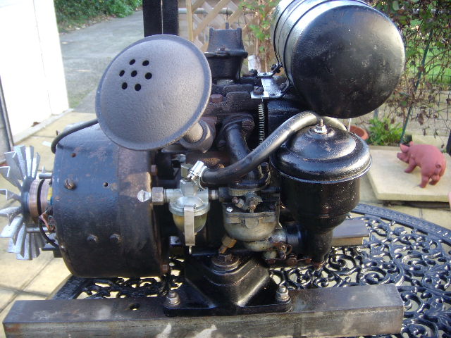

November 16, 2013 at 7:37 pm #3097
vhgmcbuddyMemberNovember 16, 2013 at 8:09 pm #3102
wristpinParticipantThat definitely solves the the issue as everything matches the info’ from the States. Also, easy to see the Suffolk connection – the sump in particular. I wonder what the deal was; did Suffolk buy the rights when BS moved on to a later design or were they paying royalties on a per engine basis. Pity that they didn’t update with a later Briggs rather than that horrible Tecumseh inspired 98cc alloy blocked lump.
