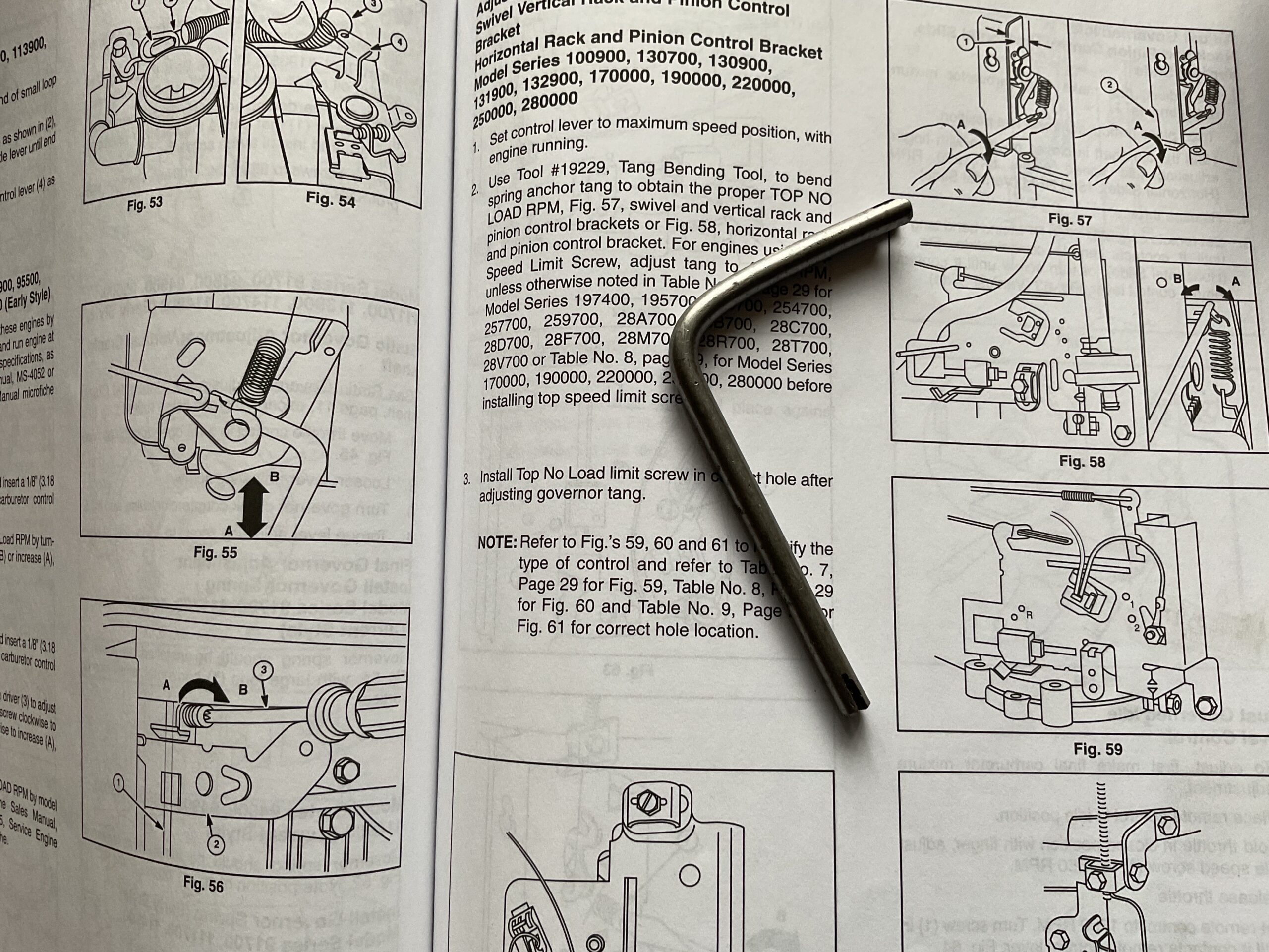

The 260902 is shown as still available with a retail price of £8.16 inc vat.Section 5 of the manual, page 25 of the section shows using a simple home made tool to “ tweak” the spring anchor. A piece of 8mm rod with a slot cut into one end and an L bend to aid controlled tweaking.8
