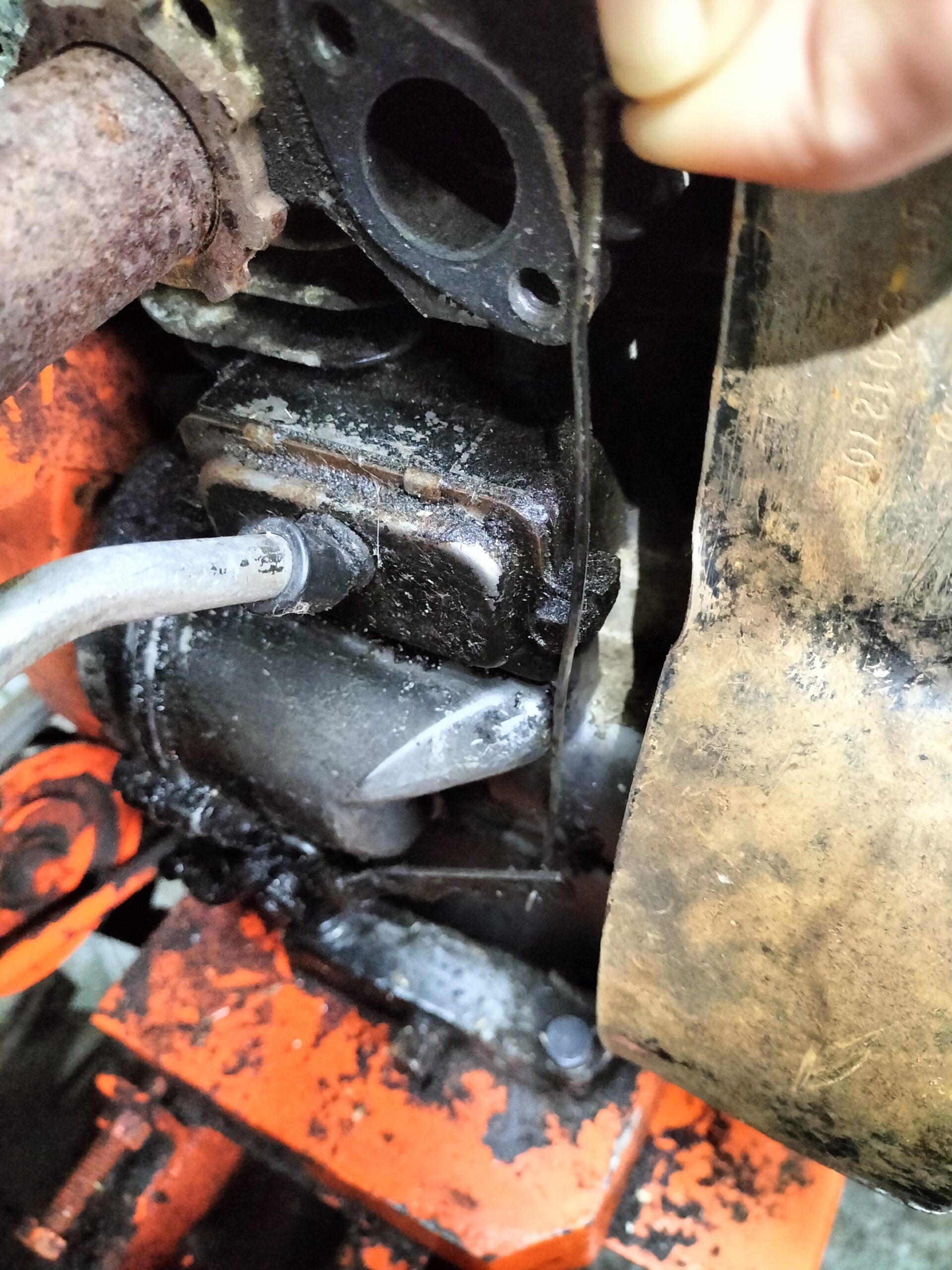

July 31, 2023 at 11:49 am #41020richardd
Participanthi andy
below are the photos, one shows the fuel tank with the throttle cable connected to a bracket which moves as the throttle is opened with a return spring to help it go back to idle.
the second one is difficult to understand if you are not familiar with this piece of kit, it is not a good photo as it is so hard to show but what it shows is that the governor arm has a thin rod attached to it which the way i have it set up, is the only connection between the carburettor and the rest of the machine. as i said it runs great, the governor works , it just i have nio method to open the throttle with the control lever.
please get back to me if you need any more infocheers richard

July 31, 2023 at 6:36 pm #41024andyfrost
ParticipantI can only see one photo , we really need a good close up of your carb.

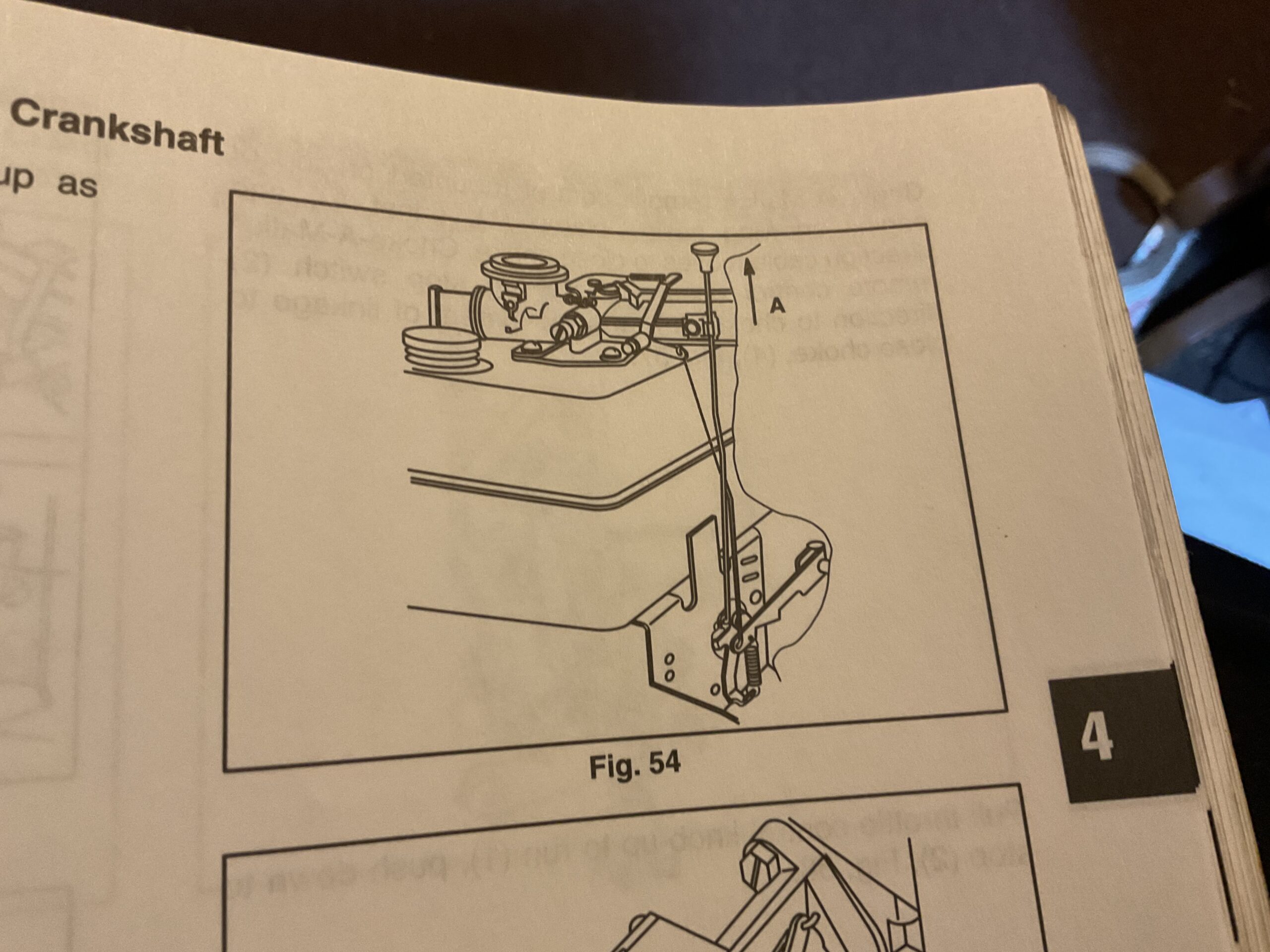

The main issue is that there were several variations in the set up for the 13 series 5 Hp throttle / governor linkage. The main difference being between those with the throttle cable clamped to the carb on top of the tank and that clamped to the tank support bracket, low down by the engine base .

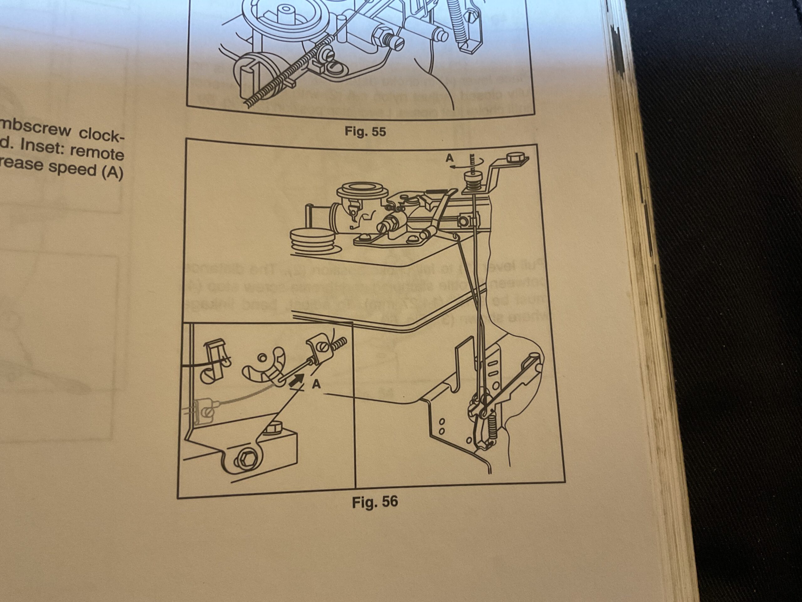

Worth investing in the BS manual 270962. Single cylinder L head manual – post 1981July 31, 2023 at 11:08 pm #41029
wristpinParticipantI should add that in fig 56 of my last post, there is a rod with a letter A and a rotation symbol . That is for a “ universal” engine with no remote throttle. If yours has a cable throttle control, that rod will not be present.
August 1, 2023 at 9:55 am #41030richardd
Participanthi i have already got the briggs manual and it is no help what so ever as to the relationship between the govenor and the trottle cable but you 56 pic looks like it could be the answer, it shows the spring connecting the throttle cable and the governor arm. will have another go and set it up as it shows on 56 and let you know

wristpinParticipantYour code number shows that it was made in 82 so the post 81 manual applies .
The second rod is included in the standard build engine assuming no remote throttle. If you have a cable throttle it is likely to be as per the insert illustration as in 56. – always assuming that your machine has not been re-engined. If I come across one still in place I discard it, as it serves no purpose and is just another thing to line up. The 56 illustration is about as good as it gets and is actually a fairly good representation of the set up in the metal.
When reassembling from a tank off situation , I find it best to offer up the tank without screwing it into place and then hooking up the gov spring – just gives one that little extra bit of space . With the spring hooked up insert the two manifold screws but not tight, then the single screw at the bottom of the tank bracket while there’s still a bit of wriggle room to align all three.
While you have the tank of it may be useful to put a straight edge across the manifold flange in case it’s a bit bowed due to over tightening . If so run a file over it. I always put a smear of heavy grease on both sides of the gasket and a drop of blue Loctite on the manifold screws – keeps them snug without the need/risk of over tightening. The latest version of those screws have recessed Torx heads which are far more accessible and easier for controlled tightening.
