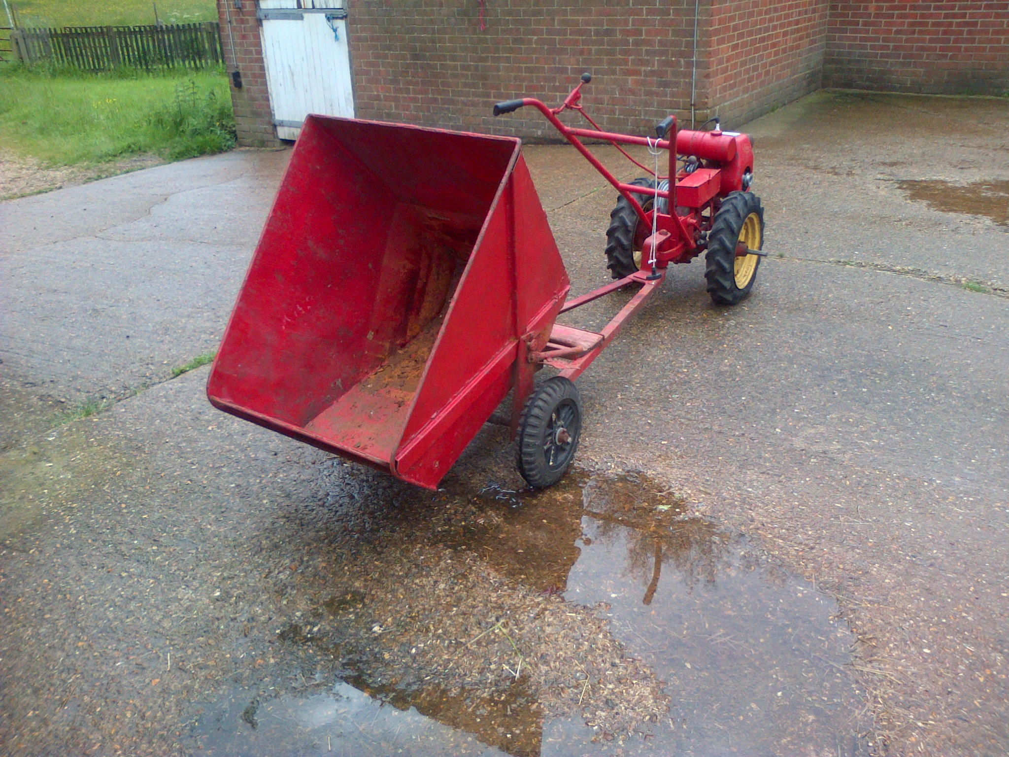

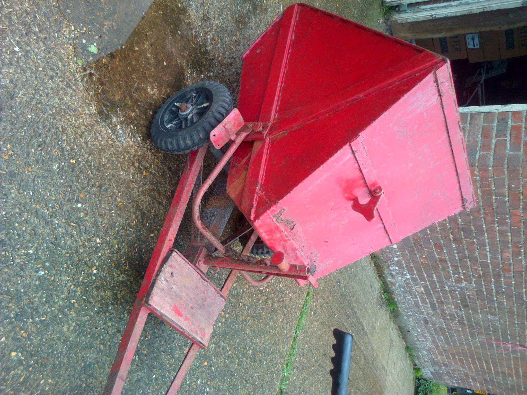

vhgmcbuddyMemberHere are some photos of my Barford Atom and Trailer
I have a plough and other bits that go with it
I bought it with the intention of restoring it but haven’t got going with it.
I haven’t had the engine running but now I have got it out and hitched up the trailer for the first time it has inspired me to get on with it.
There is no throttle cable on the machine and it never looks as if there’s never been one is that correct?May 29, 2014 at 2:16 pm #8389
vhgmcbuddyMemberNice – mine had no cable either but it should do. What’s your plan are you going to work on it or are you in the market for an offer for it all?
CMay 30, 2014 at 7:45 am #8440
charlieKeymasterNice to see another dump trailer has survived, the wheels look like replacements. There should be a throttle cable, without it engine will run on govenor and only have one speed.

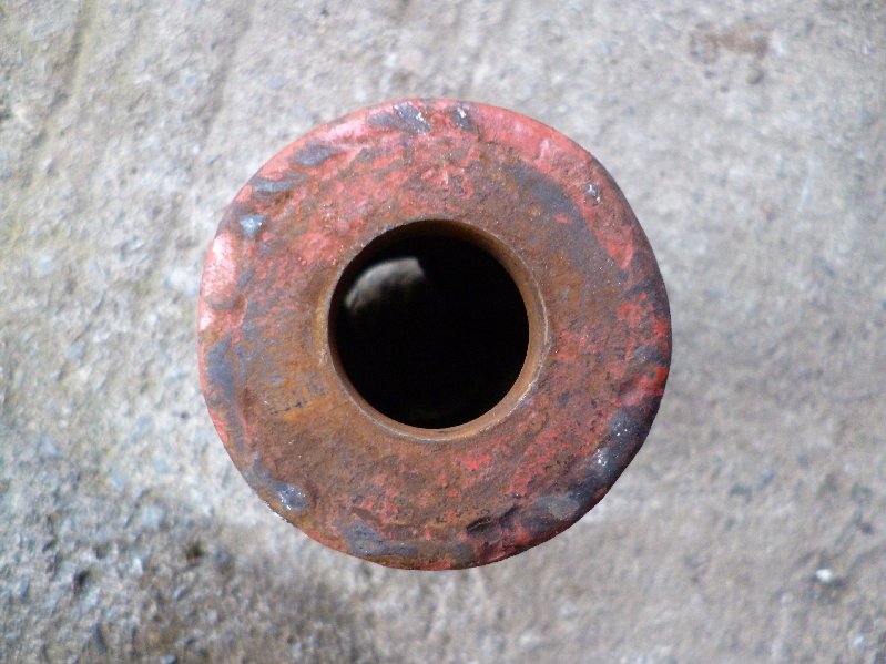

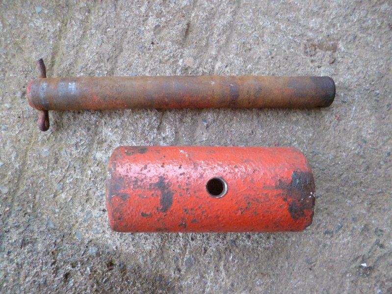

charlieKeymasterThe hitch consists of a tube that fits in the rear tool bracket on the Barford. This tube is closed at each end but has a hole in each end, one end is a slot to allow for movement. A pin drops down through jaw of trailer and this tube. I will need to dig actual hitch out of shed to get dimensions and photos.
February 26, 2015 at 5:19 pm #11846
charlieKeymasterPhotos of hitch as promised.Dimensions are 5″ overall length, 2 3/8″ overall diameter; hole in end is 1 1/32″ slot in other end is a bit wider and side pieces that make slot are welded on approx 3 mm proud of end and are about 10mm thick. There is a 3/8″ hole half way along one side of the main tube; this for bolt on back of Barford to screw into and lock it in the tool holder. The pin is 25mm diameter and 234mm long with 5 mm holes approx 9mm from each end.
