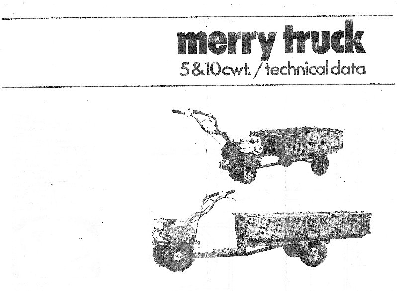

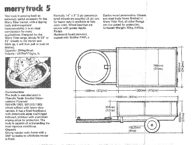

wristpinParticipantIn the absence of the real thing, if you can pick up a Saxon or SCH trailer for the right money you’ll be more than half way there and unless you already have steel and wheels etc probably won’t cost any more.

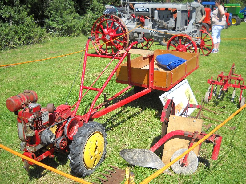

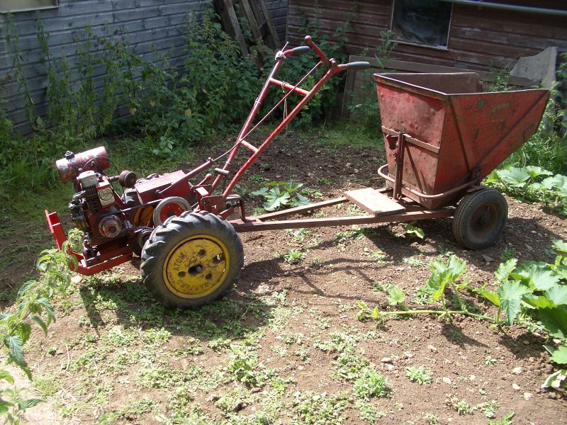

vhgmcbuddyMemberOh wow! I’m in love! That tipper trailer is exactly what I need. I move a lot of stone walling and that would be ideal. Any ideas where a chap could lay his hands on one?

charlieKeymasterBarford trailers, flat bed or tipping are a bit like hens teeth and rocking horse S~*t. A well known online auction site much used by our members is where I got mine from. The dump trailers are prone to rusting out at the bottom as they fill with water if left outside.
