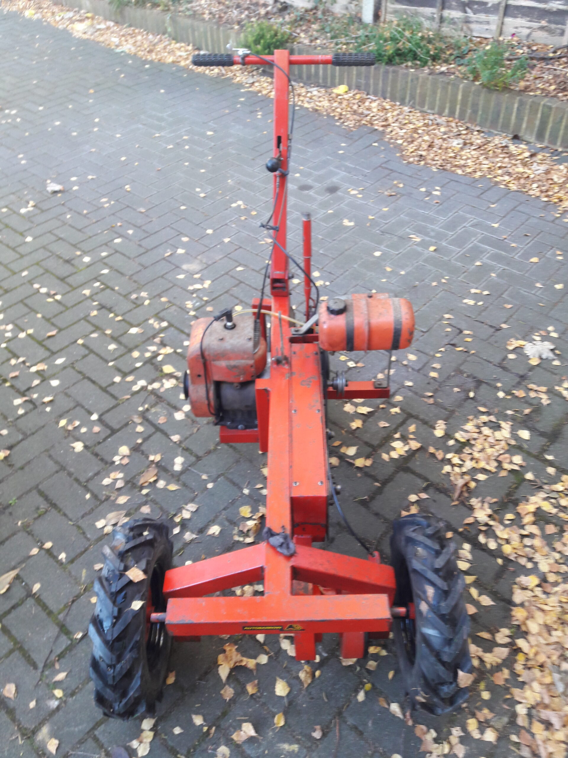

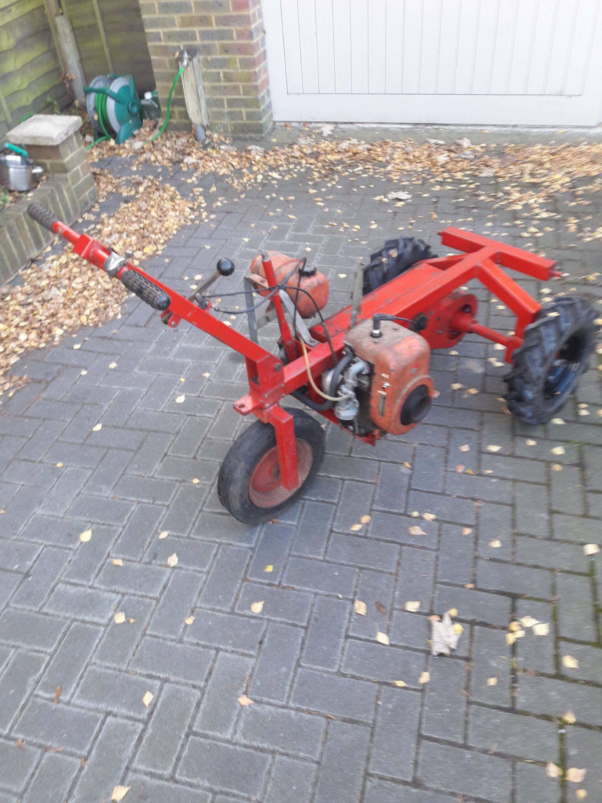

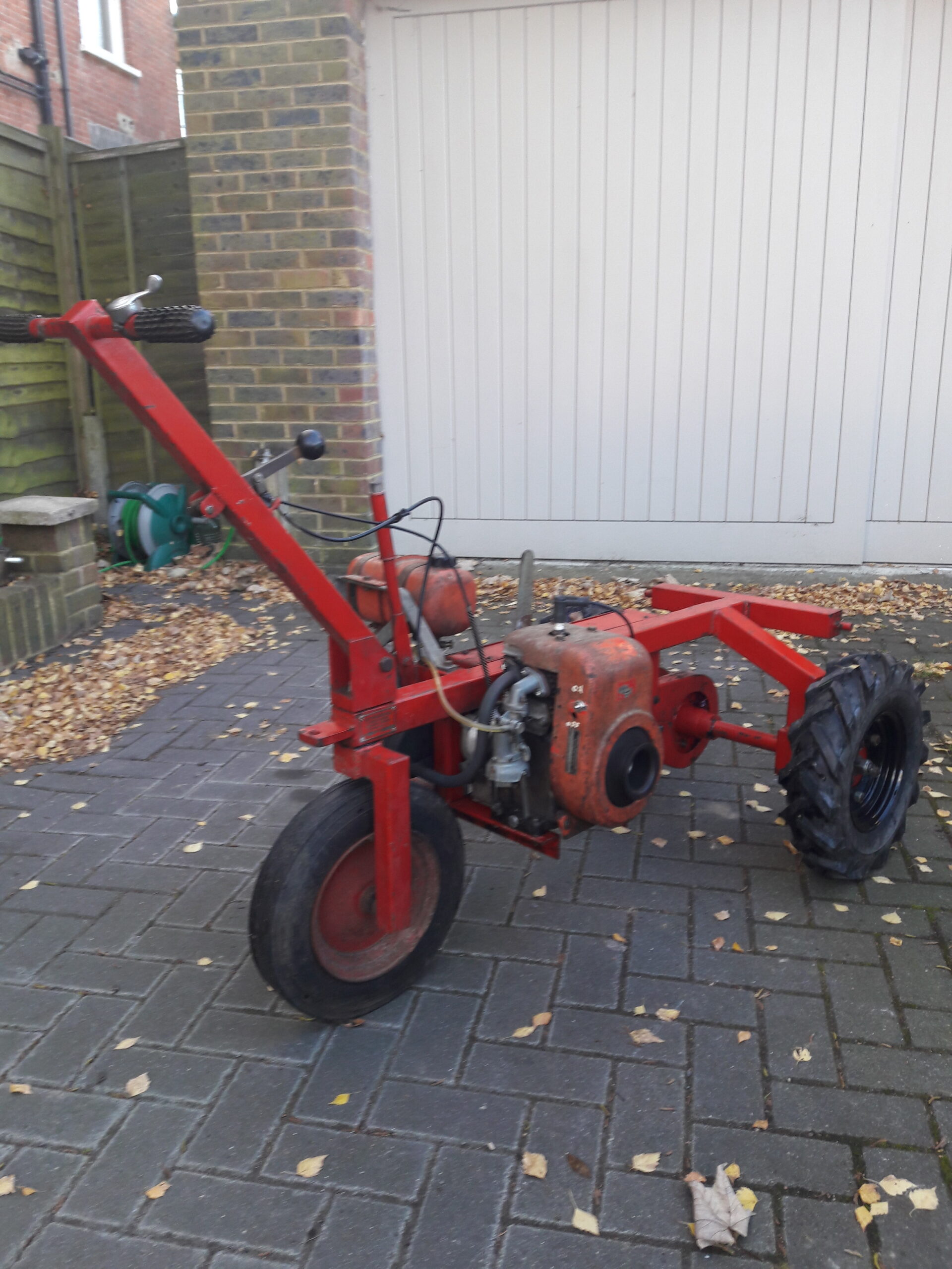

vhgmcbuddyMemberHi all, glad to have found this place, I have been tinkering with garden machinery since my neighbour through out his Briggs and Stratton Mountfield mower when I was 13 and I fixed it (so that’s, ummmm, err…. 28 years ago!) its still working fine!
Anyway, I recently bough this Autobarrow from the ‘Bay (maybe someone else saw it?). I have since stripped and greased the drive train, checked over the engine and painted a few bits and bobs, and have discovered the following: –
1, the quality of construction is incredible, the tolerances were so good that when I took many parts off it was like new underneath
2, the Villars engine is again incredible quality – however you can see why Briggs (for example survived) and Villars did not, the Villiers must have twice the parts quantity for a similar output – and I dont think many owners cared that Villiers had many well machined parts for a guvnor and Briggs had a piece of plastic! – it was lovely to work on thoughSo, anyway (again). I need to make a box of some sort for the Autobarrow, although I originally bought it as a trailer tug I think I can use it for a lot more things with a box. There is another Autobarrow with box on Ebay now for a lot of money and having looked at the fittings on the original it will cost a lot to replicate so I have a feeling my version wont be very ‘original’- unless (and this is a long shot) anyone knows of an original floating about somewhere?
Lastly, the engine does smoke somewhat. I have had the head off and the bore is perfect – it still has the honing marks, and the valves and seats are good too. The smoking was it was really bad – the lawn looked like a battlefield! but I have put the proper viscosity oil in now and is at least 50% better but still smoky – any ideas?
