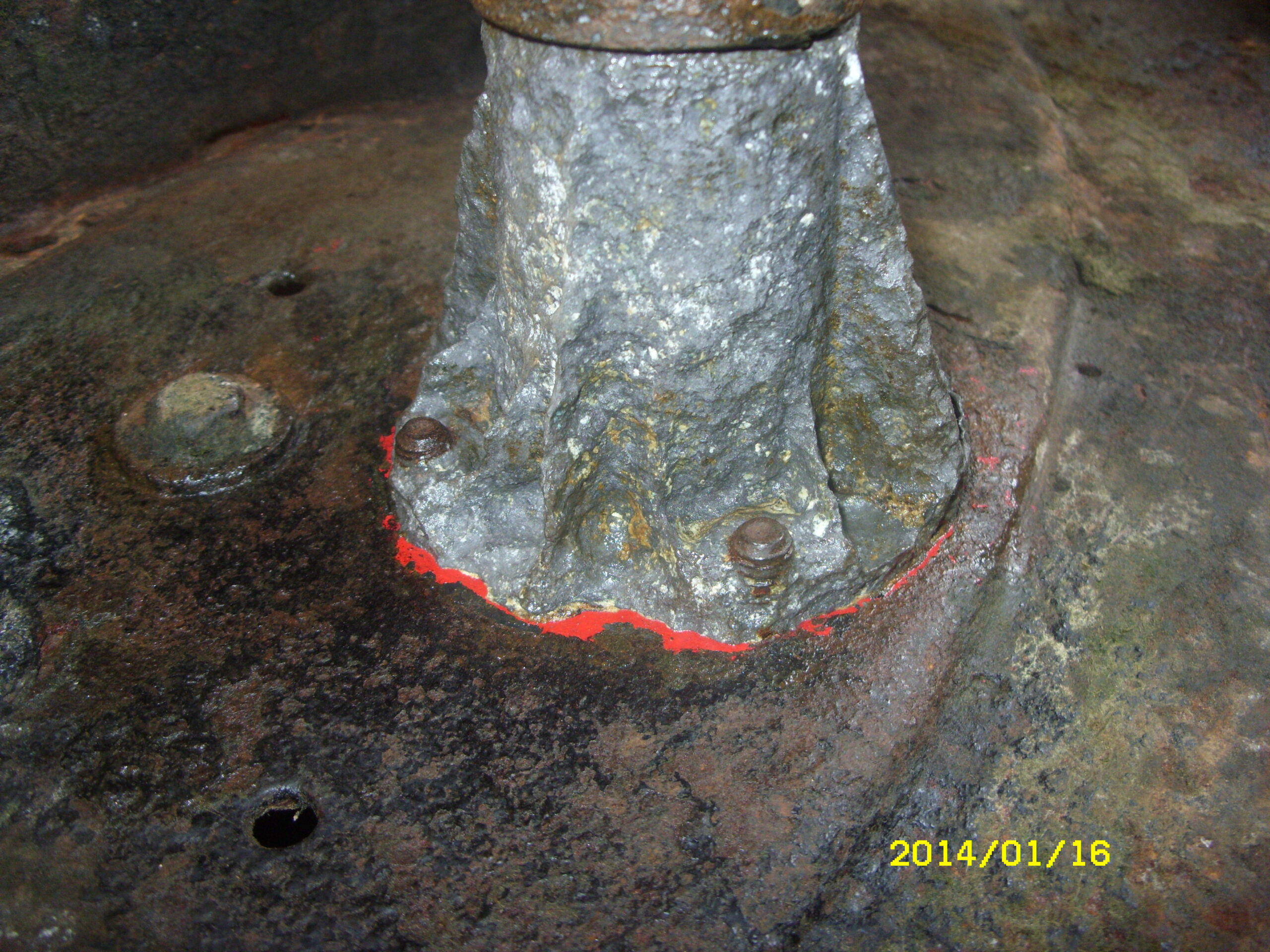

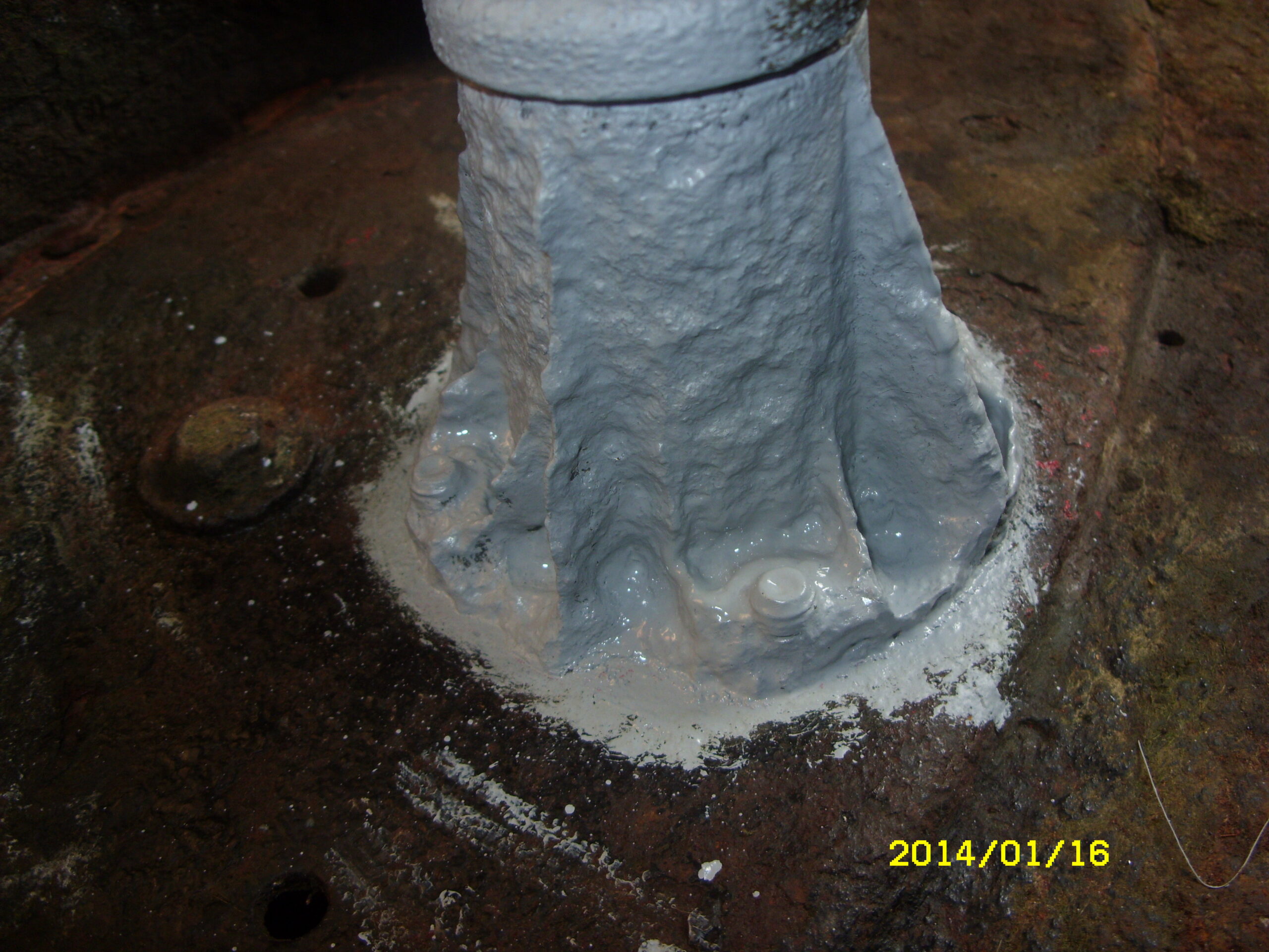

    Ive cleaned the spindle holders, a Mate let me have some Pro rust to try , it got the loose bits of. When cleaning I noticed the worst damage was the sides subject to the full force of the grass being thrown at them, the other sides being sheltered not to bad. See photos 1 and 2, with this in mind it would have been an idea to turn them around a few years back. Coated 2 and 3 holders with etch primmer and will over paint with hammerite. No 1 will get a smearing of grease, end of this season I will see whats going on under their. I recon this being a side discharge No 1 holder wouldn’t get the blast but 2 and 3 on the one side would get the waxoyl I used blasted off with grass.

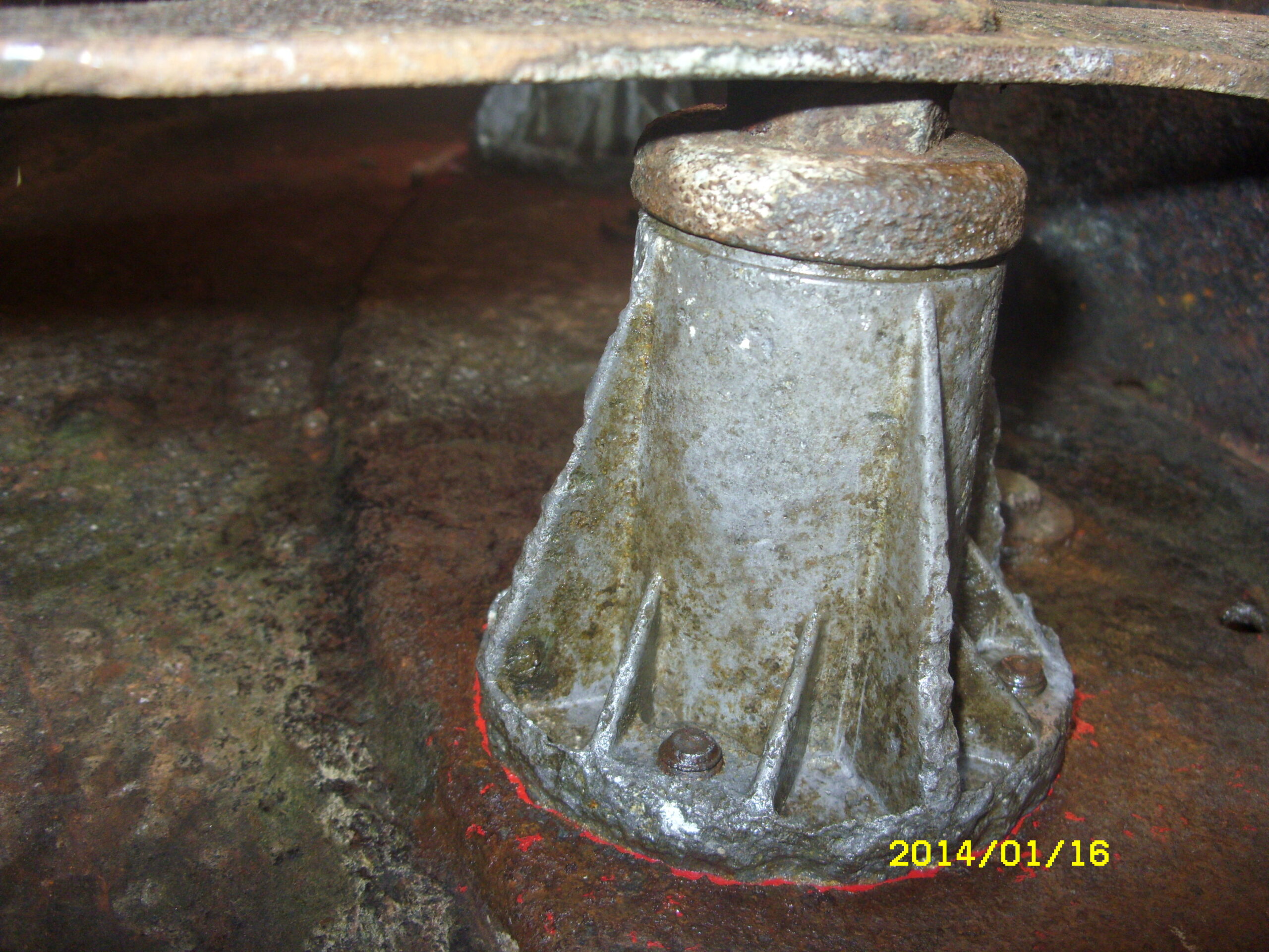

    I don’t wish to upset you here but the housing shown in image 3 appears to have severe wastage of the Aluminium casting, some of those pitted areas must be near or over 50% of their original thickness and given the nature of the decay I would be wondering if there is enough strength left in the housing to support the blade when under load.
    The general rule for material wastage on steelwork, bolts and components etc was 10% maximum when I was last involved in mechanical inspections.
    Ray.
    #5178
    That’s OK Ray, I can see your concerns. The photos are of the same holder, so it’s got a bad side and a good side. I thought it would hold but I’m not so sure now, the bearings are good with no play and it won’t be subject to any rough work. I will keep it checked.
    #5179
    hillsider
    That’s ok, But I think it would not be a bad idea to keep a lookout for another deck to perhaps salvage a spare housing from if you intend to keep the machine in work.
    It seems that although aluminium is very corrosion resistant if it does suffer it suffers badly.
    Ray.
    #5187
    Thanks Ray, I have a spare 42″ deck rear discharge with good holders that I could fit right on the Wheel Horse. But seeing I don’t pick the grass up the 42″ side discharge blows it about better, so I had a look at it today and could swap the complete units over. I will see how the season goes.
    #5960
    This is a photo of the spindle holder with two coats of paint over the etch primmer, will take a photo end of season to see if it was worth doing.
