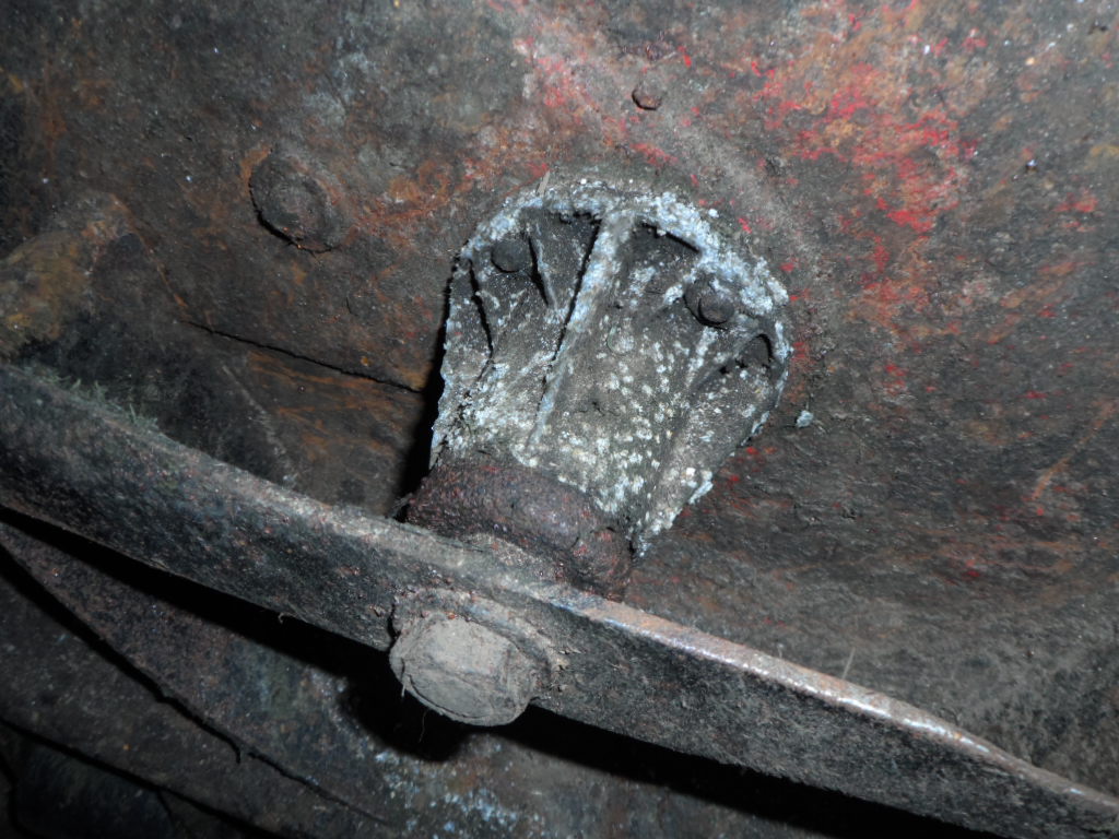

    I’ve read so much on the net concerning treatment for aluminium corrosion, I am confused . com. I was wondering if anyone had used something that works to prevent it, every year I clean the wheel horse deck and coat with waxoyl, But the spindle holders have this white deposit and are gradually being eat away. Thanks Owen.
    #4976
    I seem to remember being told that the initial layer of oxide/corrosion would protect the underlying metal from further deterioration . That was the theory but in practice it does seem a bit different.
    That said, the acids produced by a damp poultice of festering grass (and worse!) does seem to have the ability to corrode things like spindle housings to the point of destruction. “In season” in practical terms there is not a lot that you can do – weekly under deck hosing or pressure washing is not only a messy operation but can have undesirable effects to bearings etc.
    Out of season with a dry deck I would suggest dry cleaning with a scraper and stiff brush (not wire) to clean off the crud but leaving the oxide layer and then give the housings a heavy coat of a waxoyl type product or heavy grease to exclude air.
    When I was in business we used to coat the underside of “winter service” decks with “soft grease” -a brew much loved by the military back in the 50/60s for coating the underside of “mothballed”equipment and made by mixing heavy grease and engine oil and stirring to a semi fluid consistency and liberally applying with a wide paint brush. Our lubricant supplier used to offer us dented and damaged drums of grease at an acceptable price!
    #4977
    Owen I have come across this problem many times especially on older range rovers. the rear window and tail gate are two separate items . now the tail gate especially has problems on the lower hinges and the customers commented that rust was appearing in that area. on speaking with land rover they told me that when alloy and steel are mixed,i,e like the hinge and door a electrical force traveling between the two causes the furriness as you describe. your deck will be a mixture of both products and the one way you can stop it is to isolate all contact points on the joining process. its just one of lifes irritating problems.
    #4978
    Thanks Angus, I will try the grease plastered on, the waxoyl once a year works fine on the rest of the deck and has probably helped the spindle holders somewhat. One thing amongst all I read, that might tie in with your grease excluding the air. Was to paint corroded area with galvanise paint, that’s when it’s clean. Seeing there’s three of them I might try two with grease and the other with galvanise paint and see what they look like end of this season.

    Anything that excludes air and moisture has to be better than nothing . Not sure if I have read your post about galvo correctly but while being fine for steel it is unlikely to be beneficial for aluminium alloys.
    My guess is that if money was no object a new bearing housing given a couple of coats of epoxy primer would be the way to go, but to get an existing housing clean enough fot that to be effective would possibly destroy it.

    Electrolytic corrosion where aluminium and steel is a major problem on things like Land Rover especially when salt is added. One problem painting aluminium is getting a clean surface, an etch primer is essential.
    #4985
    Thanks to you all for your help and suggestions, I will stick to my original plan with the addition of etch primer.
