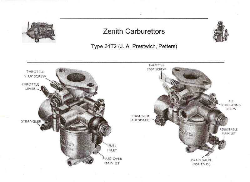

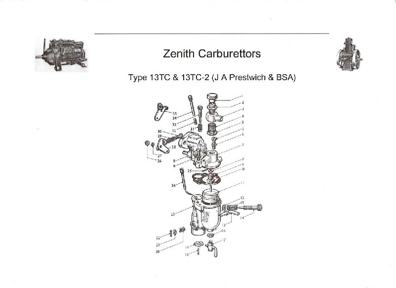

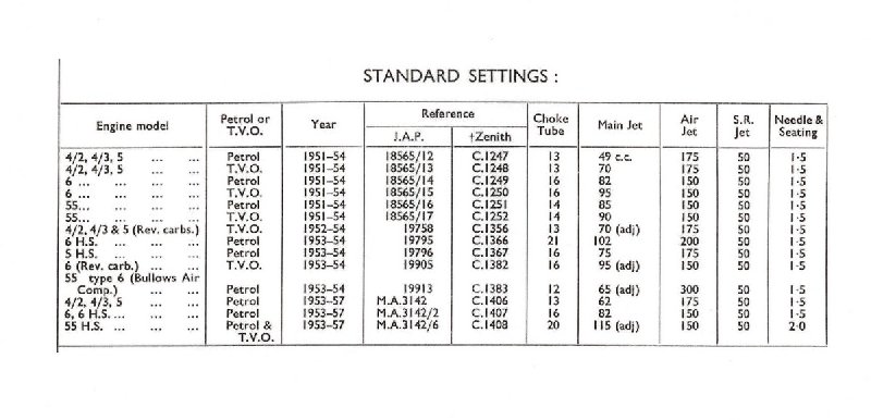

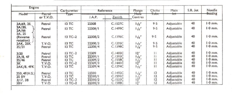

will-haggleParticipantHere’s a bit of JAP & Zenith information I got from semidiesel. This information is now held by https://www.internalfire.com/…..
