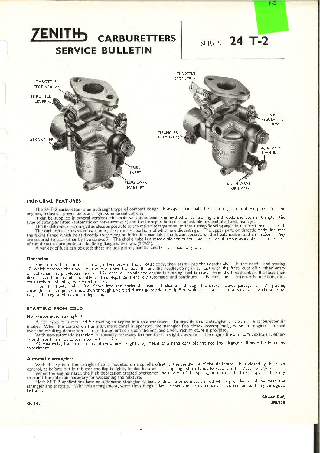

sidevalve5ParticipantHave recently got another Trusty, I think its a 1959 model with a Jap 6 engine, 3 speed and reverse box. It does not look like its done much work and has been stored in covered yet damp conditions for decades. There was a lot of freeing up and small jobs to do before it was running. The exhaust valve was stuck open, freed it with a tap at the end of the stem, but still no real compression. Had to take the head and barrel off to deal with the corrosion damage. It does go really well, put to work yesterday evening and all OK except the clutch shoes are a bit sticky and is obviously running too rich.
Which is the point of this post. It has a Zenith 24T2 carb and a fixed jet. Do have another carb with an adjustable needle and was wondering if anyone had removed the blanking plug on a fix jet model, then fitted the needle. Did clean the carb thoroughly and noted the main jet had the right hand side of the slots well rounded. Which suggested to me it was difficult to put in even at the factory. Removed the other jets with the aid of some heat, but the main jet would not budge. Have tried to remove the main jet from a couple of other Zenith’s, with no joy either. Does anyone know if the tapers to the needle and jet are the same. I would have thought it was, but if anyone know’s for definite, that would be great.
Also have a Jap 5 with a Zenith 24T2 which I fitted years ago as a replacement for the worn out Jap carb. The Zenith has never been 100% perfect, despite a new throttle spindle. Had it ultrasonically cleaned, which made a bit difference. Think there was some corrosion I could not get to in the between the main jet and the discharge nozzle. Possibly blocking the emulsion holes. But does anyone know the correct choke size for a Jap 5. The Jap 6 tickover is much steadier, the Jap 5 is OK, but not quite as reliable of the 6. When using a Trusty find good carburetion vital for slow manoeuvring.
Have a Zenith service sheet which may be of use to somebody, so have uploaded it. When I got it I could see the emulsion holes and therefore where a problem may occur.

Participant24t2s with fixed jets are ok provided there is very little to no wear in the butterfly shaft , and your engine bore/valve set up is also ok , this is especially so for any application that requires smooth tickover and smooth pickup of revs.
I would always go down the route of changing fixed to adjustable , it eliminates all the USUAL problems with the fixed jet , I had a Coleby a few years back that was a comlete pain until I changed to adjustable.Andy.

The Jap 5 has the adjustable carb needle, so am going to put it on the Jap 6 and see how it goes. Have nothing to loose and can always return it back to the fixed jet. Many thanks for the offer David, but have a spare Zenith carbs with an adjustable needle. When I get round to restoring the Gravely D I might have a go at fitting a modern carb to it. Think the Zenith is too big so such a small slow reving engine. But thats for another day.

sidevalve5ParticipantAn update, the adjustable tapered screw does work very well with Zenith 24T2 carb that has a fixed jet. The Jap 6 in my newly acquired Trusty was obviously running rich. Had to take the head a barrel off as part of the re-commissioning and there was a lot of sooty type deposits. It was not hard baked on carbon, which I would have expected if it was burning oil. I set the fuel/air mixture with a plug chop and after a couple of efforts with doing adjustments, I have the plug with the correct brown coloured deposits on the end. The engine sounded beautiful and pick up from tickover was smooth. But currently only scuffling with 7” diamond feet on 5 legs, with at 2” deep in ground I have already gone over both ways with ducks feet at 3” in clay soil that was padded down well. So did not need much power on the already roughed up ground. Find when I put a SV engine to harder work and if I have the correct brown colour on the plug, I get a bit of a hunting type misfire. A tweak to richen the mixture usually cures it, even though the plug colour changes more to a charcoal shade.

The ultrasonic cleaning did improve the Zenith’s performance at tickover on the Jap 5, but it was not perfect. After looking at the sectional drawing of the carb, I just get a feeling that some of the blind passageways still have a partial blockage due to corrosion deposits leaving an uneven surface.
