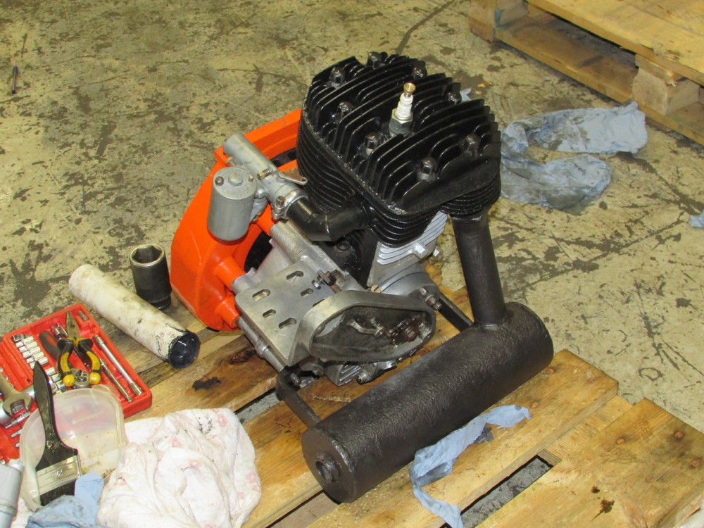

    Recently into my possession fell a JAP 600 side valve from what I believe is a Howard Gem Rotavator.
    My aim is to rebuild the engine and build it into a cool custom motorcycle, however.
    It has attached to the LHS on the engine a big orange flywheel and the body it sits in, now to remove this i’m guessing a puller is involved as I can see two bolts holes front and center but my problem is I can find two bolts that screw into them my garage.
    So my question is how do I remove this massive flywheel? a special tool? any help or advice is extremely appreciated.

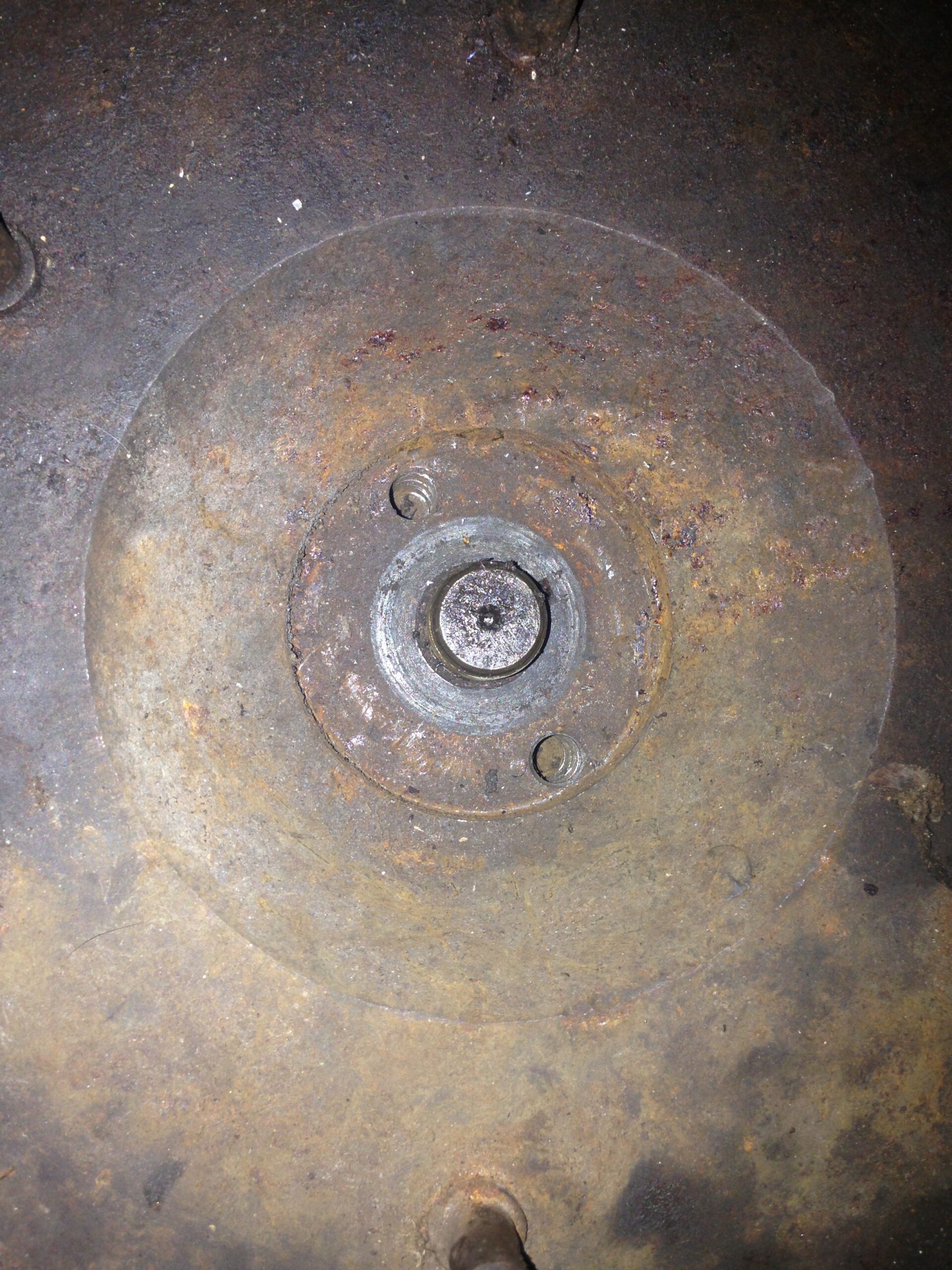

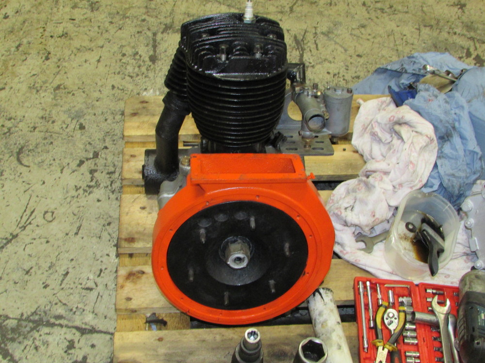

    A photograph would be a great help to identify the type of flywheel. I’m guessing it would be off a Howard Gem.
    #26071

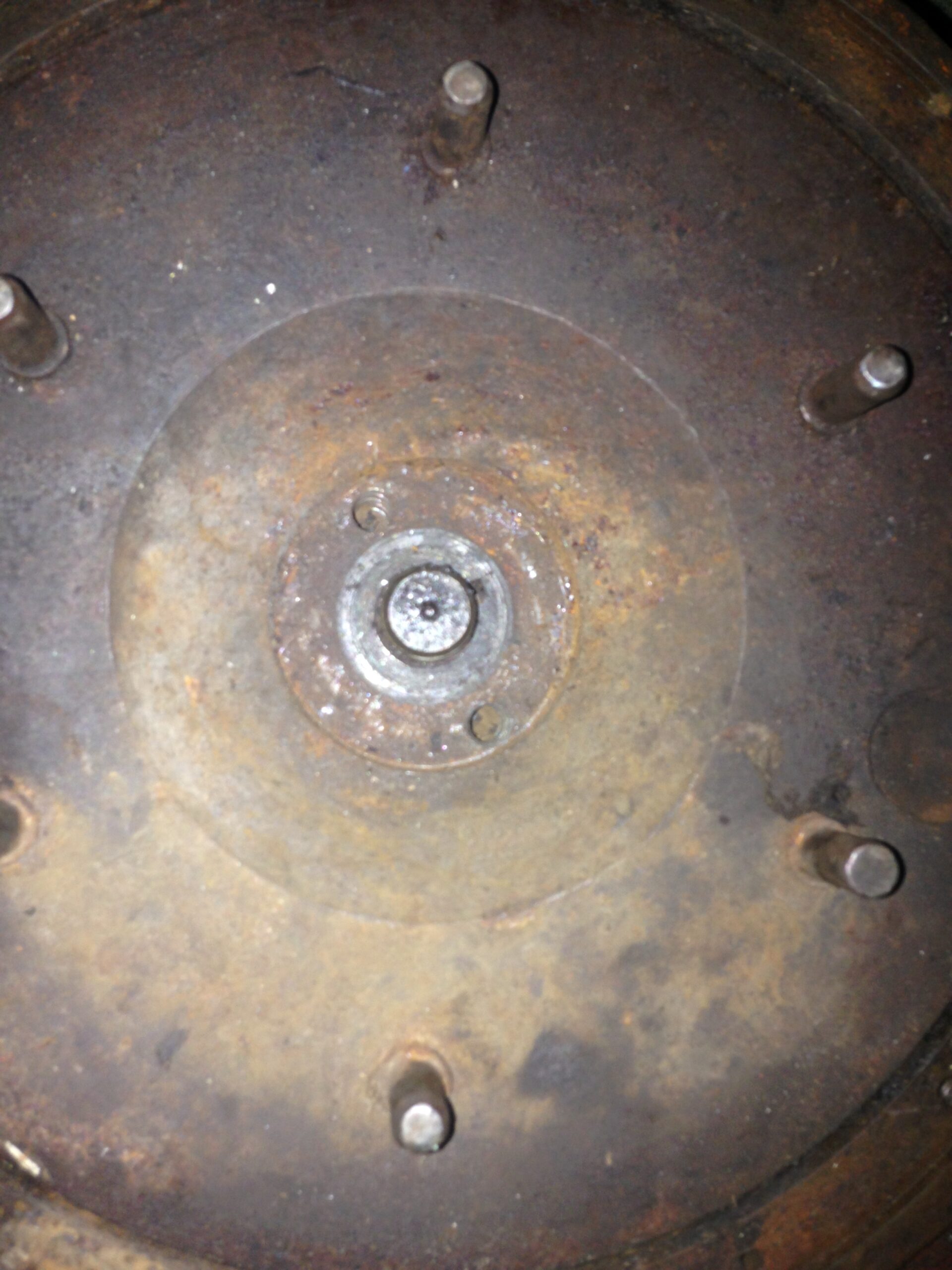

    Photos added i can see a fly wheel puller is needed but anyone know how big/ which one/type is needed. thank you.

    Now you’ve removed the nut, I find the easiest way to remove the flywheel is to undo the 6 nuts holding the Orange airshroud in place on the opposite side of the engine and then give the shroud a couple of clonks with a soft hammer. Maybe not the correct way but very effective.
    #26080
    Will give it a go now, thank you S1.
    #26083
    No joy, tried that aswell as many others. its really on the crankshaft. can someone link me to the correct type puller please?
    #26087
    You’ll probably have to make one. What you need is a bit of thick flat plate( or angle will do) with 3 holes drilled in it. Weld a nut on the centre one so you can thread a bolt in to push on the end of the crank, the get 2 bolts the same thread as is tapped in the flywheel, I can’t find my book at the moment so can’t find what the thread is but do you know anyone with a set of thread gauges?
    When the tension is on you may have to whack the centre bolt to shock the flywheel off the taper.
    #26088
    They will come off if you keep at it.
    #26145
    Quick update for anyone checking this out in the future, got it off finally with thanks to £14 harmonic puller from ebay, works perfectly. all the best.
